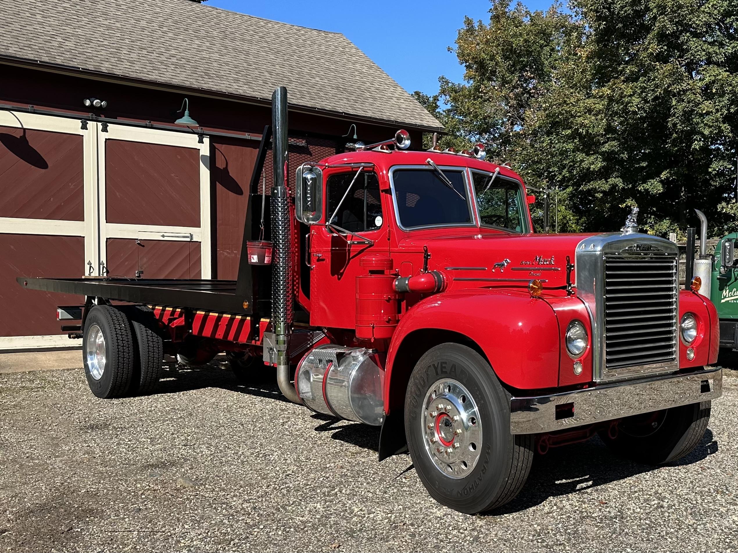

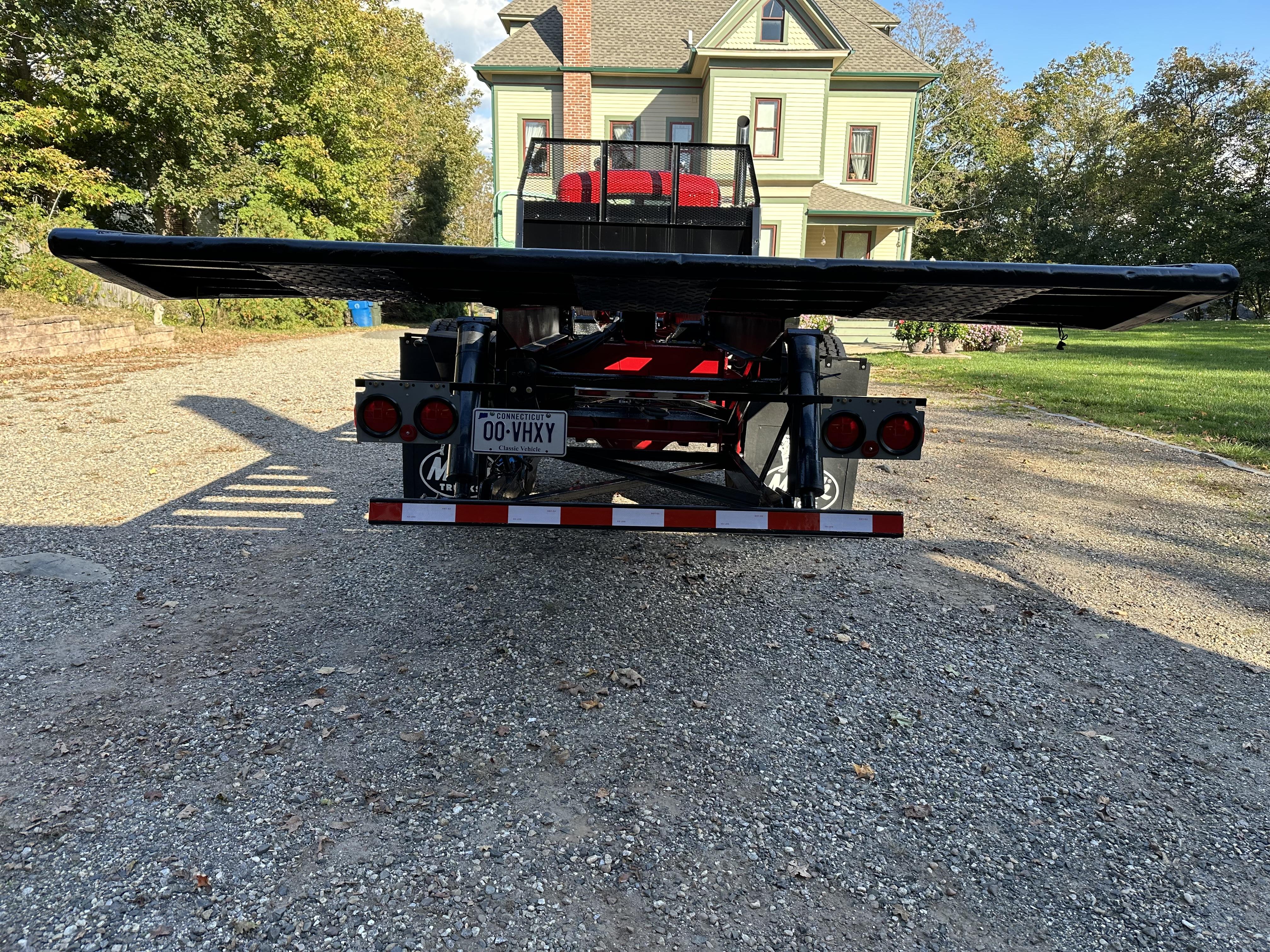

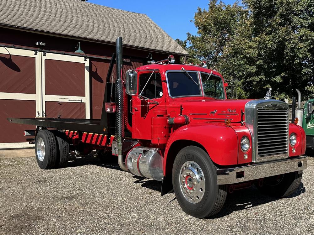

can't comment on the truck due to no words can accurately describe it .work of art. did notice one thing when enlarging the picture to see the details++ the puppy in right side upstairs window looks like he wanted to be in picture !LOL

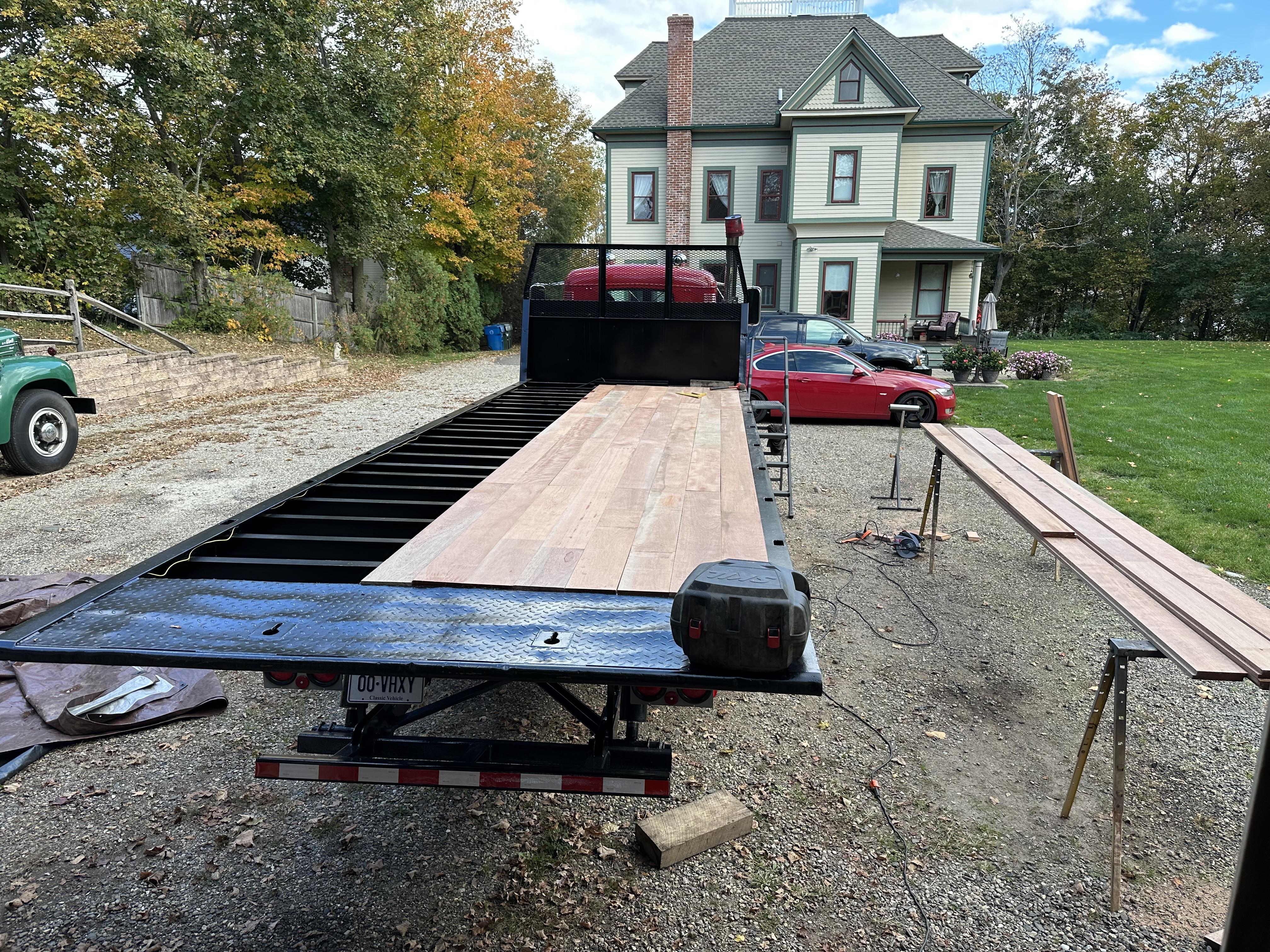

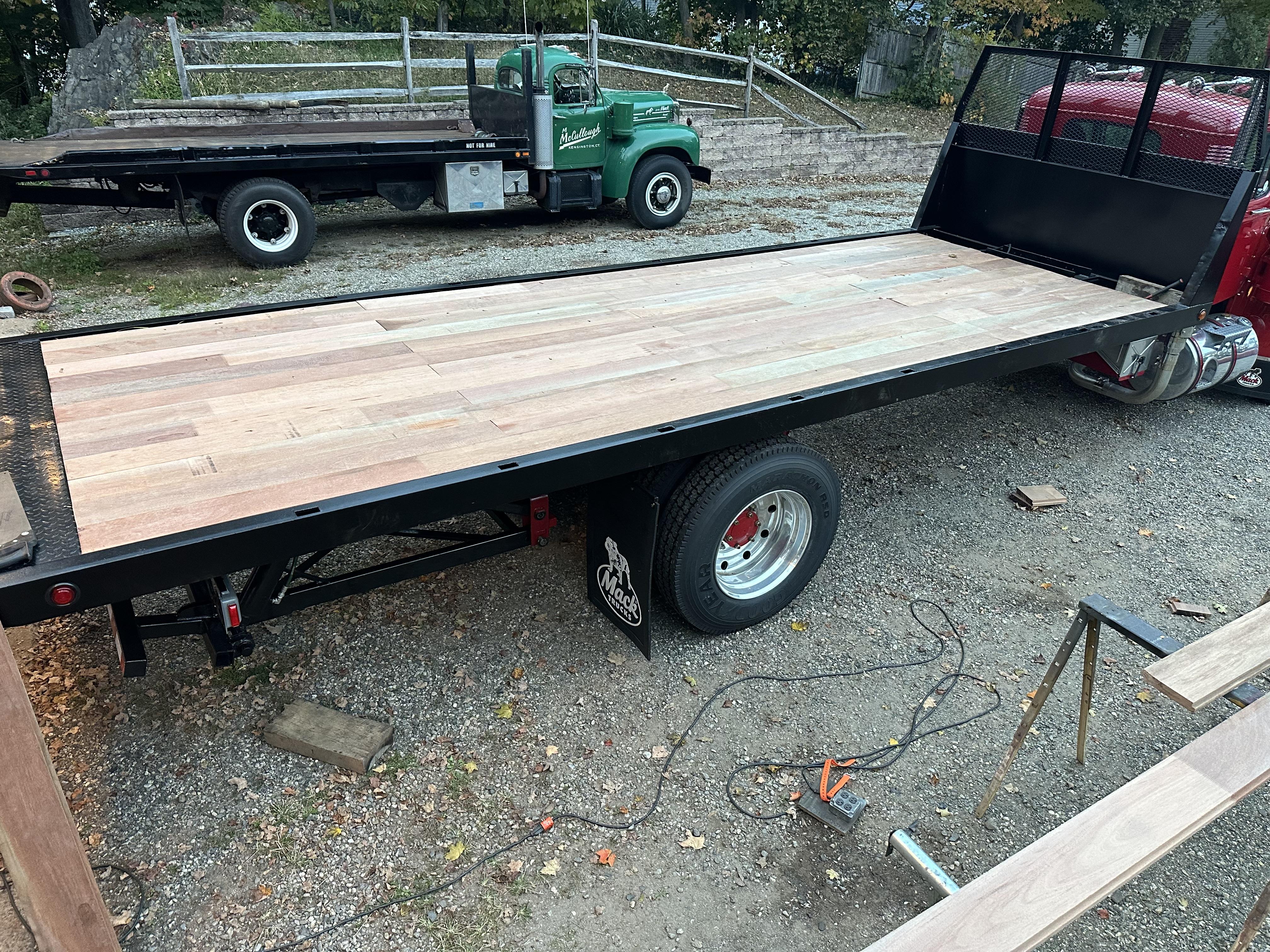

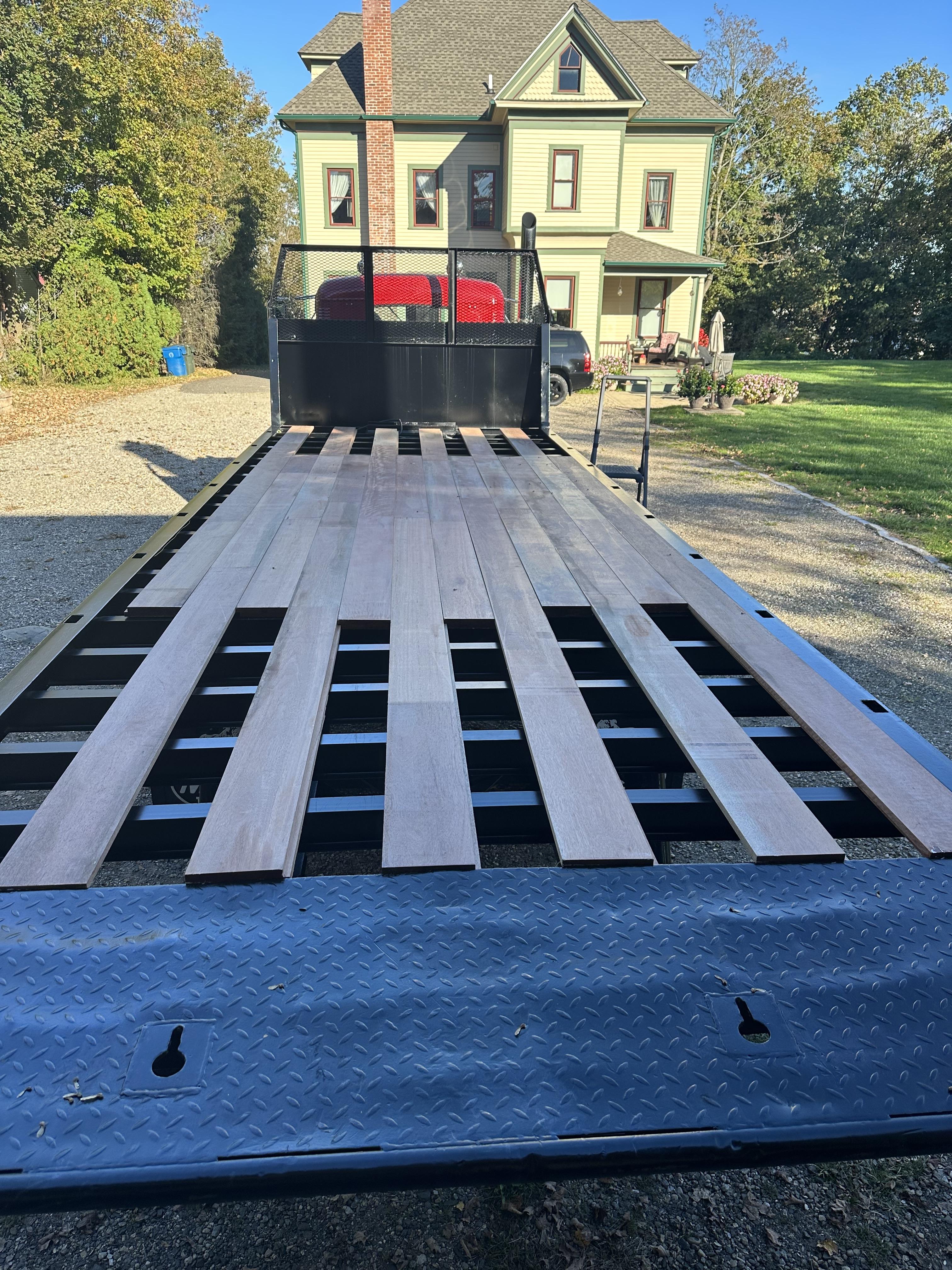

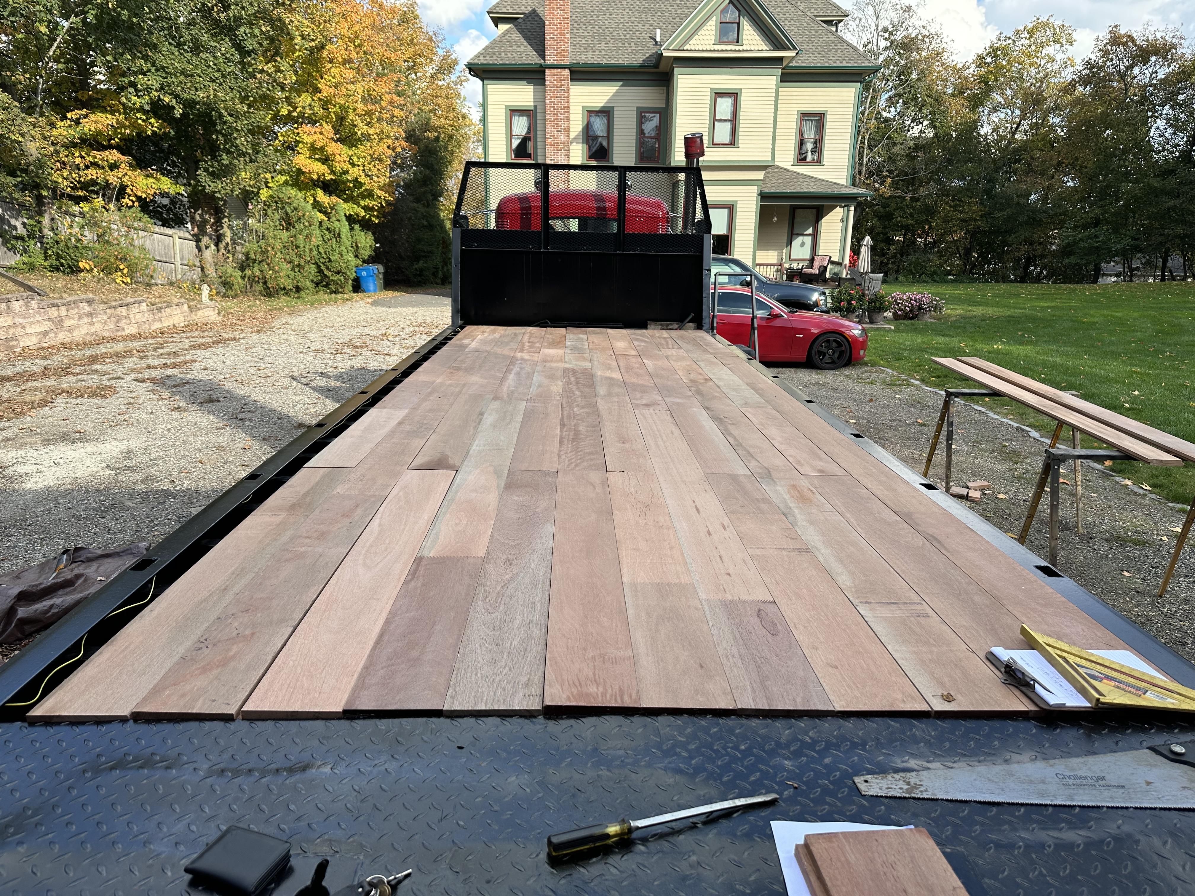

I gather when you say your screwing the boards down you mean a nut and bolt type of screw not a self tapper
I remember my first attempt at a wooden tray
Air dried timber, cut the center board custom for a neat fit and bought another center board for when the wood shrank further
Just nailed it in place
It all dried and I closed up the gabs and fitted my spare center board
Screwed it all down
First lot of rain it saw, the boards all swelled up and popped out everywhere
Had to wait for it all to dry again to jack all the warped timber back into place
Nut and blots this time
When carting cattle the boards would swell right up tight and sort of buldged here and there but worked fine and no further issues
A few rookie mistakes were made by me there
Paul
21 hours ago, doubleclutchinweasel said:
I’m a big fan of carriage bolts and nylock nuts!
box truck carriage bolts fine (they are inside not exposed to elements.) that flat bed I would go the route of floor decking bolts  1/4 in  which have the 3/4- 1 in flathead  and flat washers / nylon nuts. few more $$ but well worth it ( my thoughts )
Will you need to countersink them to prevent snags????
Brocky
NO- bolts I'm talking of have a larger diameter  head which is thinner. tightening the bolts which have the flat washer against the steel channel NOT under bolt head go close to flush with top deck boards.
The fastening system for this deck was originally self tapping screws into the cross members. I'm going to use the same thing. I'll drill and then countersink the holes to keep the heads below the surface. the wood is Apitong and very dense and hard. It's very durable, nearly impervious to rot and doesn't really swell.
