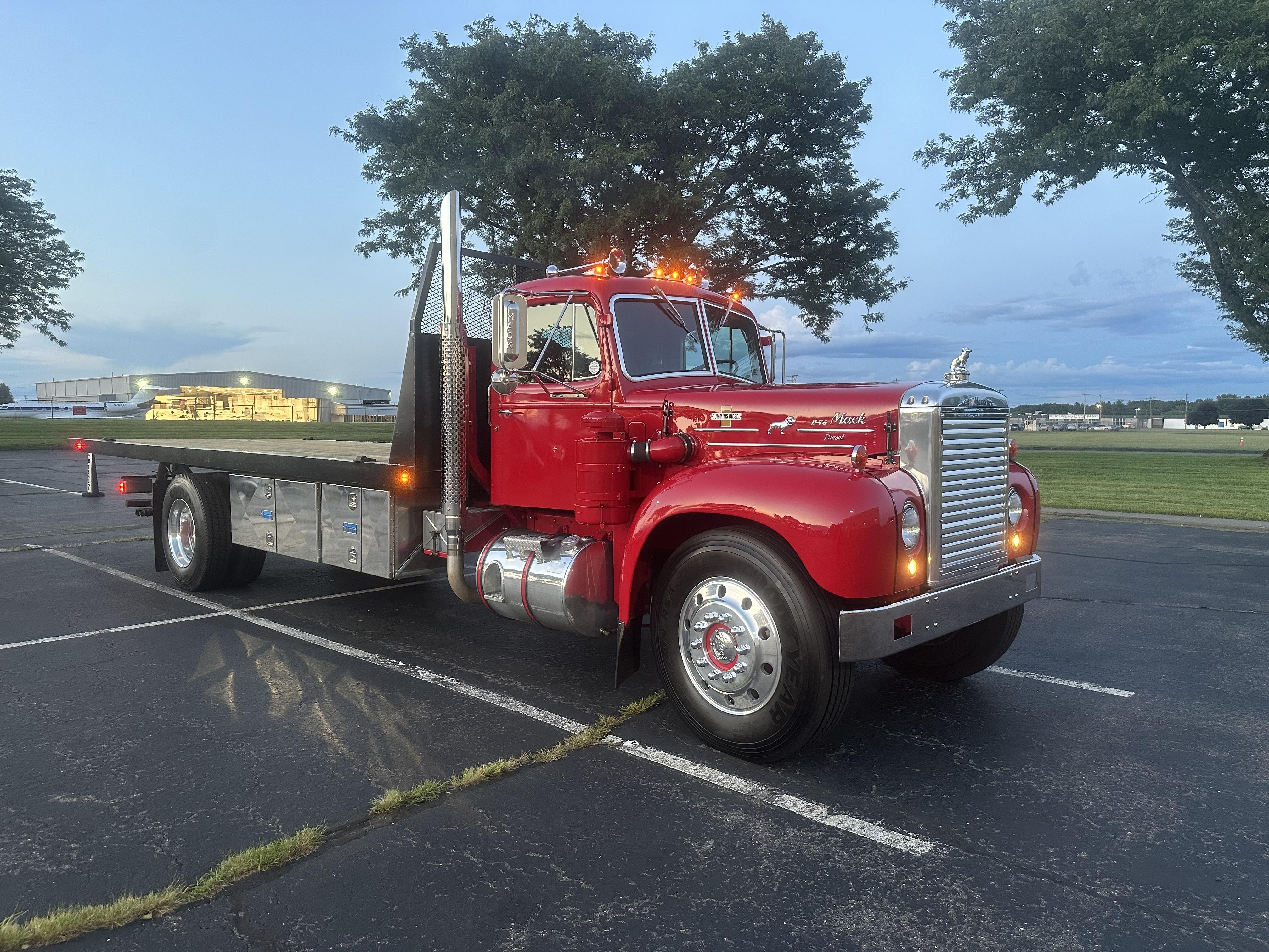

On a bright note, I did finally get to drive the truck at night, with all the lights working.

and matt,,,,love those side markers,,,,great touch,,,must have missed the post,,,when you put them there,,,bob
The ones on the bed? They were original to it. Thinking about adding some more, but I may just leave it as is. There all new LED types and all fresh wiring.
