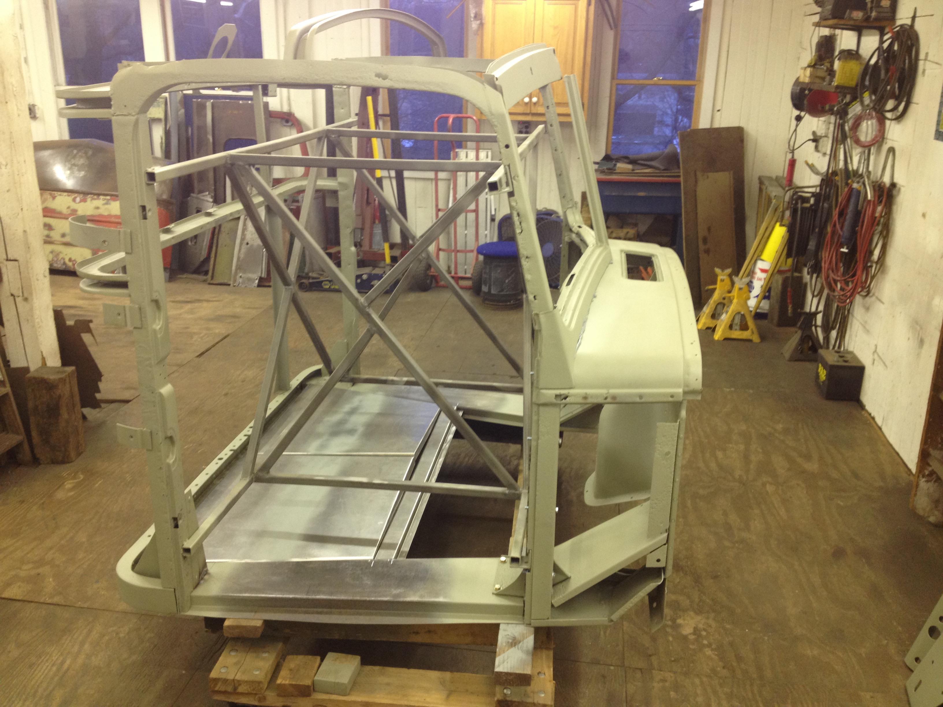

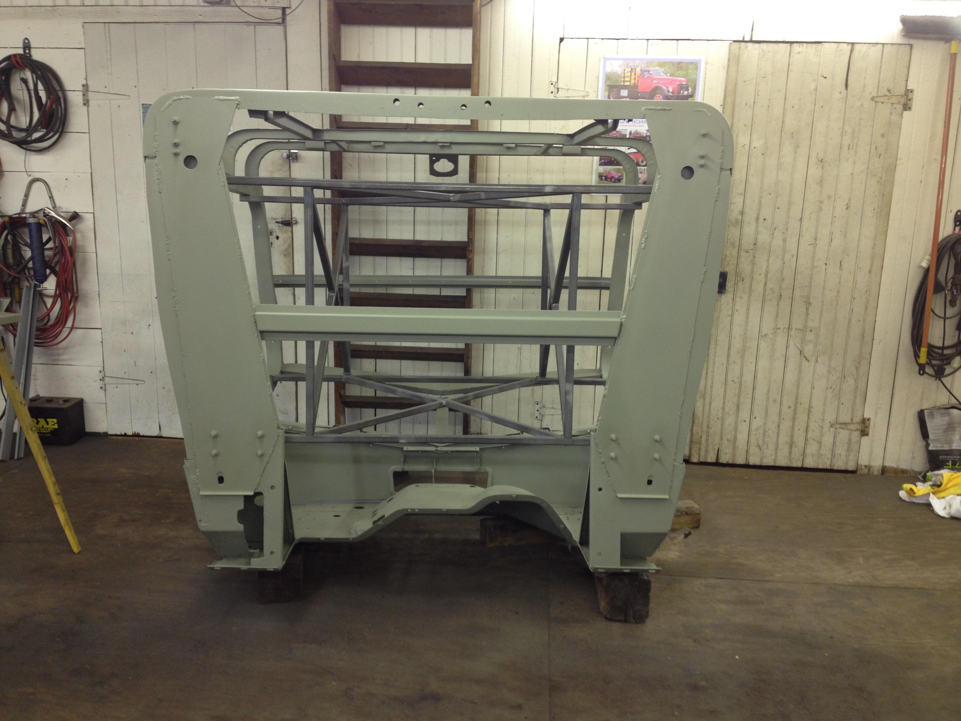

It's hard to estimate the man hours due to how long I've had it. It's always been a back burner project, as I was about to start my other B just when I found this one. So, I've done and collected what I needed over the years in between other projects. A lot of items are already done and stored, ready for assembly. This is the part I've dreaded, it's just dirty, time consuming work. I have the knowledge and experience to go this deep, just not all the equipment to do it. Fabrication is adding to it's cost, but it would be even higher to buy the equipment for what I see as a one time restoration. The cab has always been the roughest part. The truck was used hard up until, from what I could figure, around 1987 when the engine was removed and it was essentially abandoned outside until I found it in 1998. With that and the typical New England climate, rust has taken it's toll. Almost all of that is gone now, with new panels to go back in or existing ones repaired. It would have been nice to find one from your area, but getting it home would have been cost prohibitive. This style cab is somewhat rare and not easy to find. I saw one for sale up in Canada, but a close look at the photo's it looked like it might need similar work and again the cast of getting it home. This is certainly the most in depth restoration I've attempted and there won't be hardly anything that hasn't been touched.

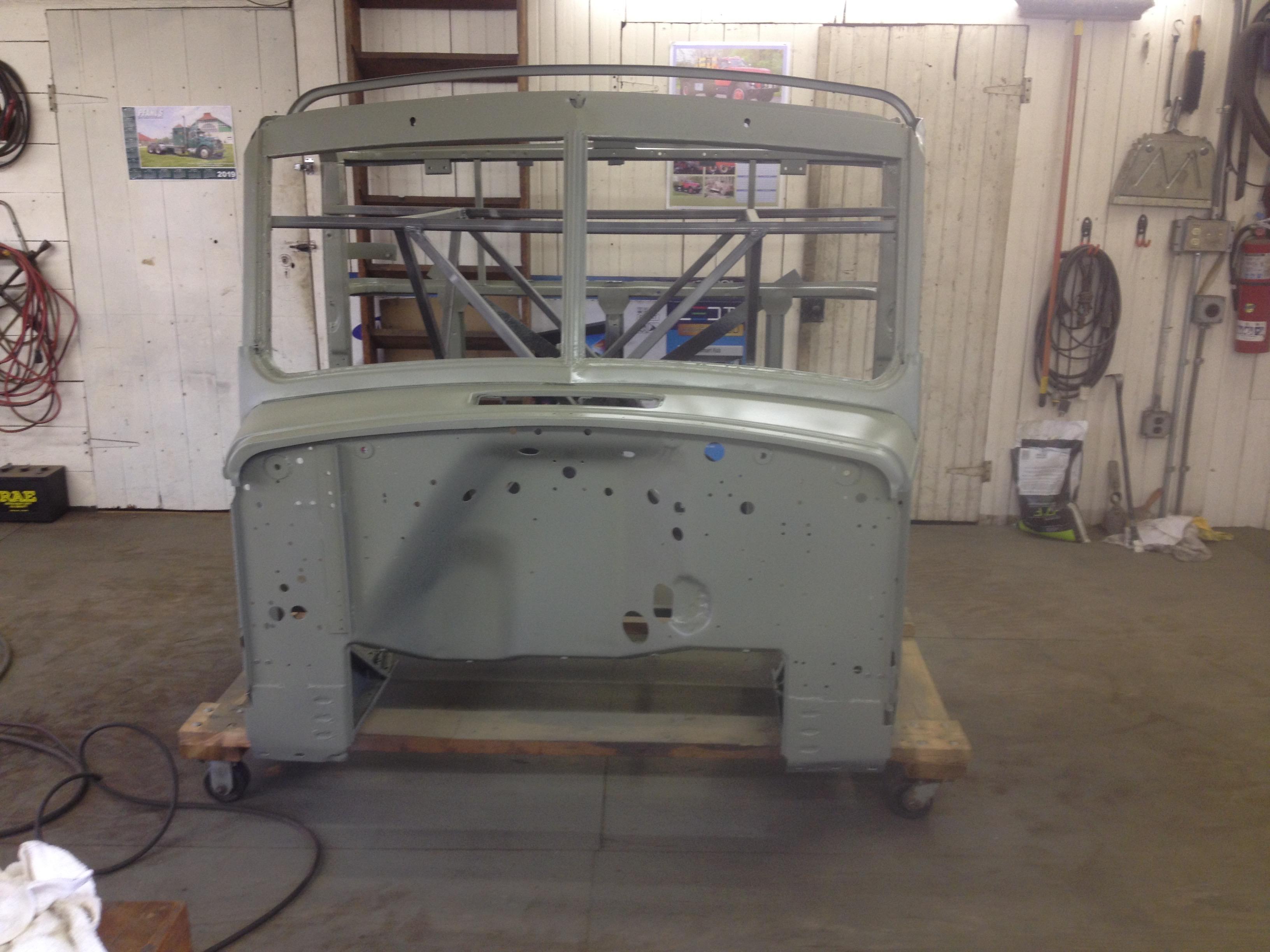

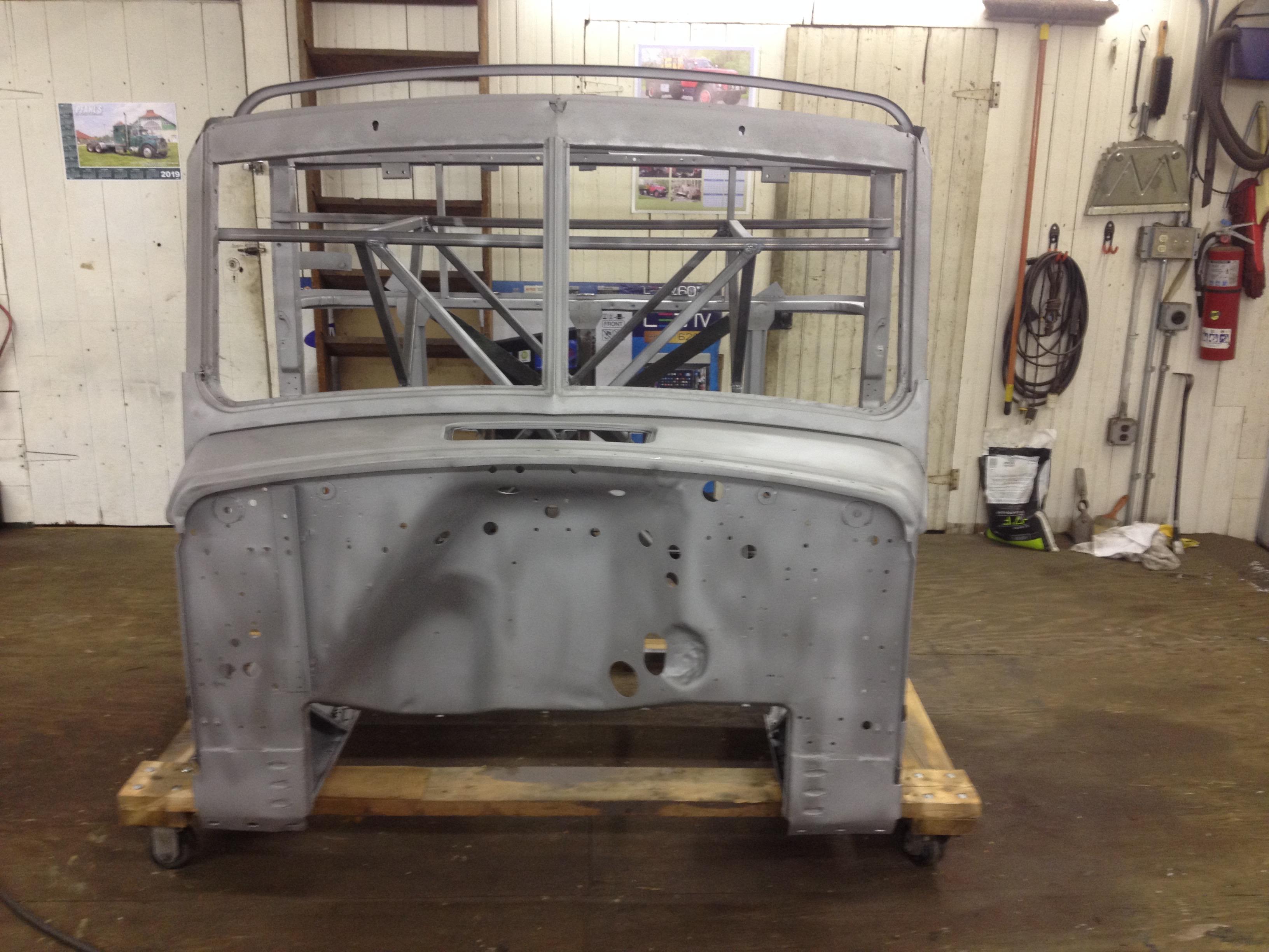

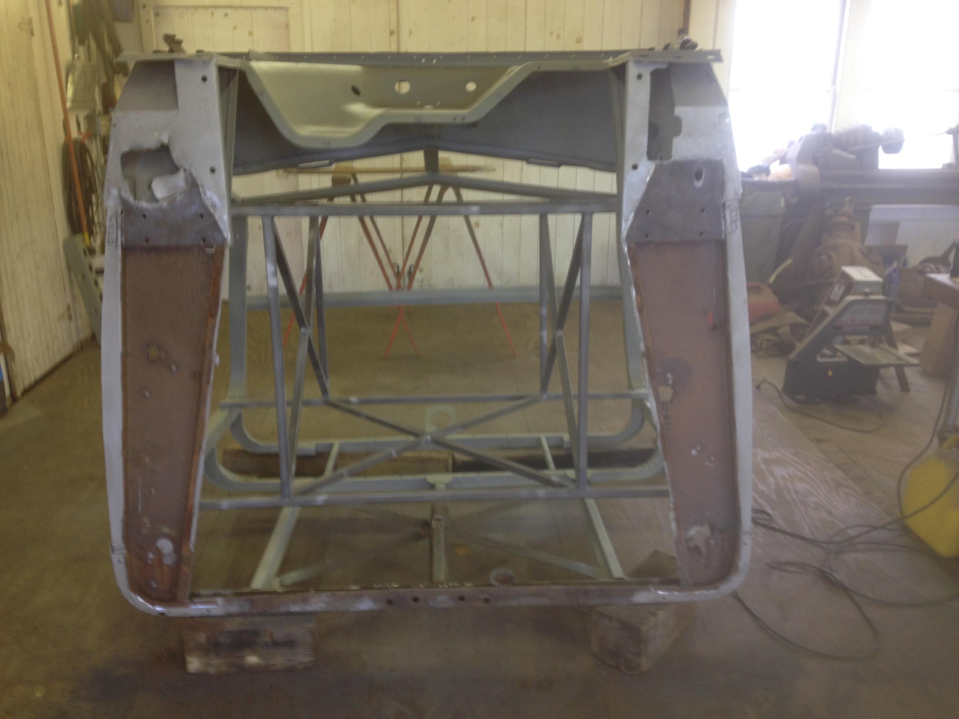

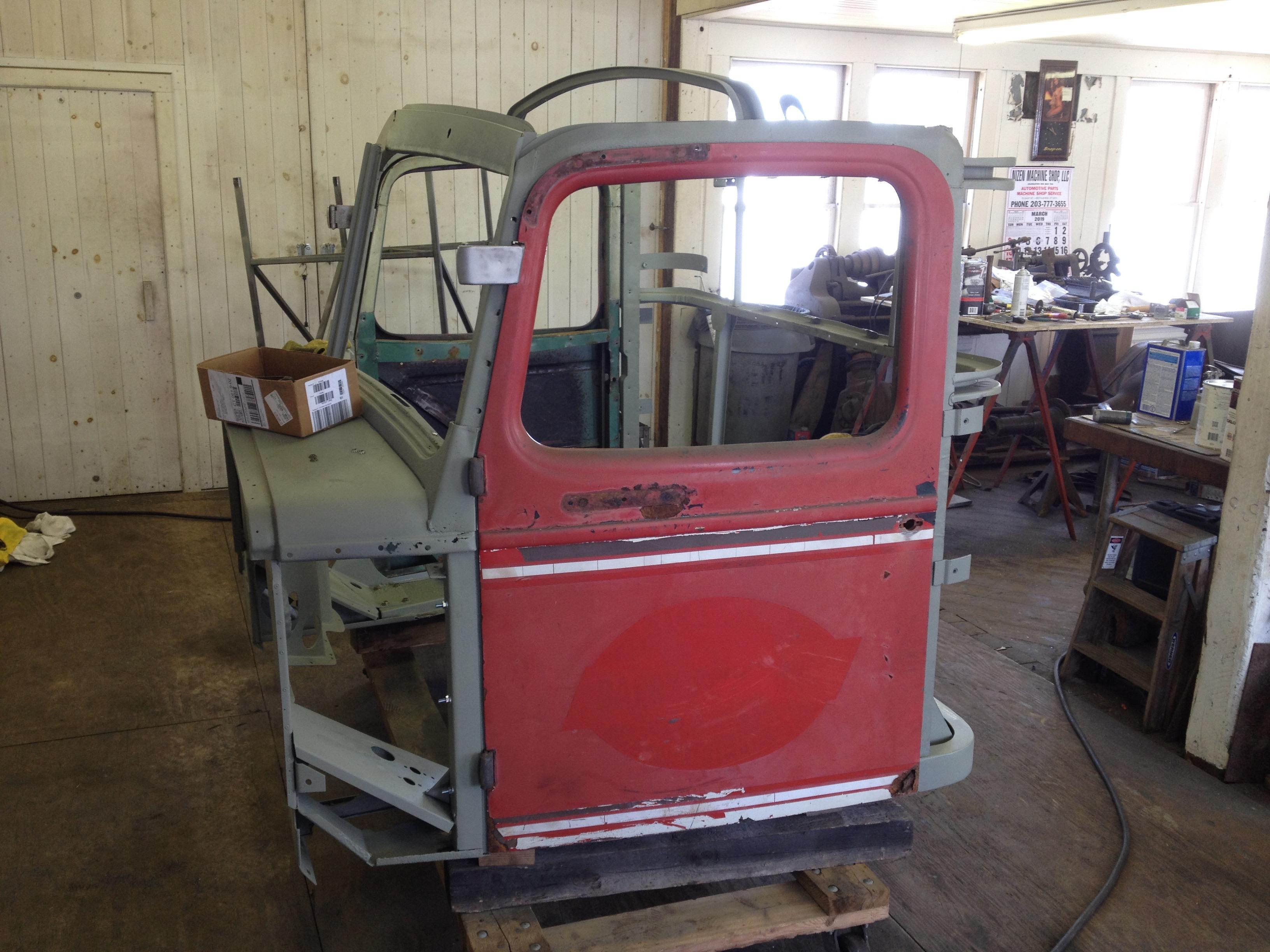

You've got that thing torn apart!! My H67 cab didn't look too bad until I had it blasted and all the bondo was blown out of the rust holes...then it looked a lot like yours.

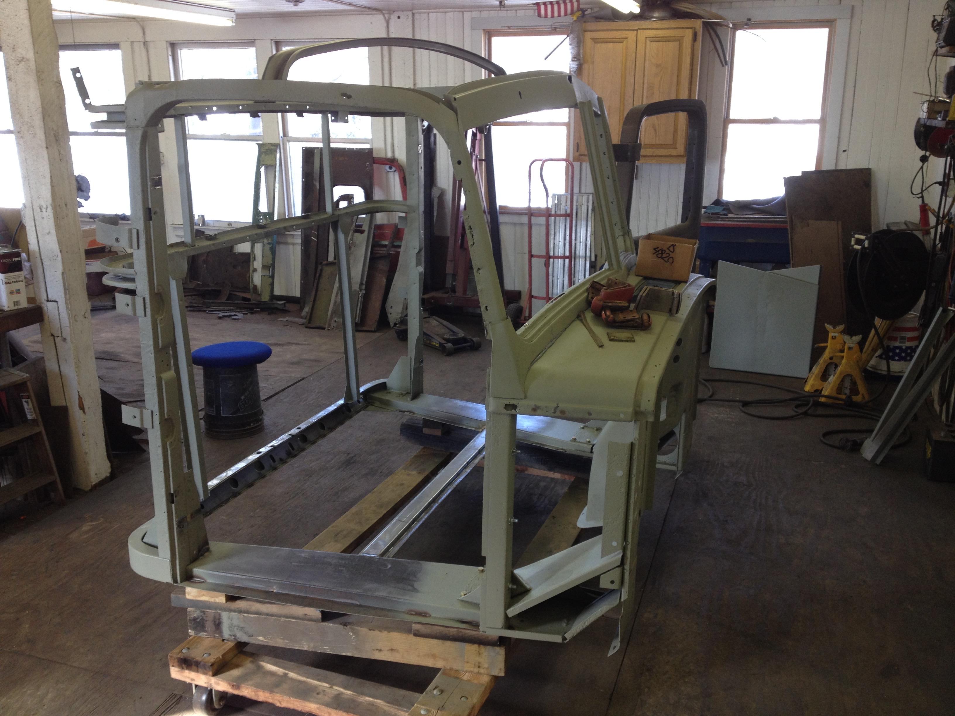

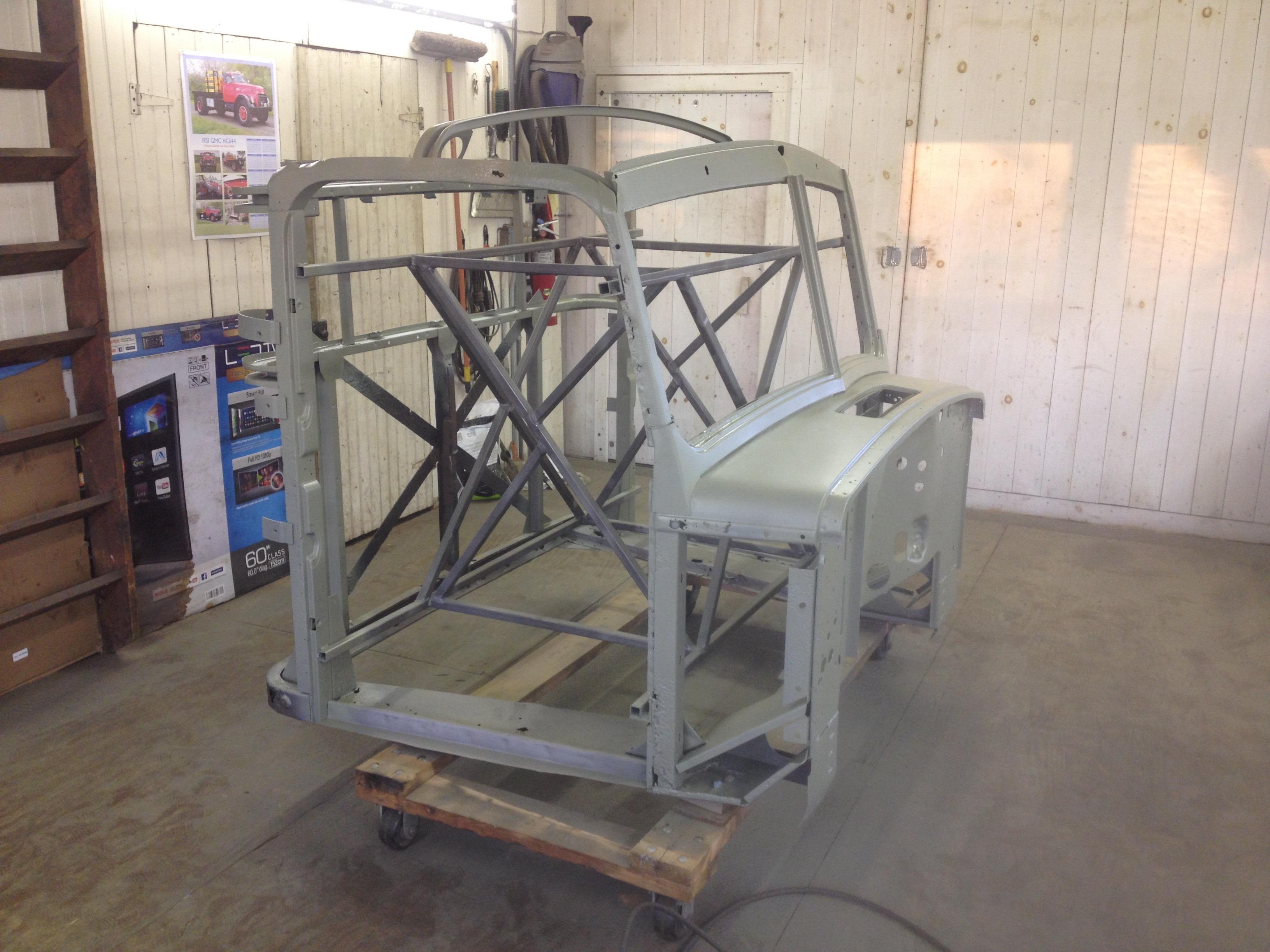

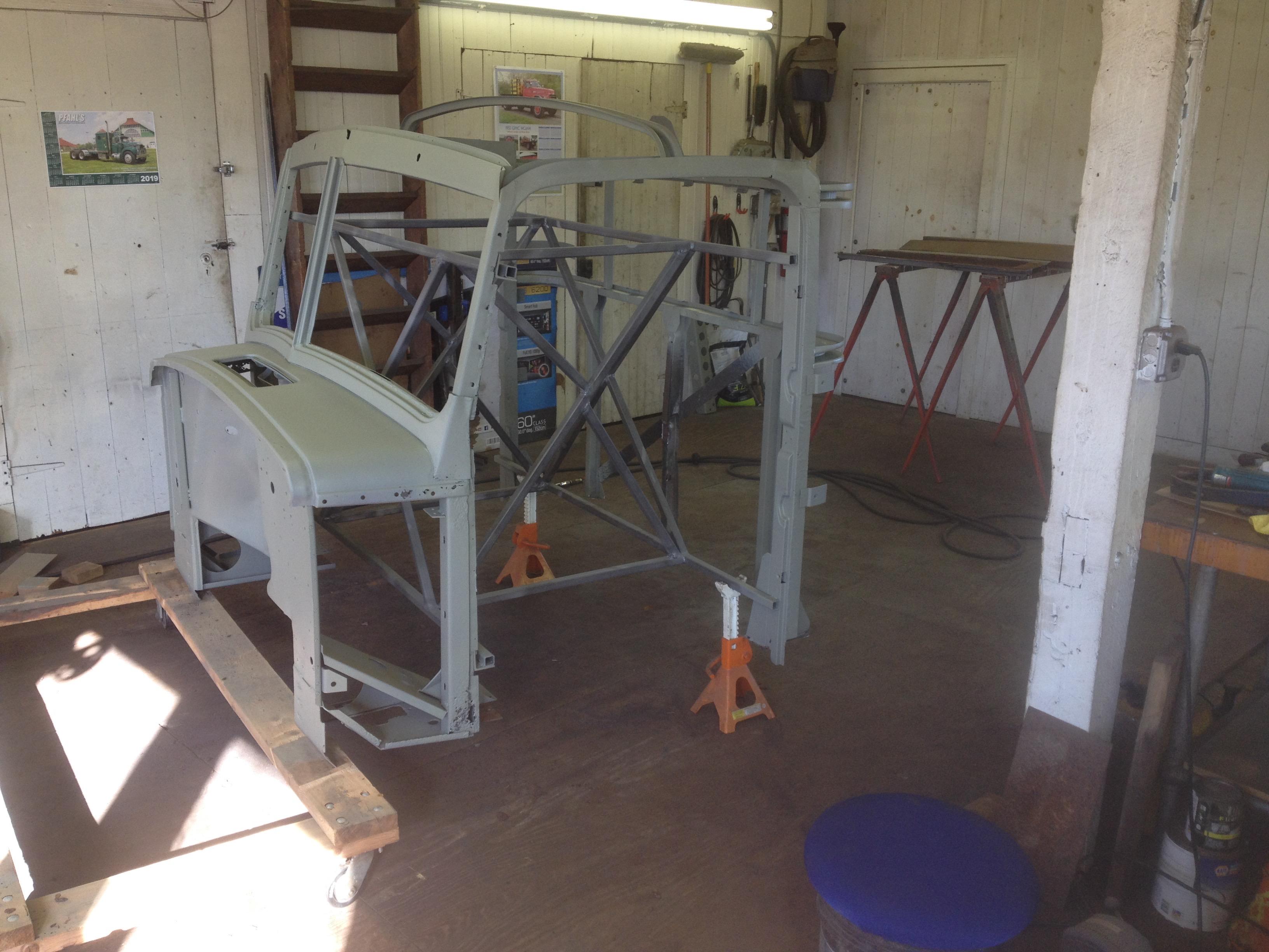

Luckily no surprises when I got it back from the blaster. The areas that were slated for replacement opened up a little more, but the rest was solid. And no real bondo, several layers of paint was about it. Now to start putting it back together so it doesn't look like a rolling jigsaw puzzle when I'm done.

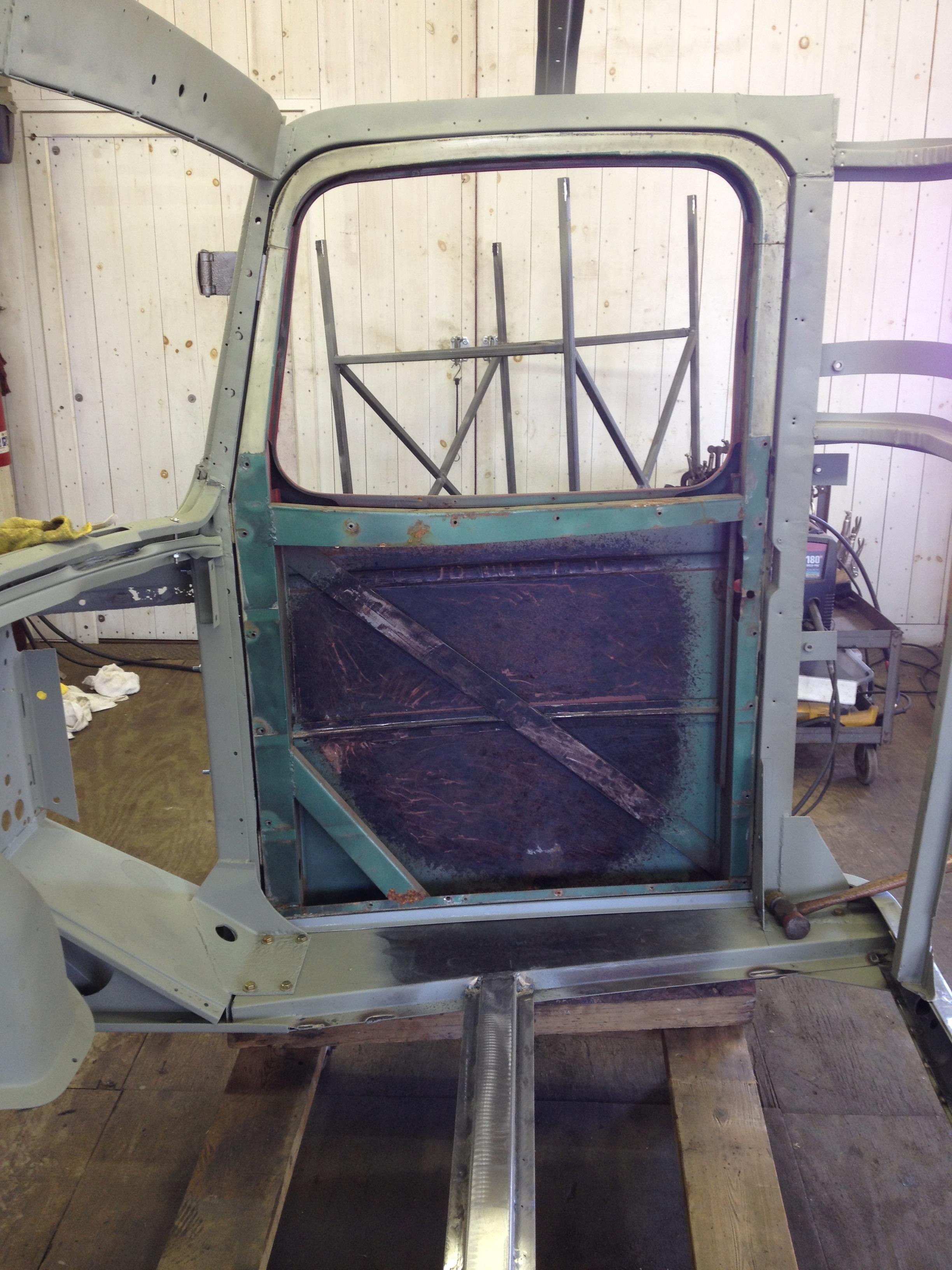

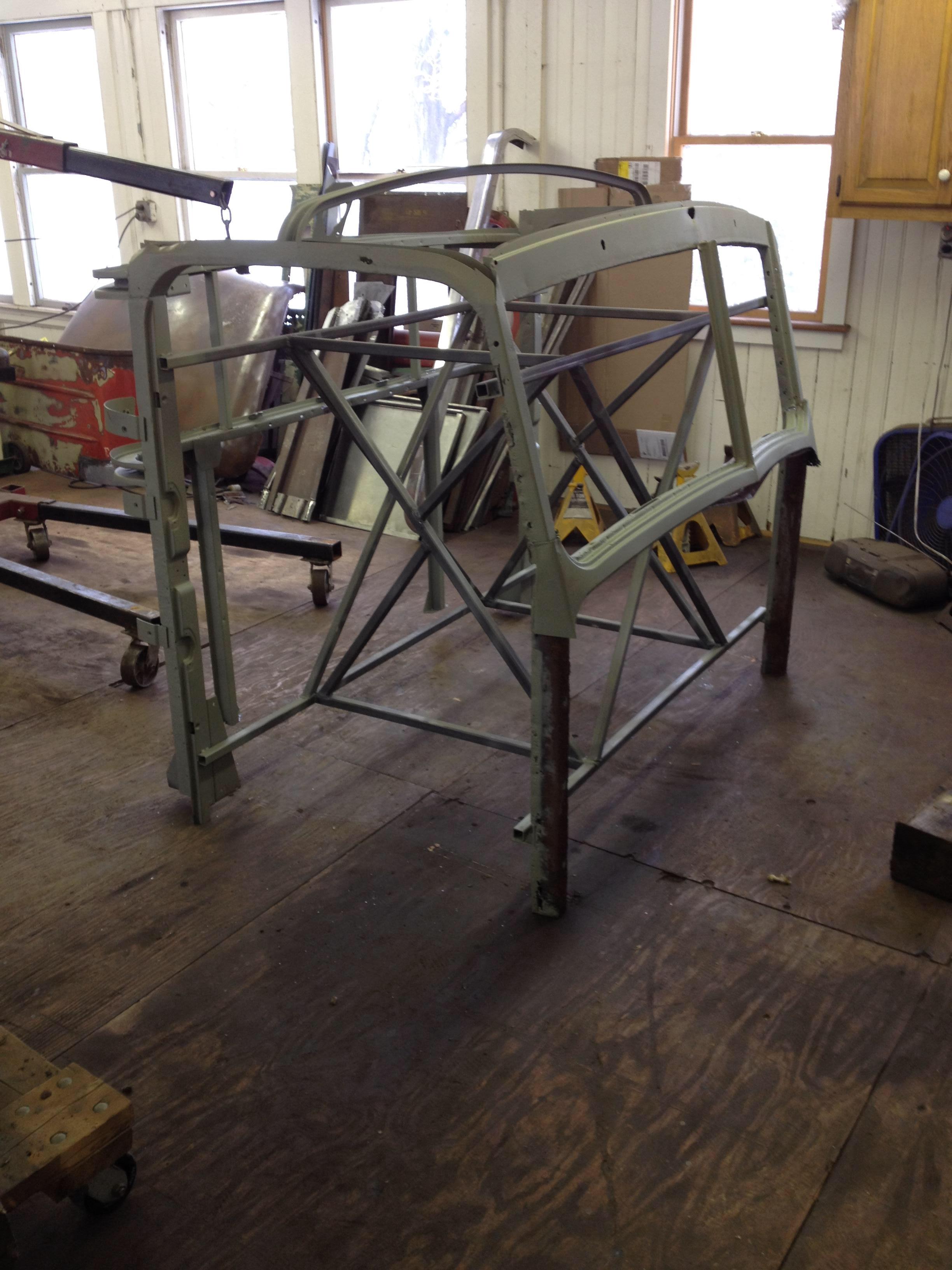

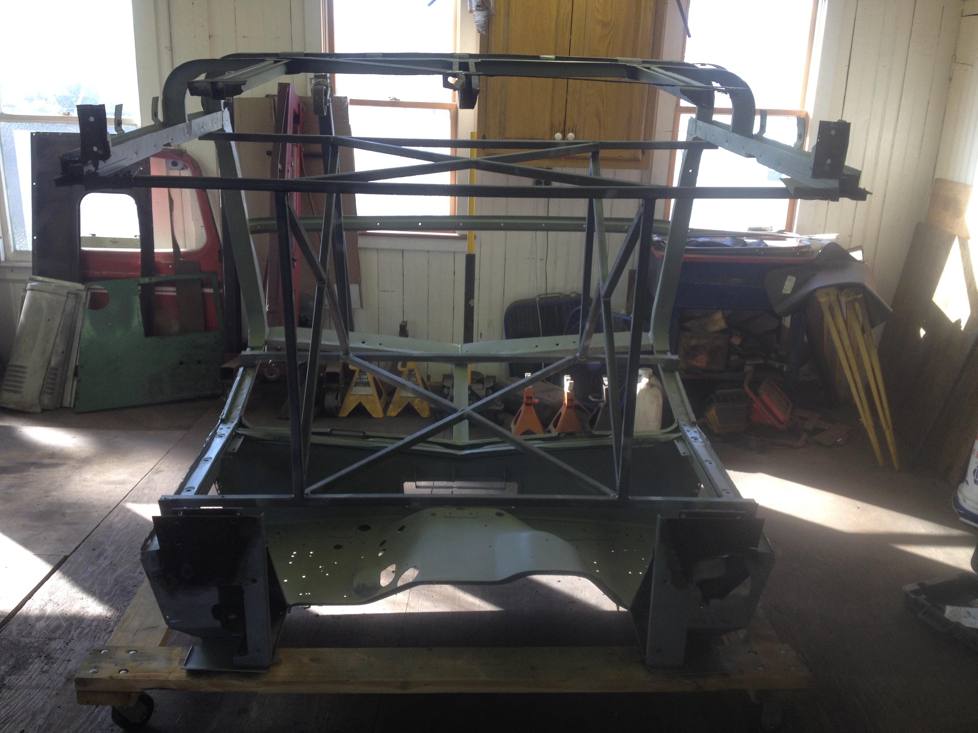

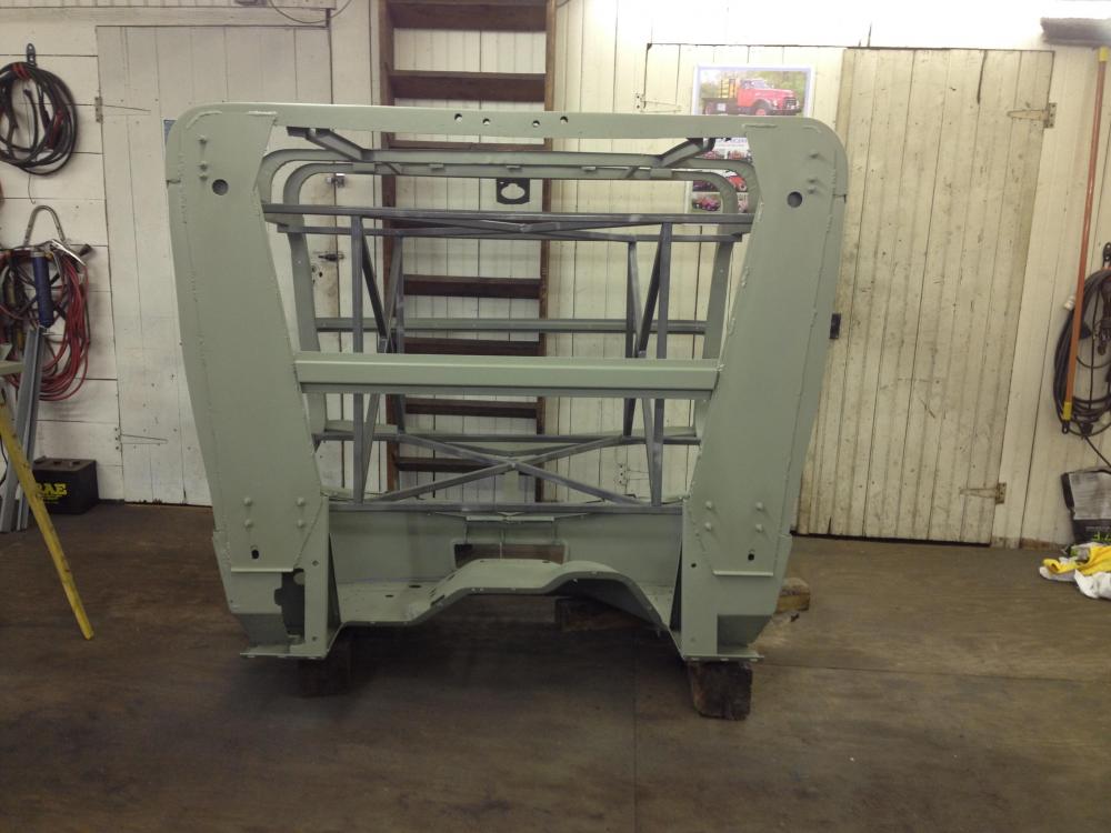

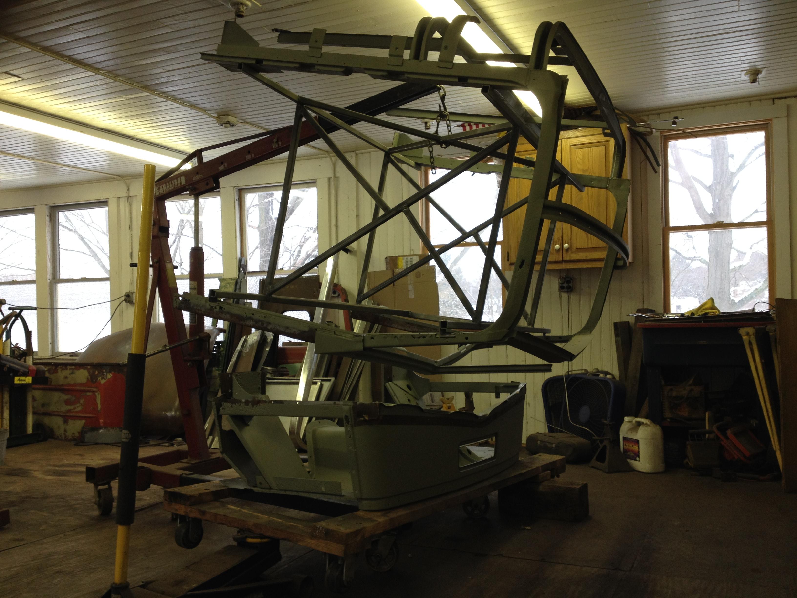

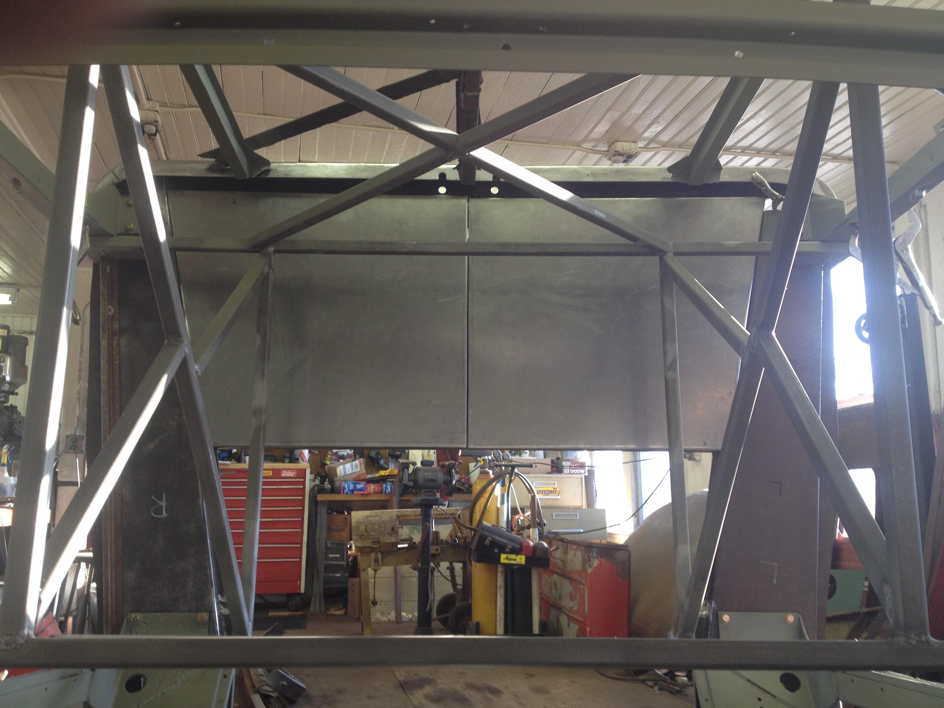

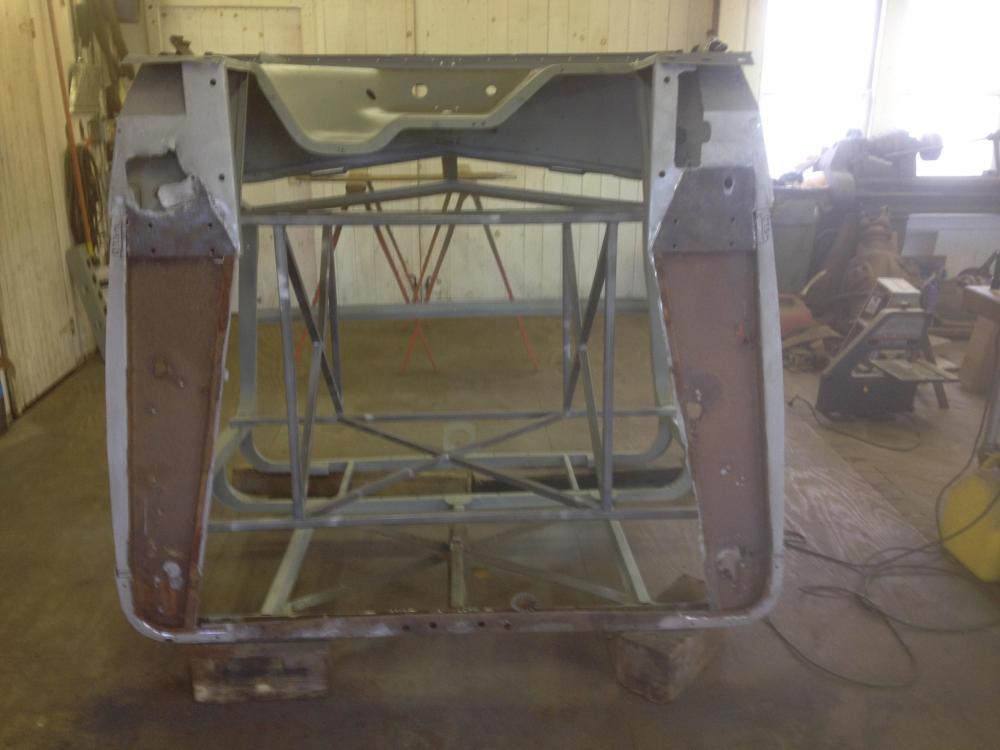

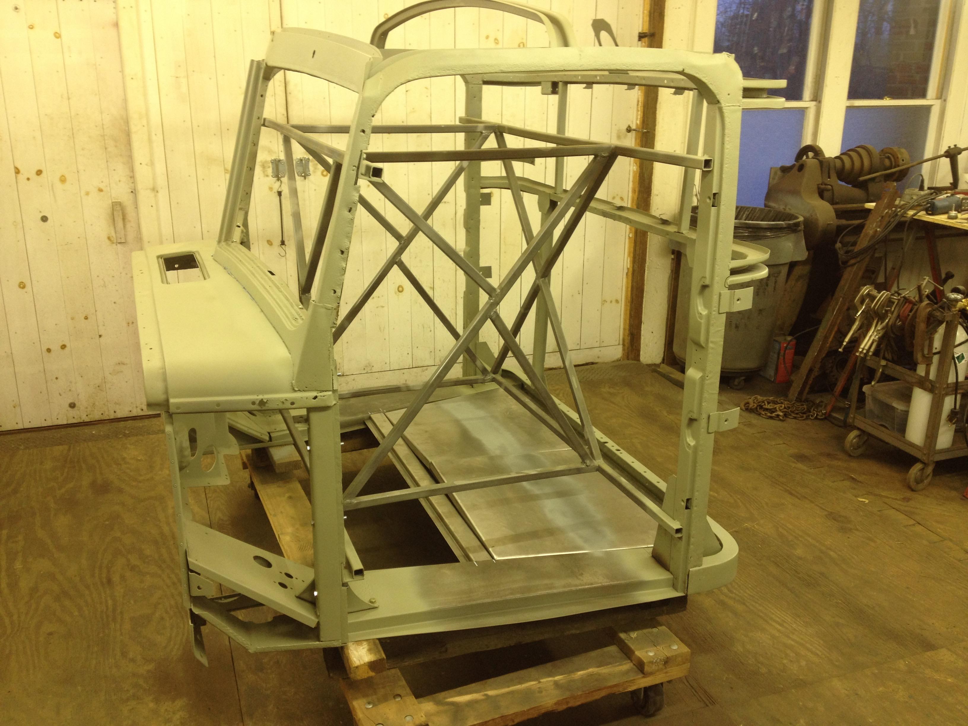

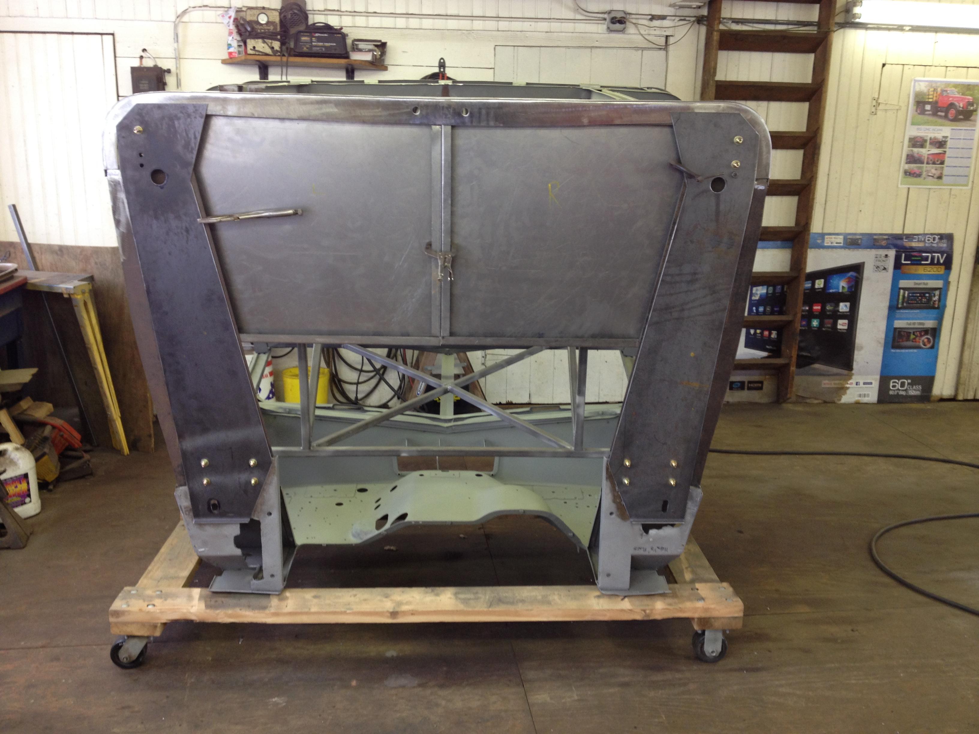

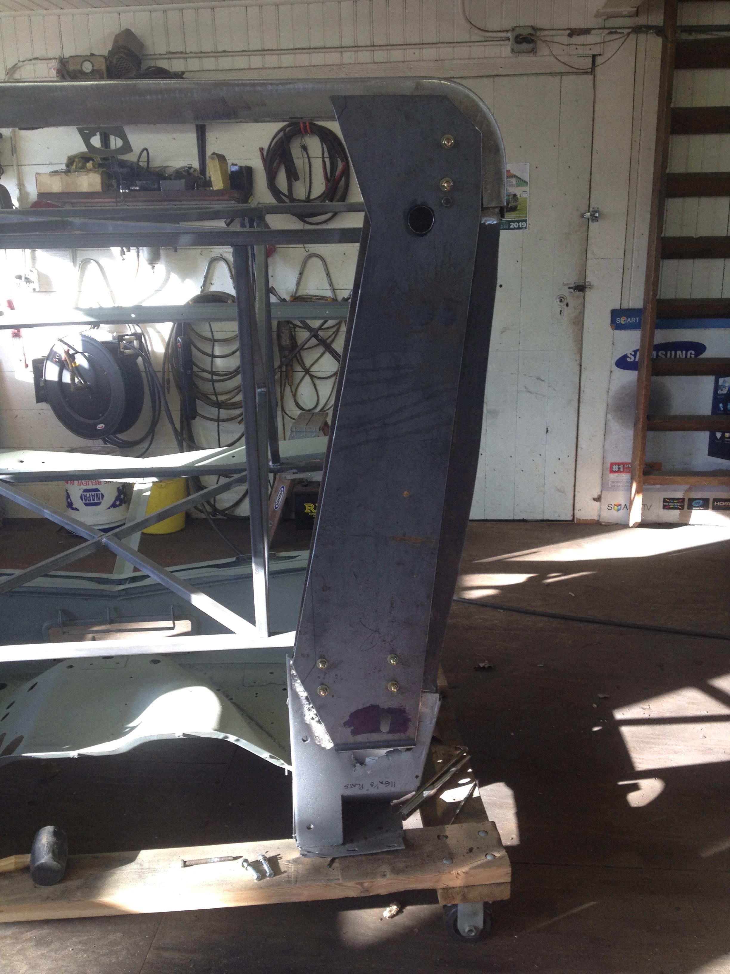

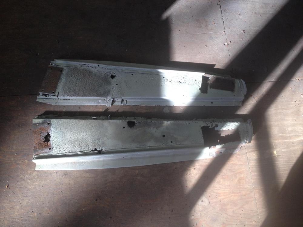

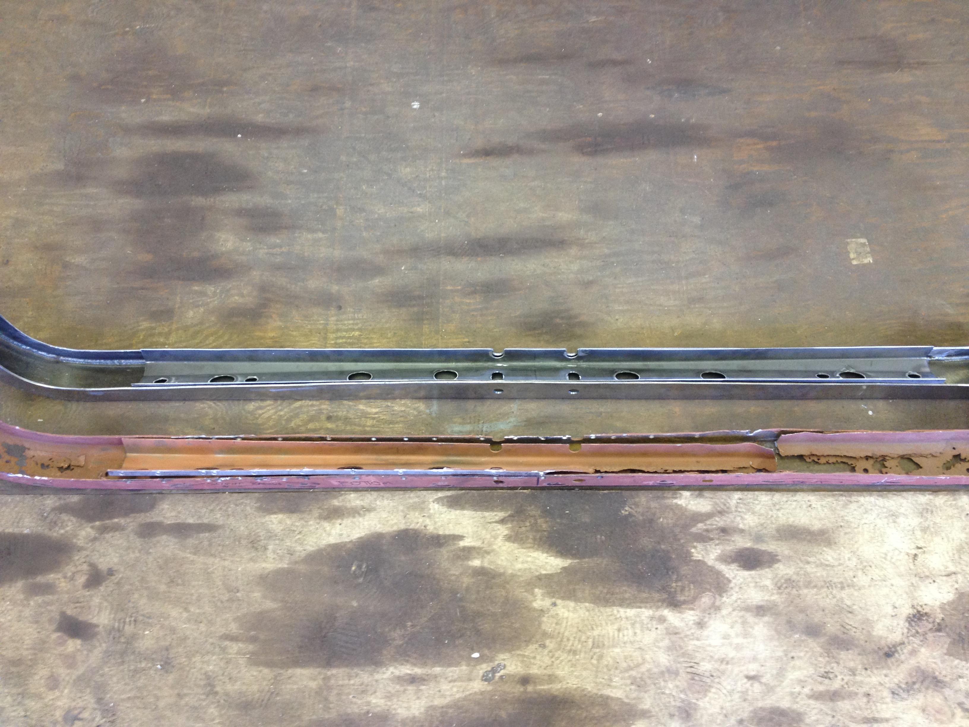

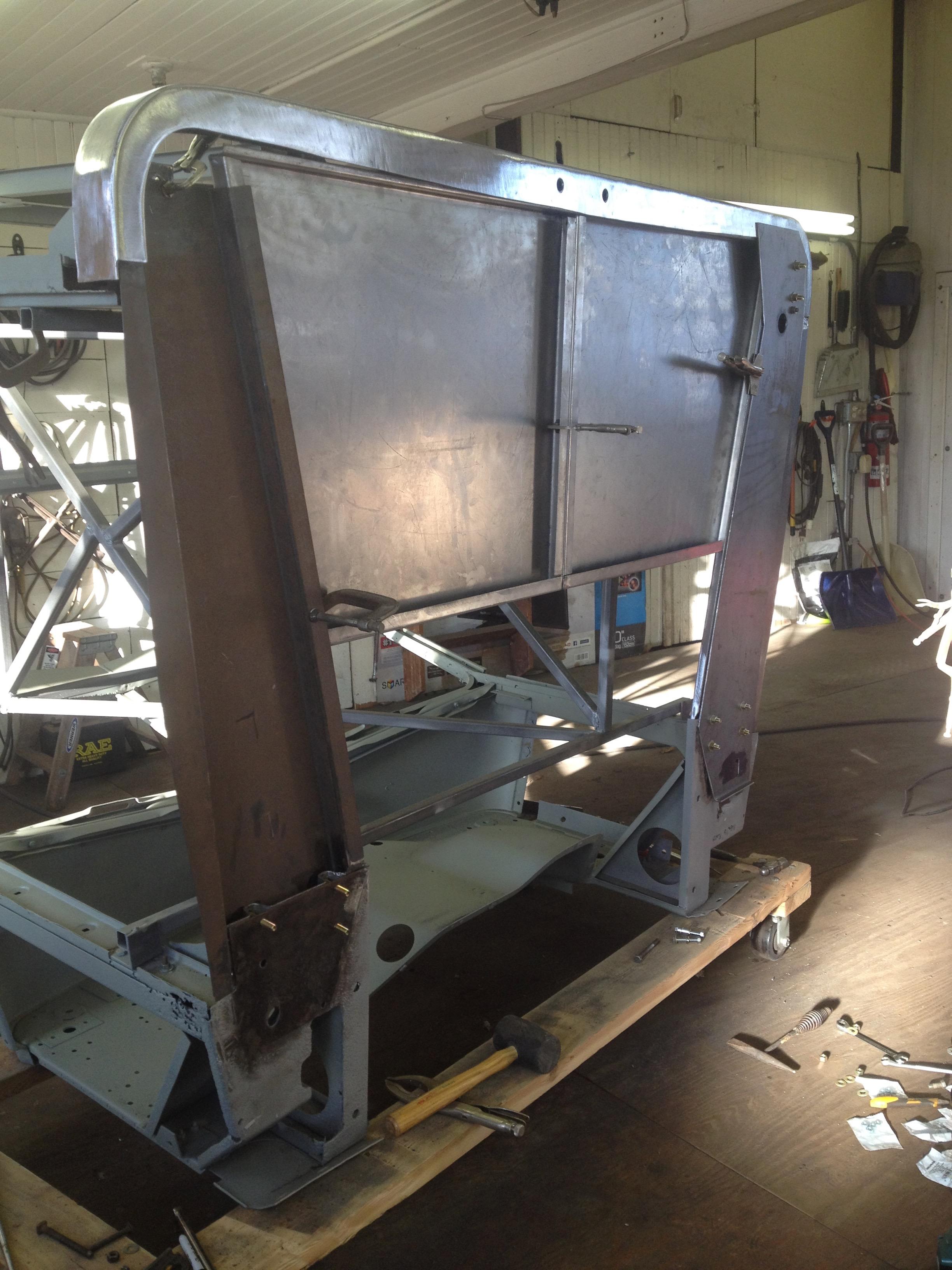

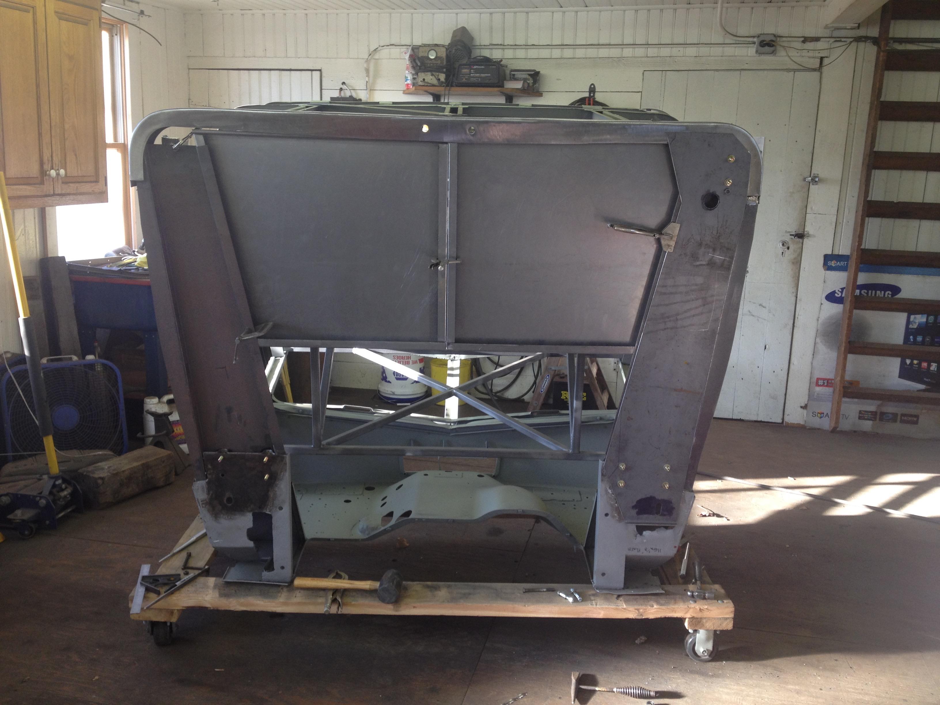

Final cutting today and the most serious. The cab is where I need it to start the repairs. Sills are carefully cut apart and completely removed. On to working on the new panels to fit and modify them. My framework seems to be doing it's job and nothing seems to have shifted. It'll be a while before I post so there's more significant progress to report.

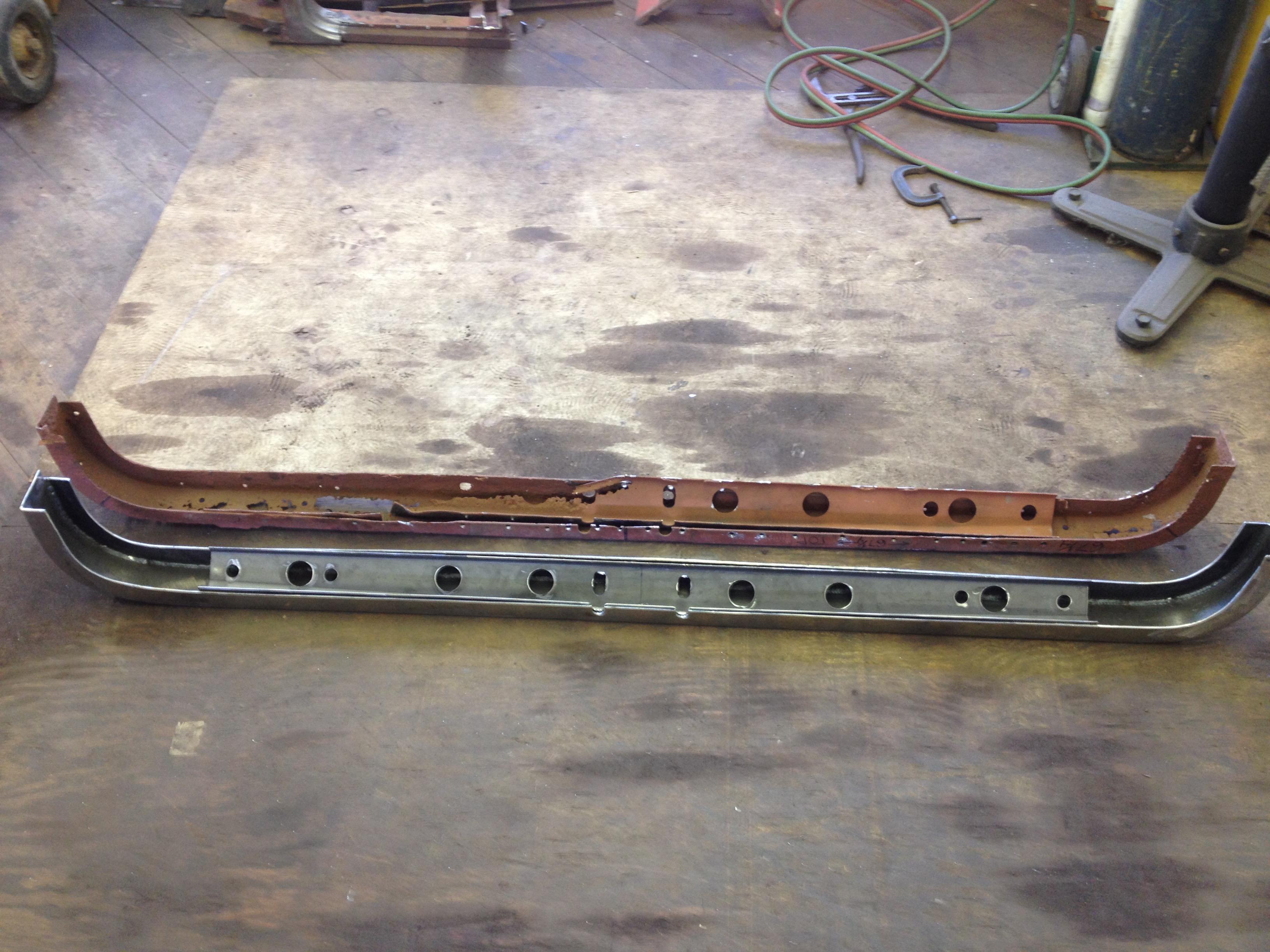

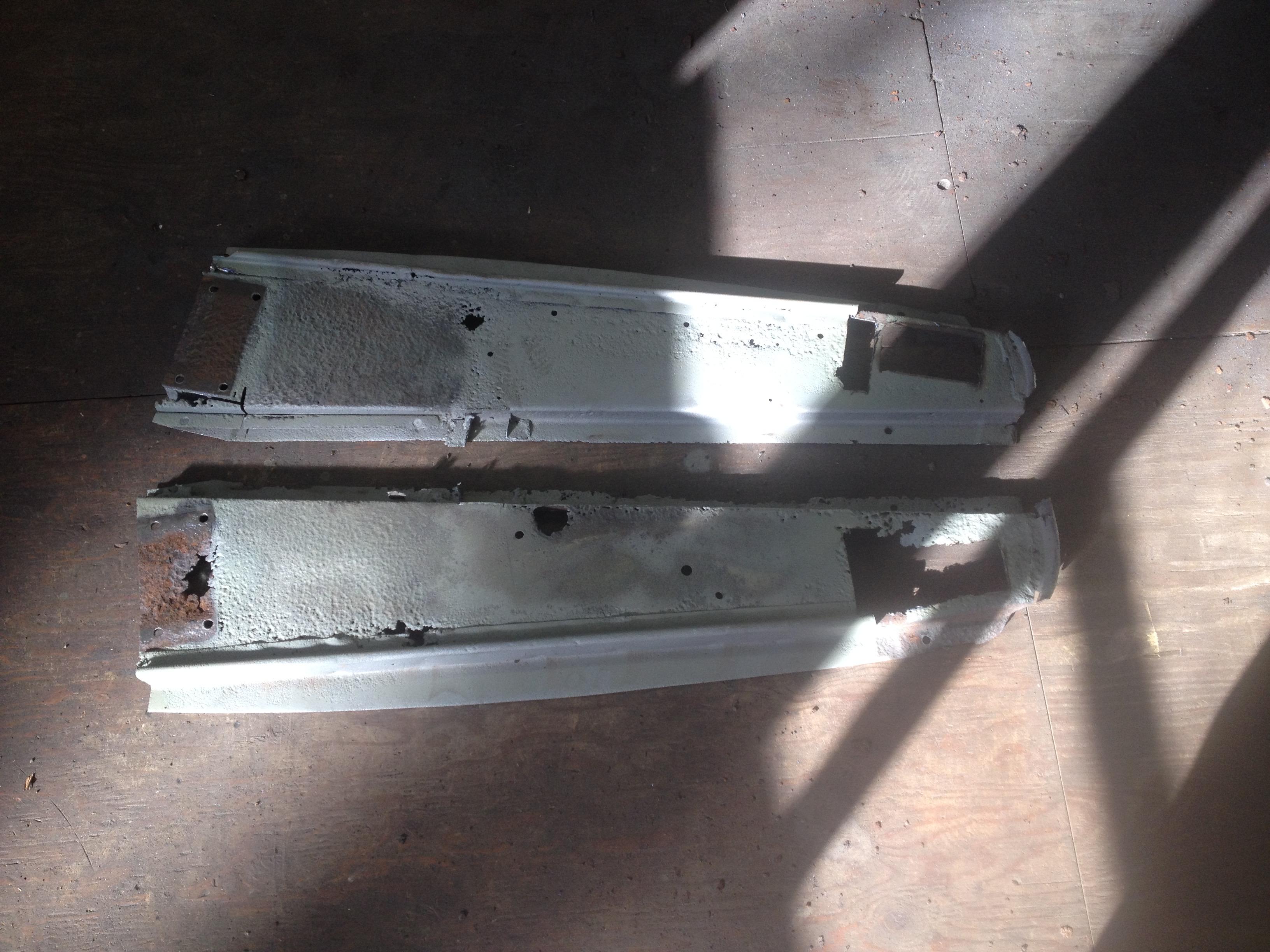

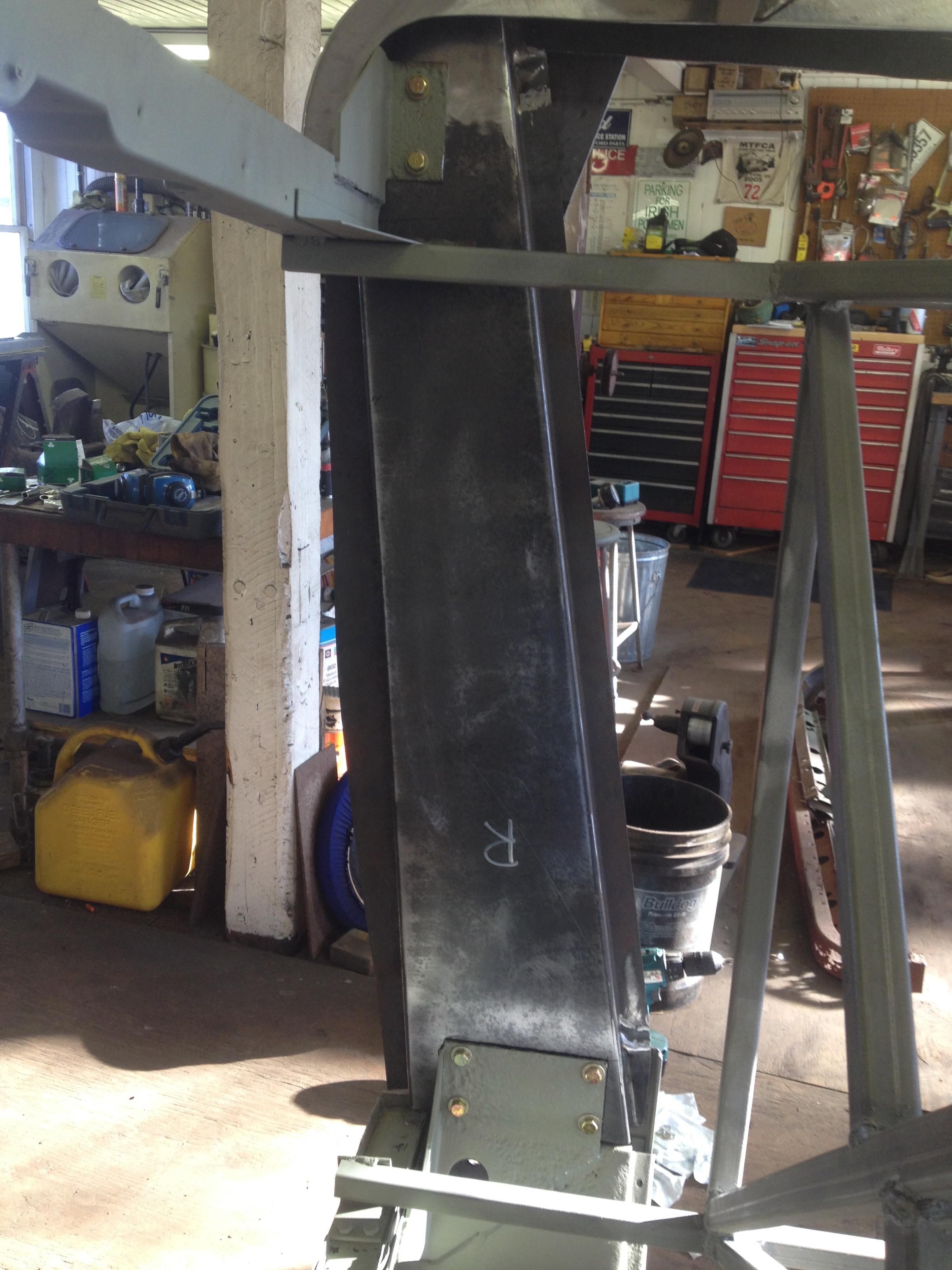

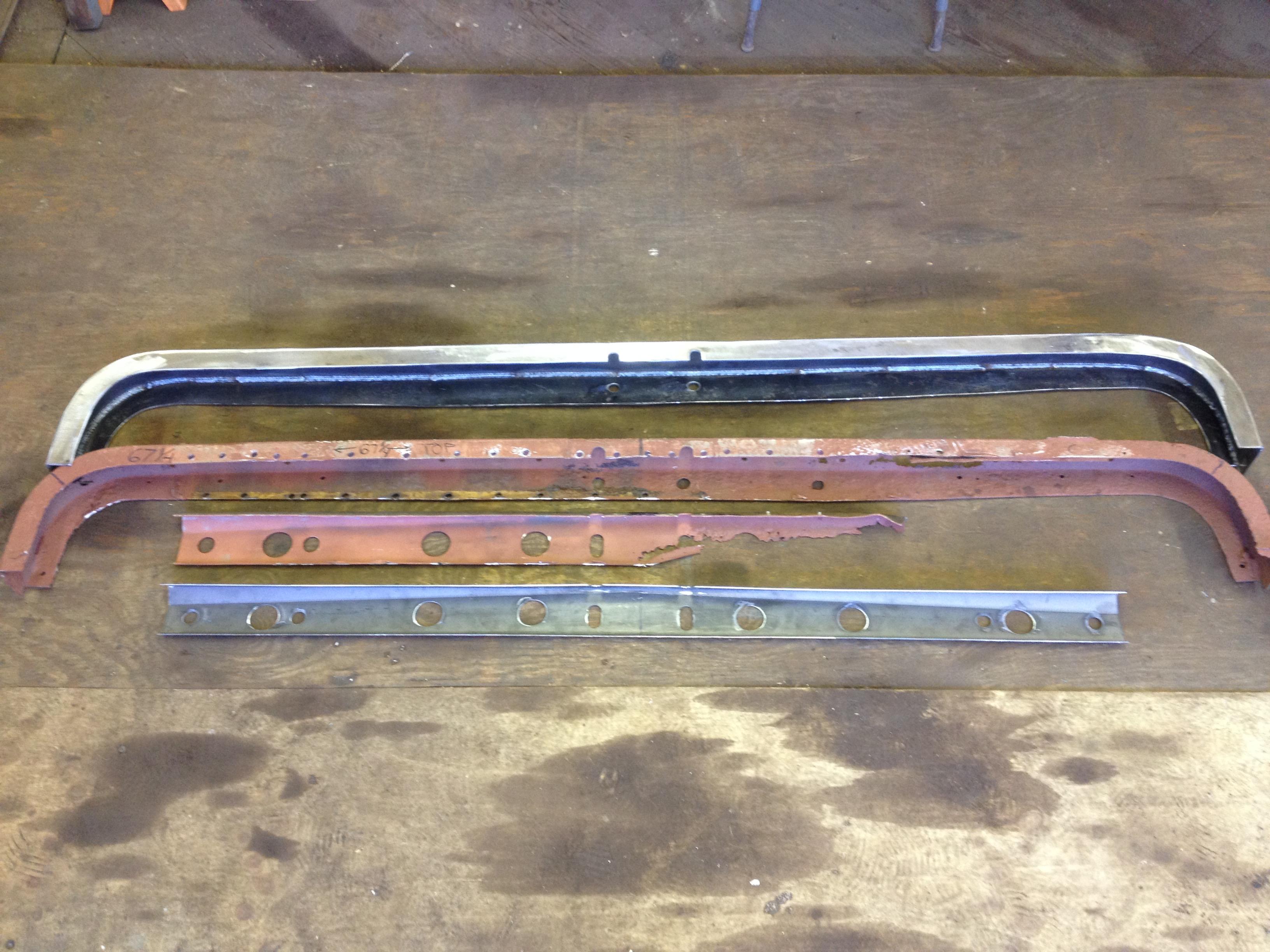

I'm sure you know what you do by my fingers will be kept crossed. What is the plan for that big 3" U-channel at the bottom of the back wall? Are you going to make a new one? Right at the moment I'm waiting for such part from fabrication but that one will be a straight piece. Hope to get it in the shape by cutting-welding-grinding. My new sills (or rockers?) are also in that order. At least I hope the shop folks will be able to bend what I have drawn :)

I had another fabricated locally from a donor I picked up and cut apart for a pattern. Mine was too far gone and broken from the accident. The fabricator did a great job, considering how complex it actually is.

Your fabricator made a great job! At least as long as I can see it on my screen. So far I haven't found a shop which could made such 3D curves. The most of them are newly organized small companies with laser cutters and straight bending presses. Good thing they do exist though.

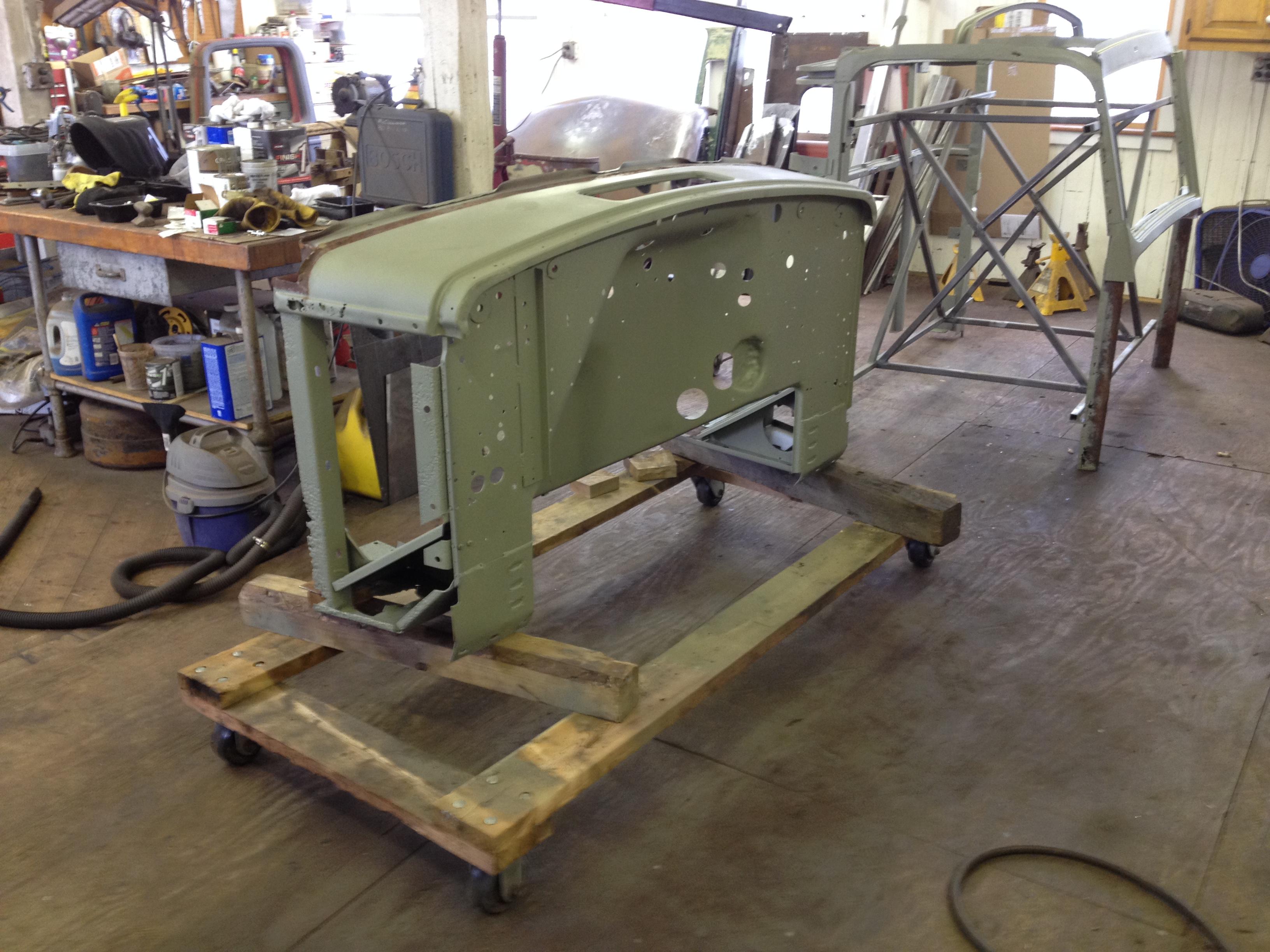

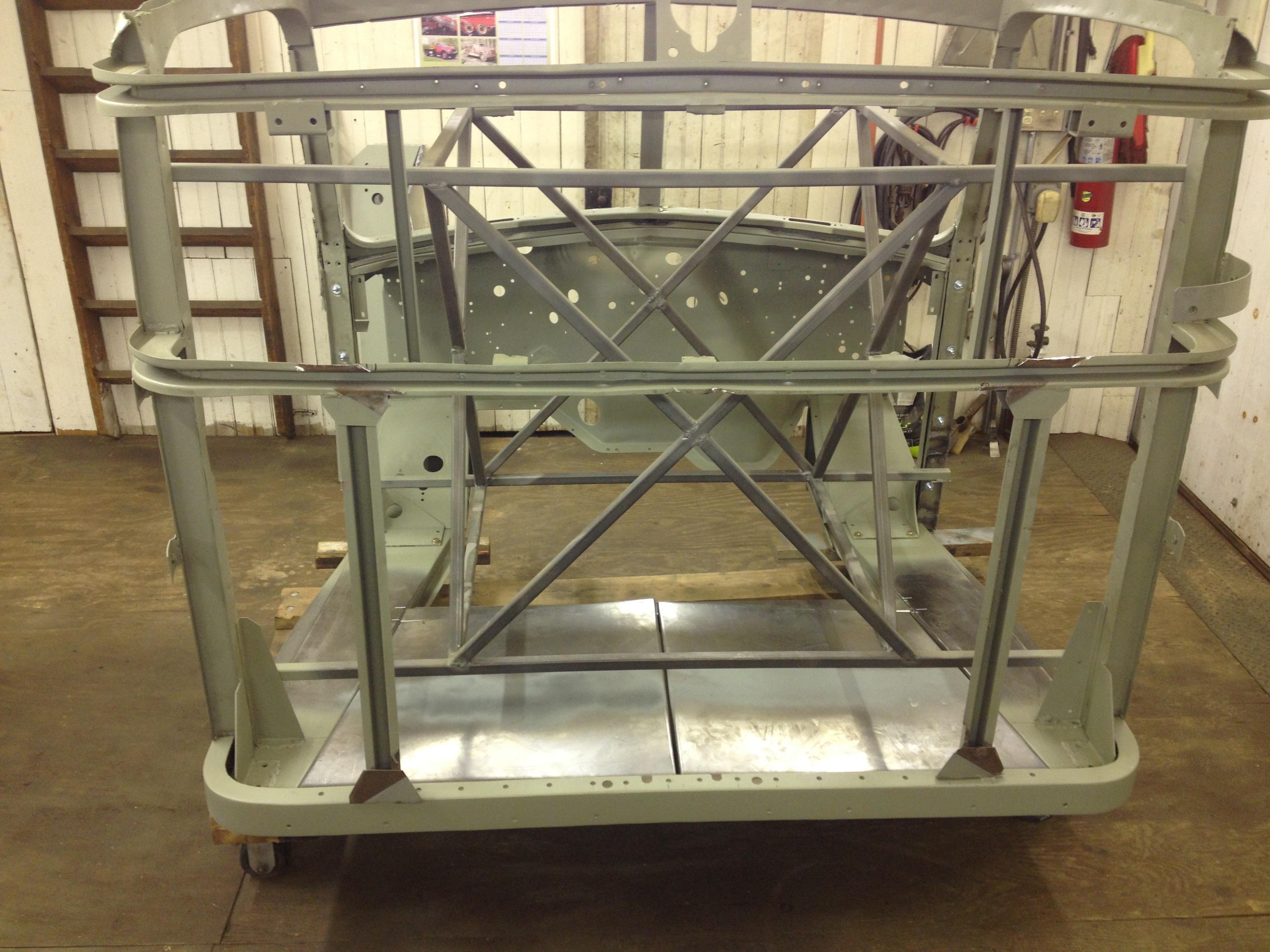

Lots of puzzle pieces but it sure looks like it is going to be better than new!!
I'm very optimistic about this. Alignment seems good and I keep using the old pieces to check. It'll all come apart again for finish work and heavy priming. I still have to attend to some issues with the lower A pillars.
