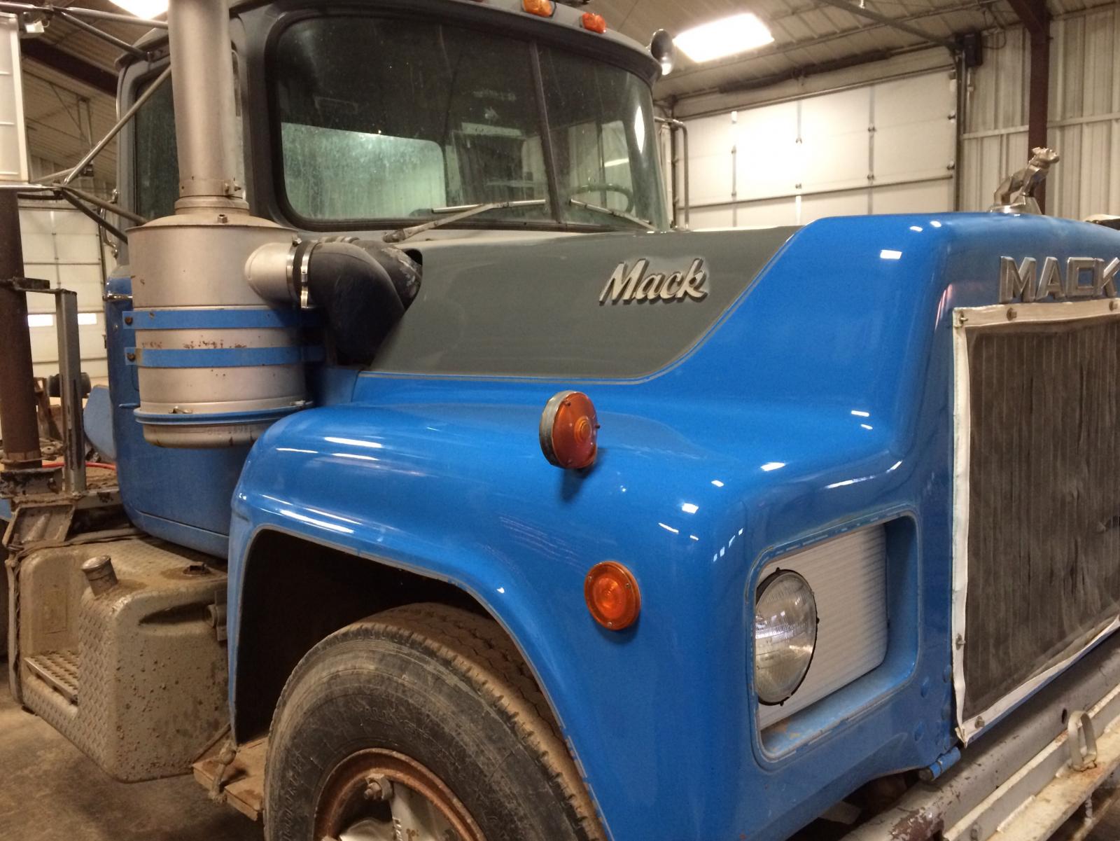

Blue truck looks good!
You might start doing work on your original truck and keep your eye for more parts during that.
It sure will take some while until you have the most of the chassis done.
Good luck on the project and welcome on here!

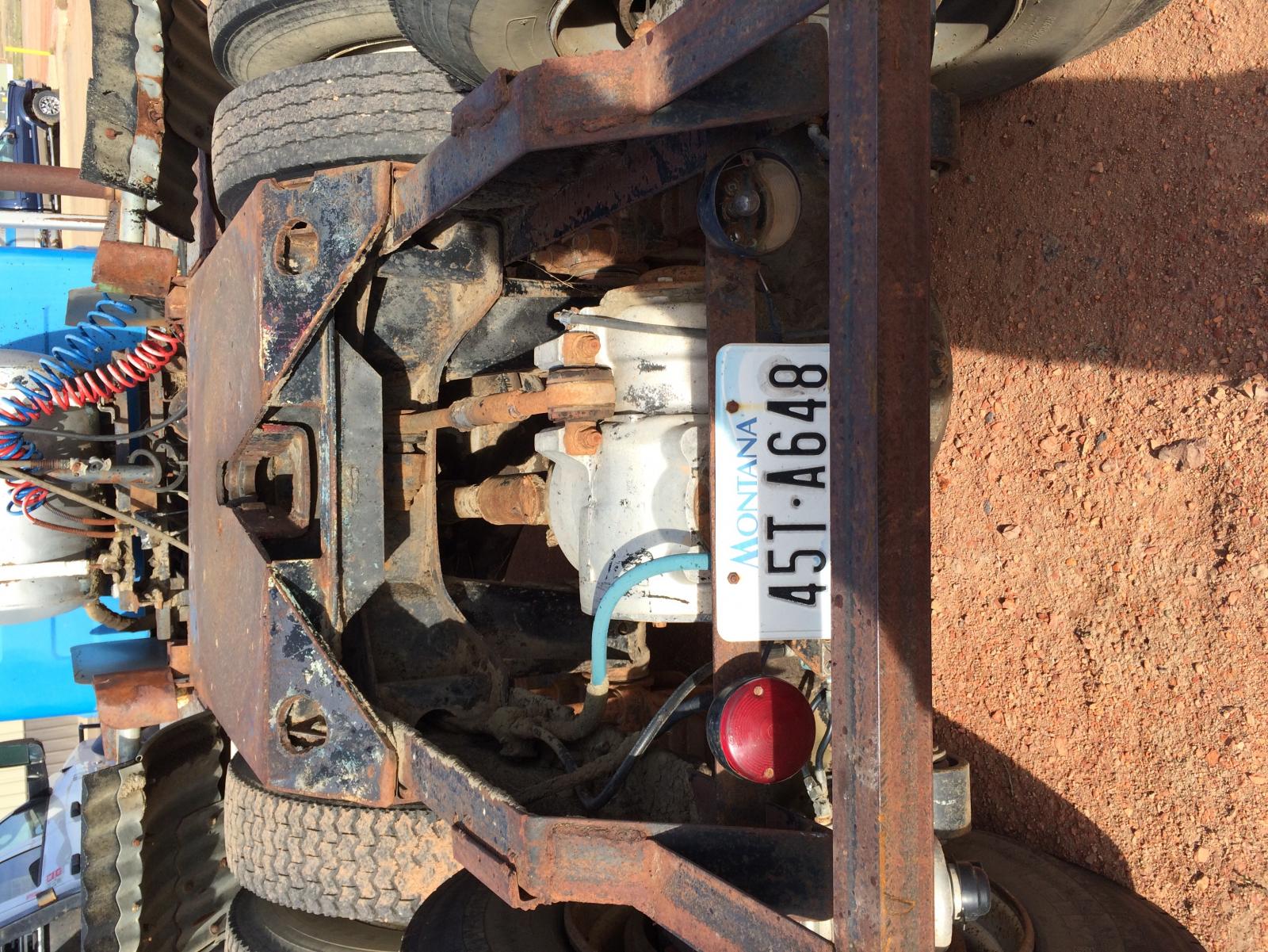

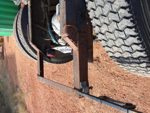

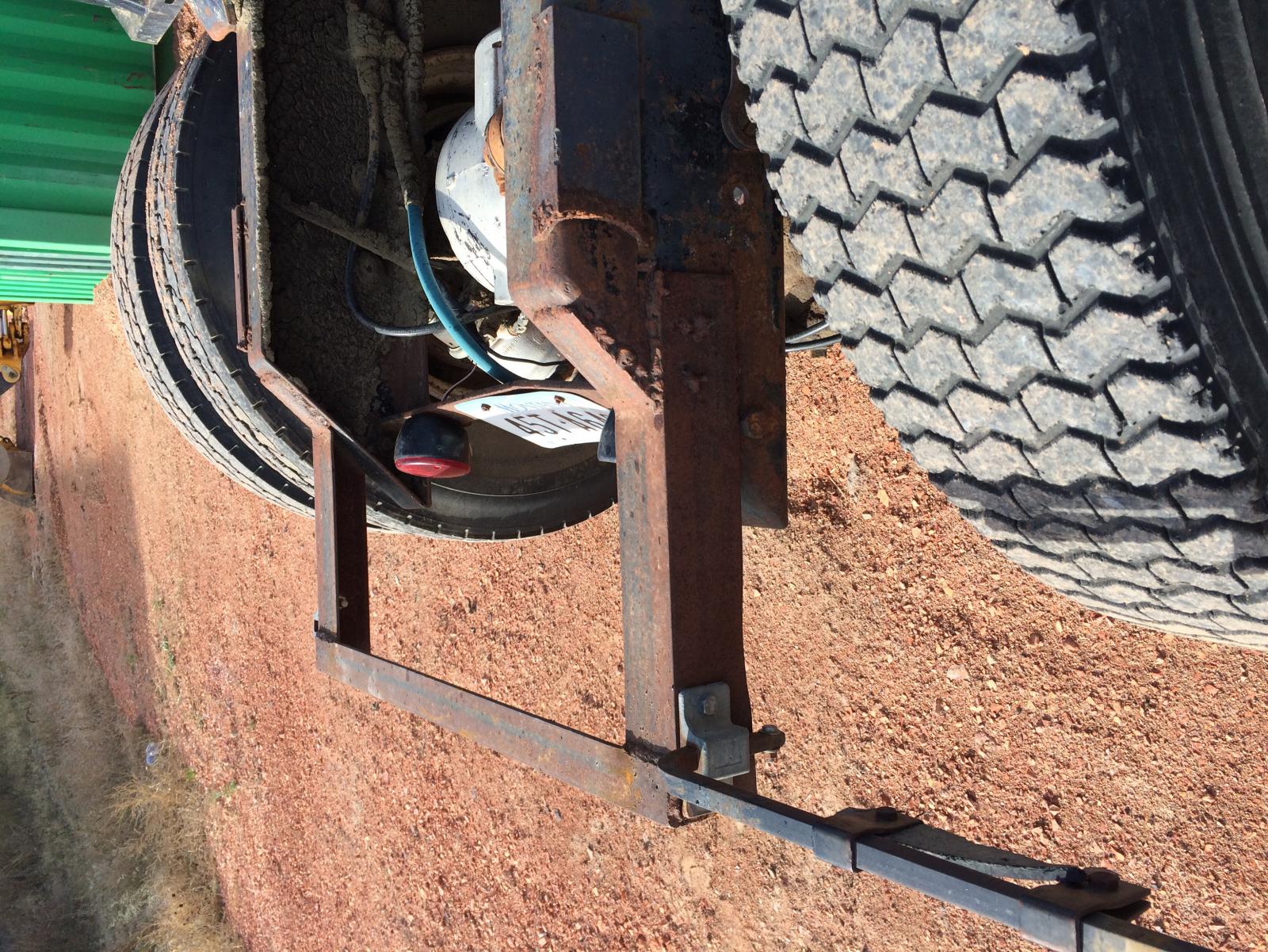

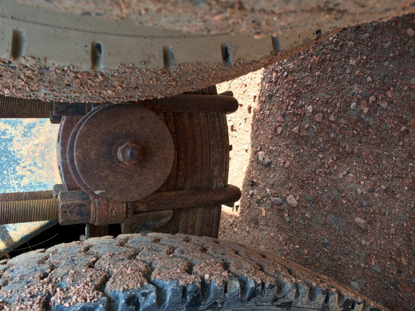

Here is a pic of the frame. Also what is the name of this style suspension? Also could anyone tell me how to tell what size axels these are?
Mack Inverted Camelback suspension. 34,000 lbs. rating.

34,000 is light but would be useful for a tractor doing strictly highway work. 38,000 or 44,000 on conventional camel back is more common than seeing 34 on an inverted spring. I don't have any information on one being better than the other but there may have been thinking that it could provide a smoother ride.
You could weld on new frame sections and add a cross member to your chassis. On a tractor, you are only holding up the tail lights. If you were going to make it into a dump truck, you would have do more extensive work for rail strength.

I need to do something with the frame I know it doesn't matter for anything other than appearance, but I just want it to look factory. Not farmer'd. The coupler is another story...😬

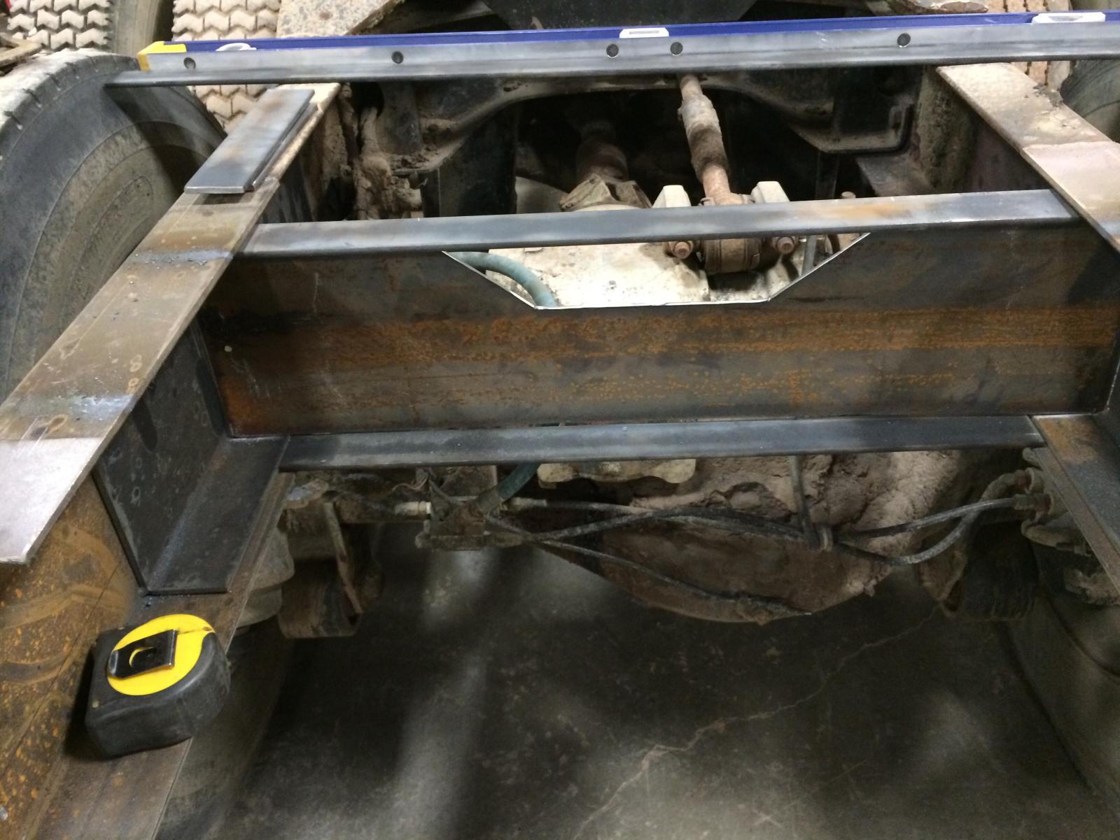

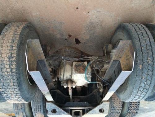

Thanks guys I had the steel shop form me some steel so I can add to the back of the frame at least enough to get mud guards back on the thing. As for the springs in the back it rides pretty dang smooth empty. Lol almost as smooth as air ride.

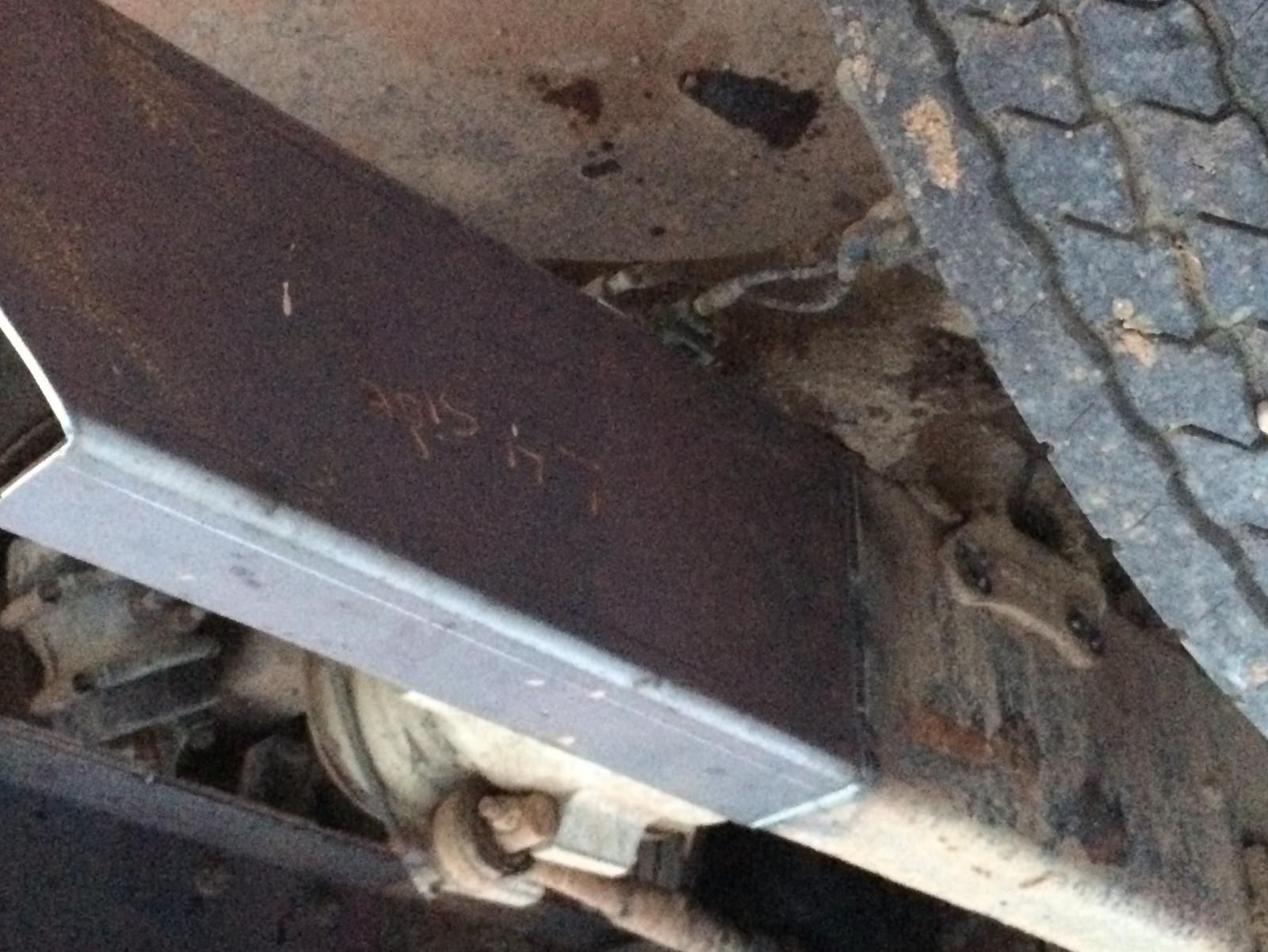

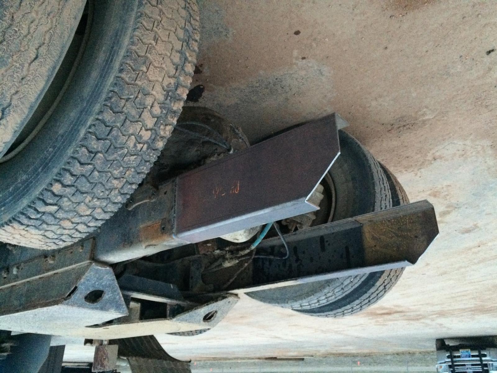

The old lady and I pulled the trick In and cut the frame and put the new 24" sections I had made. It's starting to look like its supposed to again. Sorry about the upside down pics. Posting from my phone and I can't seem to get them to flip.
