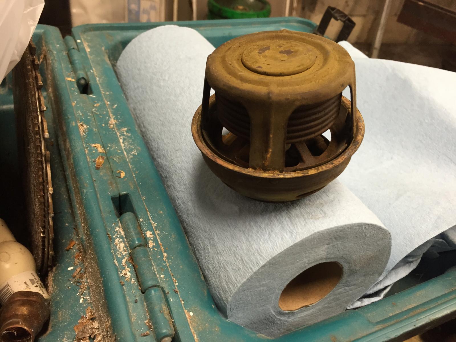

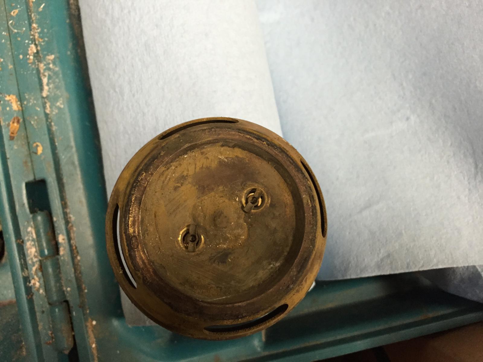

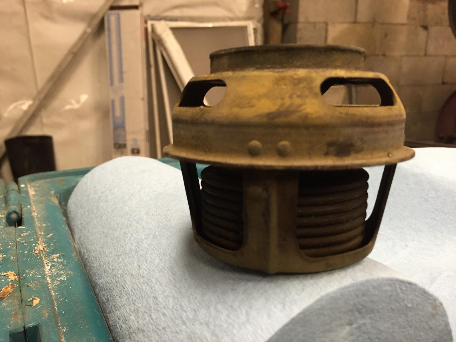

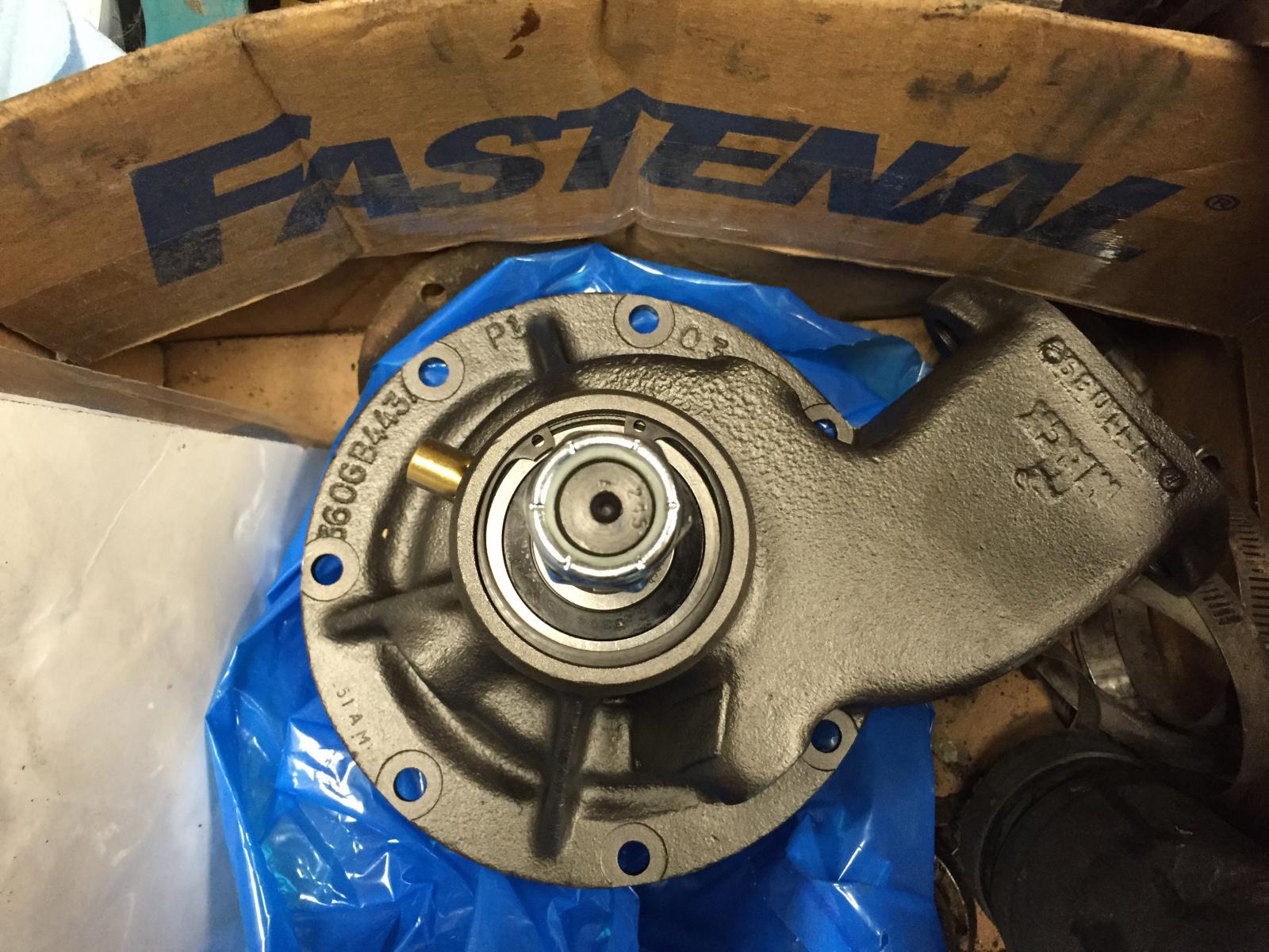

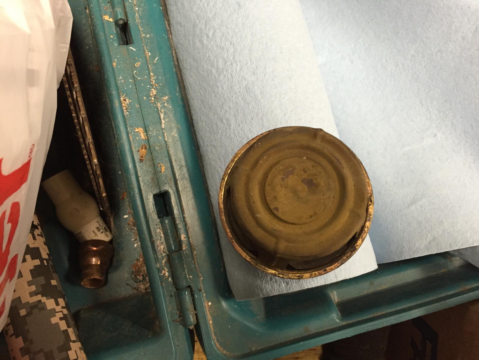

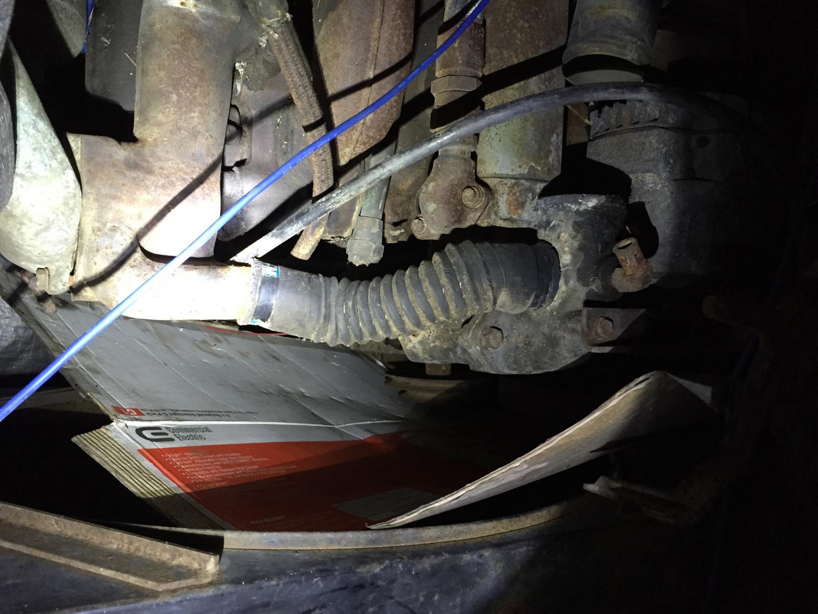

Replacing the water pump on my f model with a 237 . I pull the thermostat and head to Napa and all I get are blank stares back when they try looking it up in the books. There are no numbers on my old one to compare to. Can any of you guys recall what the part number I need is?
Also possibly a part number for this hose as I am pretty sure the universal hose that was on it isn't right.

https://www.bigmacktrucks.com/topic/41621-mack-thermostat-part-number/
Six Cylinder Pre ESI Mack Part numbers
215SB 164P1 155 degree
215SB 164P2 170 degree
215SB 164P3 180 degree
Six Cylinder ESI Extended Service
215SB 165P1 155
215SB 165P2 170
215SB 165P3 180
Don't have an OEM number for the hose.
Hose looks universal and NAPA should be able to help you. They may have to order from their warehouse if both ends aren't the same diameter.
Horrors... they might have to look in their hose and belt catalog.
Jim

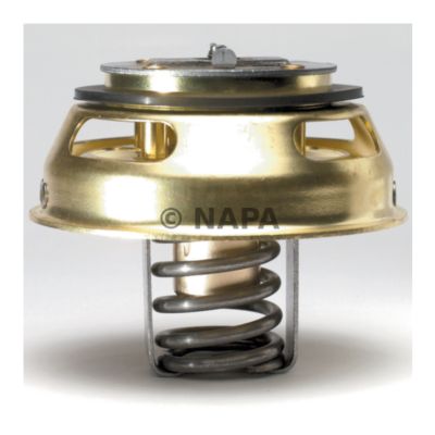

I have a Mack thermostat part #215 SB 164 AP3 in the box. It looks like the NAPA one pictured. I got it from Watt's for a 673 B Model and then found out my truck doesn't have a thermostat, just shutters. I can't find the invoice but will sell it cheap.
Expand
https://wattstruckcenter.com/shop/180-deg-thermostat
The small 's' shaped hose I just put on my b-model along with new water pump. Pai still carries the hose the part number on my receipt is Mac 8651......not sure if this is company's or pai's part number......also if anybody needs water pump pai also carries NEW not rebuilt water pumps........Bobby j.
