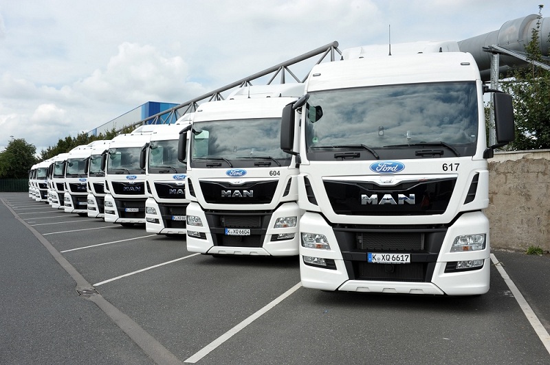

Ford Motor Company has put 58 new MAN TGX 18.400 Ultra tractor units into service.
The new trucks will be used in the vehicle manufacturer's production logistics unit.
The particularly low height of these semi-trailer combinations with full air suspension is worthy of mention: The low fifth wheel height in combination with specialized trailers allows for three pallet cages to be stacked vertically for greater transport efficiency, while at the same time remaining in compliance with the statutory height limit of 4.00 metres.
Typically, an internal height of 3.00 metres is required in the automotive industry. This height is taken from the material being transported - either stacked pallet cages or transport racks, produced at this height, for engines or vehicle body parts.
MAN offers a special range of Ultra tractor units for this purpose. The new and particularly 315/45R22.5 drive axle tyres enable a fifth wheel height of 920 mm to be achieved. A special air suspension function ensures that the truck-trailer combination does not exceed the 4.00 metre mark, even when unloaded and with tyres under fully extended suspension: the truck is able to lower the driving height by approx. 20 mm when unloaded.
