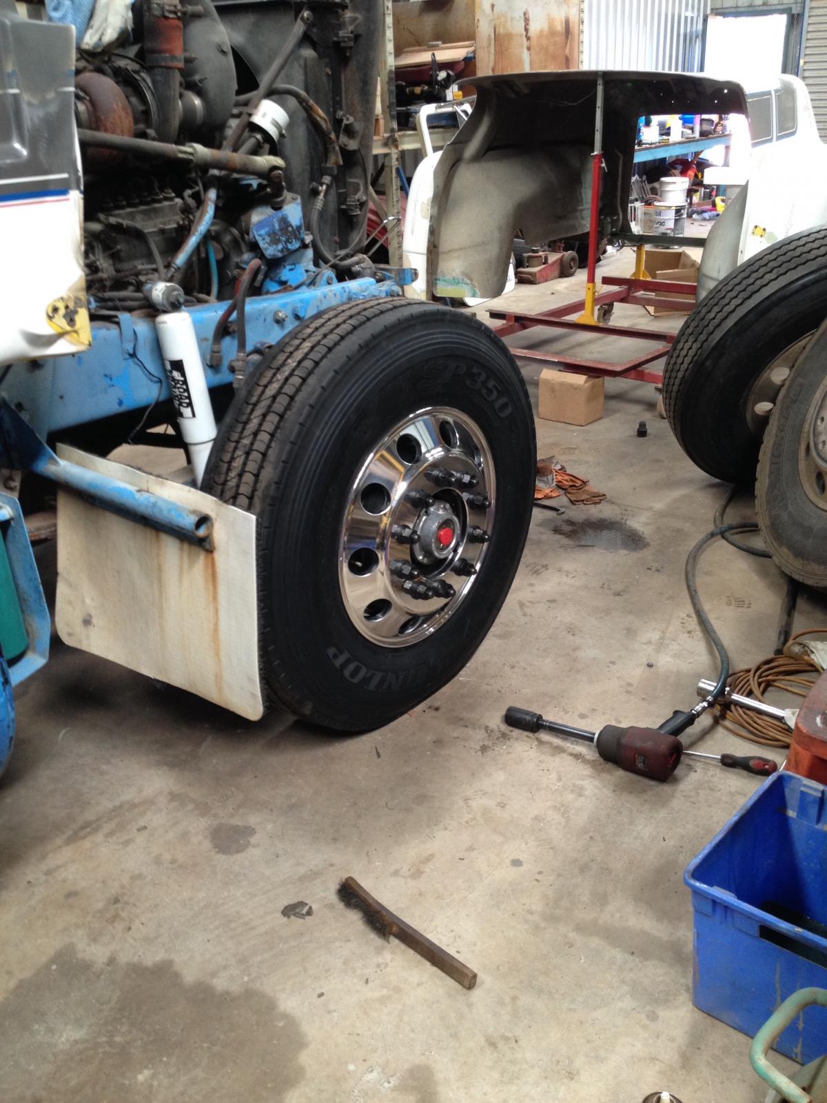

Got my new Accuride wheels out of the box and put some dunlops on them and thought id show you guys how it looks. Put some ceramic balancing beads in to test out.

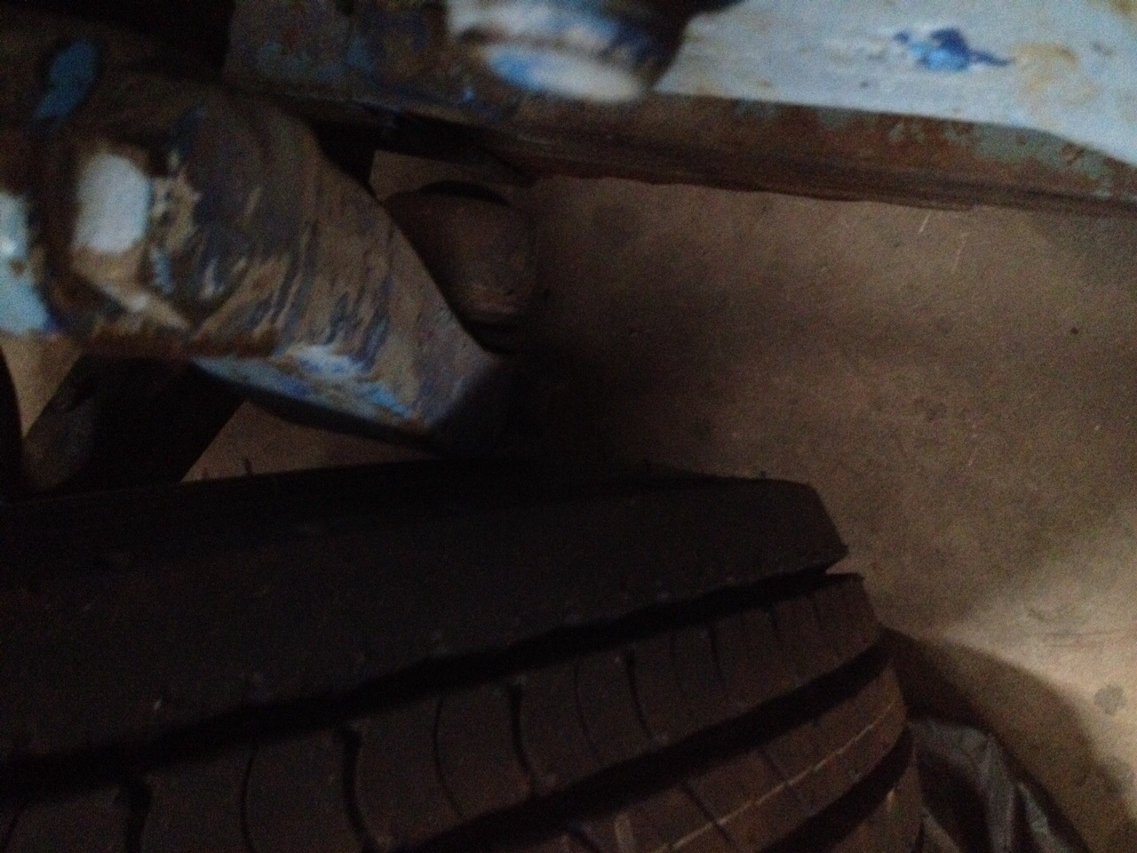

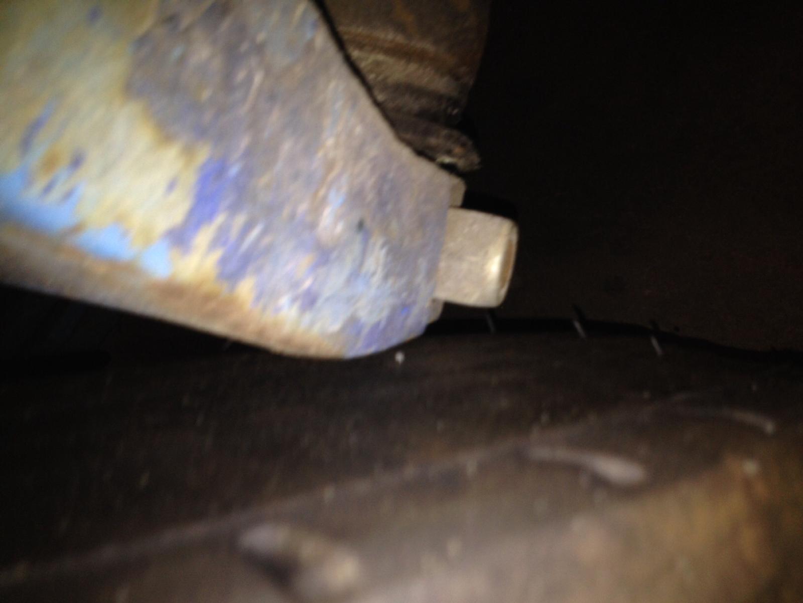

So after mucking around some more I decided to start the old girl and check the clearance when I turn the wheels full lock. Tyre hits the steering arm on the steering box.
post-14557-0-87930600-1446853955_thumb.j
post-14557-0-51995400-1446854078_thumb.j
I know I can adjust the steering so it stops just short of it, but it's hitting with a 10mm spacer behind the rims and with skinny tyres on it. I'd have to adjust it a lot! So I'm at peace with it now, I tried but it didn't work for me. Putting my wobbly wheels back on it.

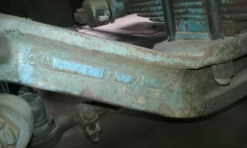

ten studs on a r model WTF are you thinking Timmy !!!!!!. mate this oz we run spider wheels NOT those poofy wheels ,leave them for Volvo and kenworth steering wheel attendants. 9" off sets if you have to have ten studs, knock your steering arms out off the stub axles flip left to right so your steering arms face up not down, we used to do that trick to stop the track rod being bent in boggy ground .what front axle have you got? FA536 FA537 FA538 or FA538C
