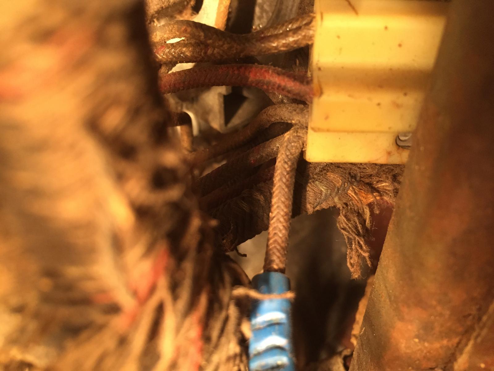

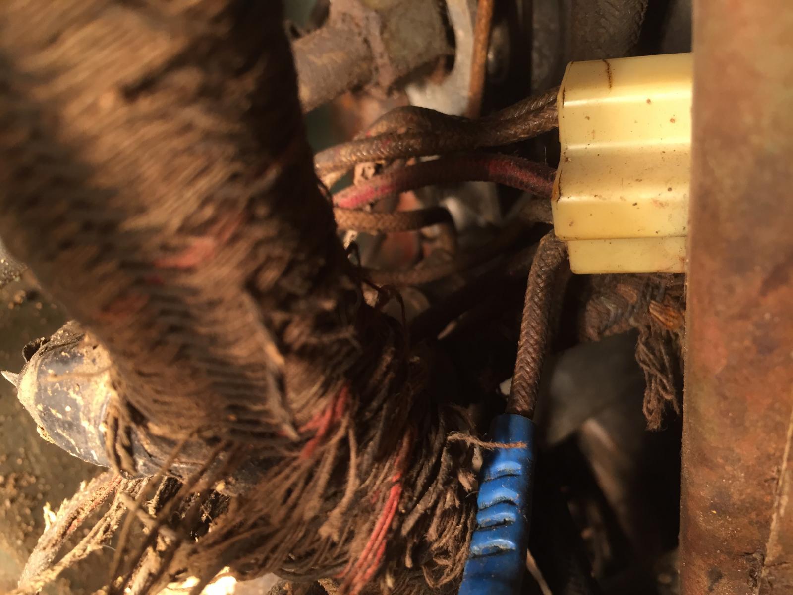

The silly thing is real hard to see and I have the damn thing in the driveway! That harness is wedged up under that dash and I'm afraid the wire burnt inside the loom. Just looking to see if anyone could tell me what color the wires are and if they ran through a breaker or relay between the switch and shutdown.
I'm afraind that I am going to have to start at the junction block behind the left headlight and cut the loom apart the whole way untill I find the crispy.

you mite get lucky,,,and spot something right away,,,i would start by looking at everywhere wires connect to under dash,engine trans rearend abs ,exc,,and feel each connection with key in on position..should be able to spot it somewhere without breaking it open good luck...bob

the worst part of this this is everything is so jammed up in there that I started asking questions before going hog wild. I will have to do some removing af dash panels just so I can get a good look at all the spots you mention.
68-f
On this one the wire that comes off the junction block and goes up through the door post appears to be light blue. No other colors but there is no light blue on the keyswitch. Is yours the same and what colors do you have on your keyswitch?

yep Light blue is what I have also heading up the door post. That is one start for me.
My problem is that I do think it is only one wire but I do not know if it burned up other wires in the harness. None of those gremlins have shown up yet. The wiring diagram has now shown me where the other end of the wire actually is wich I had no idea. Just one big bowl of spaghetti under that dash.
