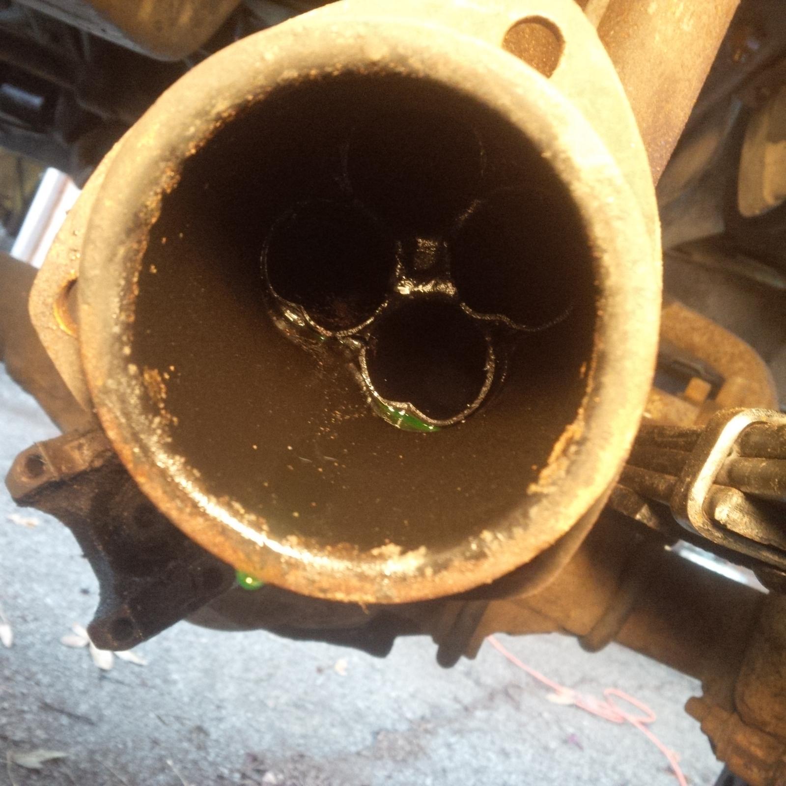

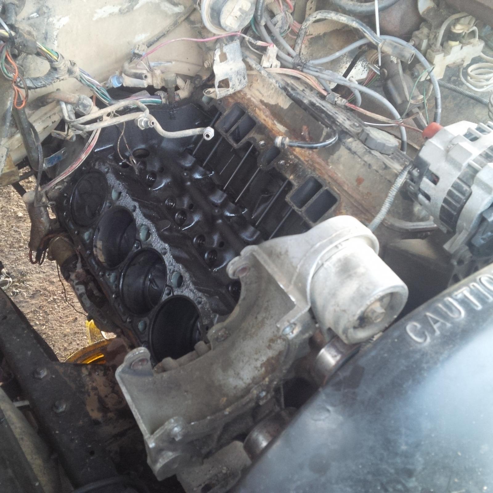

Looks like I get to pull a head off to see if it's cracked or just a head gasket. :pat:
Well, after tossing around the idea of dumping a bottle of that head gasket/block repair crap into the radiator, I decided to do the job right. Didn't SEE any cracks, but don't have time to have it checked...so, new head will be here tomorrow to put on. Hoping that by the time I go to bed tonight, all that'll be left to do is splice in the controller and put the motor back together. We need it running by Friday morning.

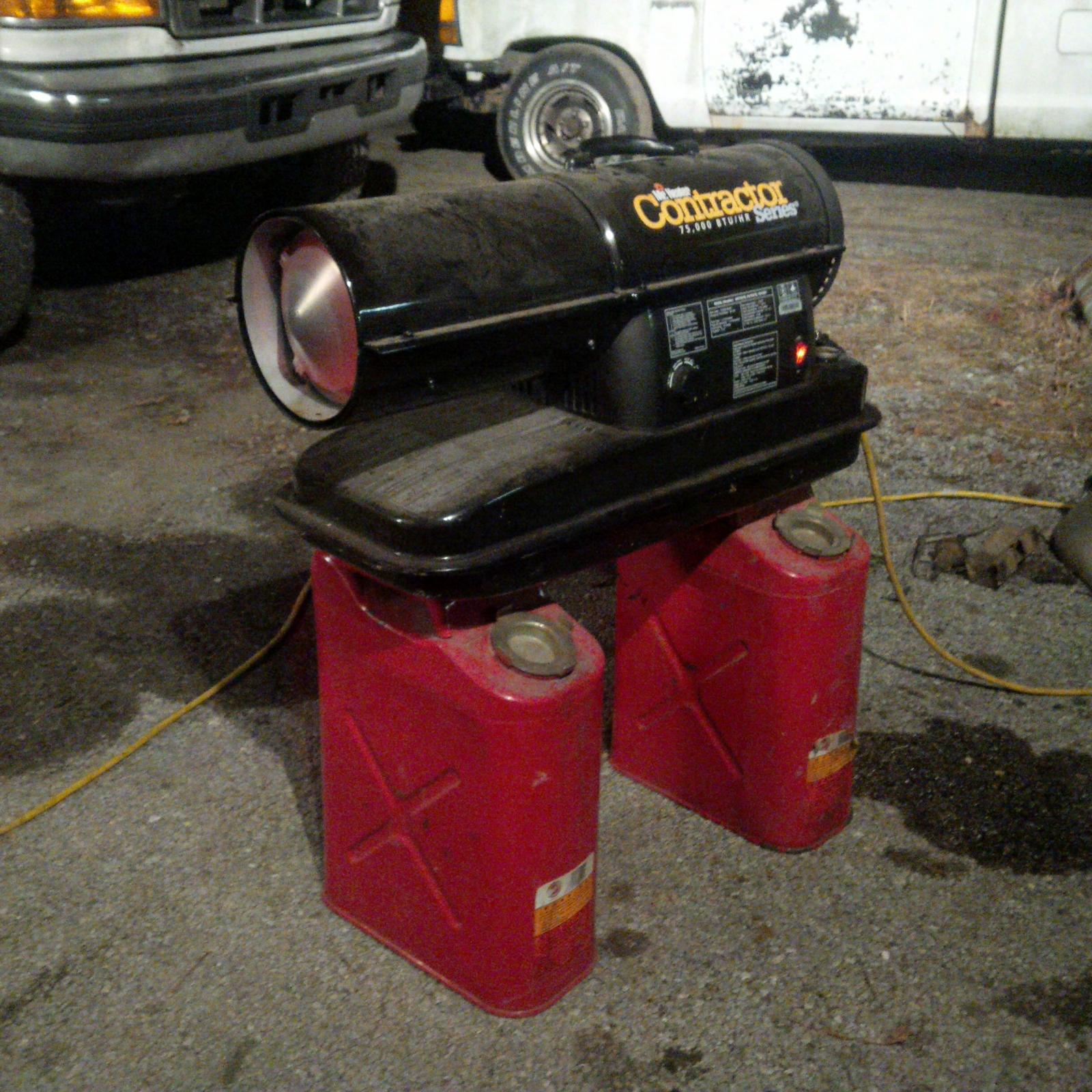

Well, I had it to the point I'd hoped before I went to bed...at 7 AM. Woke up @ 10 and got back to work...sleep is overrated. New head arrived today and it's going back together like a 1,000,000 piece jigsaw puzzle. Ought to get 'er put together and the valves adjusted tonight, though...but it's shaping up to be a COLD SOB tonight. Got m. Have to wait 'til tomorrow to fire it up & make sure I got the distributor in right...should be pretty damn close. Change the oil, splice in the controller, and bolt the exhaust back up and she's done...HOPEFULLY...ain't put it under there yet to see if that needs to be stretched an inch or two. Should probably do that before I run to town for a new rotor (wrench slipped...which is why it won't be fired up tonight). Oh well. Wouldn't be a project without setbacks. By the way, the wife was giving me a hard time about my heater...

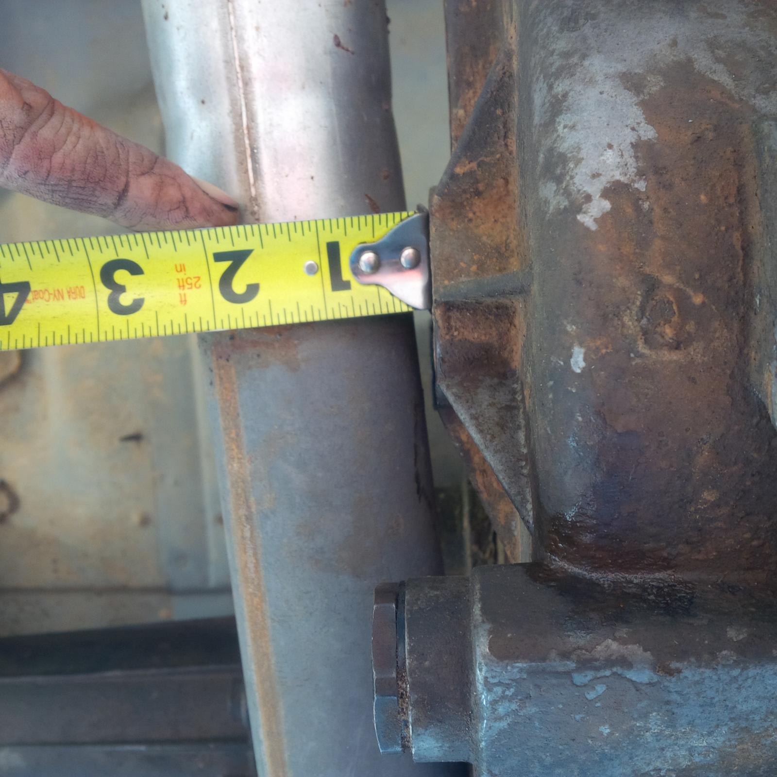

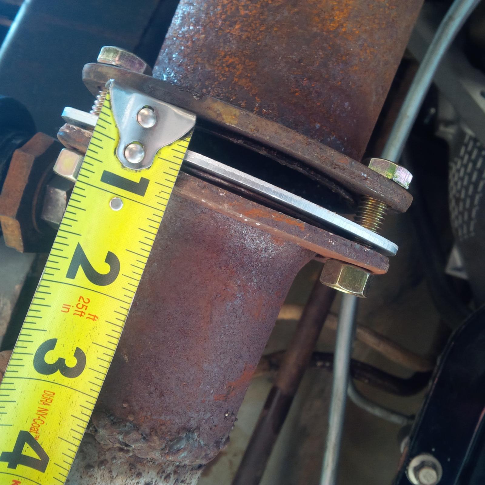

Looks like I'll be doing some cutting & welding this morning...or stack some gaskets and use longer bolts. If it were MY pickup truck, I'd likely do option 2...but this Suburban is for the wife, so I'd probably do option 1.
