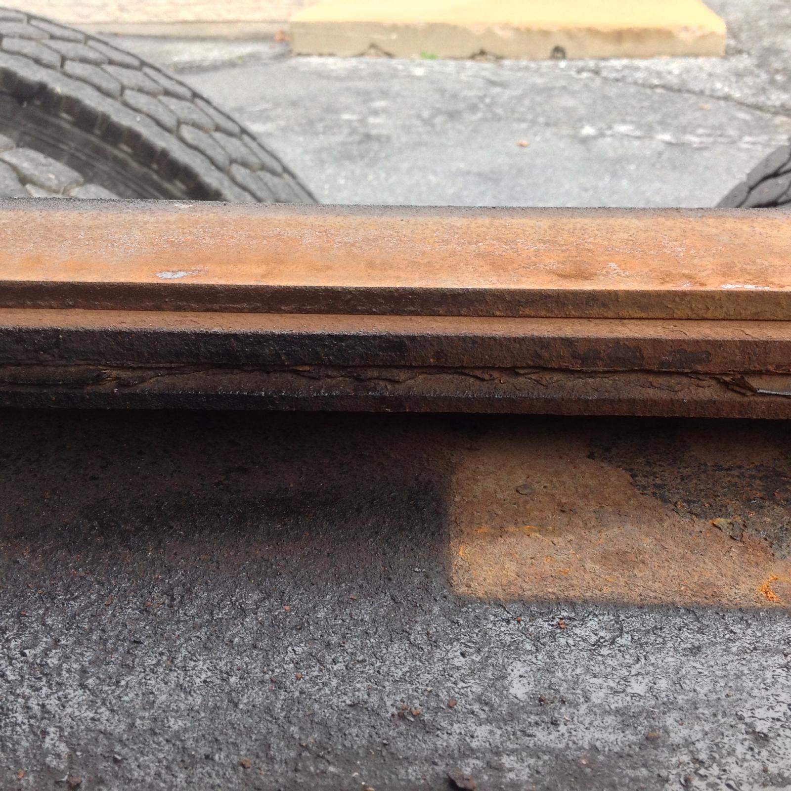

Take a look at the picture of an 05 Mack Dump truck's frame rust. I did not buy the truck based on my concern about the rust between the double frame. Do you guys think I am making a mountain out of molehill? Thanks for your time.post-10788-0-15085400-1443478627_thumb.j

If that is the worst you have, I would not worry. I'd do something about stabilizing it so it doesn't get worse now rather than later, Depending on the plans, a good dose of crank case oil, or a some rust converter and POR15 with primer and paint to seal and protect it. Structurally that is fine. Wish mine was as good.
