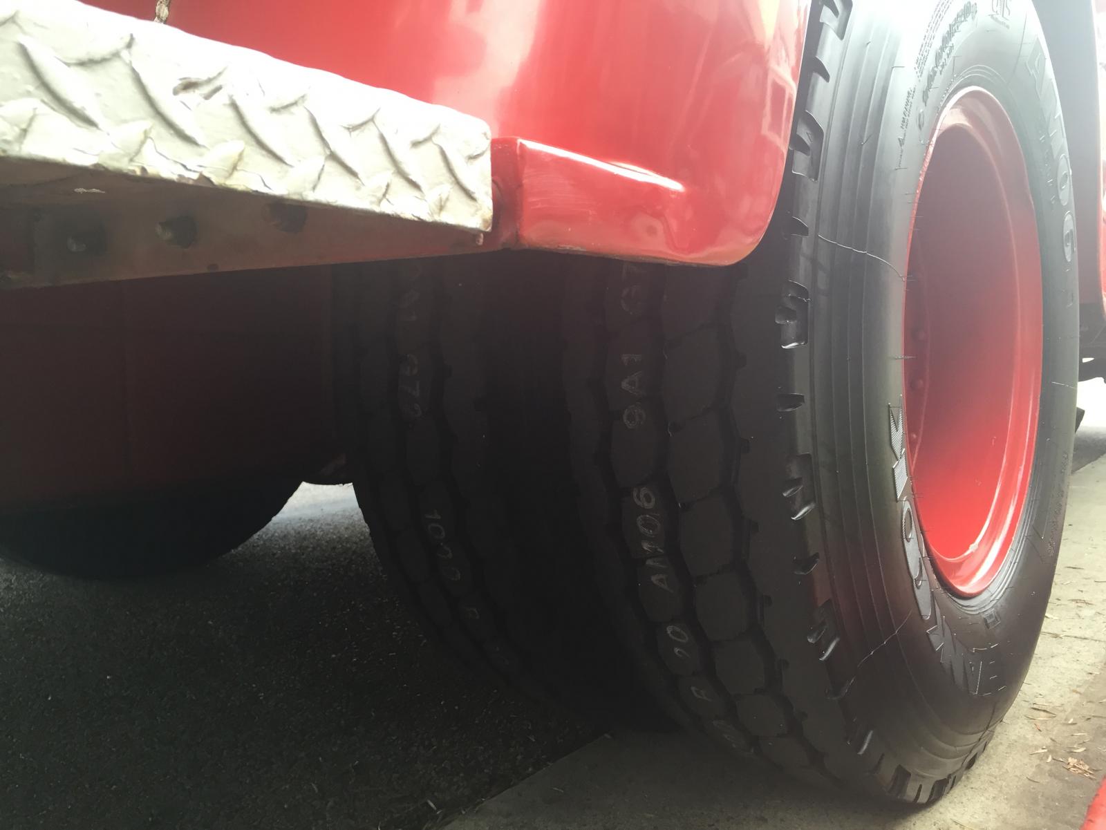

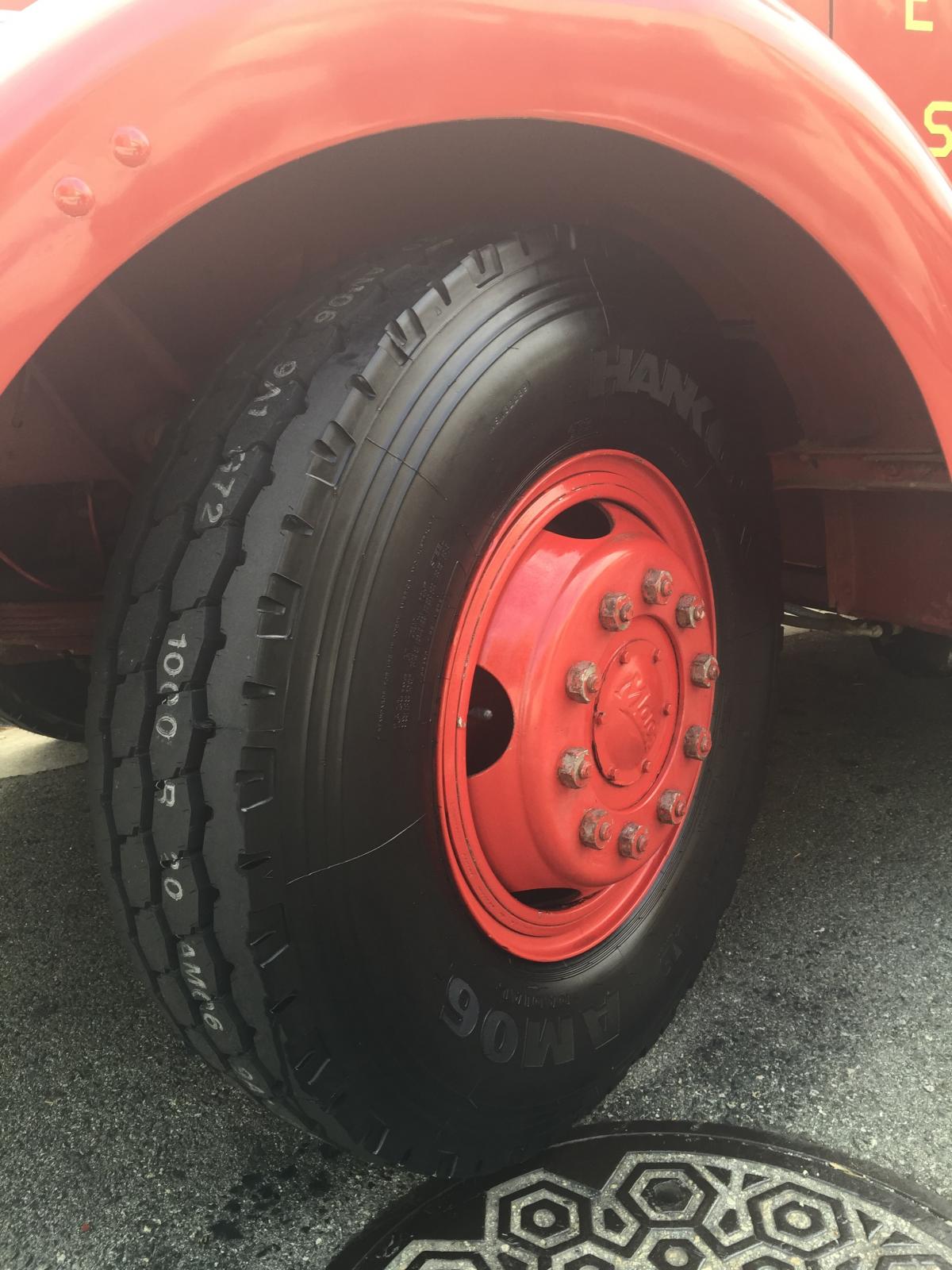

We have finally purchased new tires for our girl. We went with a Hankook AM06 10R20 Radial tire that really looks great.
This page has a little bit of info on them: http://www.commercialtireservices.com/hankook-tires-am06-tire-detail.htm?productid=4392355
We purchsed them through our local tire dealer that sells the city the tires for our front line apparatus as they are a Hankkok dealer.
I looked long and hard for 9R20 tires and the selection just wasn't there for the radial tires in 9.00.
I'm happy with these slightly larger tires and they fill up the fenders a little better and have a bit of a more aggressive "old-school" look. I'll post pics soon.
