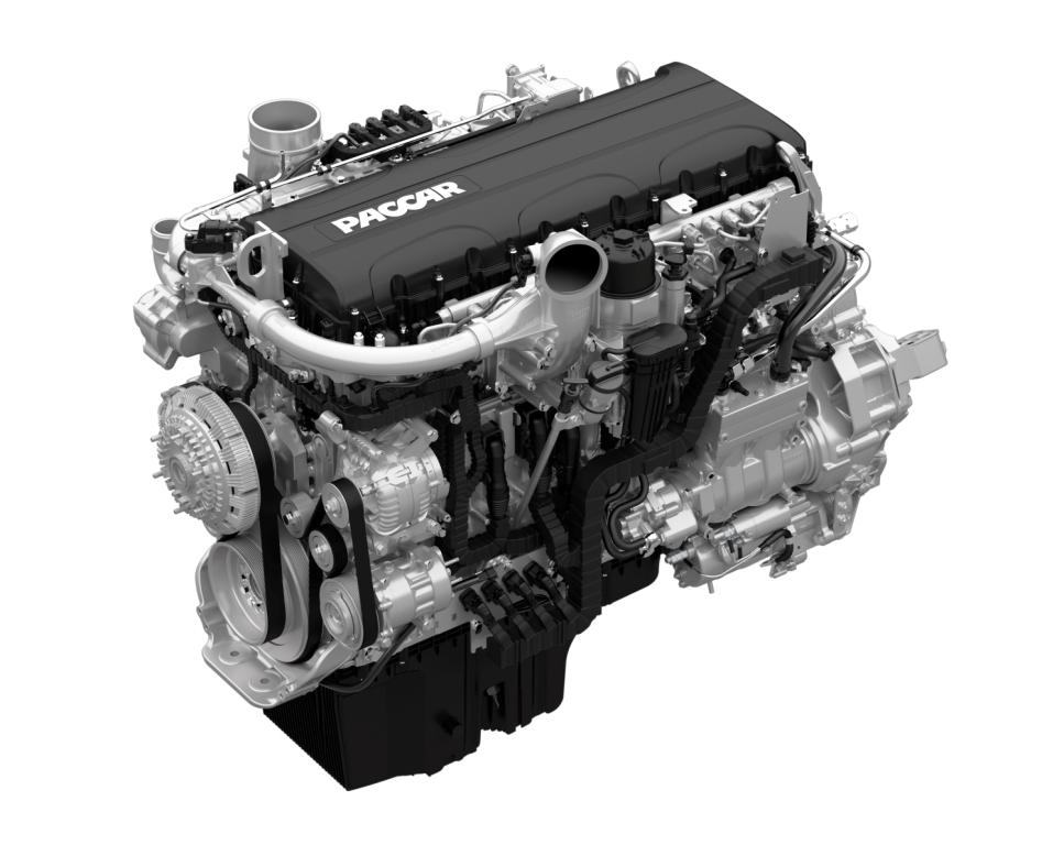

The MX-11 features several new design points that were not available when the MX-13 engine was on the drawing board. There are new, modularly-designed components, for example, including an interesting new water pump that features cartridge-style sections that can be replaced without removing the entire system. If the impeller or the belt assembly goes bad, a technician can simply remove and replace those modules and go on his way.
A glimpse of the future can be seen in the MX-11 as well: The engine has been designed from the ground up to be quickly updated with new software and can be programmed to meet specific customer requirements.
Actual engine displacement is 10.8 liters, which works out to 355 to 430 horsepower options with torque ratings ranging from 1,250 to 1,550 pound feet. Paccar says the new MX-11 is 400 pounds lighter than comparable Cummins ISX12 or MX-13 engines and has a 1 million mile B10 life.

The 10.8-liter MX-11 engine is characterized by its combination of state-of-the-art innovations and proven technologies that reduce weight and deliver features needed for a wide variety of over the road and vocational applications.
The MX-11 engine’s double overhead camshaft design, coupled with a compact graphite iron (CGI) engine block and cylinder head, create long-lasting durability, achieving an industry-leading B10 life of one million miles.
The MX-11 utilizes a common rail fuel system with injection pressures of 2,500 bar to optimize combustion and ensure the lowest possible fuel consumption and noise levels.

The DAF MX-11 is a six-cylinder, 24-valve design and has double overhead camshafts along with high-pressure common rail fuel injection. Like the DAF MX-13, the engine block is constructed from compact graphite iron with vertical ribs to maximize strength while reducing noise levels.
