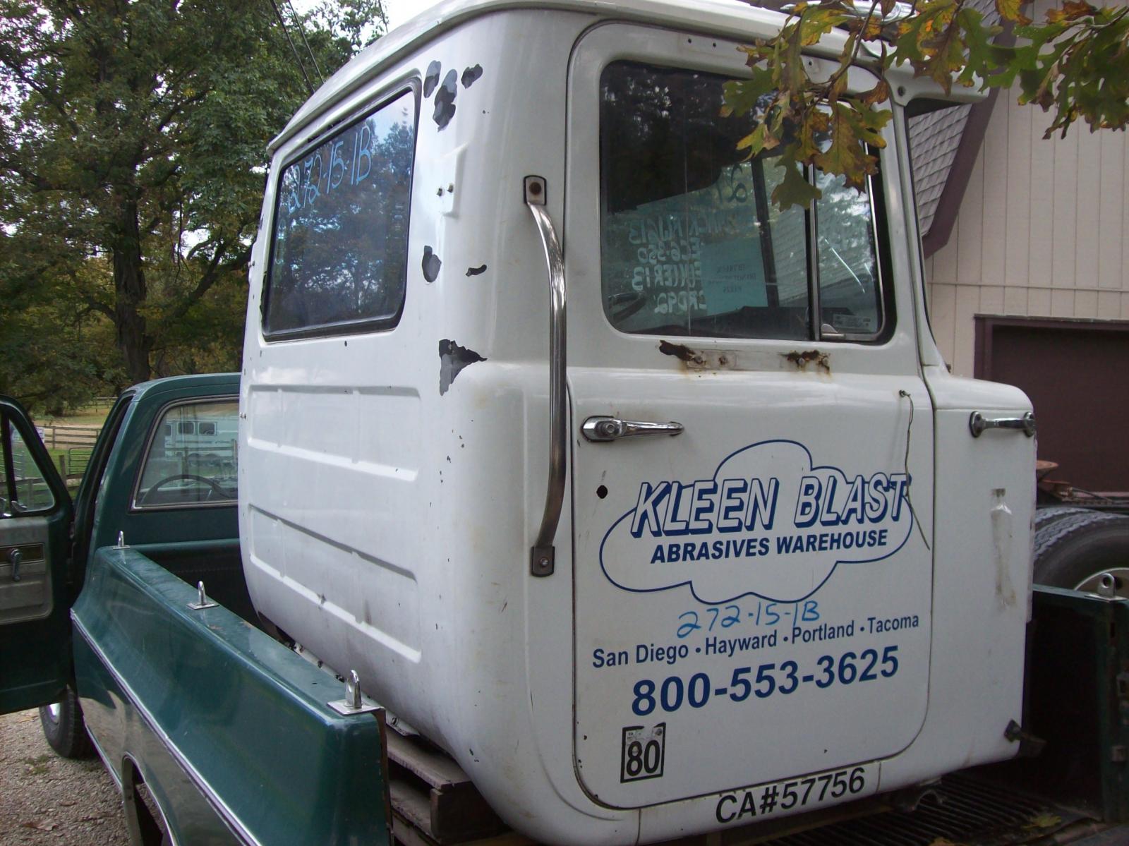

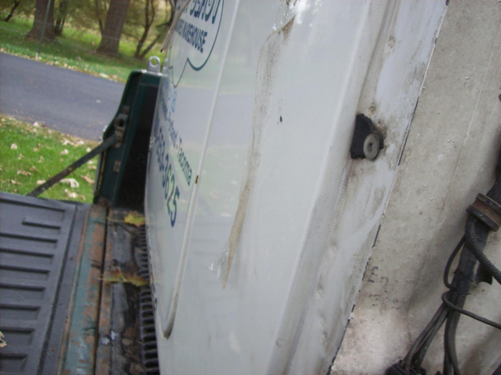

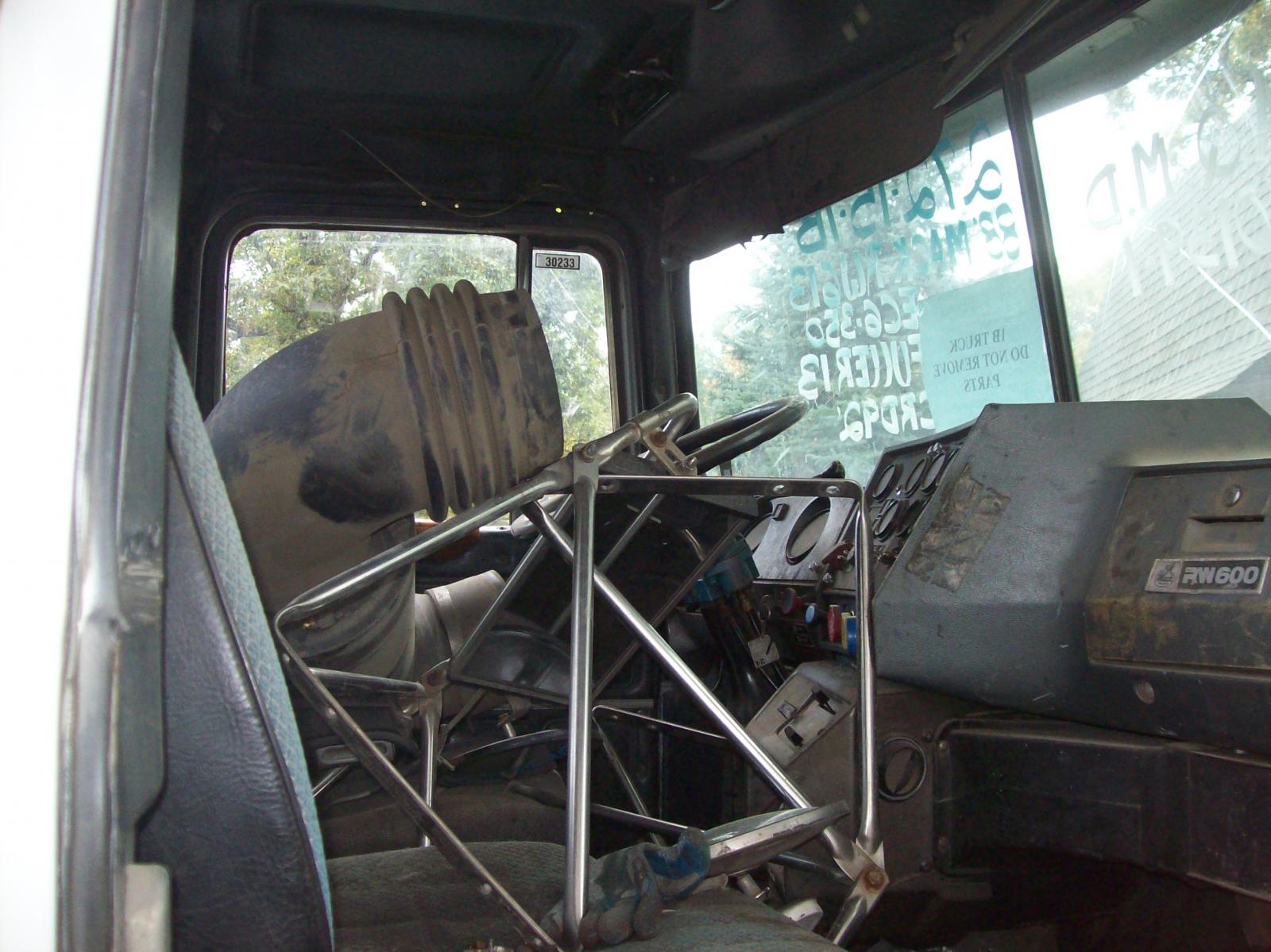

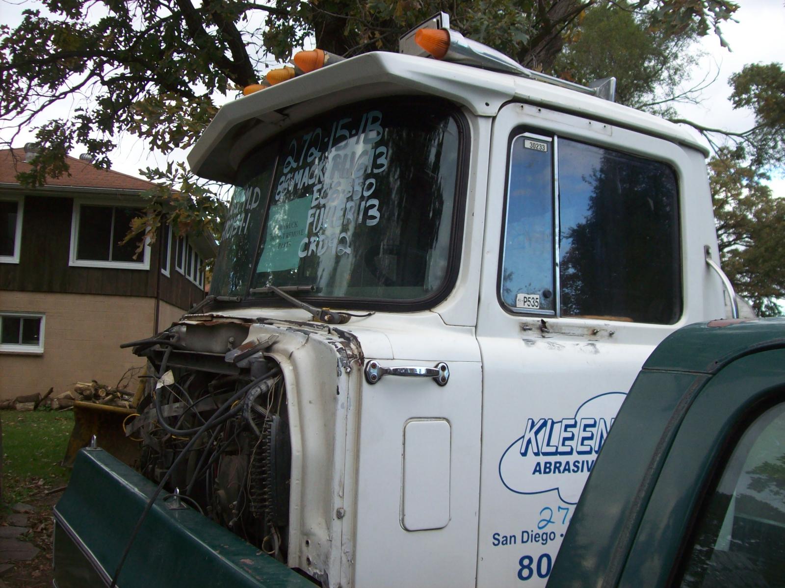

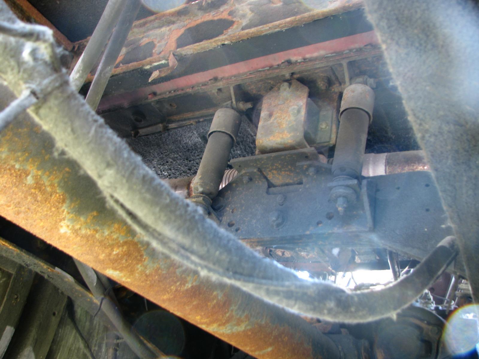

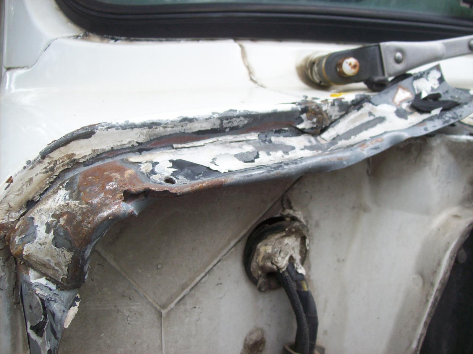

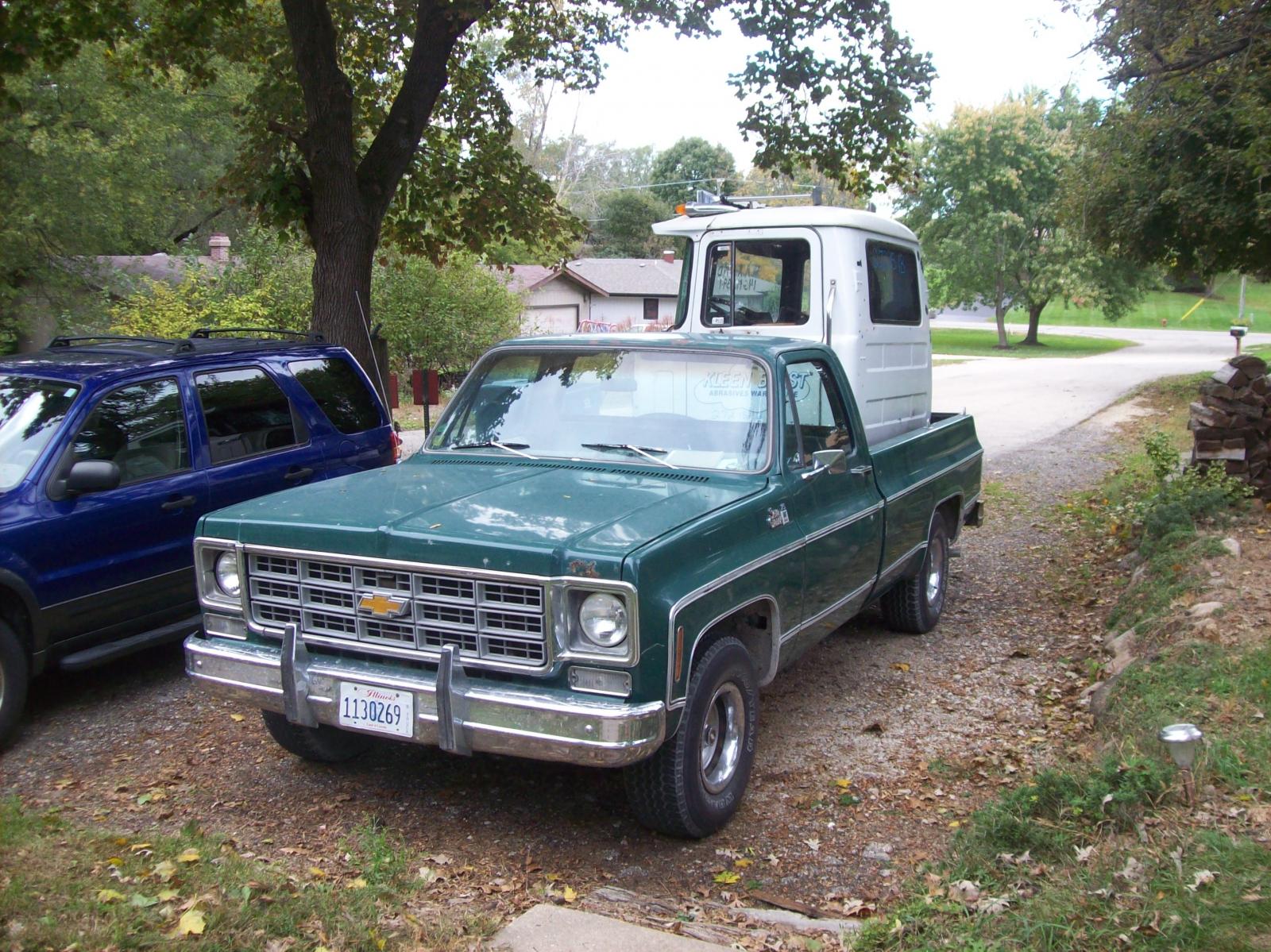

My cab arrived from southern California today better than I expected they threw the mirrors and headlight bezels in for nothing so overall Im pretty happy with it. There is one spot where the hood slamming on the firewall has damaged it but thee old cab will make a good donor for the piece I need but best of all no rust.

Its a pretty big job had to add some weight to the back of the tractor to lift 1500 pounds of cab out of the truck lots wires and other stuff to transfer over.
I'm anxious to find out what hurdles you are going to run into putting a PA built Superliner II cab on a Hayward built Superliner 1 chassis.
Me too Mike they sent me the whole set up for the rear of the cab with the shocks and airbag hopefully I can figure out how to use it sure would be better than a solid mount cab. Mounts on the front look pretty much the same the hood rests are different on the bottom they sent me the headlight bezels they are plastic mine are metal but theirs are in better condition.
