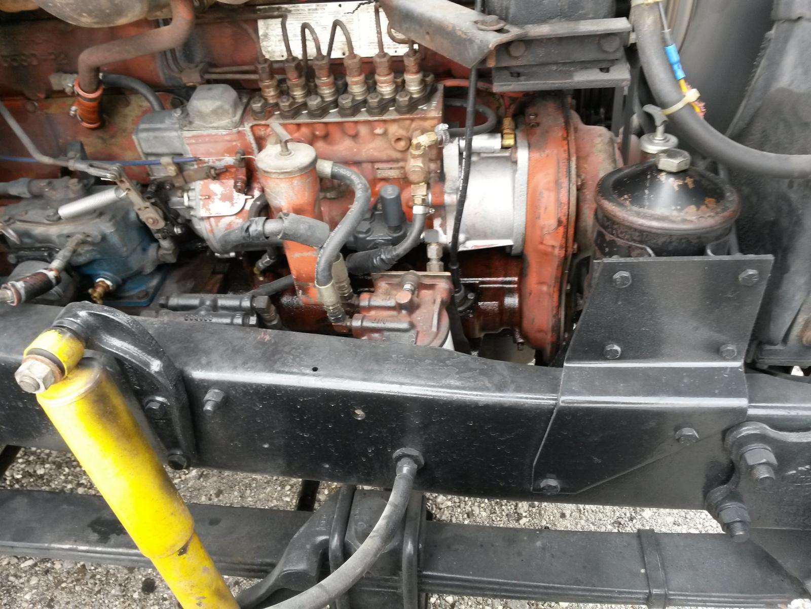

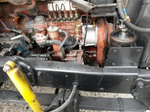

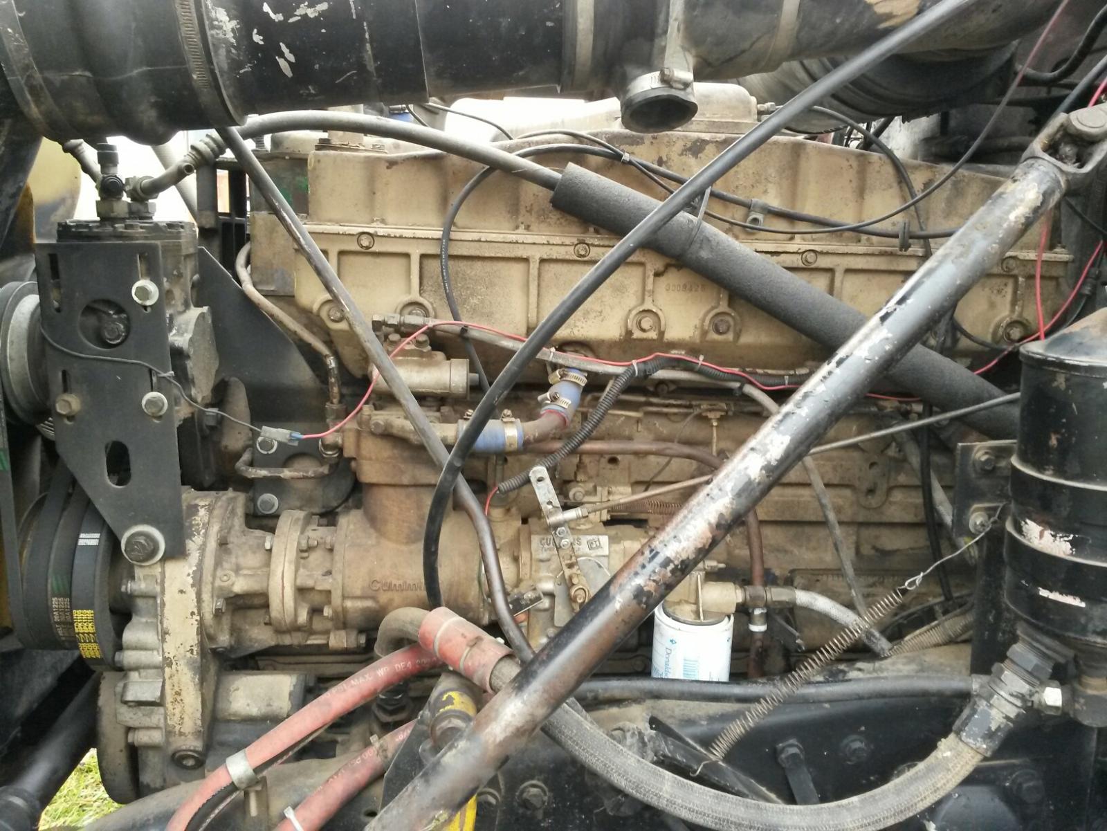

On the original motor i would think it would be on the passenger-side front same as the pump. On my B and the later Mack engines that I have seen they were also on the right. The Cummins in my Super-liner is on the left but so is the pump.
