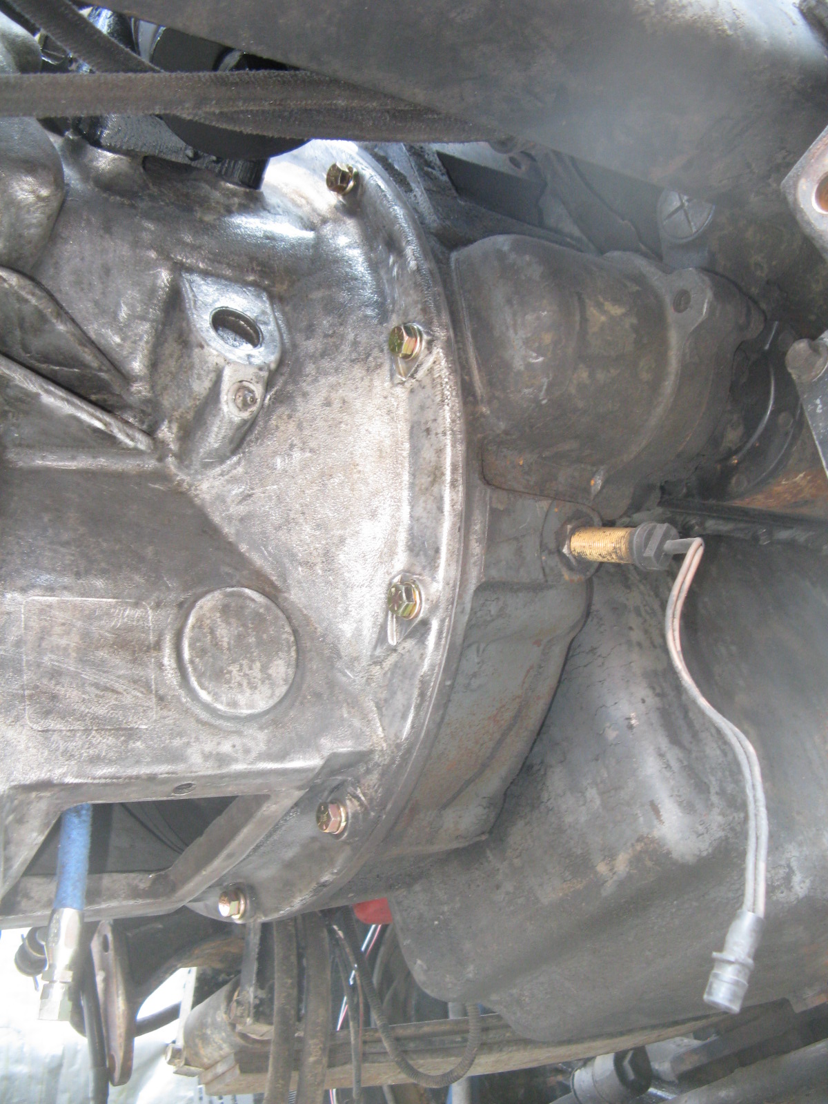

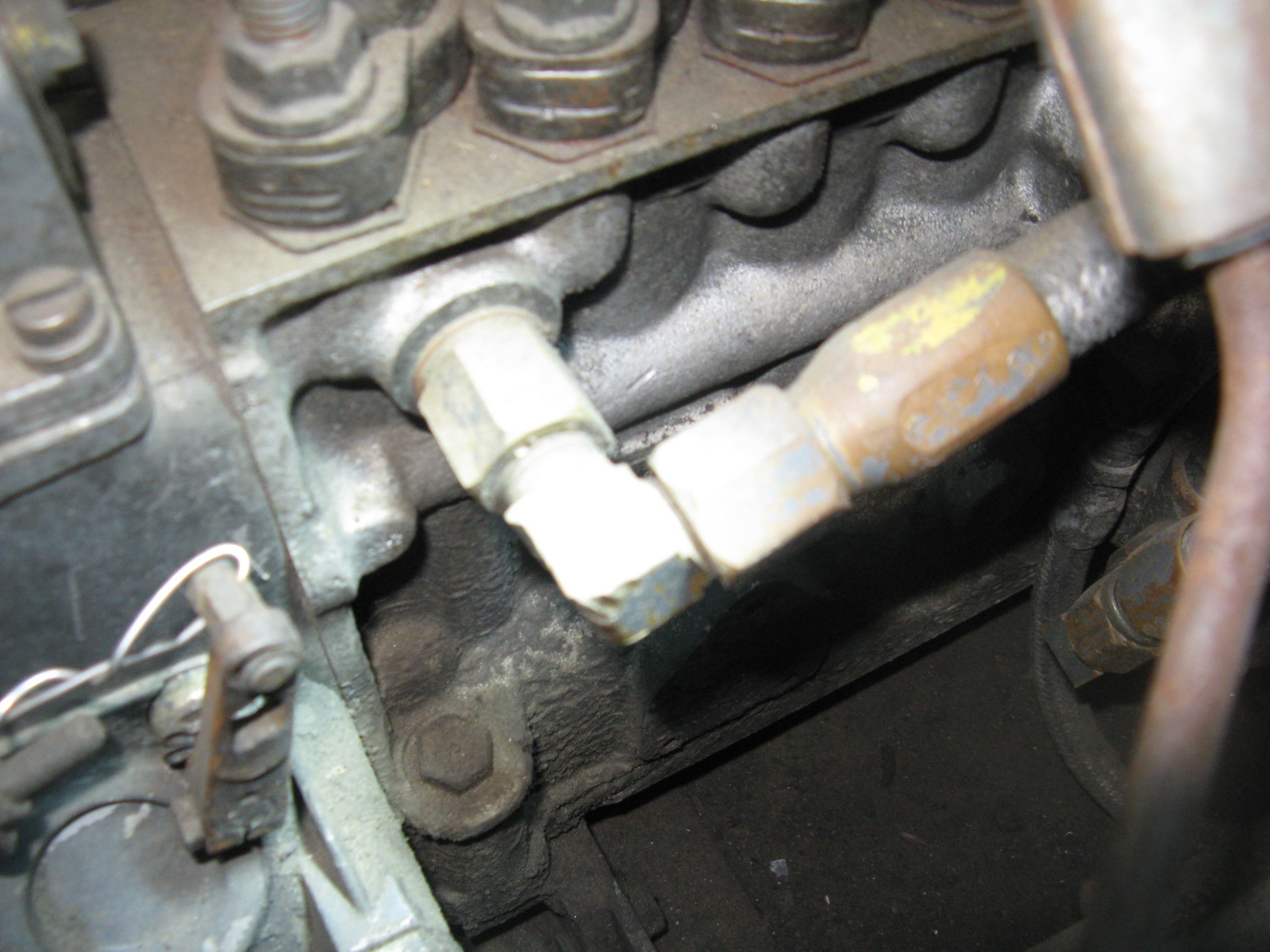

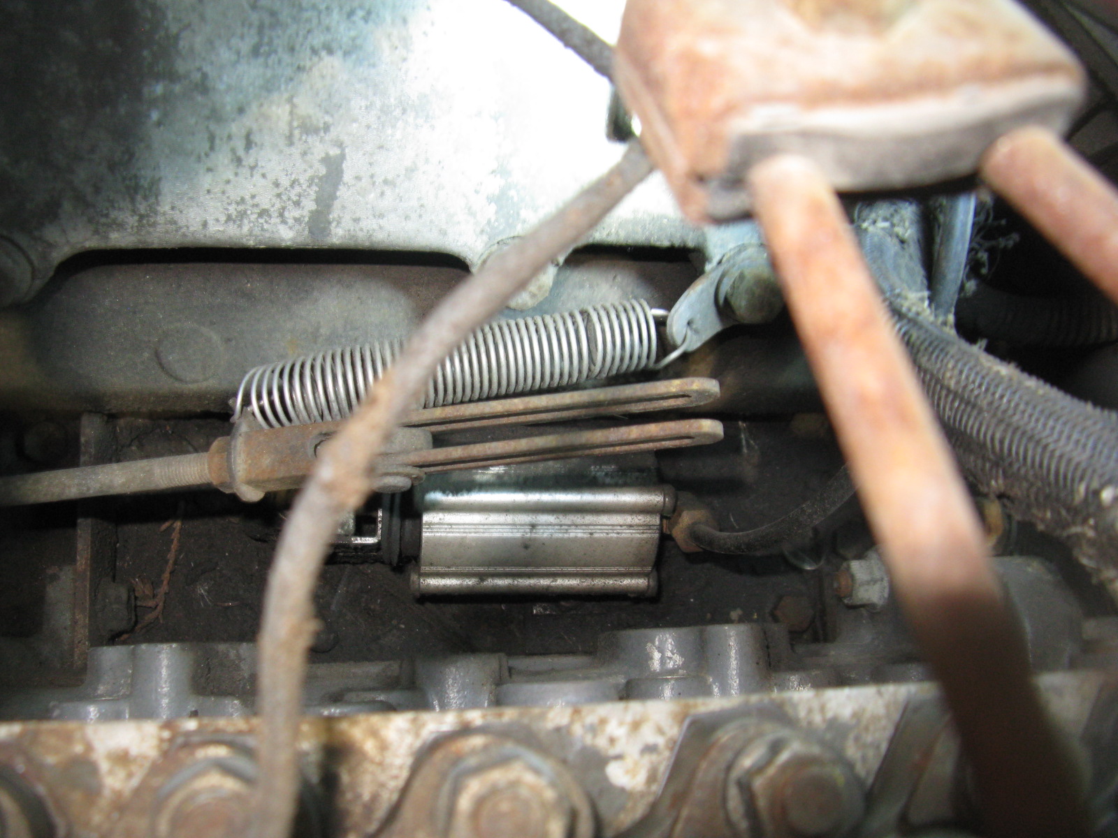

thanks BC mack...would you have an pictures of the top of your engine showing the fuel pump hosing and routing? I'm doing a V pump to in-line pump conversion and it's hard to find anything on the Internet...I appreciate your help

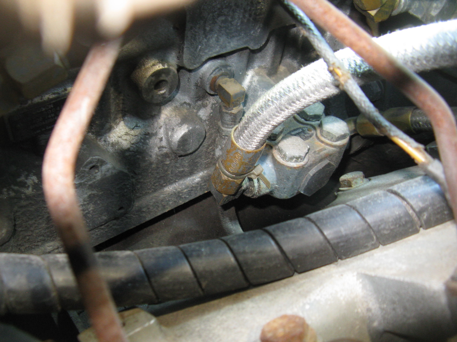

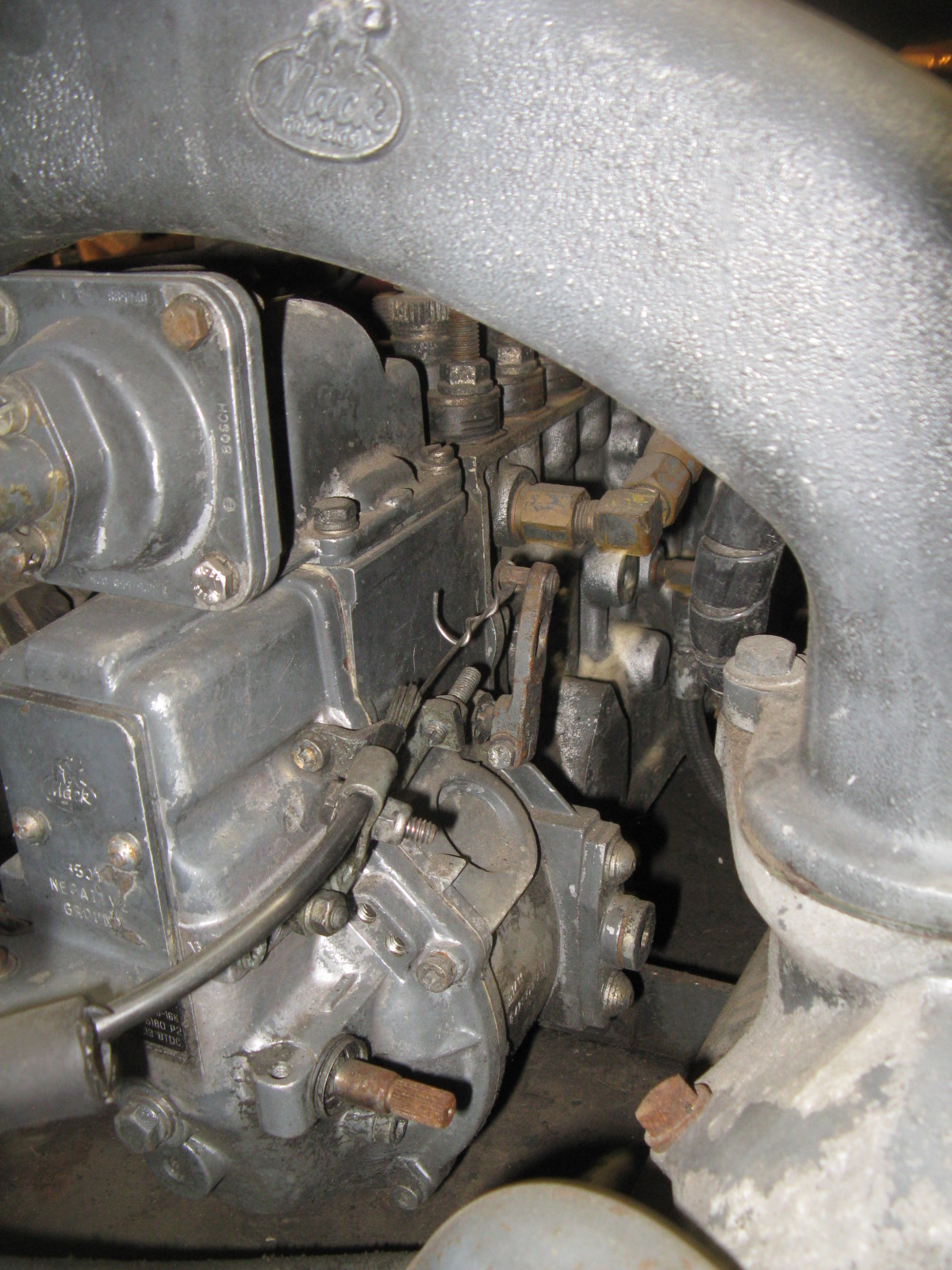

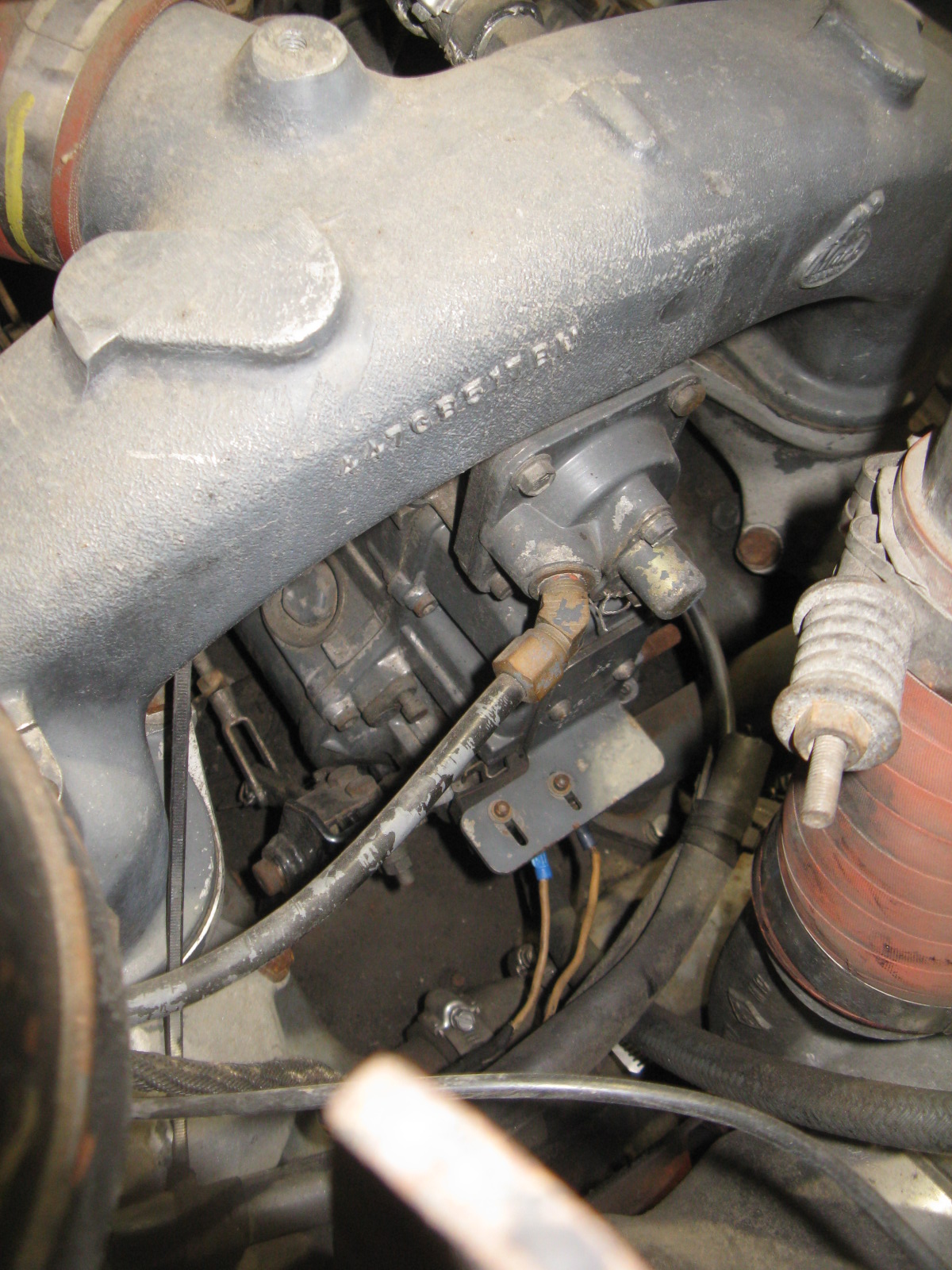

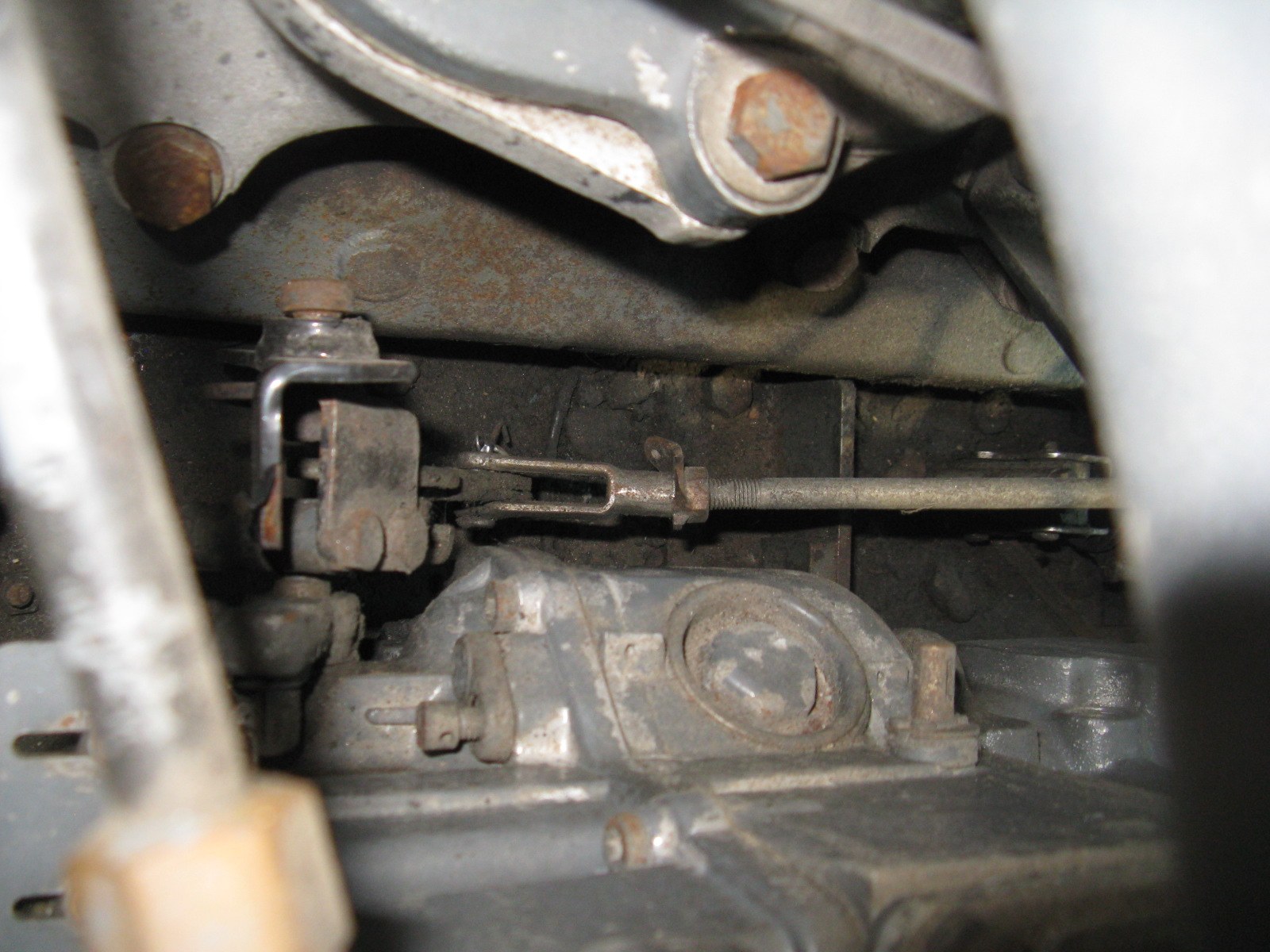

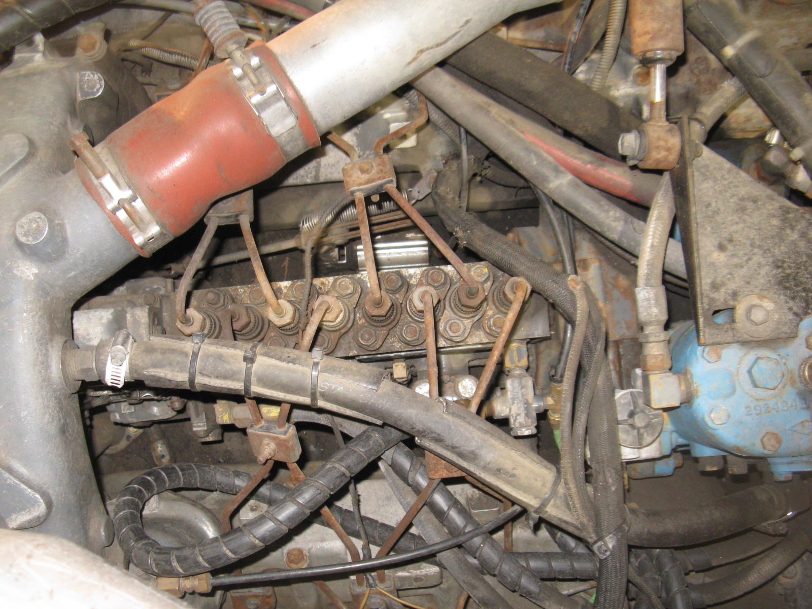

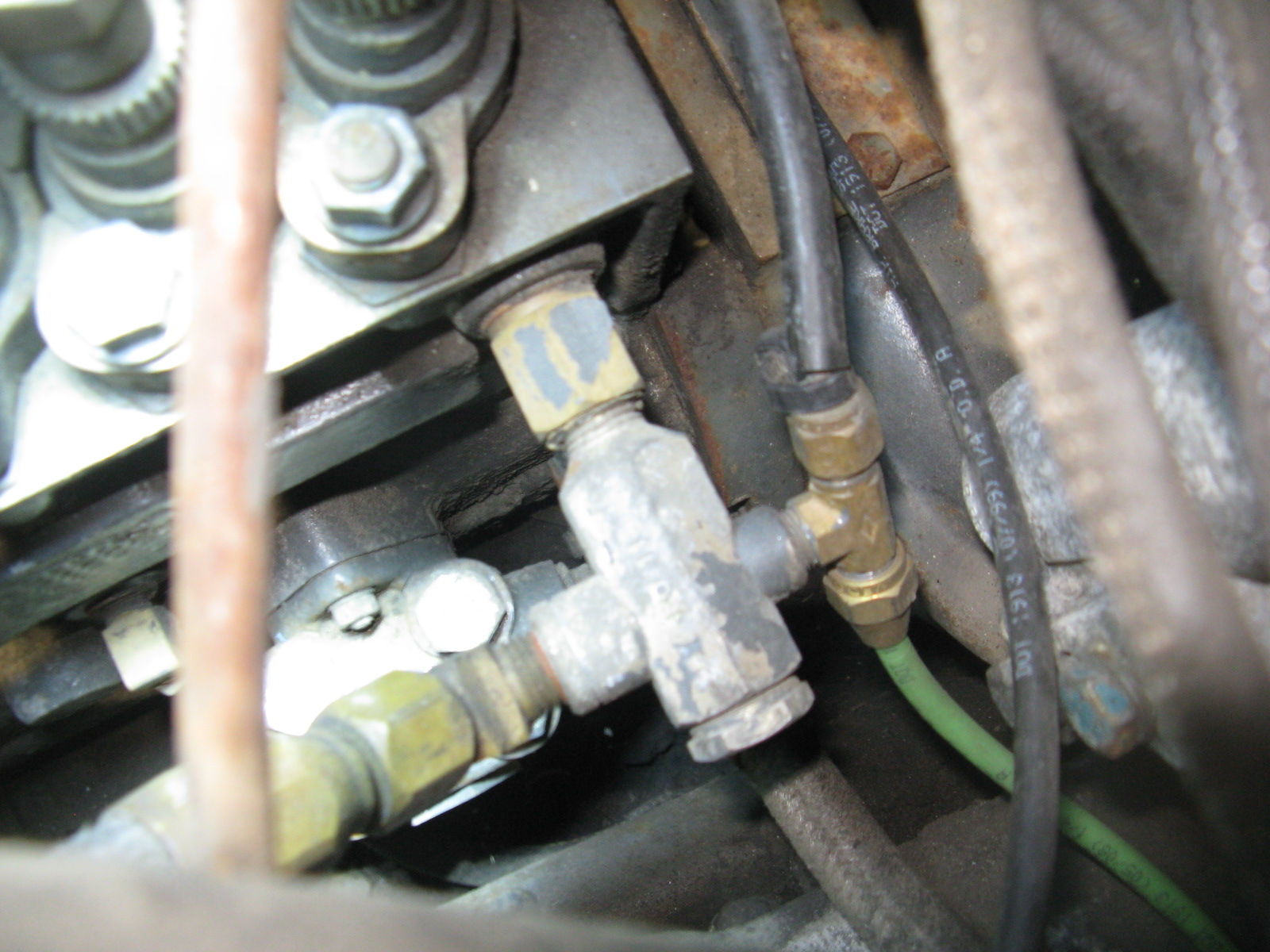

I got some photos for you today... trust it is what you need.
I hope I got the hose direction right, pretty crowded in there...!!!
BC Mack
1. general view of top
2. outlet from pump and injectors, return to tank
3. lift pump, aft fitting goes to secondary filter, front is from primary filter
4. inlet to pump from sec filter
5. stop cable
6. dynatard switch and torque reduction for low-low
7. air throttle cylinder
8. hand throttle lever (my cable is off)
