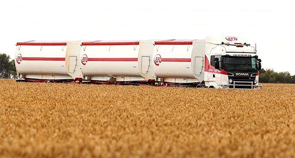

Behind the big Scania was a three trailer C-Train tipper combination, the WA interpretation of an AB-triple with the B-double set at the front and a tri-axle dolly and dog trailer at the back.
With concessional loading for harvest this whole combination is good for an 80-tonne legal payload.
This makes a gross weight of 121 tonnes which would no doubt would be a good test of the R730’s 16-litre V-8.

The C-train combination is relatively compact at 36.5m long and tracks very nicely.

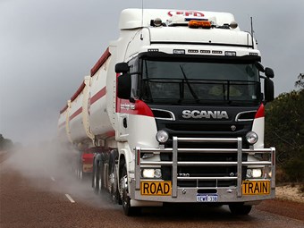

The stability and handling of the air-suspended twin steer axles was superb, even on dirt and rough, broken blacktop.
Where some twin steer set up can feel like you are hitting every bump twice, the Scania setup let larger bumps roll though the front end without a double impact.
Given the short drawbar between the dog trailer and the rest of the combination I was expecting that rear trailer to be a little jittery at highway speeds.
But, given the stability and ride provided by the front end, the dog trailer tracked along nicely with very little sway on the rough stuff.

If the V8 was the star of the show, the Scania retarder wasn’t too far behind it.
A bit of forethought on approaching an intersection meant I could pull up the rig, keep my foot off the brake pedal and keep the R730 rolling even at such a large weight.
It really was impressive.
