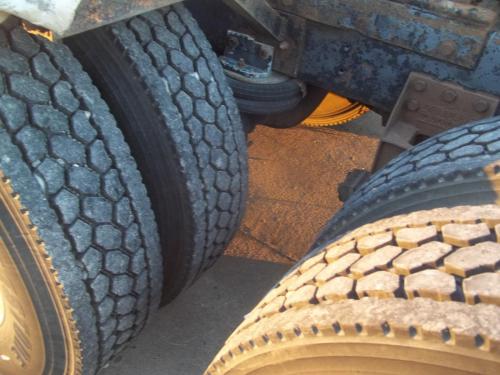

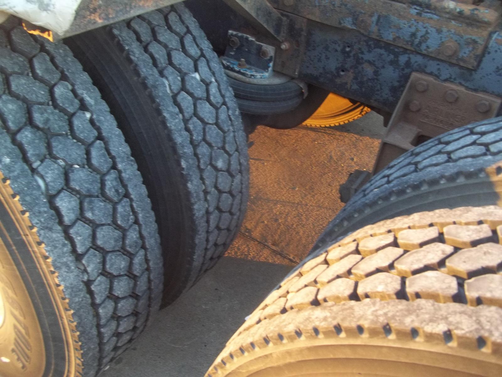

wish you were closer! those Alcoa's would look great on the ol'e red dog. sounds like Alcoa's will soon be a thing of the past and we will be running chincoas
Doesn't sound good does it? I just sold some scrap aluminum,hadn't for quite awhile,it was down about $.20/lb from last time I'd sold any.

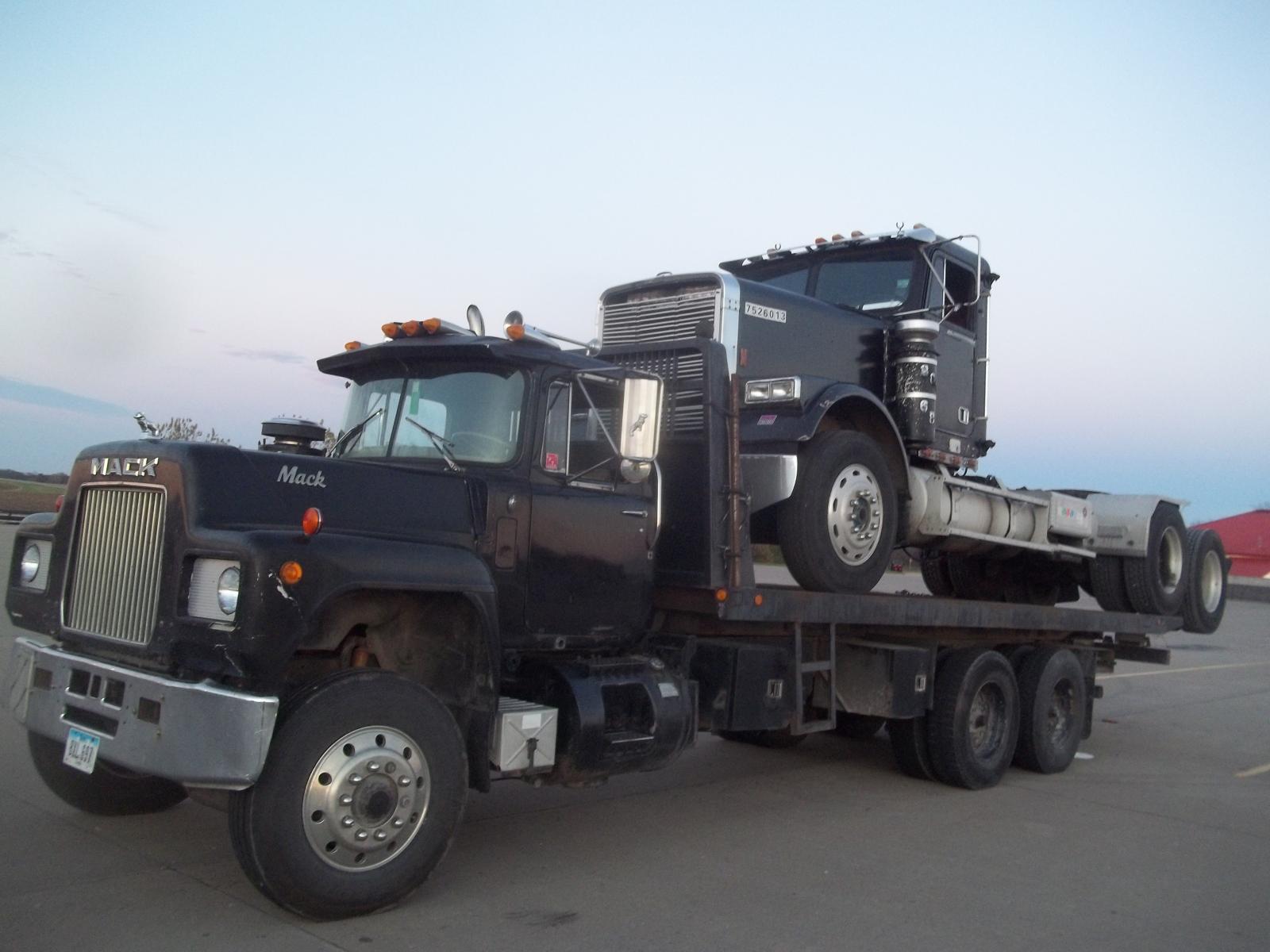

I will look forward to the progress report and pictures! That kw looks to be ok, why is he parting it out?
it's a '86 Freightliner,it ain't very pretty.The guy I got it from was going to fix it up,but just ended up using the bunk on a different truck,cab is really rought,wires hanging everywhere inside,
I sure could use four of those 24.5 alcoas for my superliner it has a pair on the front but all steel on the rears I would even drive the old chevy out to pick them up.
if my Freightliner buddy don't want the 2 front ones,they will be for sale,but I'm keeping the back ones for the RL.

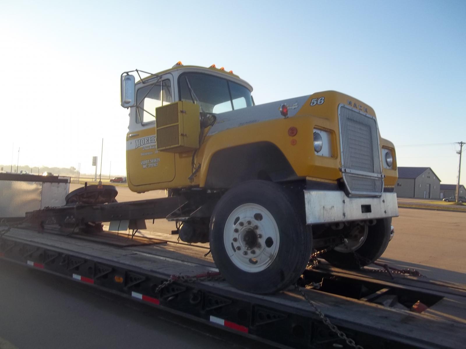

I'm pretty certain I'm not going to use the rears. I want to make the RL a little longer so I can put one of my Mercury sleepers on it,and I think the best way to do that is go with Camelback suspension,slide the trunion all the way to the end of the existing frame,and then add on to the back,that way there won't be any stress on the welded area and I won't have to sleeve the aluminum rails with steel.
The cab and hood aren't that great,Ernie.
So it is! I must pay closer attention to detail!
Good plan Mike!
Hope you'll put all that together relatively quick.
I like the idea of using Camelback. But you will need to weld up the frame rail ends with some aluminium pieces anyway.
At least it's difficult to imagine how to make alu rails longer adding a steel section.
Was it Ok to keep the truck loaded on the rollback keeping onle one rear axle on the bed?

I just had to haul it from the truckstop to my house,my wrecker buddy was coming home empty from a tow and he drug it out of IL for me. I knew it was going to be too long for me to haul and the way the wiring is in it,I didn't want to drive it home and have it catch fire.
