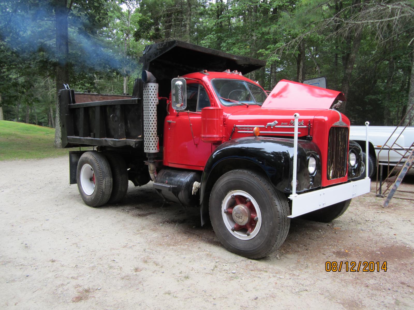

Went to a guys place today to purchase some B model parts and one of his trucks was a B61 LST. How common were these? Is there a list of the aluminum parts? I purchased the hood and will be getting the air tank next time I'm there. I saw the motor mounts and spring hangers were aluminum. This is the first lightweight model Iv run across.
