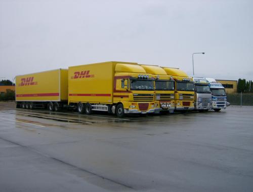

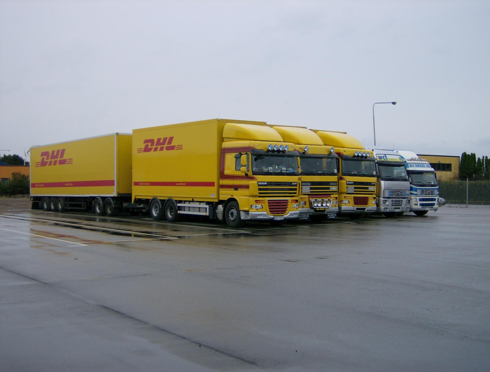

I send a Pictures of some "box trucks", those is DAF, an Dutch brand and sister to Peterbilt and Kenworth. I have lots of them and it´s ok. Those ar 460/480 HP, 64.000 kg and single traction axle.
Stina.
