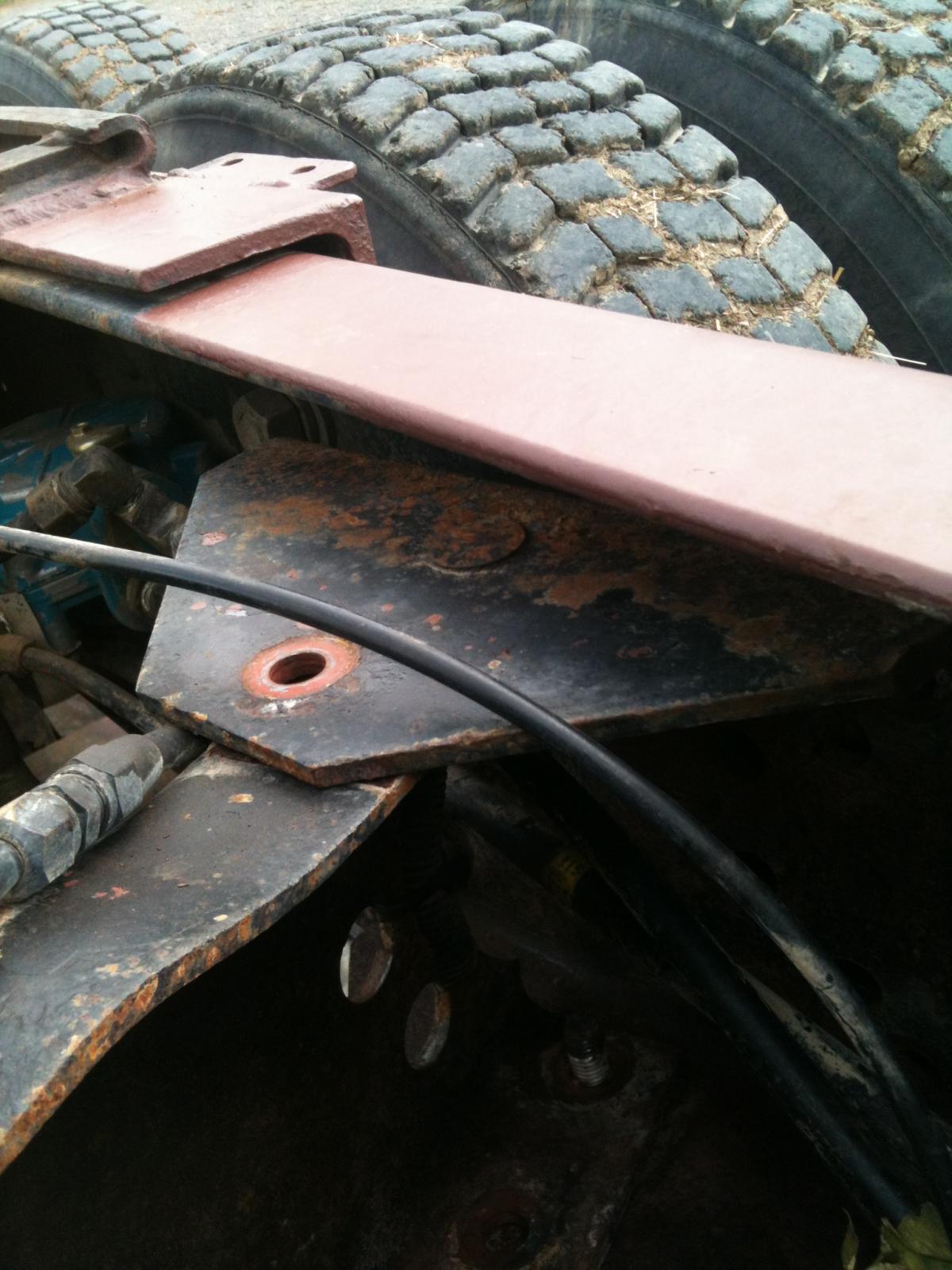

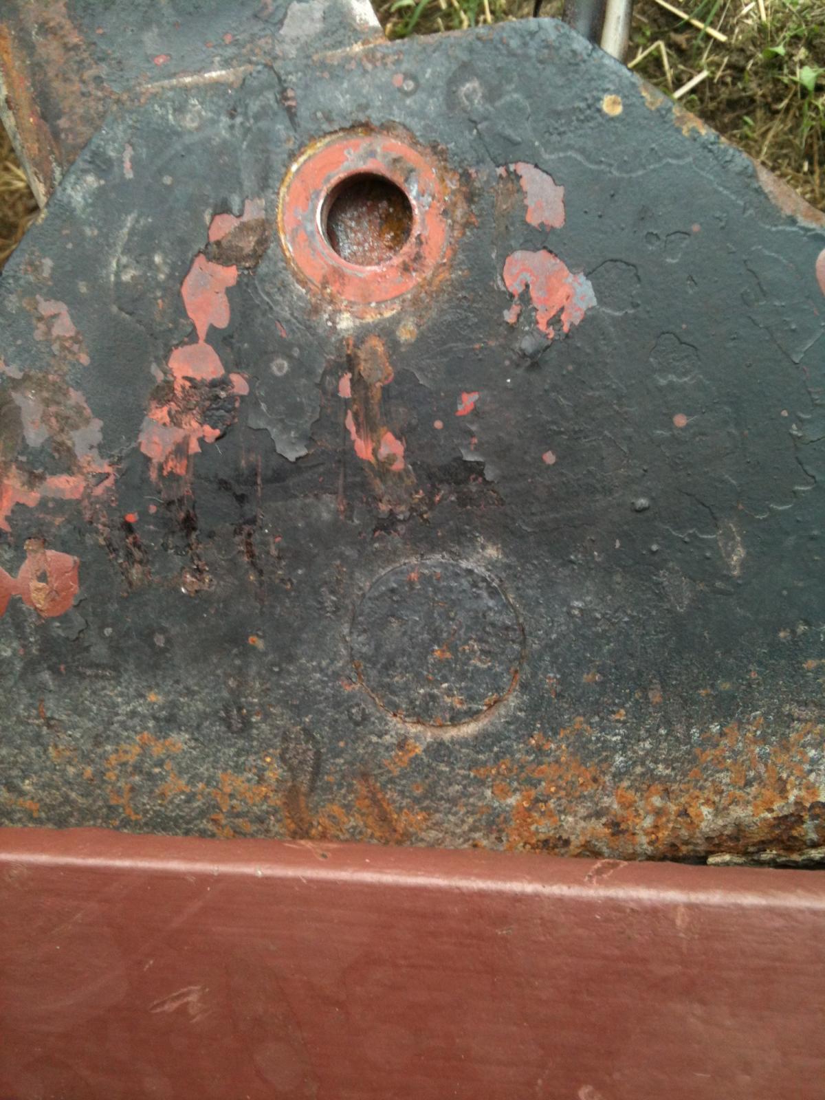

I am taking a crossmember out of my Super to clean rust/paint behind it. Four bolts are "plow bolts" with no heads on them. I removed all the others, and 'hinged' the crossmember on those plow bolts, so its loose in the frame... but if I want to remove the member from the frame mounts, am I supposed to just knock those plow bolts out? Can they be reused? I know on an actual moldboard 9 out 10 times they won't hold tight again.
Does the above make sense?
Thanks.
Ron

Like so many other things, I'm more worried about them being "no longer available". They are odd looking things, and since there's only four, I don't mind buying them.... if I can get'em.

No, these are like a counter-sunk plow bolt, minus the square shoulder. We use them on our chisel plow and our moldboard.... but these are much larger. Really no option either because there isn't room between the frame rail and the bracket... I can't remove the brackets without driving out these bolts, when its daylight I'll snap a photo. I haven't worked on many trucks, so I don't know if these are common or not...

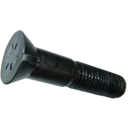

Caterpillar has them. I asked my grandson who works for H.O. Penn Cat dealer. Also here from Grangers Grade 5 to 8.
http://www.grainger.com/category/plow-bolts/bolts/fasteners/ecatalog/N-8k2

Since the rail will be counter sunk for the plow bolt heads just might as well get them from Cat, Grangers or Fasten All.
Pictures of plow bolts... They are 'supposed' to come out right?
By the looks of the design, anything with a nut on it should be able to be undone. As a matter of fact, them style cross members would be very hard to get out without removing them. Just so long as you can replace them with something.

I tried pounding one of those plow bolts out (without damaging it)... wouldn't budge... That's why I'm asking.
Every crossmember is like the one photoed. One plow bolt on all four corners.
The rest of the bolts are normal flanged bolts.

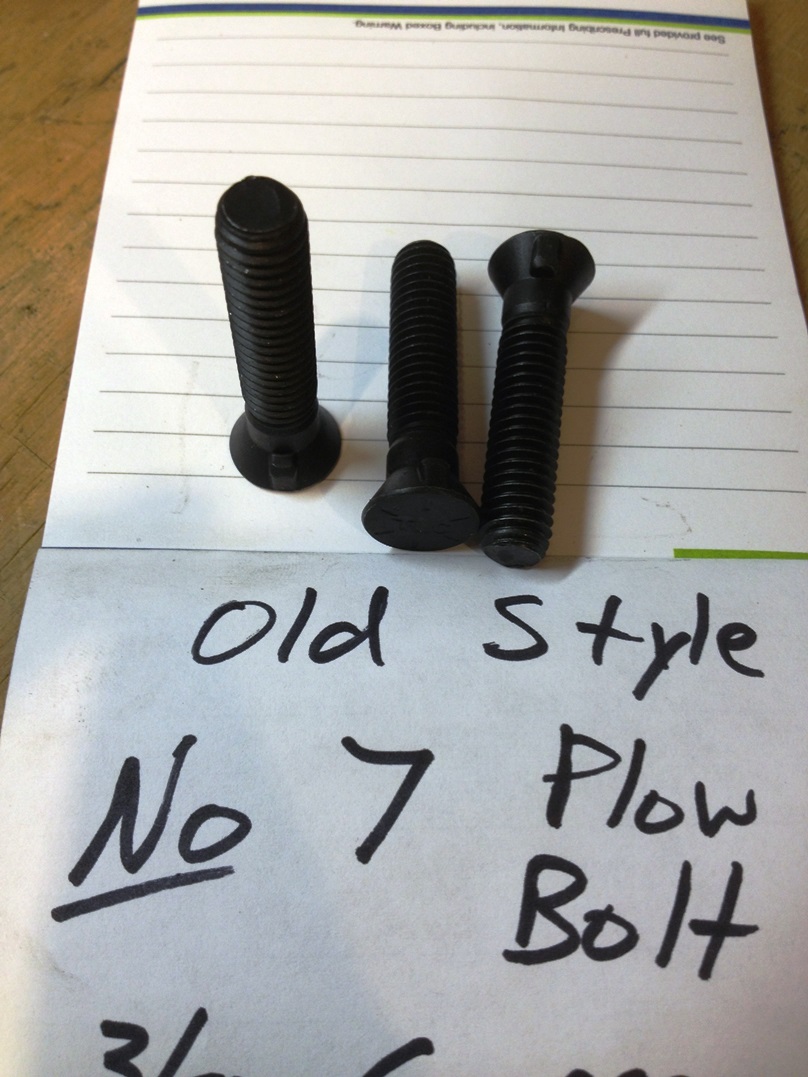

Grandson brough these home from Caterpillar they are #7 Bucket Tooth Plow Bolts. The tooth "collapses and locks it in the hole as he said tighter than sh#t.
