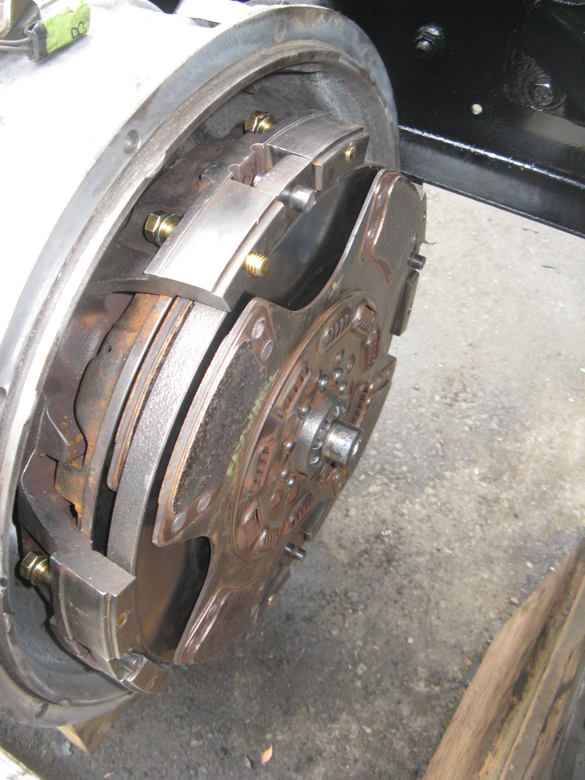

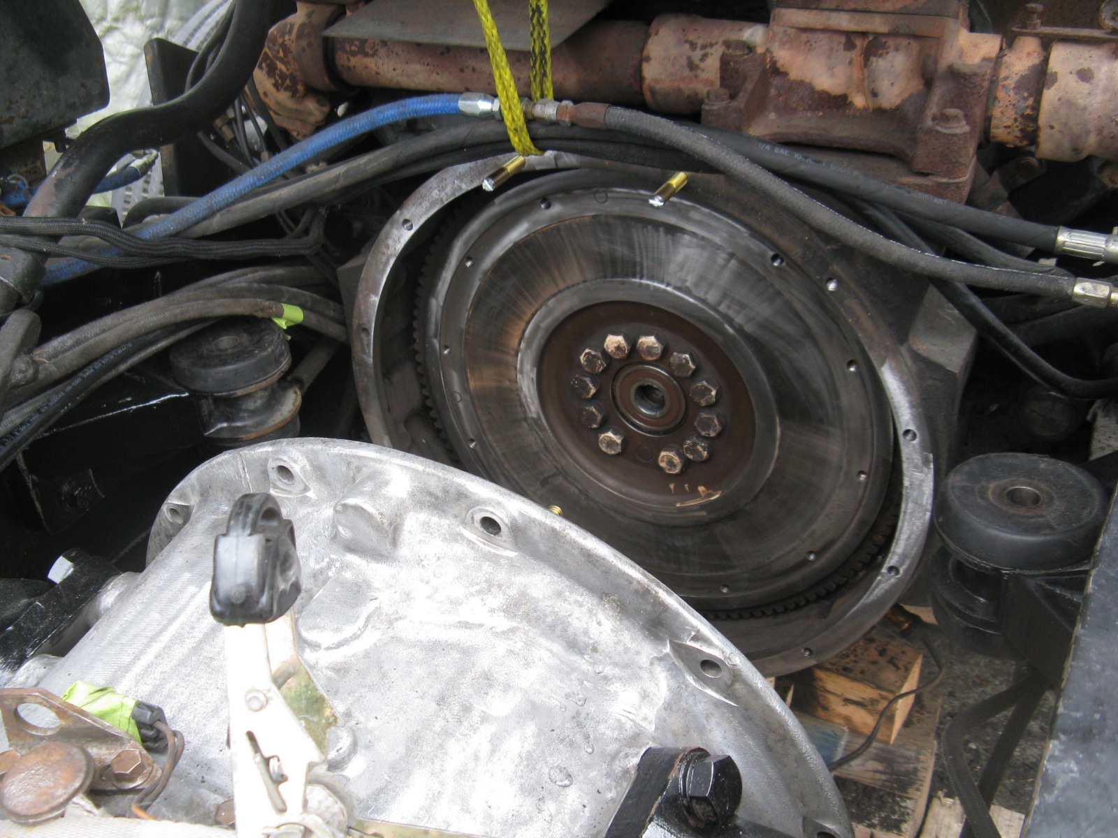

I couldn't find the size of alignment tool I needed so I loaded the spicer clutch onto the trans input shaft, put two cut down bolts into bellhousing for alignment and it rolled in easy...a bit of wiggling got the cover bolts on... only downside is constantly turning the engine to torque the cover bolts...
BC Mack
post-10384-0-60322700-1448063752_thumb.j
post-10384-0-86849000-1448063826_thumb.j
