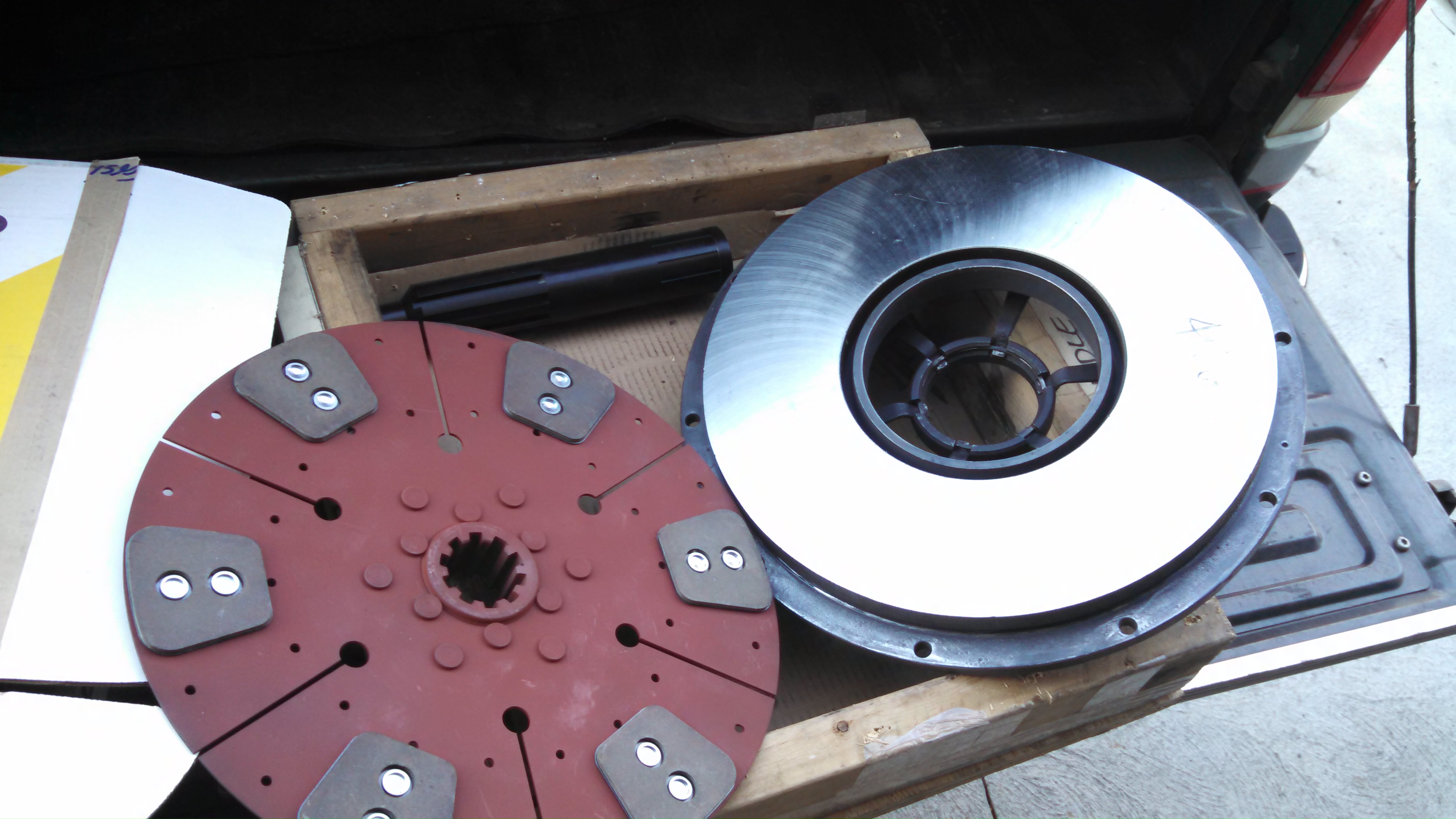

Well the clutch is on its way back, will have it Tuesday.   Will pick up a new pilot bearing on Monday at local bearing house.
They upgraded the disc material, but not to ceramic, but some kind of carbon fiber mix.  Suppose to give more grip but be a bit easier to drive(not so grabby as ceramic).  Okey dokey.  $295 for everything, not bad.  They are throwing in an installation tool to line up the disc too.

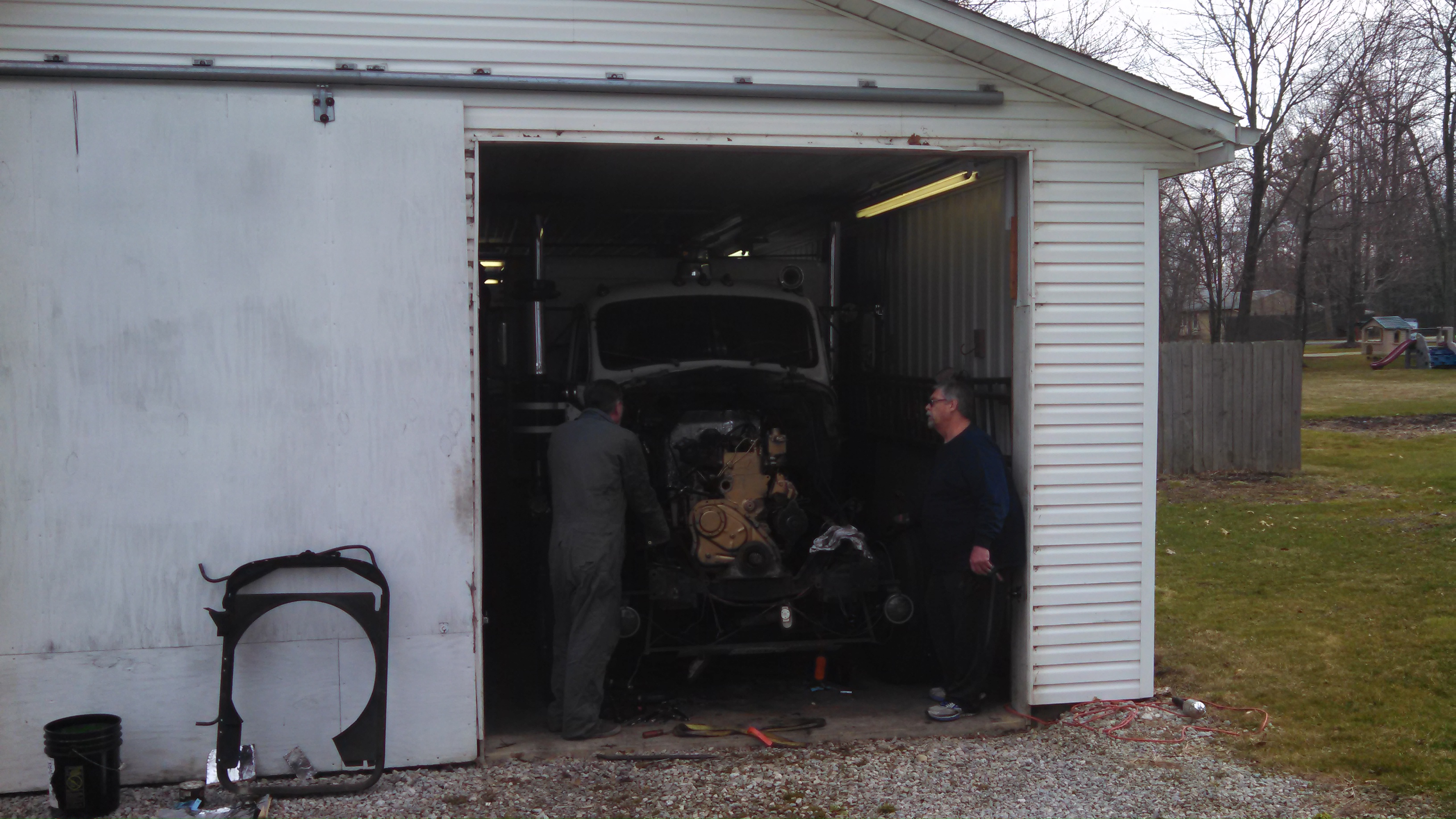

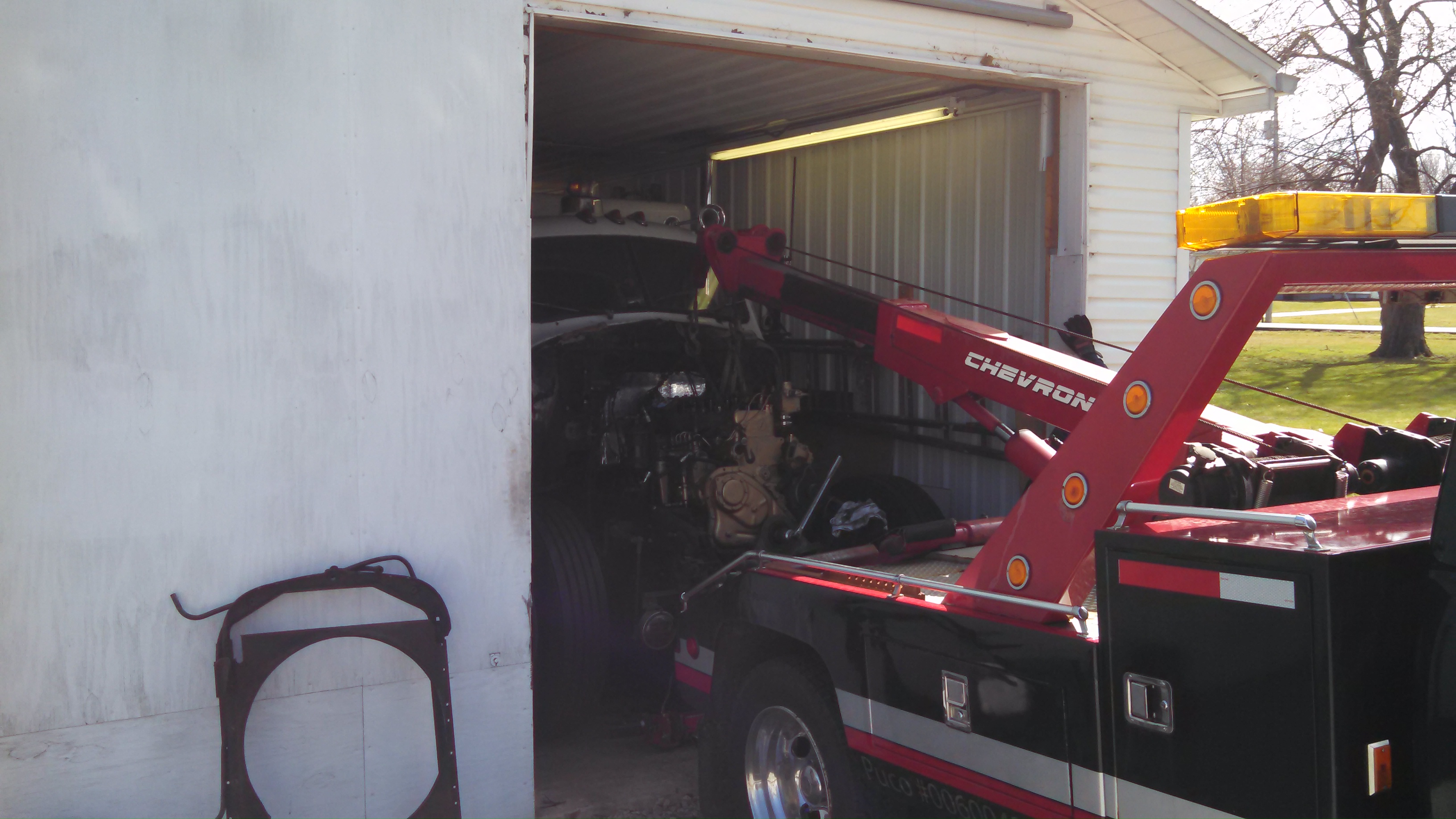

Well, it's back.
I have the flywheel installed, just need to finish torquing it down.  My wrench only goes to 150, buddy has one that goes 300.  Calls for 190 on 5/8" bolts, I'm going to go 200 and call it good.
The wrecker is set up for Sat morning.  The weather is suppose to be 62* and nice.
I made some guide pins out of 6" long 3/8" bolts(with the heads cut off).  Should make getting motor lined up with transmission much easier.

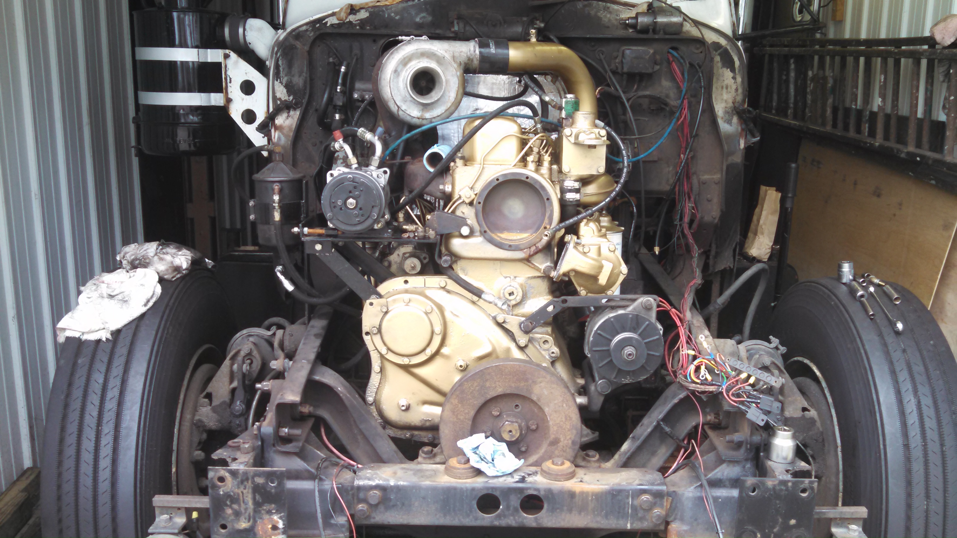

It could actually, have fuel and electric hooked up.  Just no water yet.  Got the crank bolted torqued last night.   Picking up water pump gasket and then can put that in and install radiator.  Then front end, etc.  Have to fab up upper and lower radiator hoses.
I do need to get some idea on where to hook heater core up.  I found a place on water manifold, but don't know where to return it.  The oil cooler does not have a return hole like my old system did.  Where did the R models get and return the heater core water?
I think I'm going to have to make a throttle arm for the pump.  Can't get the old one off.  Can't believe how tight that little 1/4" bolt is.  Heat, heat, heat, oil, heat, oil, heat.  Ugh, don't want to break it off.
