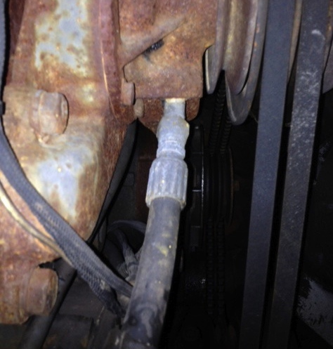

Nothing.  This supposedly came from a fire truck if that matters?  The feed for air compressor is on bottom of water pump.  No other holes like on my old motor.  This having an oil cooler makes it slightly different set up.  Just curious if anyone has an r model with 237 to see where they route the hoses.

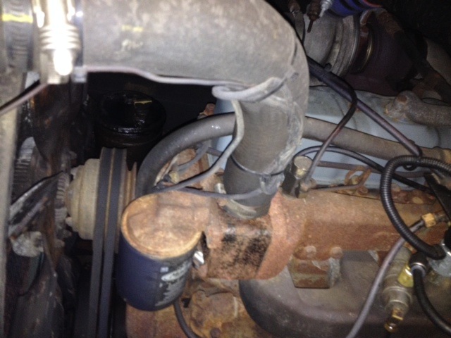

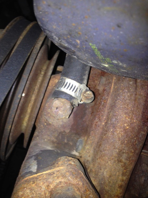

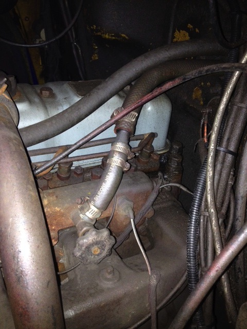

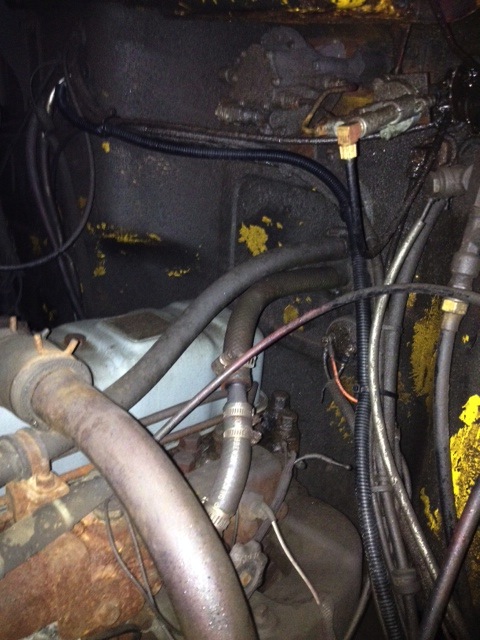

I opened a photo bucket account as I can only up load to the galley and it says I am 135% over my allocation.  Anyways, see if this works.  As you can see from the picture it runs from the waterpump housing up to the heater and returns to the manifold near the temp sender probe.

Hmmm, ok.  Only problem is I have the 673 waterpump on it.  I have the fitting on the bottom of it, that is where the line goes to the head of the air compressor.  I do have a fitting in the top of the front manifold where I was going to hook one line(that motor just has a plug in it).  Just not sure of the water flow and where I would need to bring it back in? I have the temp sender in the same location as that picture.  I have the shutterstat in the same location also.

The original 237 had the line coming off the bottom of the pump, going around the passenger side to the air compressor(just like the 673).  That I will reuse with my 673 pump.  The one heater hose came off the front/top of the water manifold and returned back into below that area(mine had no oil cooler).  I'd have to go look again to confirm.
The 237 manifold does not have a fitting in the front since it has the water filter set up on it.  Then the oil cooler does not have any fitting in the front either.
I'll get some pics and post them, likely tomorrow night.
Larry

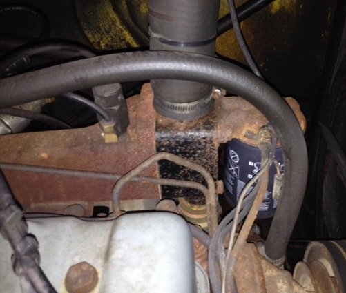

Thanks Keith.  I'll have to do some checking tomorrow and see where I can tie into the waterpump.  I know I don't have room like that as the 673 pump is shorter and the pulley covers up most of the pump.
Image.jpg.614ac22f3131a274db73ed0a083c96
 Pretty sure mine came off the casting(where the oil cooler is at) but my 237 doesn't have a fitting there(just like yours doesn't).

The B75 has a longer hood than the B61 so the 285 water pump could stay in place.  Routing is pump to heater core back to the valve on the water manifold as pictured above.

have you thought about making the return < t > into the compressor?  I don't know what kind of flow you would have tying back into the water pump twice if I a reading what you wrote right.

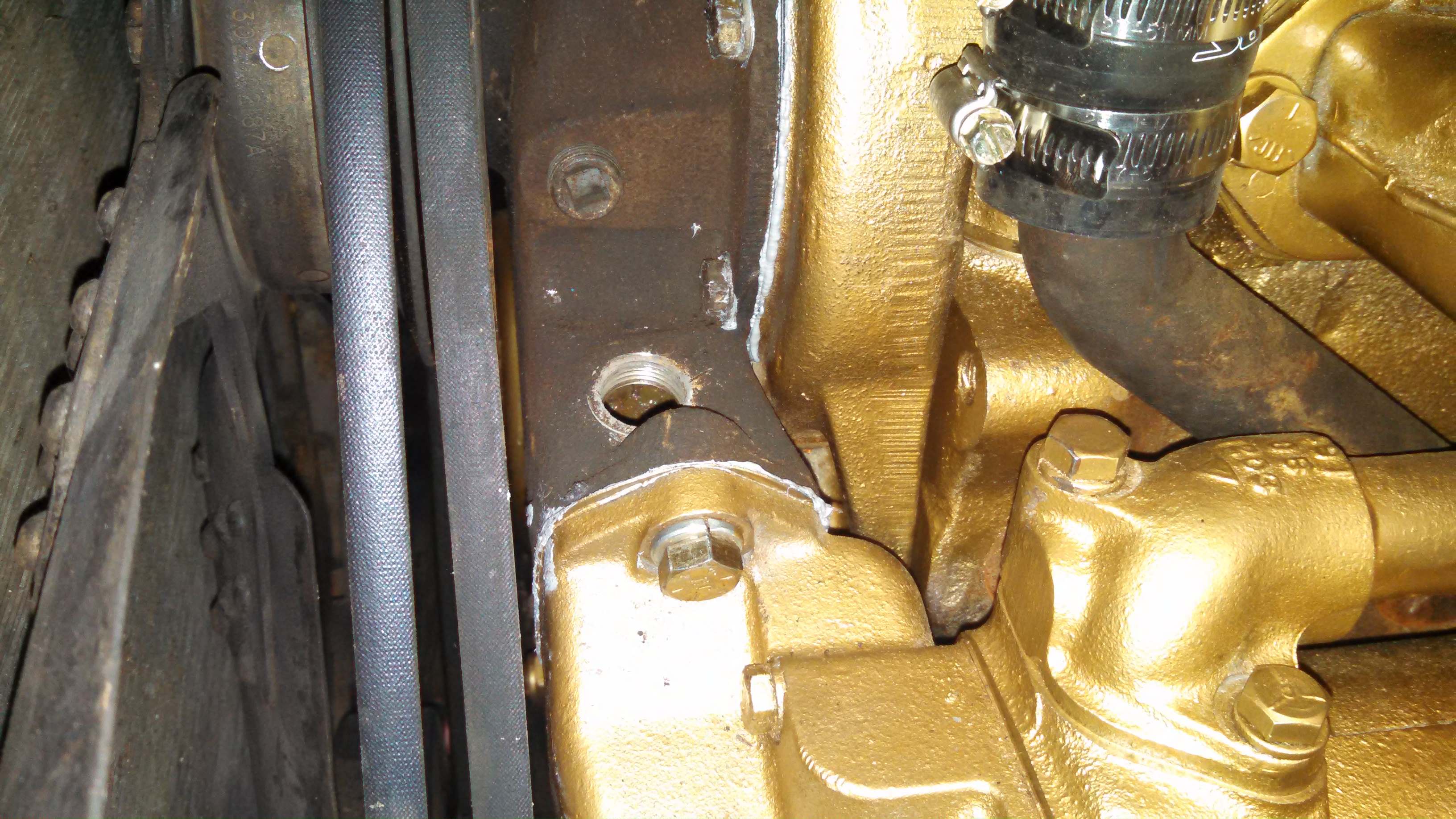

The original line came back into the casting the water pump bolts to(which is now the oil cooler-see the flat spot on top of the elbow going to cooler).  I found a plug in the water pump to use.
