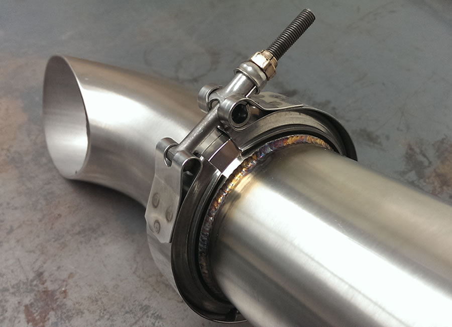

WTF......can't I buy V clamp for my exhaust??  No one has a clue along with Mack dealer.  Got a wide groove version but it wont grab my downpipe enough.  I tried massaging the clamp but I think I will have to add some wire to the pipe side to get it big enough to tighten it.  Ugh.

I went looking for some for my Mustang. I called it a Vee Clamp, Gabrielli  MACK called it a Groove Loc,  Long Island Truck Parts called it a V-Lock clamp. Got them from White Water Marine Supply, used on Hypo boat exhaust.     Paul

Like the style Paul posted.  The joint between the turbo and first pipe should be V clamp Mack #48RU2341.  Seems to measure 4" using my calibrated eyeball.

Well, the first clamp I got from Cross truck was too big(5"), so I returned it for a 4".  It is a narrow groove and would not get around the big cast iron pipe.  They didn't have a wide version so I went to Mack.  They couldn't come up with a real part number(since I didn't serial number from the truck it came from) so he got a few from the back and I picked one.  It sorta fits but won't grab the pipe side enough.  It might be the downpipe I bought is too small on the clamp area for the clamp to grab it tight.  I am going to check the part number I bought and compare Jim's number.  All else fails I'm going to just modify the pipe side and make a "spacer" to thicken it up and give the clamp something to hold onto.  We'll see.
The clamps are made by Breeze that I bought.

Thanks Robert for the link.  Looking at the dimensions, the one I have is pretty close to what I need.  The "C" dimension hits the casting(on the turbo side) before it hits the pipe on the other side.   I think the biggest issue is the flange diameter of the pipe I'm using is just small enough that it won't fit up into the V enough to clamp tight.  Thus I'm going to thicken the width just about 1/16" to get the clamp to tighten up on it.  Going to cut a ring from some sheet metal, just enough to fit the flange area.
I looked at BT10494, it is just a touch thinner at the "B" dimension.  Not sure if that would help or not?

I posted a question in the fire apparatus forums and Don stepped up with a VIN number for me.  My local Mack dealer had the clamp in stock and my exhaust is now assembled.
I can't say enough about the people here.  From mass confusion to the right part in a matter of a few hours.  Thanks guys

Well, all is better........now if I could get that clamp to tighten enough to make it NOT leak.  Ugh.  I pulled the casting off the engine, used a small hammer to "finesse" the downpipe to fit the taper better.  That helped, not totally.  Might try some hi temp silicone, as the casting is kinda rough and likely why it leaks.   Once I get that done I will get the other fender back on.
