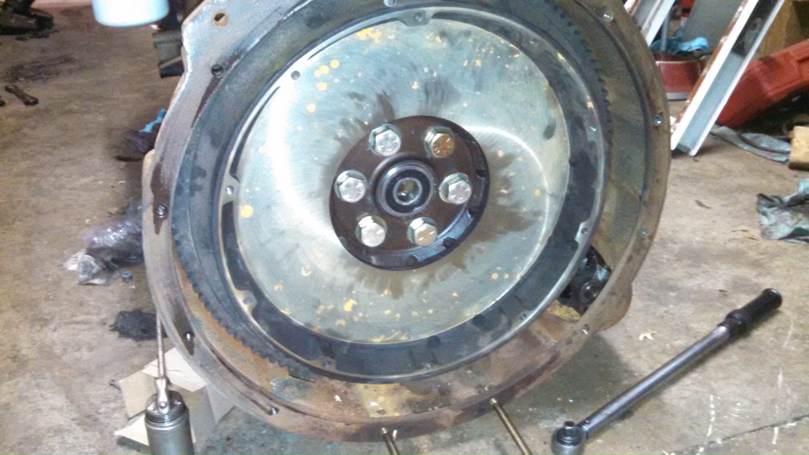

This is me, at work, using our G/L Horizontal mill to open the holes.
Since I couldn't get the bolt pattern leveled out easily enough, I used a tight fitting test pin in each hole and lined the chuck up.  Then drilled that hole.  Moved around the pattern.  If I could have set it up a Bridgeport, it would have been easier to spin the wheel around and pick up on two holes to get the zero on X and Y.   I was still concerned that the holes would be right.   Got it home and bolted up perfect.  Holes were still dead on.  Sometimes a plan comes together.

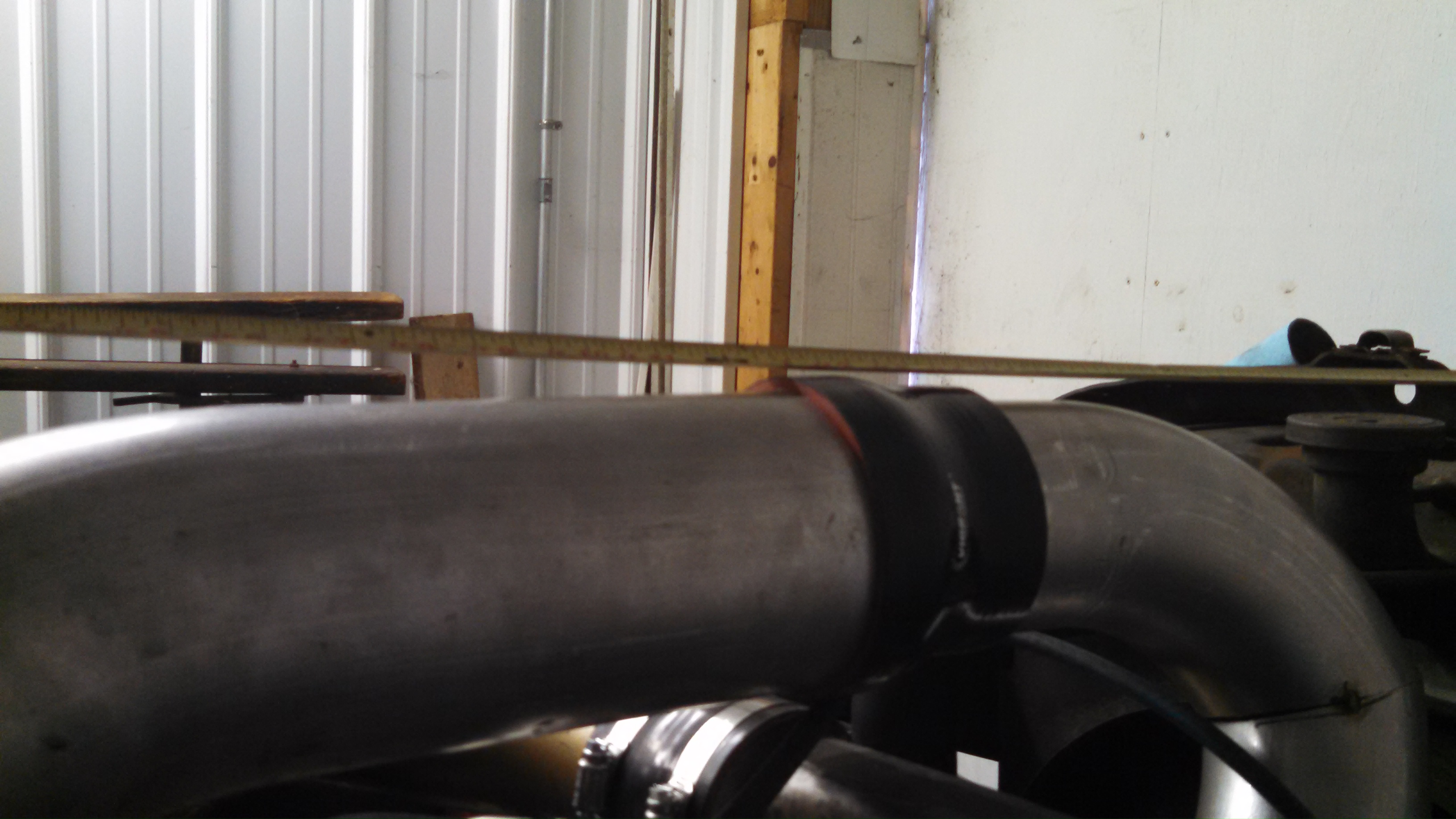

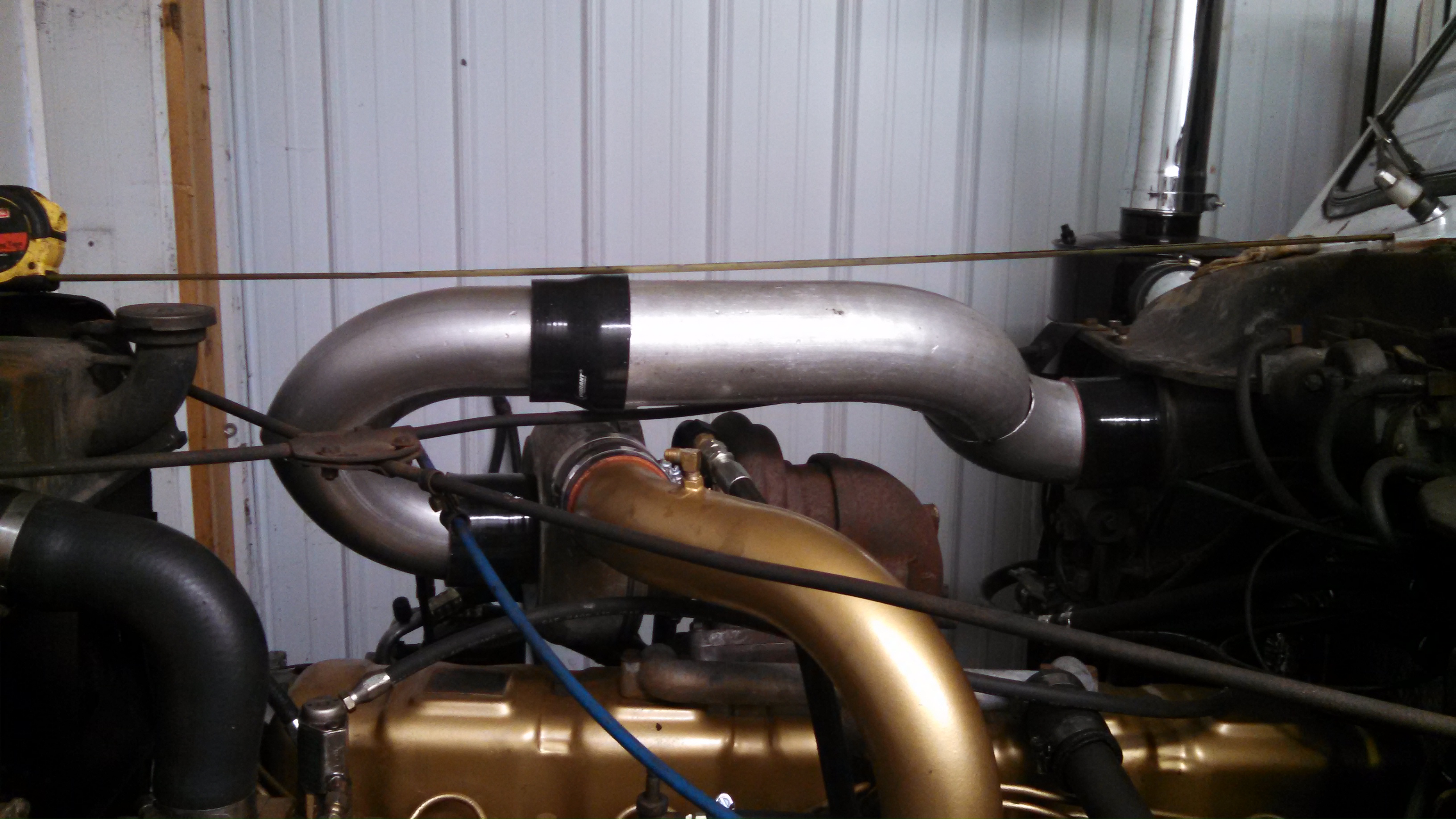

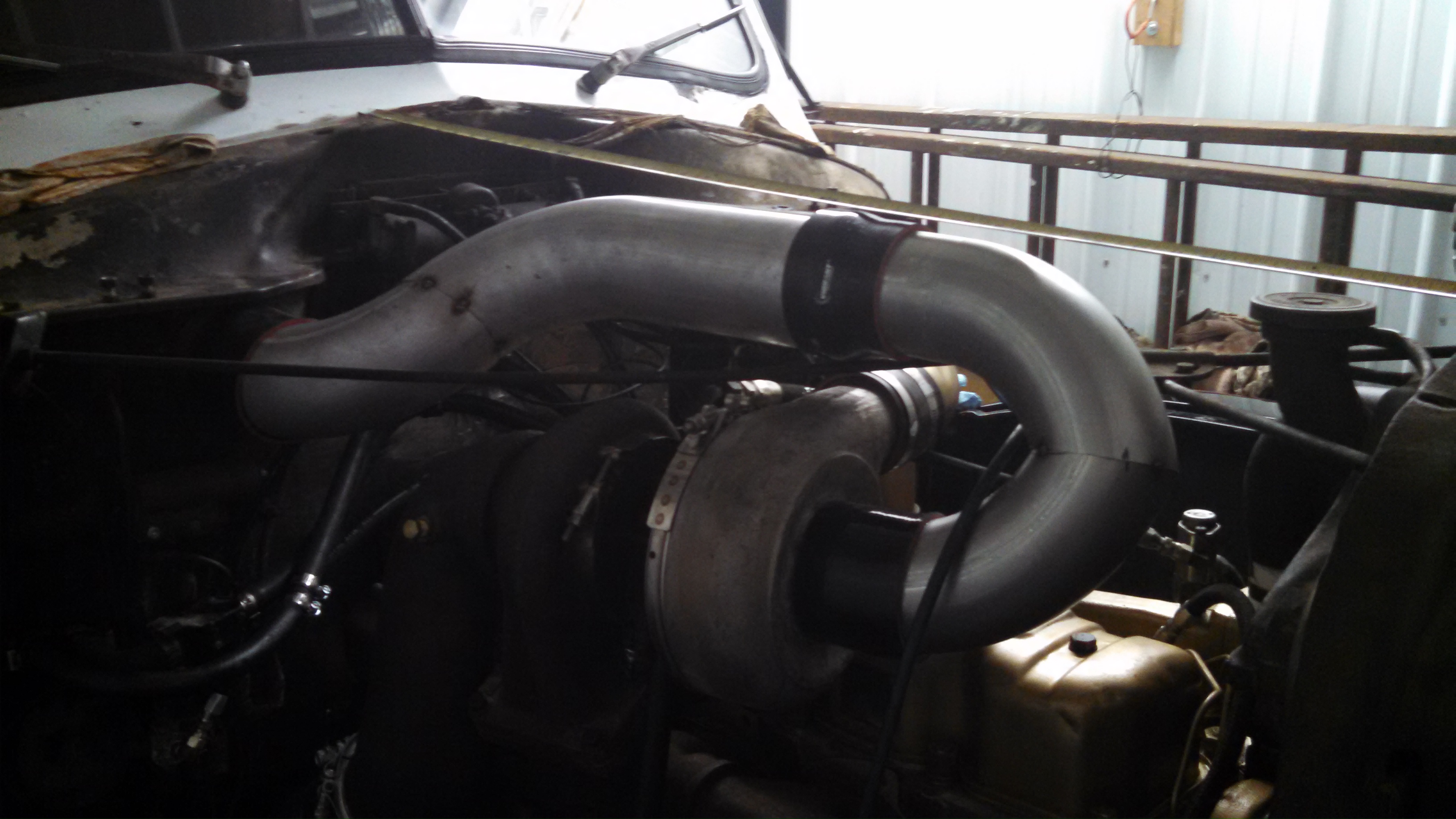

Working on air intake.  I think it is turning out well.  Looks like it should JUST clear the hood.  Tape measure is approx. hood line.
Getting tight enough radius wasn't possible so I had to cut them.  Not what I wanted but will work fine for this.
Finish welding and some gold paint so it looks like it is suppose to be there.  Would love to done alum but that was not in the cards.
Had to step from 4" at air cleaner to 3 1/2" at turbo.

Looking good. Nice fab work. Going to look really clean and well done when you're finished.
https://www.bigmacktrucks.com/topic/42967-237-flywheel/page/6/#findComment-330009
Nice work, it does look close to what should be there. I do my own fab work too and try to make it look correct as well.
Two suggestions. Get the tube bright ceramic powder coated not gold, it does look really good and just like aluminum. If the radius bends really bug you, as they would me, use the rubber elbow that are available. I looked for the rubber ones and the small size is a problem. Summit racing has smaller rubber ones or Silicone turbo elbows with tight bends.

I'm thinking of going alum or silver colored.   It might look a bit more like it should instead of gold.
The radius deal isn't a deal breaker.  It looks okay and will work fine.  I could look farther for something else, but getting the right radius is still a shot in the dark.  Like I usually say.."good enough for who it's for".
Powder coat is possible, need to check with my buddy and see if he is running anything silver in the future.
With just moving the truck back/forth the new clutch is smooth as glass.

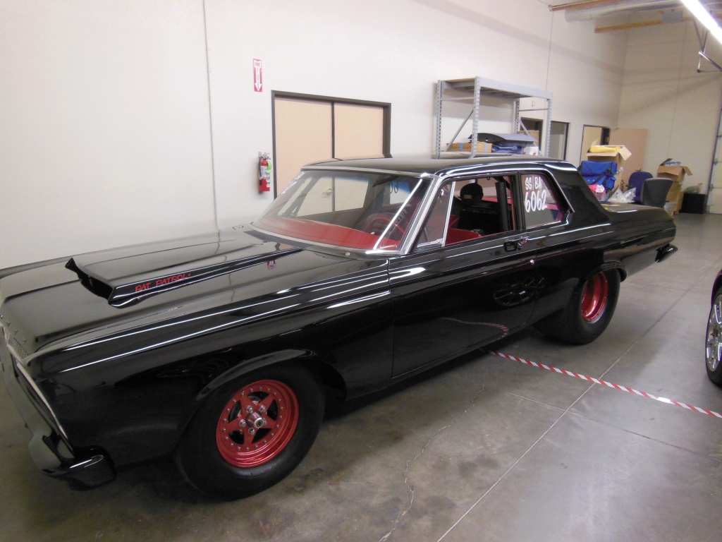

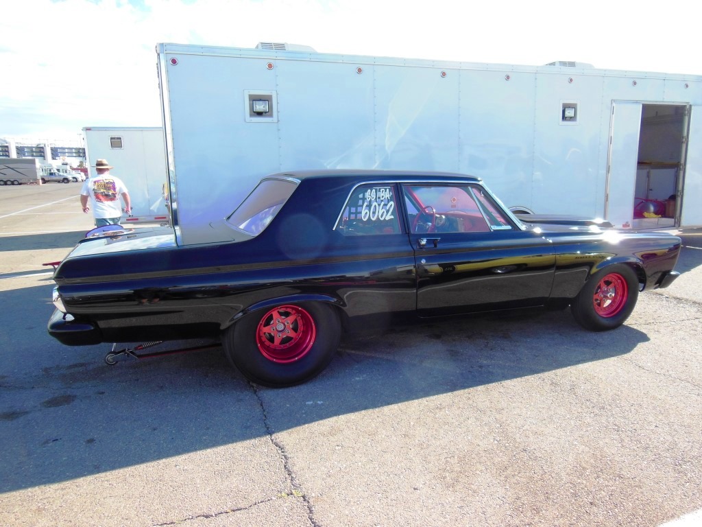

My Old Plymouth SS, 548 Hemi, 727 Torqueflight, 2x4 Crossram, roller motor, 4.30 gears, 2940Lbs, Best, 9.31@145. Should go 8.7? with new all aluminum  605 Hemi and drop 150Lbs when I get around to it. No electronics, Old school mash pedal and GO!! Got beat by that FE Ford when I had to pedal it not to break out, I don't pedal well, O Well... Don't like loosing anyway.
Might want to think about some wheelie bars for that Ford, I'd be blowing by while your heads looking at the sky.

Good looking car.
Already got those installed.  I bought the 60" kit and found out they still just barely make the back bumper LOL!!
I'm still at a stealthy 3850#.  Down from the original 4600#.  I had a chance at an all alum 482 FE, made just under 800hp for PENNIES on the dollar.   I knew what it cost to build and it came on the market a year later, never installed, only dyno time.  Ugh, just didn't have the cash to piddle away on it.  My motor makes 625hp, for a plain, flat tappet, no CNC work motor it isn't bad.

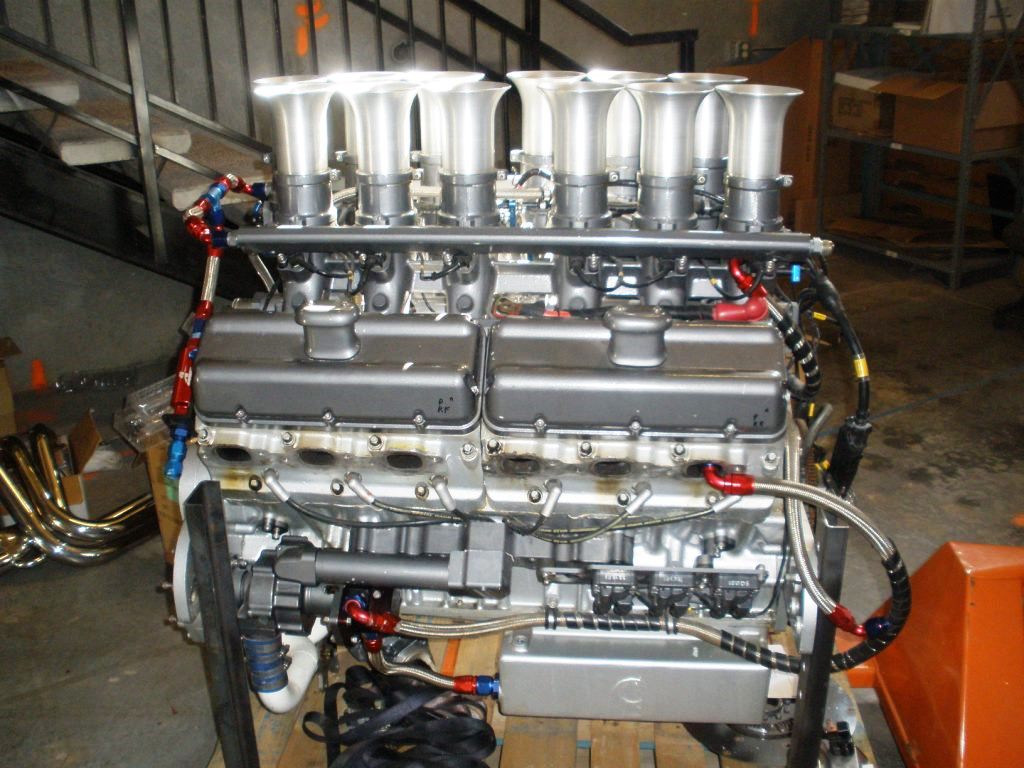

Those wheel bars should really help. I like hanging them in the air but... no control. On the ground with all 4 is a good place to be. Holly Cow and I mean COW. That is impressive to run that good at 3850Lbs:thumb:
All aluminum isn't going to help that much with all that weight.... Well maybe I have the answer for you,... a couple of the dinosaurs I have to play with:chili:

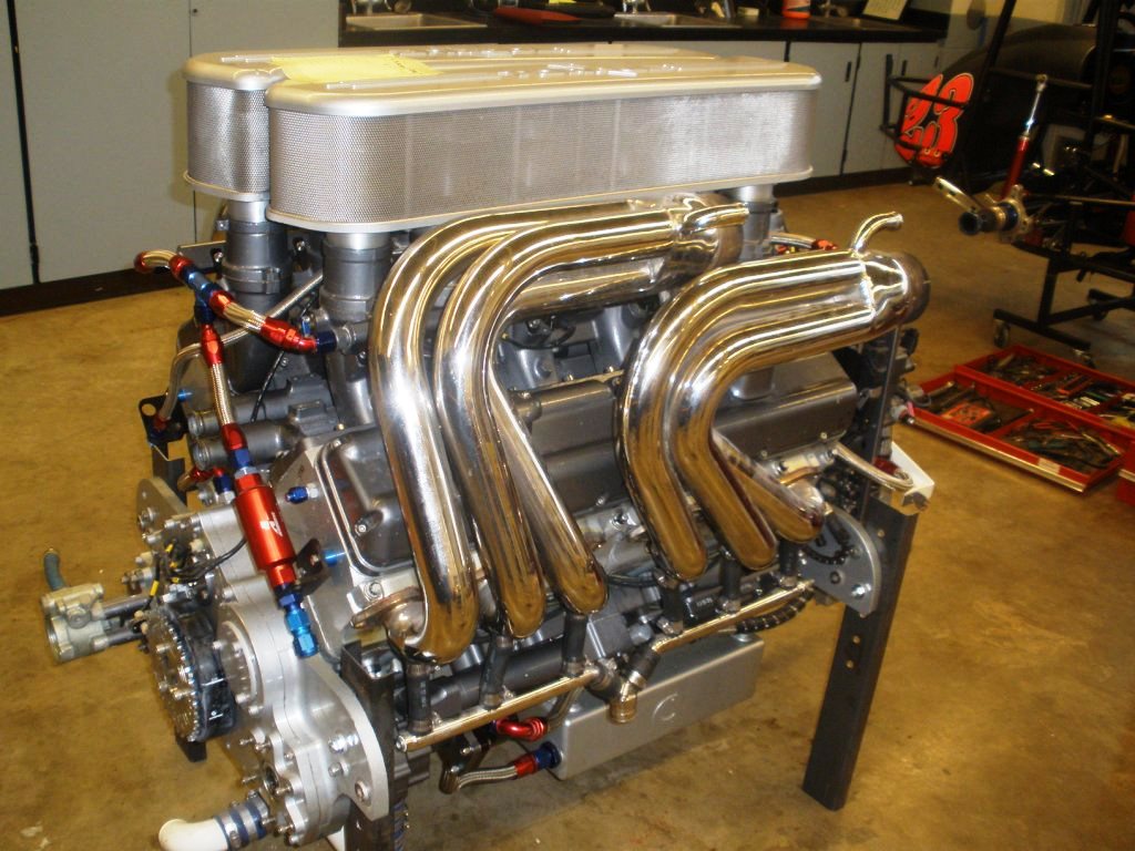

All aluminum V12's, 860cid, a little heavy at 1000Lbs dresses but.... Just like a good looking woman that has a few extra pounds... It's what you do with it. Pure Auto Porn at its Best:rolleyes:

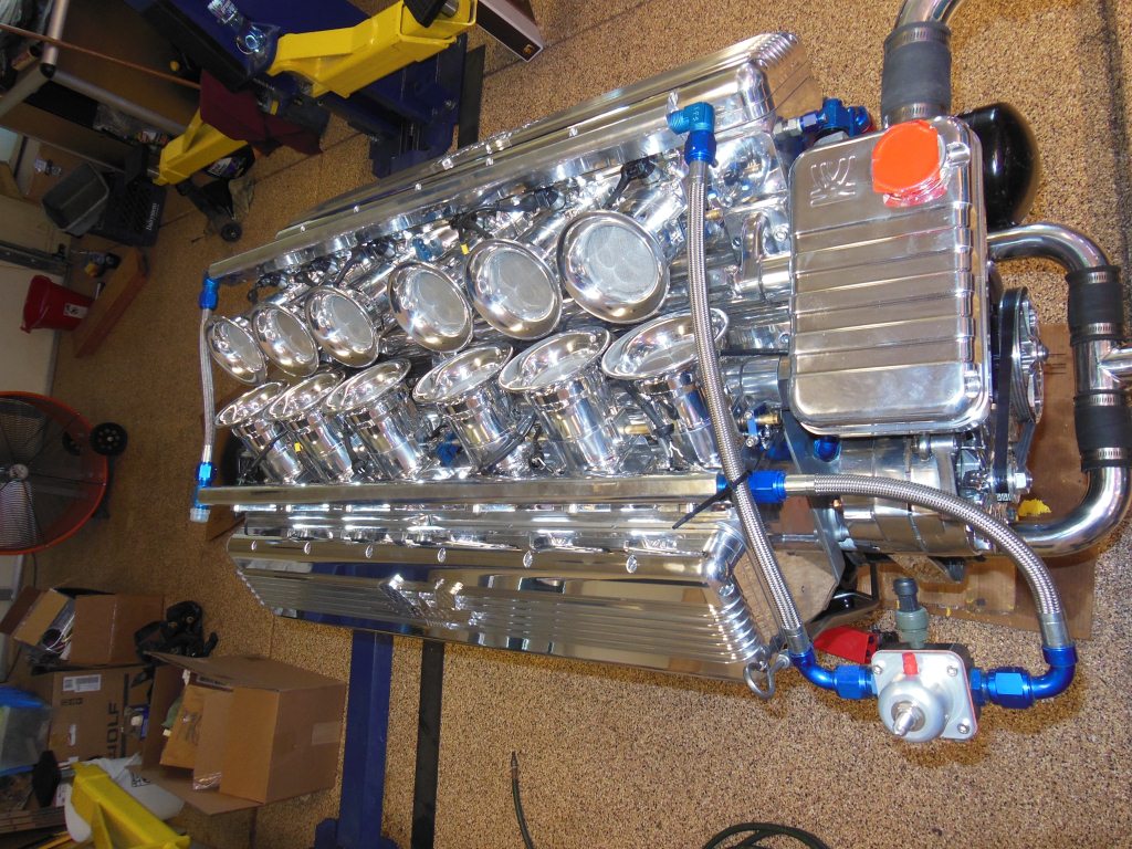

Take a look at the valve covers and coolant tank on the last one. What do you think its is going in? Been in the works for 5 years now. You should know real quick Larry. It will really move at 2600Lbs, is a clue.

Looks like an expansion tank from a Galaxie!  Only the outlet is on the drivers side.  The top picture looks more boat oriented?
Is that an outlaw car in the upper picture?   Some good motor porn for sure!
