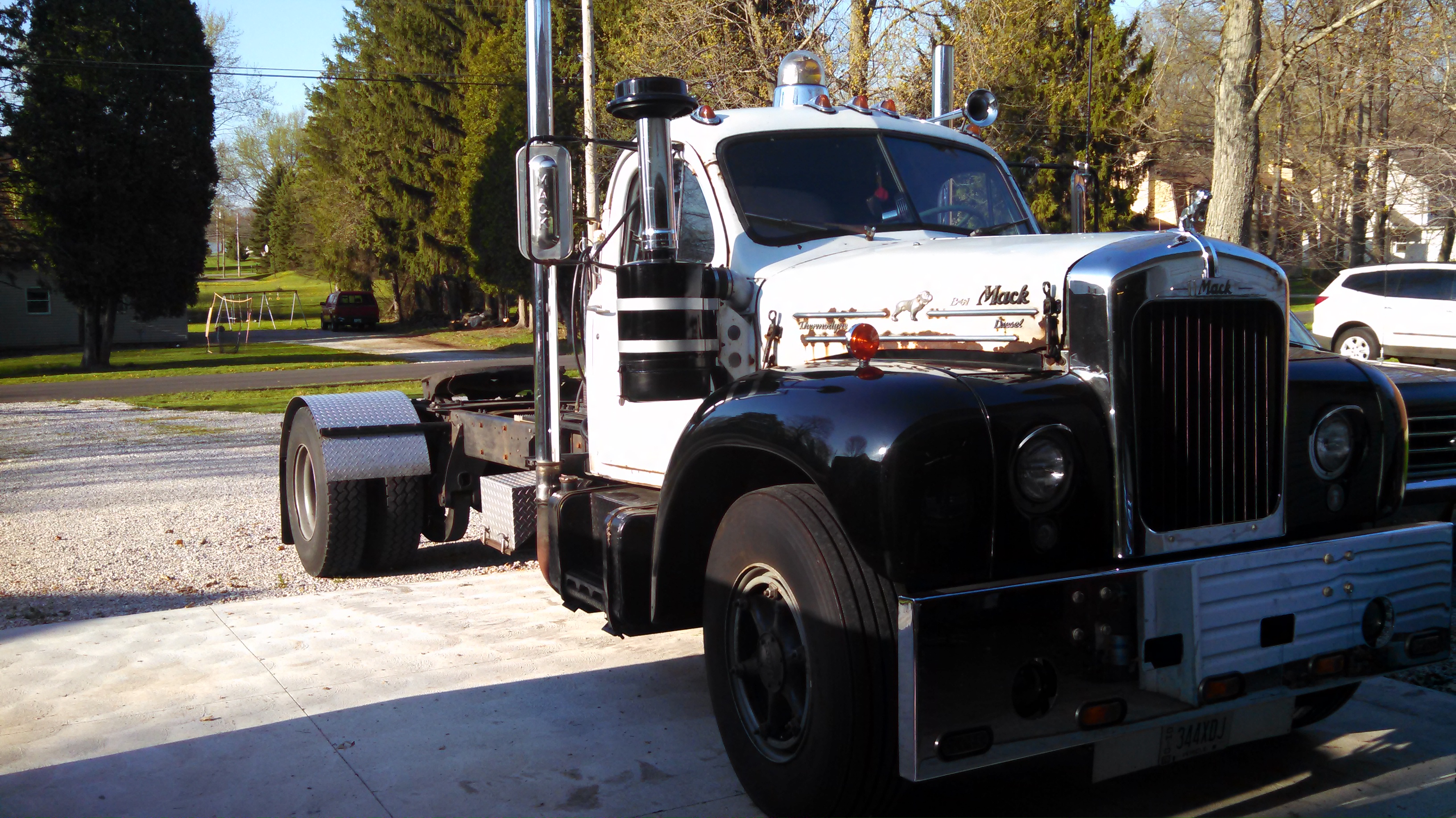

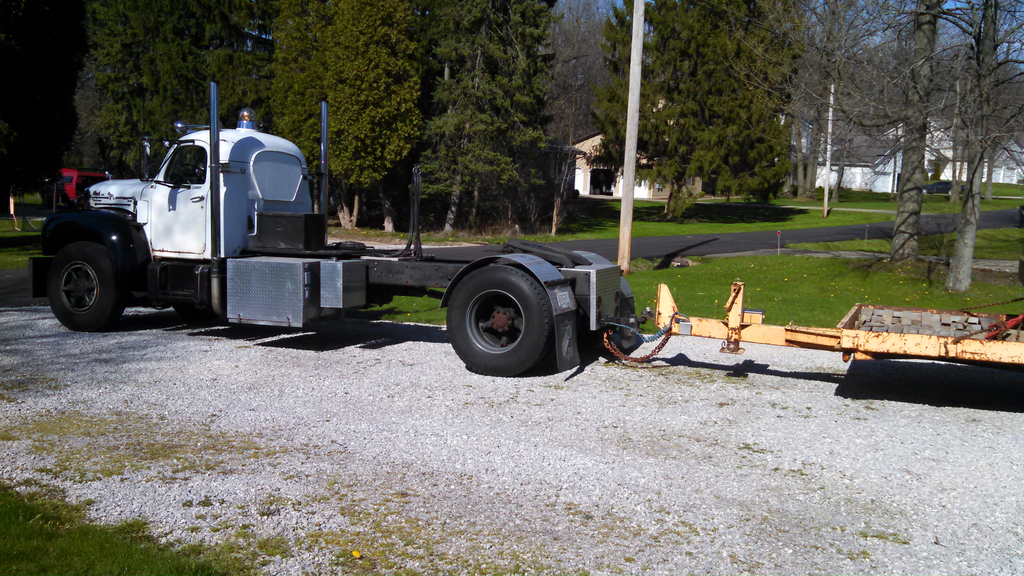

It is kevlar.  Put the bobcat on the back and now it is fine.  10# of boost and it pulls it fine.  I'm pretty excited with driving it.  Can't wait to get my trailer on the big road and roll with it.  Even straight piped it is even more quiet in the cab then before.  Sounds good out the window, would like to hear coming done the road!

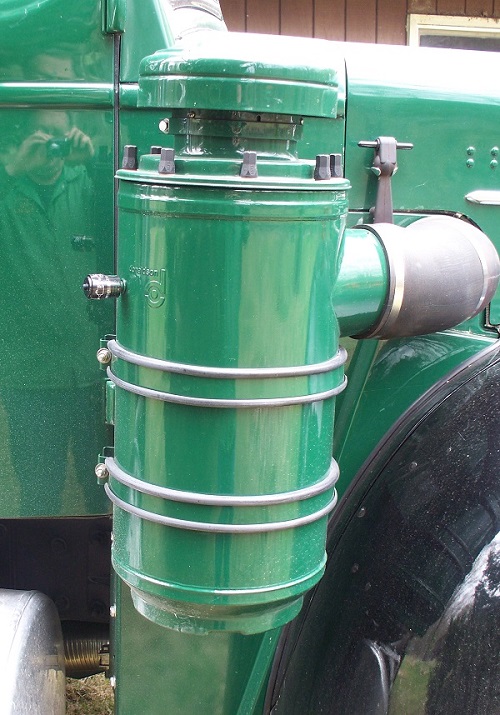

Here's a pic.  The body is 22" tall and takes a Fleetguard AF-966 filter element.
The B75 has the fender to cab filler panel so this may not be suitable for the B61.  You may have to scout around to find the correct height dry housing to fit.

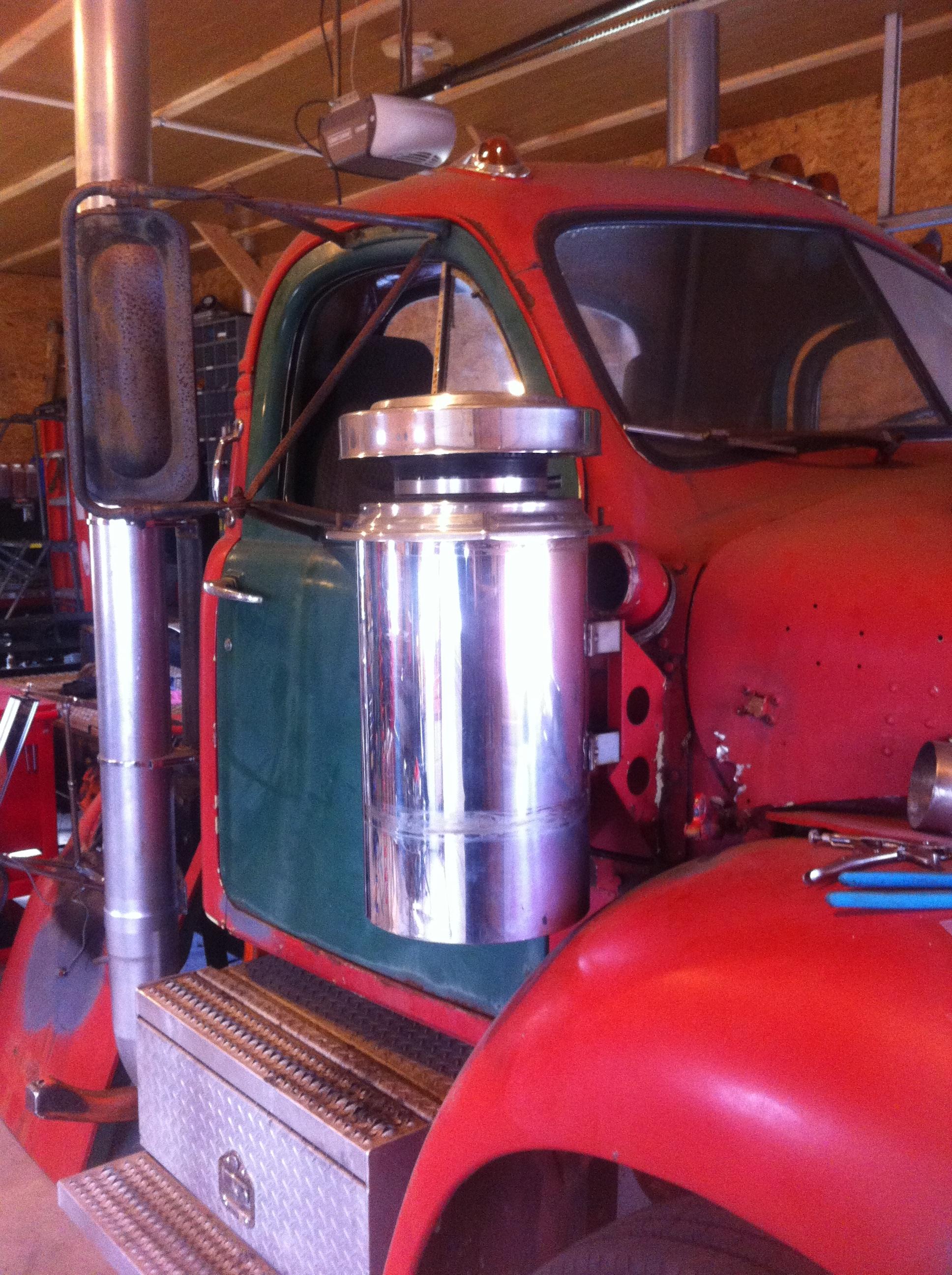

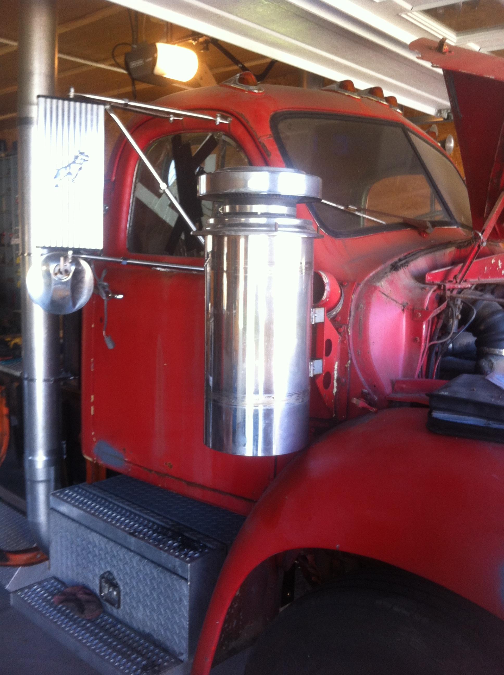

I have a stainless one off a freightliner classic.  It's the Nelson not Donaldson.    My buddy crossed filters over and found one about 3" shorter. Then he cut the welds and shortened the housing.  Also had to weld a new neck on it.   I don't tig weld so its at his shop now.   This is the only pic I have right now.                                       image.jpg
https://www.bigmacktrucks.com/topic/42967-237-flywheel/page/7/#findComment-331509
Nice!  I suppose with some work I could do the same kinda thing.  Just need to find a bargain on a housing.  I want to keep my riser on the top, as I like that raised option.
