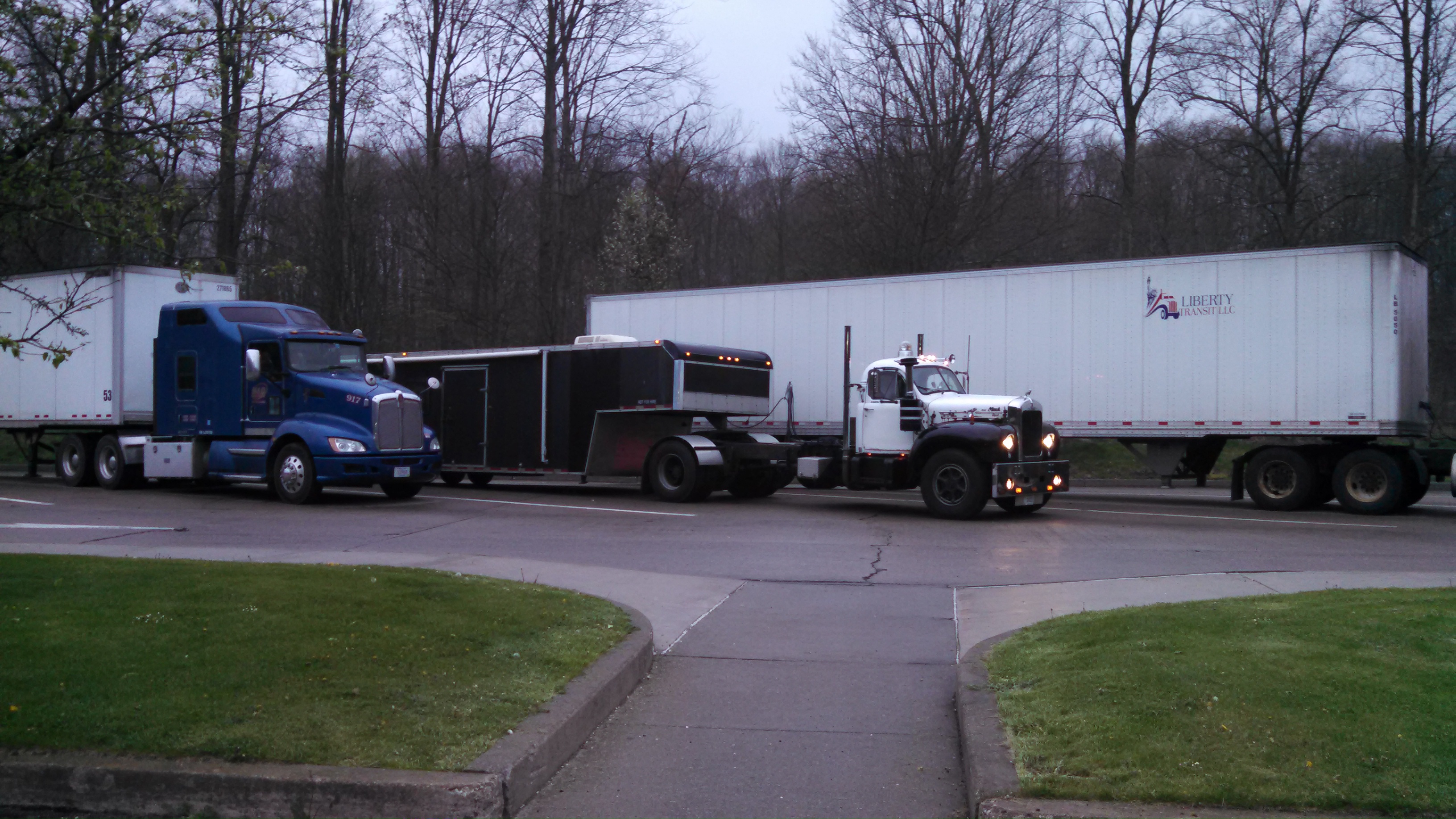

34 minutes ago, wingman said:
I like the long look, but kinda liked the shack on the back!
Me too!    Paul
https://www.bigmacktrucks.com/topic/42967-237-flywheel/page/8/#findComment-332023
I like the long look too.   As for racing?  Yes they got the race in but I parked the car before eliminations.  The traction was so poor that in four passes I never got a full run.  Three of them I tried to take out the photographers on the left side and the last pass it tried to change lanes and spin around.  I was pissed and put it back in the trailer.  The track was too cold no matter what they tried.  I had a good time overall talking with everyone.  Racing sucked...,they need to get this set up later in the year when it is warmer.
The truck performed flawless.  Online issue was my wipers took a dump about an hour from home.  They would only go one way.  Guess I need to check some airlines.  They only ran 10 hrs of a 12 hr drive.
Larry
https://www.bigmacktrucks.com/topic/42967-237-flywheel/page/8/#findComment-332054
