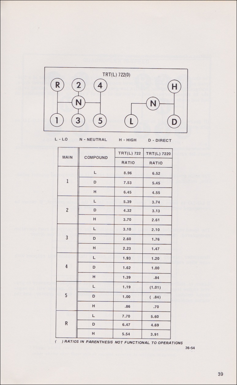

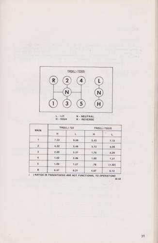

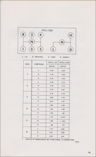

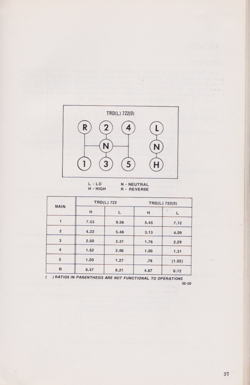

i"m not sure, but maybe some shift patterns will help figure things out.
Some advice from the experts will probably be needed also.
Not almost about that.
The patterns you posted are of the Mack built TRD/TRT/TRQ factory transmissions.

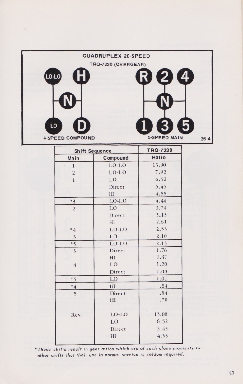

First what are you dealing with, got a 5 speed, sound like direct in 5th. A 3 speed Aux, box is worth about 200 to 300 RPM's in overdrive. Like Superdog said it should be good to 75 MPH @ 2100RPM. I like 4.17's got them in my B with a double over Quad and 75MPH is 1800RPM on big rubber.
https://www.bigmacktrucks.com/topic/42970-top-speed/#findComment-317321
The trans with L N H is kinda what's in my dads R 600. It has R1-5 on the right stick. And L-N-H on the left stick low is toward the back of the cab. High is against the dash. It is the .78 od Truck will run 75 mph with 4.17 at 2400rpm when you put it in OD it drops rpm to 1200 at then she will be in pass those big talking fast Peterbilt gear. Lol. It should gear out at 130+
