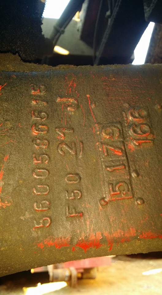

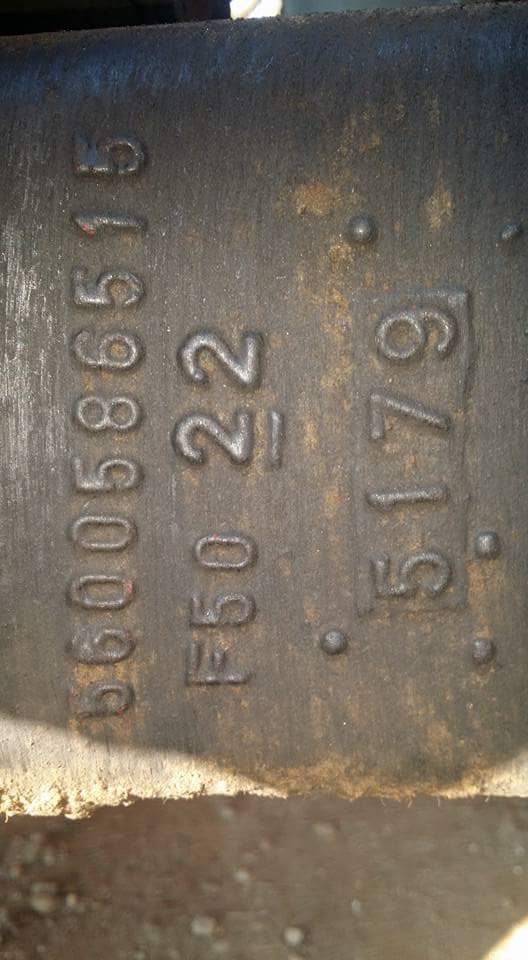

I trying to figure it out what i got on the truck is a 2006 mack granite with dual axles on the back
I think i got 44000 but not sure and i would like to know how much weight can i legally carry with that set up any help would be appreciated it
post-22123-0-83408100-1449796396_thumb.j
post-22123-0-09526200-1449796405_thumb.j

What suspension do you have and where are you located? Certain suspensions only come with certain axle ratings. How much you can put on an axle can vary depending on your jurisdiction. As an example just because you have 46,000 rears on a truck in Canada doesn't mean you can carry up to its maximum rating. Axle spreads can also dictate maximum load per axle. Need more info.
