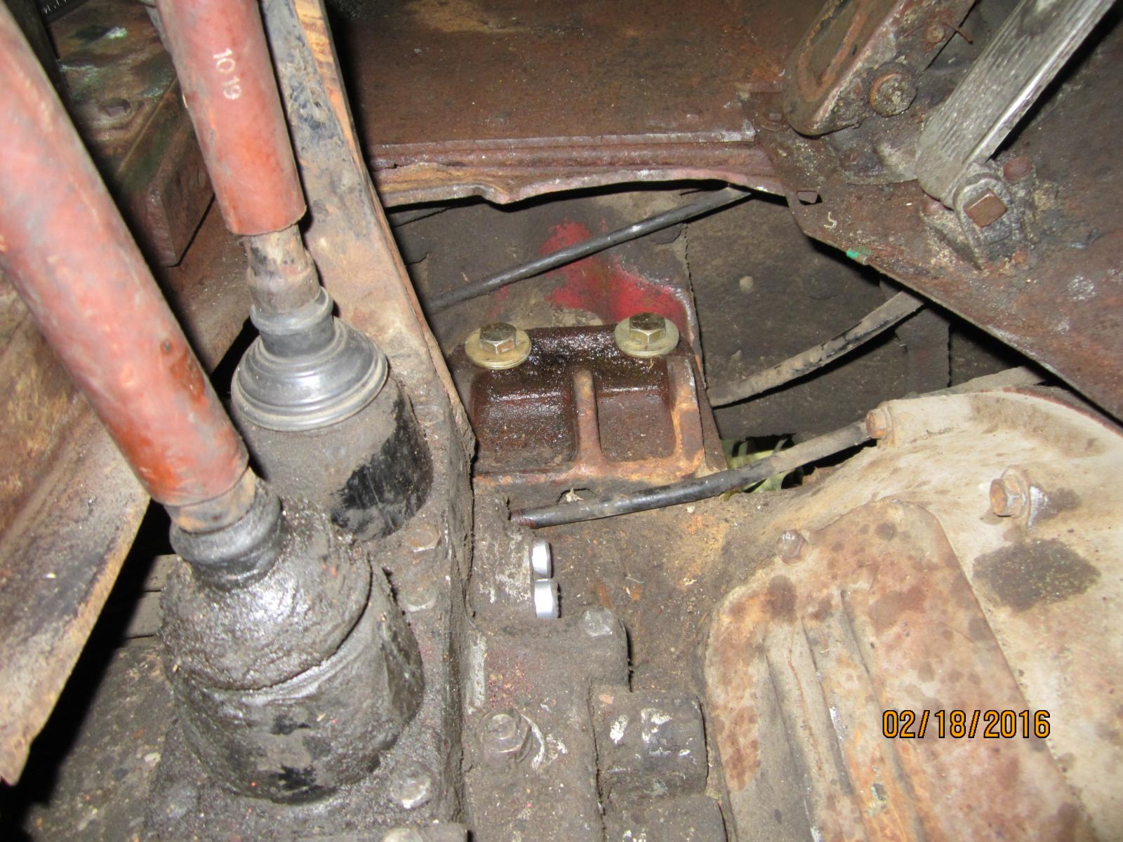

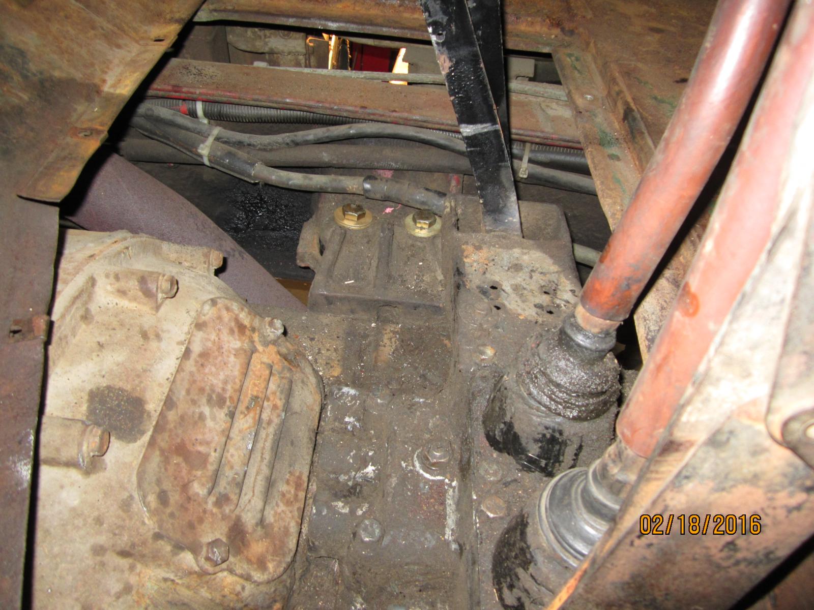

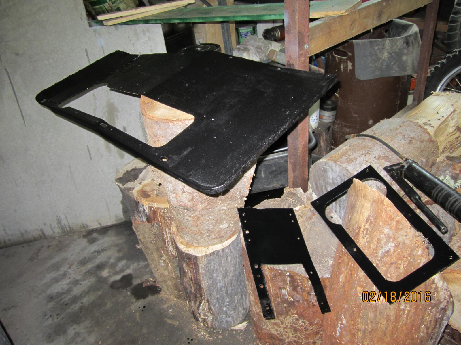

Today I finished painting the removable steel floor pieces (floor board, thin sheet metal holders for rubber gaskets around shifters, etc, steel box that covers the series parallel switch, and PTO/dump levers). While the floor board is out, we replaced the transmission mounts on both sides. The rubber, bolts, washers, and nuts are all new. The old mounts were absolutely trash.
Tomorrow I hope to back the truck outside, wire brush the rest of the cab floor, paint it, and then change the oil, oil filter, and clean the air filter.

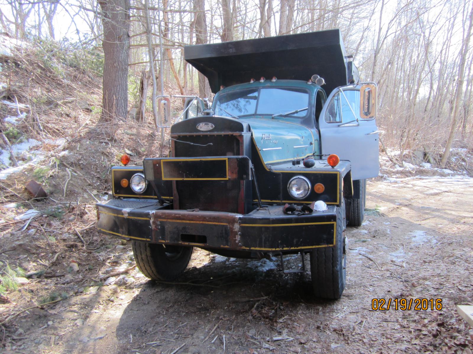

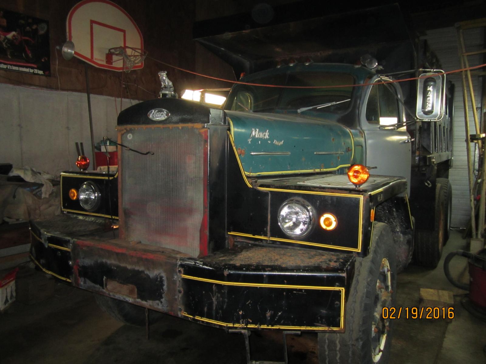

Busy day today.
1. Removed the plow frame. This B-81 will most likely never plow again now.
2. Removed push plate and support arms.
3. Changed the oil and oil filter.
4. Changed the fuel filter.

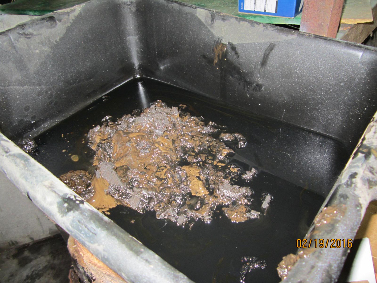

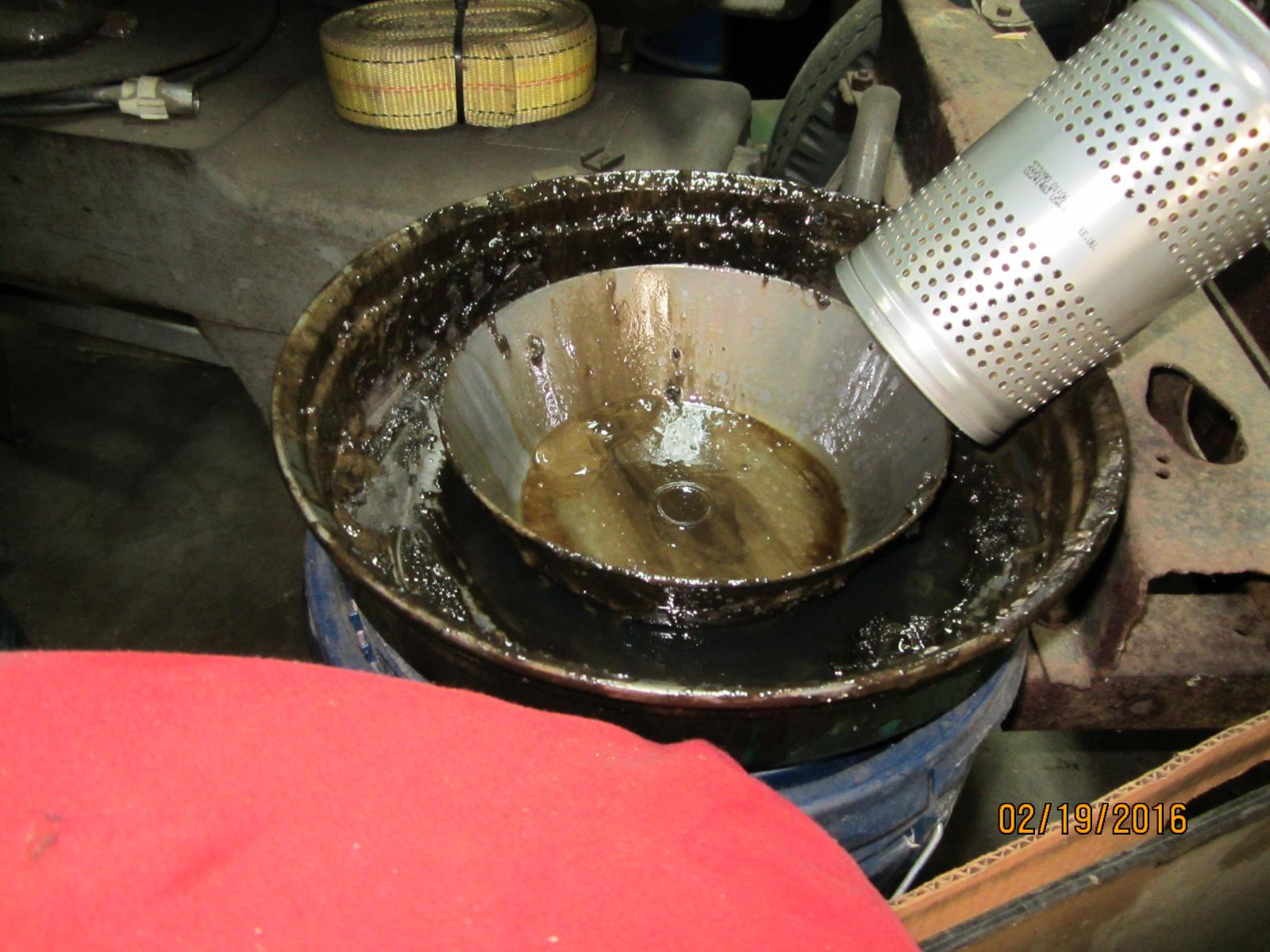

5. Started cleaning the air cleaner. Started. The bottom pan was nearly chock full of silt and oily dirt. Last two pics show some of it.
6. Wire brushed the cab floor.

I'm not sure how efficient the old oil bath air cleaners were for fine particulates and such, but they did collect some crud for sure. The one I bought on here was loaded with crap. The truck is looking good...I sure do wish I had tome and funds for mine...maybe later in the year...I hope. Looking good.

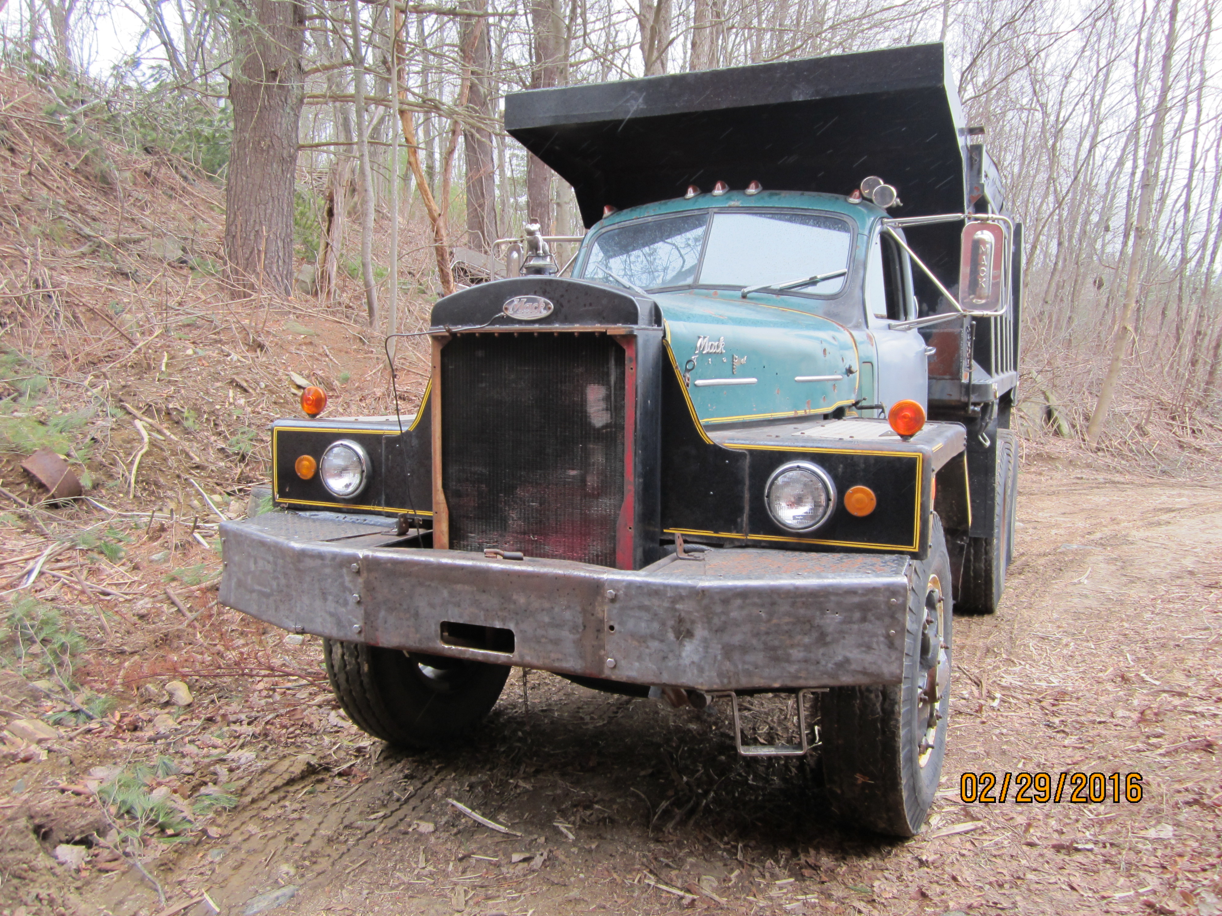

Have you been hauling any dirt?
Oh no. The dump body needs some attention before that happens. Aside from driving it around in the yard a few times, I haven't driven it much.

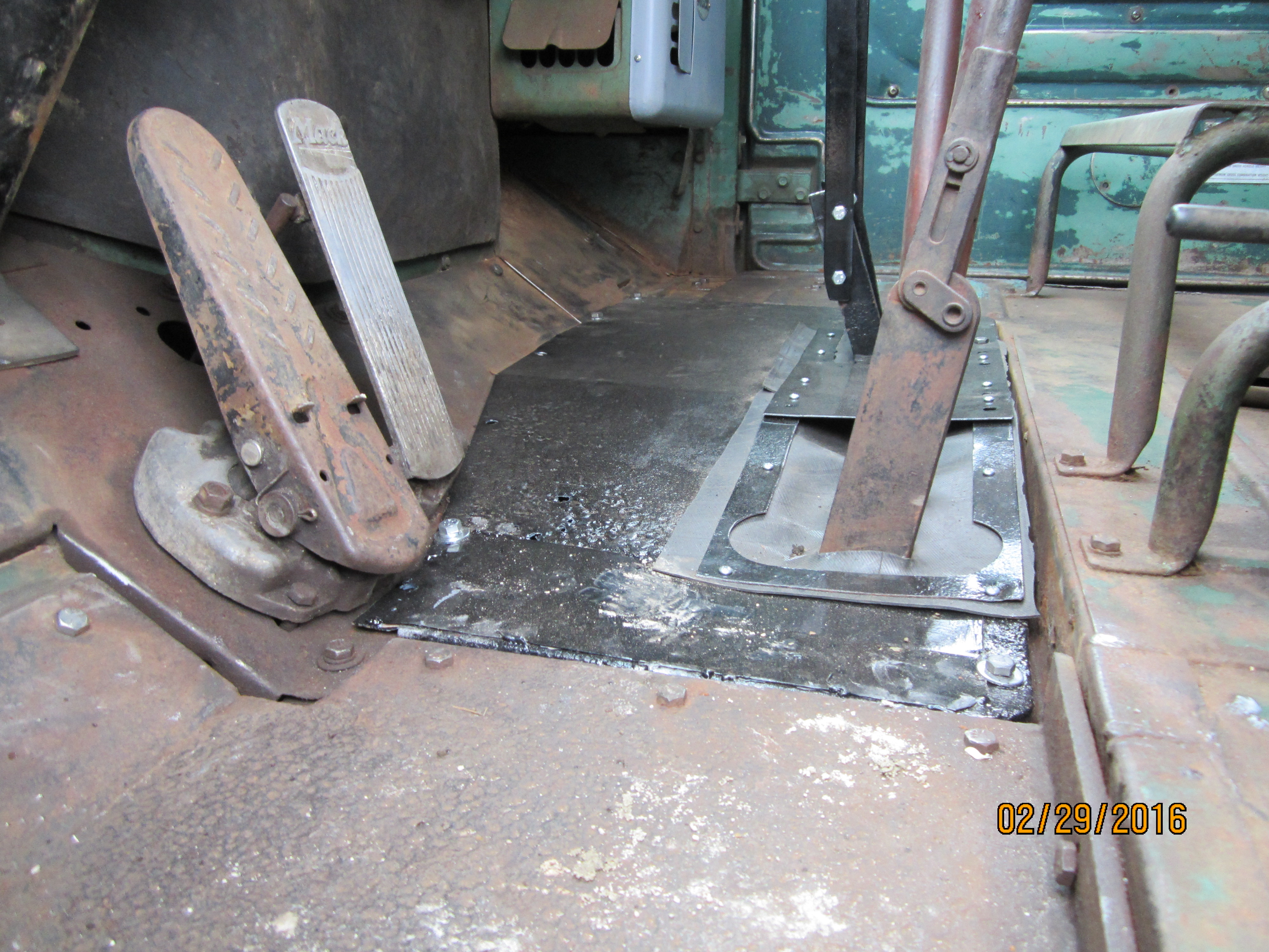

Also, the middle floorboard is done and installed, along with the rubber seals around all the levers through the floor.

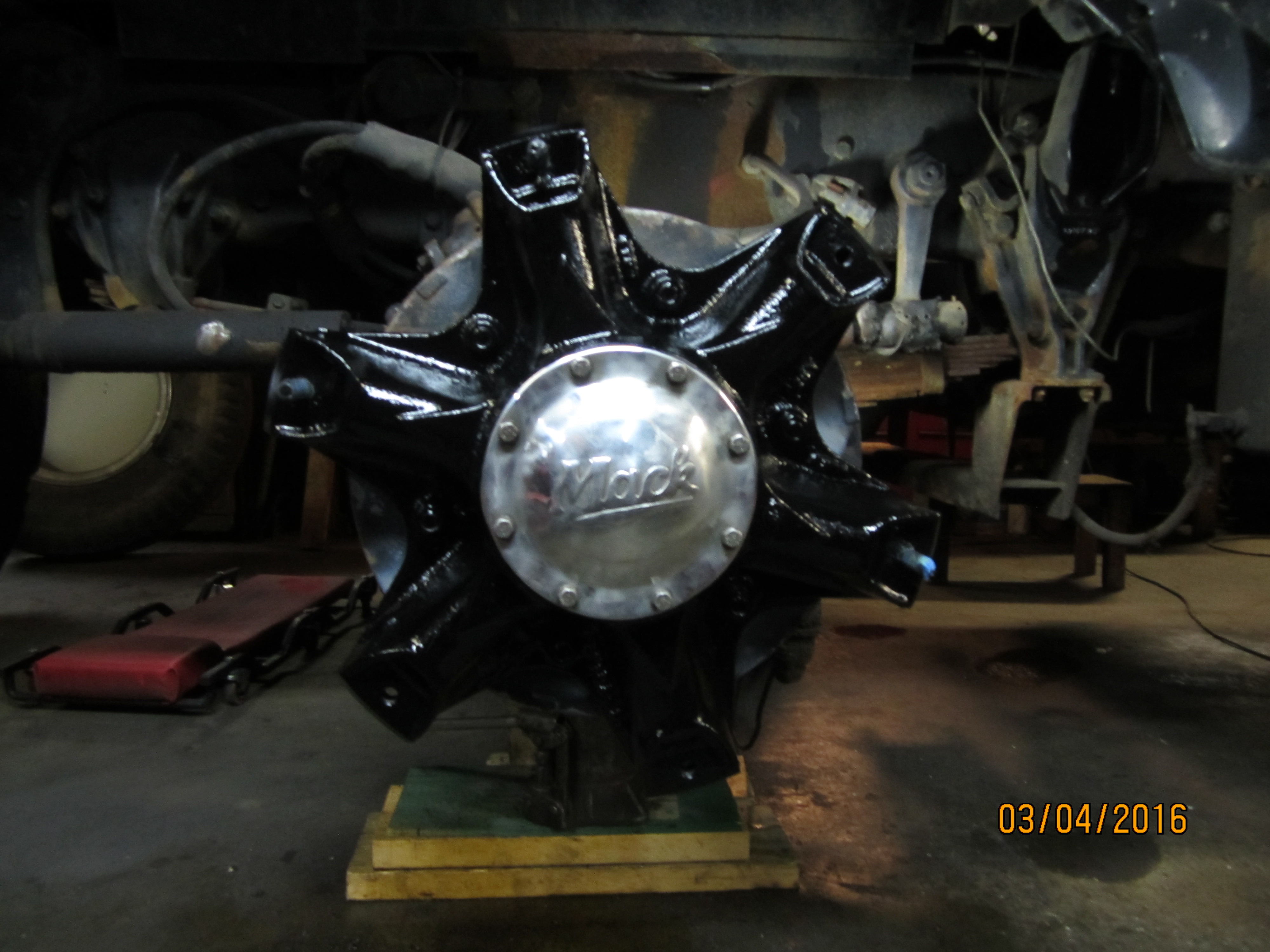

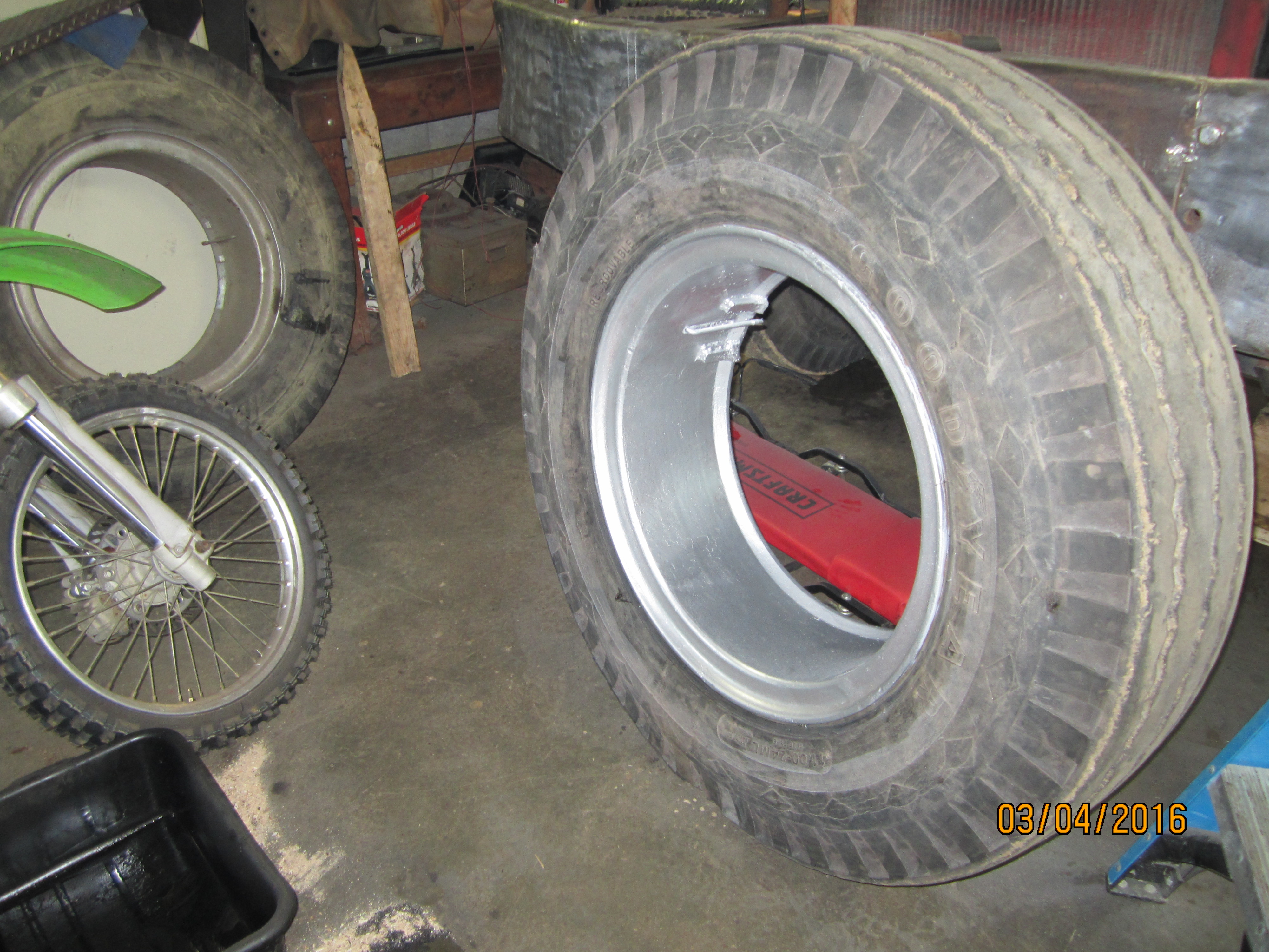

3. Removed left front wheel. Stripped, cleaned, primed, and painted the wheel (silver) and  spokes (black).

I'm kind of just going through the truck and addressing things as I see them. For instance, today I noticed the front cab mounts (under the fenders) were loose. Now I'm digging into the truck to remedy them. Also, while I have the front wheel off, I noticed the pin holding the clevis to the slack adjuster was frozen. It took a while (with plenty of lube and heat) to get it free.

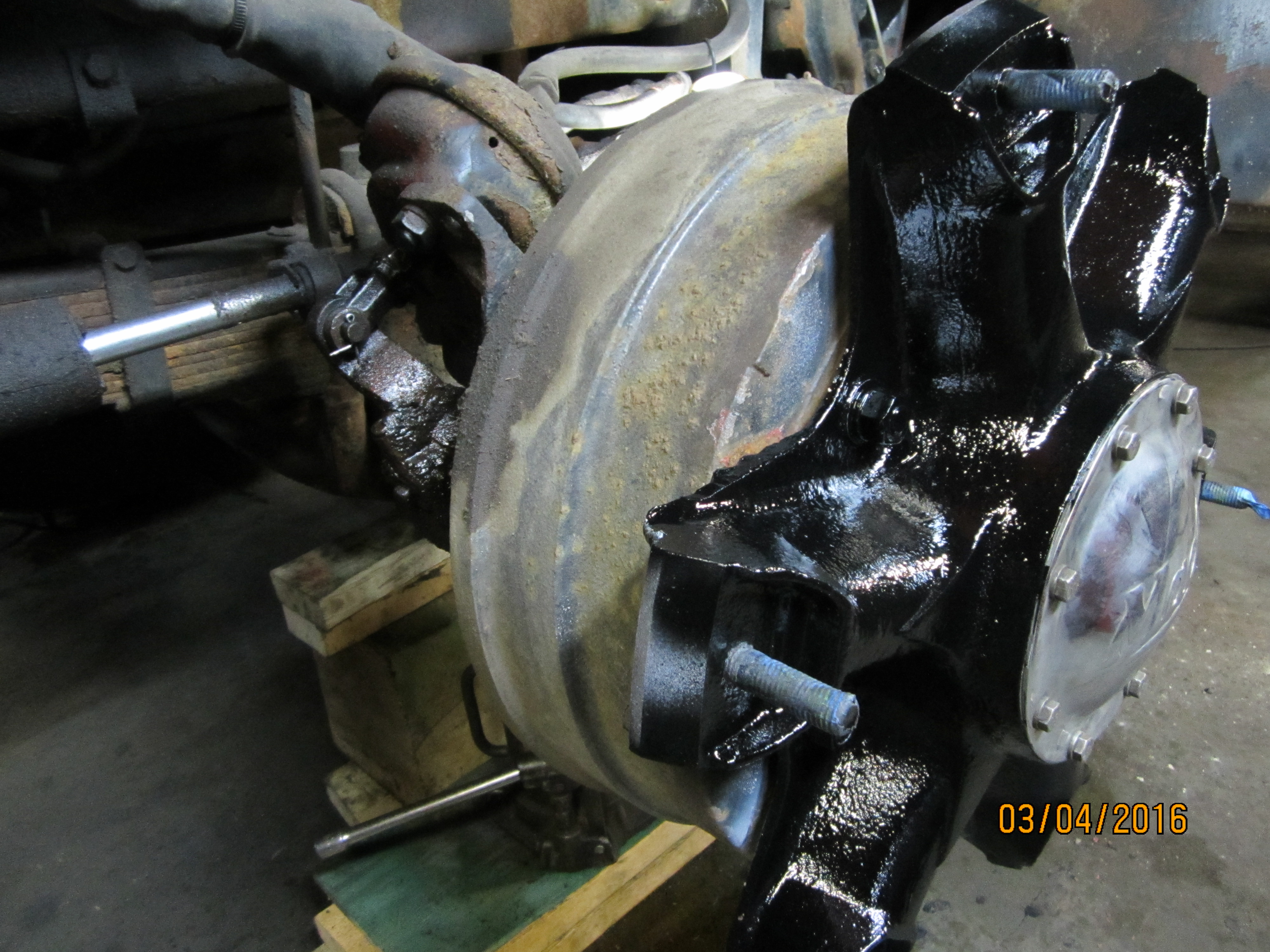

1. Mounted the left front tire on the truck.
2. Stripped the paint off the left angle fender and welded a few tears up to repair it.
3. Removed right front wheel. Adjusted the brake. Freed up the pin on the clevis that attaches to the slack adjuster and slobbered it with never-seize.
4. Greased the king-pins on the right side while the axle is jacked up and wheel is off.
