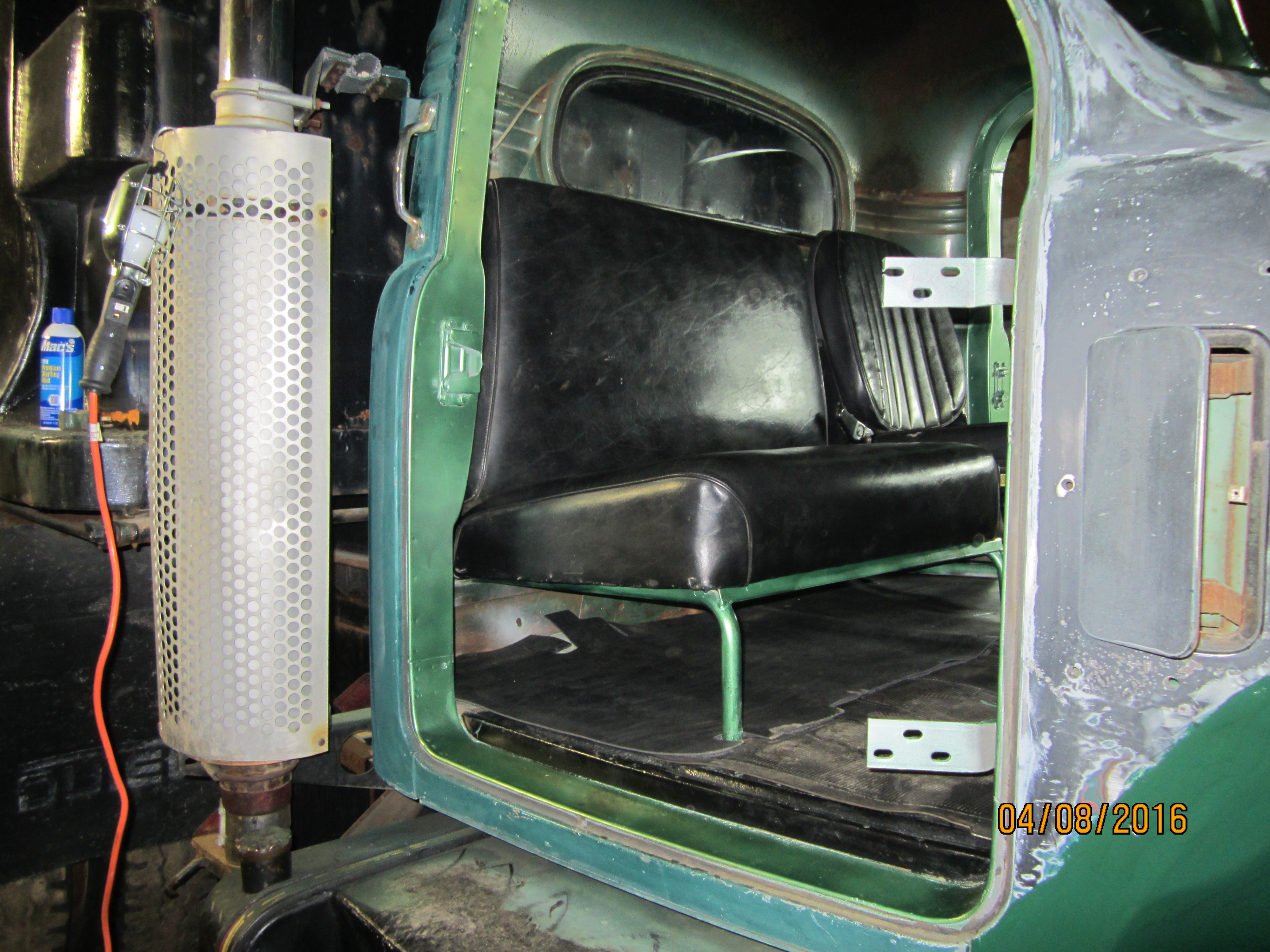

1. Mounted right front tire/wheel.
2. Made a plate to cover opening where the series parallel switch box was. Primed, painted, and installed it over the hole.
3. Re-installed the front floor mat. It looks fairly recent, but whoever initially put it in did a quick job, so there were gaps and stuff that had to be addressed. I used the Wal-Mart floor mats from last year's project to fill those gaps in and seal up the penetrations in the floor board (clutch, steering column, throttle).
4. Removed the air valve setup (for the plow) from the dash.
5. Removed the old push-button directional box from the dash.
6. Installed the seats.

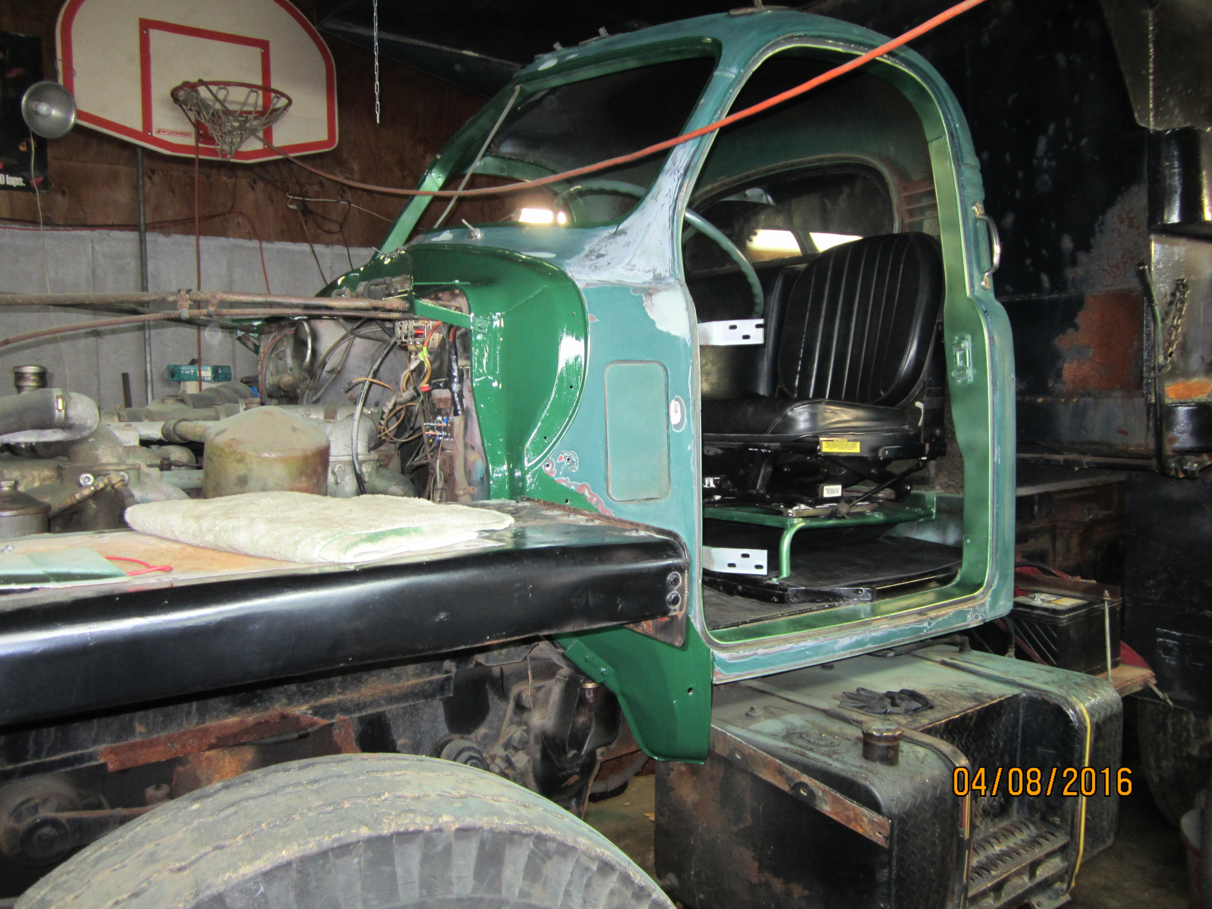

Today's progress:
1. Did body work and some welding on the driver's door. Overall, it was in good shape, especially the internals. Primed the door inside and out. Primed the door panel and the window ring. Painted the interior of the door, the panel, and the ring with the interior green. Exterior will have to wait for the other door and the hood.
2. Topped off the steering box with 80w/90 and power steering reservoir with ATF.
3. Took hood off the truck, disassembled the sides. Took off all remaining emblems. Used a body work hammer to take as many of the dings and dents out as I could. It looked like some gravel dropped on the hood, so there were plenty of dings.

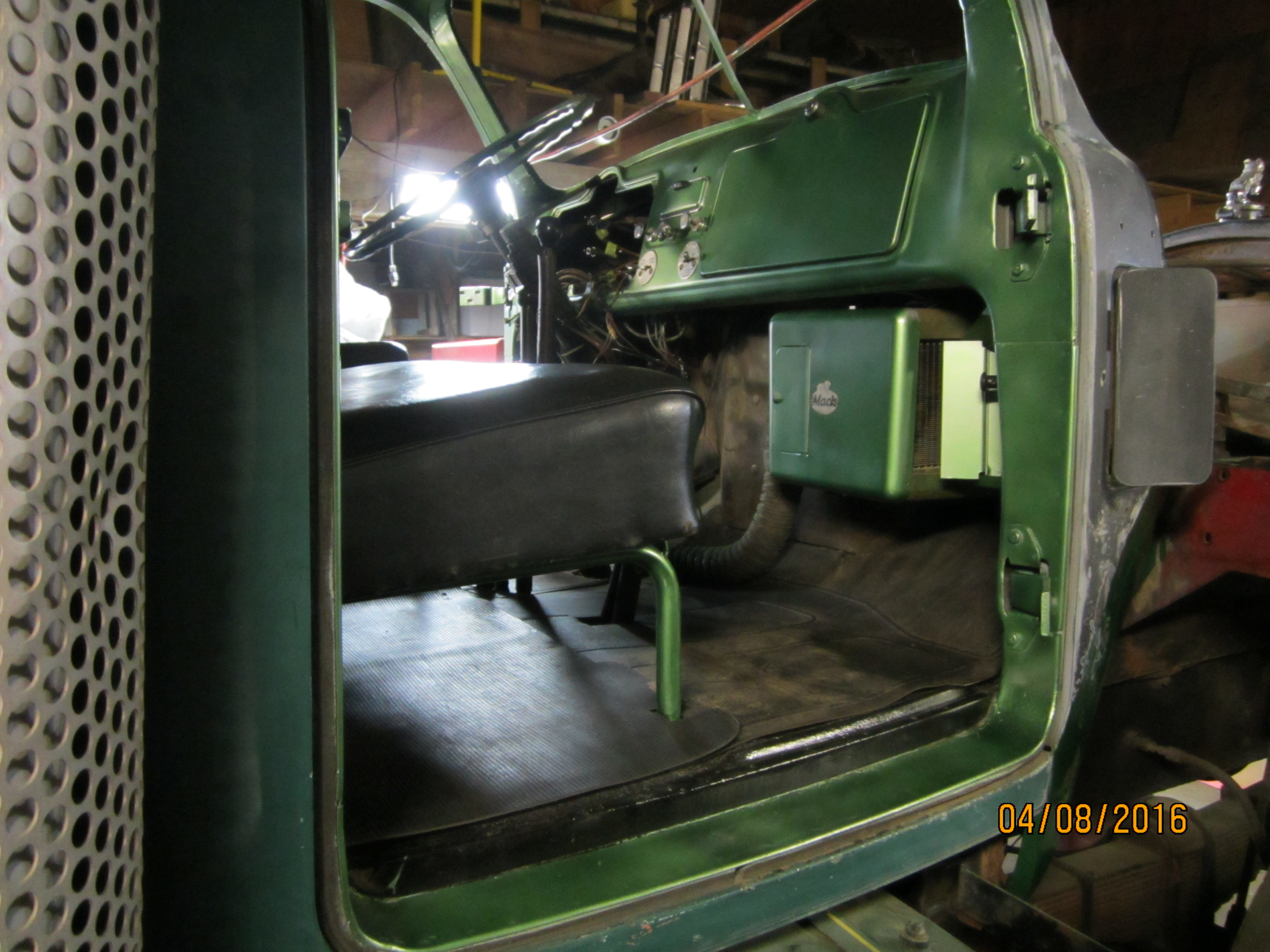

One thing I wanted to do is to fix the glove box cover. The cover was there, but the hinges were snapped off and the part of the dash that the latch catch was fastened to was previously massacred, so the entire cover was simply screwed into the dash to hold it there.
Yesterday my dad and I cleaned the back side of the dash and made little wooden braces to hold the stubby ends of the hinges up and visible. Then we made a platform for the cover to sit on in the "open" position with the other half of the hinges touching the braced halves. Then I welded the hinges back together. OK, now the cover can open and close normally.
Next, I cleaned (spelled: Dremel) up the mess around the catch area and then welded a tab to give me something to screw/bolt a little catch tab to. I've got a button coming from Roser, so when that gets here, I should have a completely functional glove box lid.

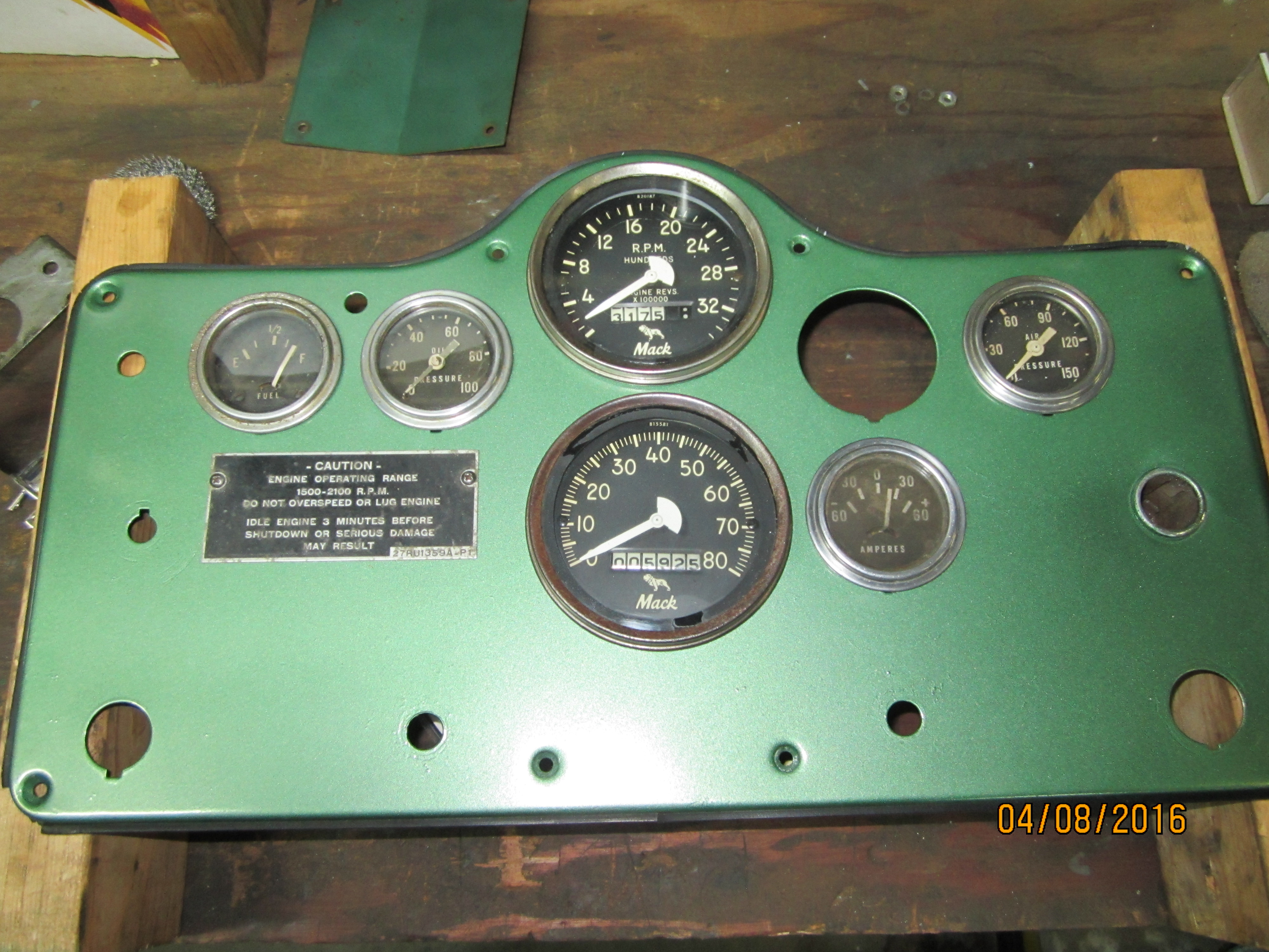

12 hours ago, hicrop10 said:
Wobbling,what size screws hold the gauge panel to the dash,seems I have misplace mine?Thanks.Mike Durkin
I'll have to check tomorrow or something, as I don't remember off hand. My guess is fine thread #6.
BTW, dash panel is now installed. Next up: windshield glass and doors. Then...paint the fenders and radiator black.
