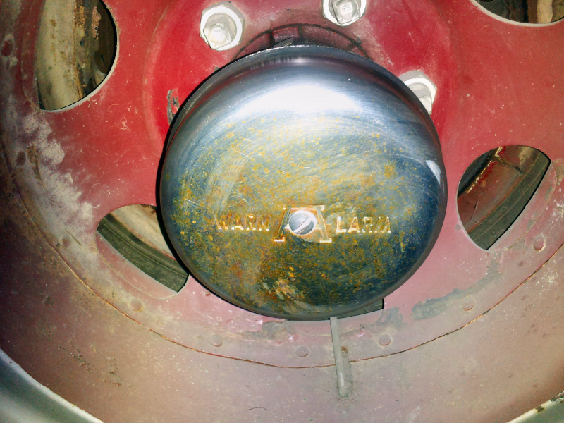

I was under the impression that there was a mechanical bell version I could install on the inside of the wheel. We do have the buzzer which was used when it was in service but would like something audible for its new life as a fundraiser/special event rig. It will be around kids a lot and a bell would be nice.

As for the back up alarm I'd go with a modern unit since that is what today's folks associate with a truck backing up. And the wheel bells are immensely annoying as they rattle and ding all the time.
At a local show ENFD's 1952 MACK has a Back-up Bell, it actually attracted kids and some adults to the rear of the truck. Most people and kids today associate a bell with the Ice Cream Truck not a unit backing up.

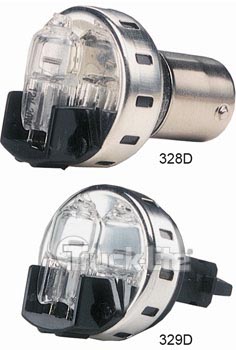

My Gabrielle MACK parts guru told me about these. If you have reverse lights this is simple and easy install. 87 decibels
http://www.truck-lite.com/webapp/wcs/stores/servlet/ProductDisplay?storeId=10001&productId=29247
