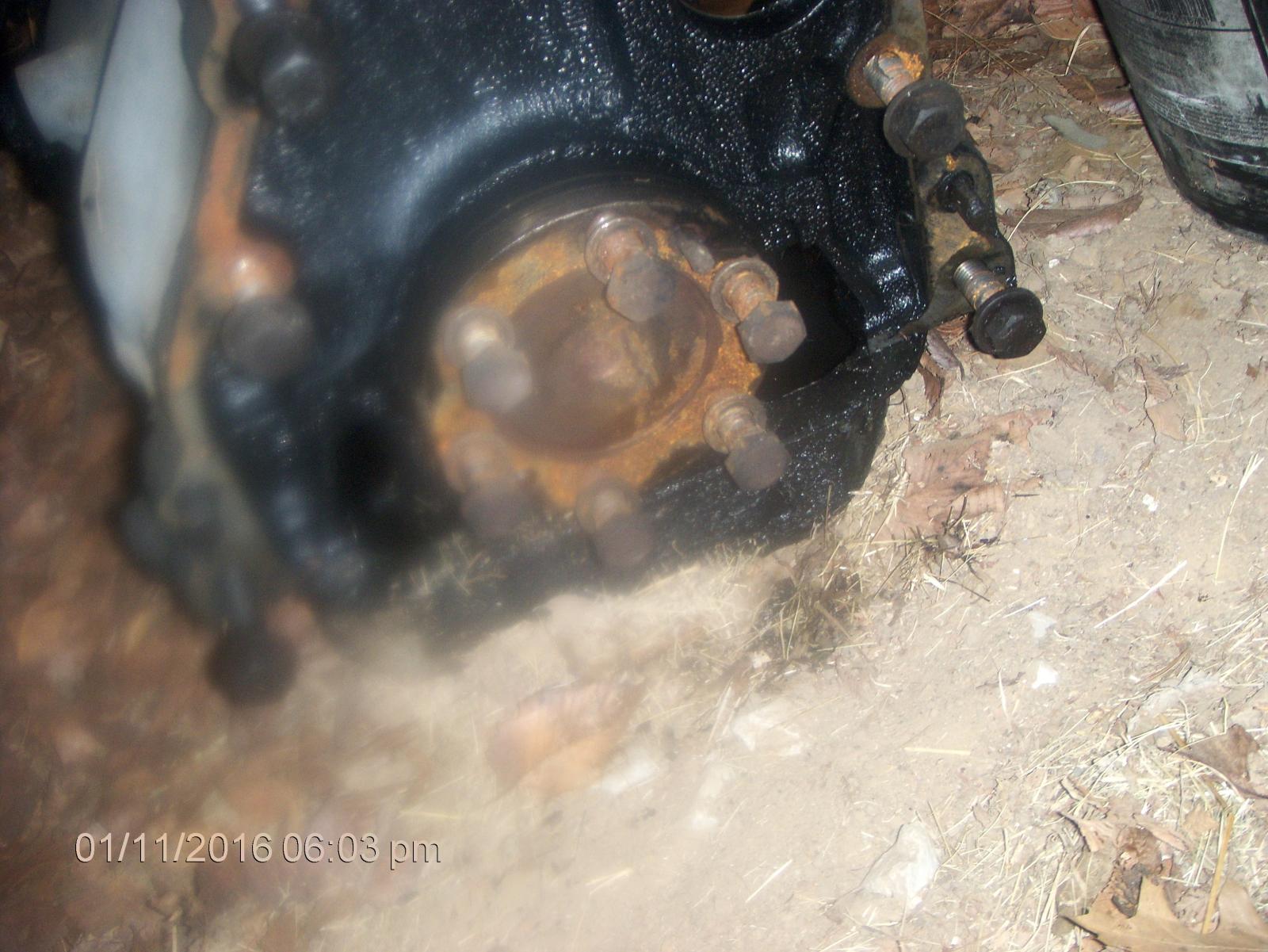

Anyone have some that I could get a picture of next to a tape measure? I'd just like to compare to the ones from the 237. Are they identical? Probably, but I'd like to know before I start searching for the 3/4" versions I need. I don't want to wait to pull the motor to compare.

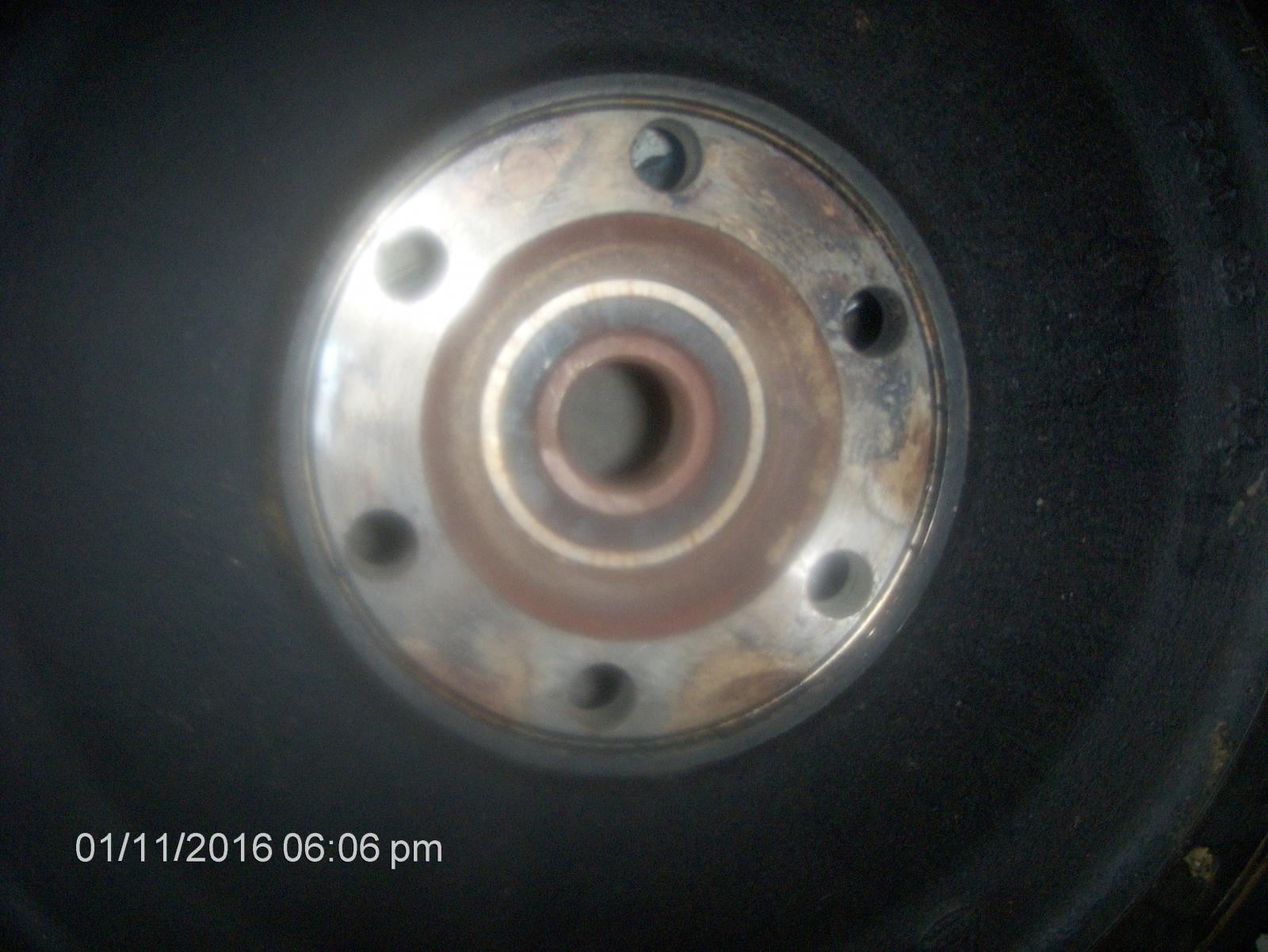

How about a flywheel? Just so I can get a visual on that. I hate flying blind and waiting to pull mine apart.
Thanks.
Larry
