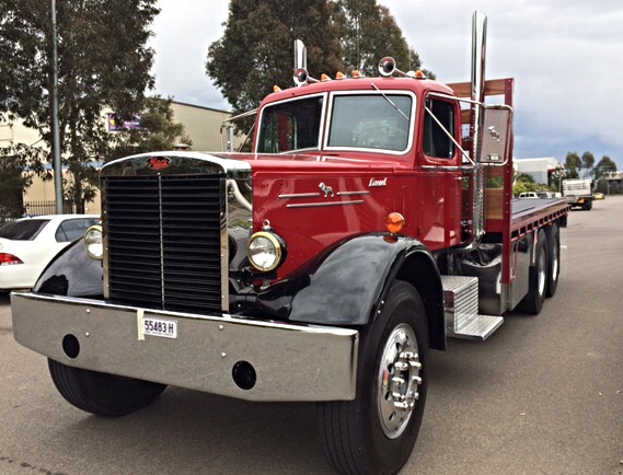

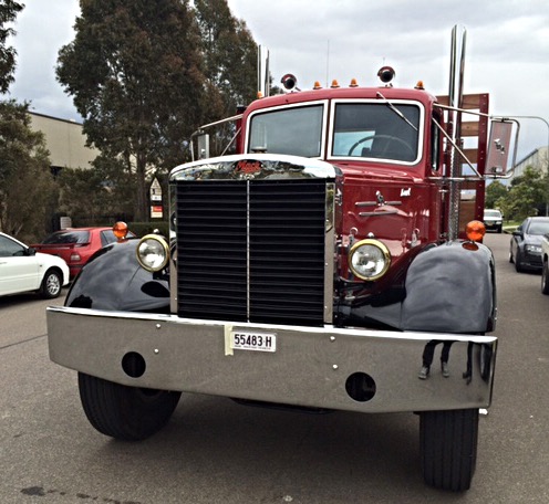

The LTL is awesome!
Do you mean you're not going to go to Alice Springs with it?
You don't noted on what side of the globe you are.
The steering wheel of LTL could be seen on the pictures though.

Yes the B Model and the LTL will be going to Alice Springs Next week.
We're based just at the bottom of the blue Mountains just outside of Sydney.
The LTL is a US spec unit fitted with a Big Cam Cummins,Quad box & Joey
The B Model is an Aussie Spec with a 2V E6 and Quad Box.
