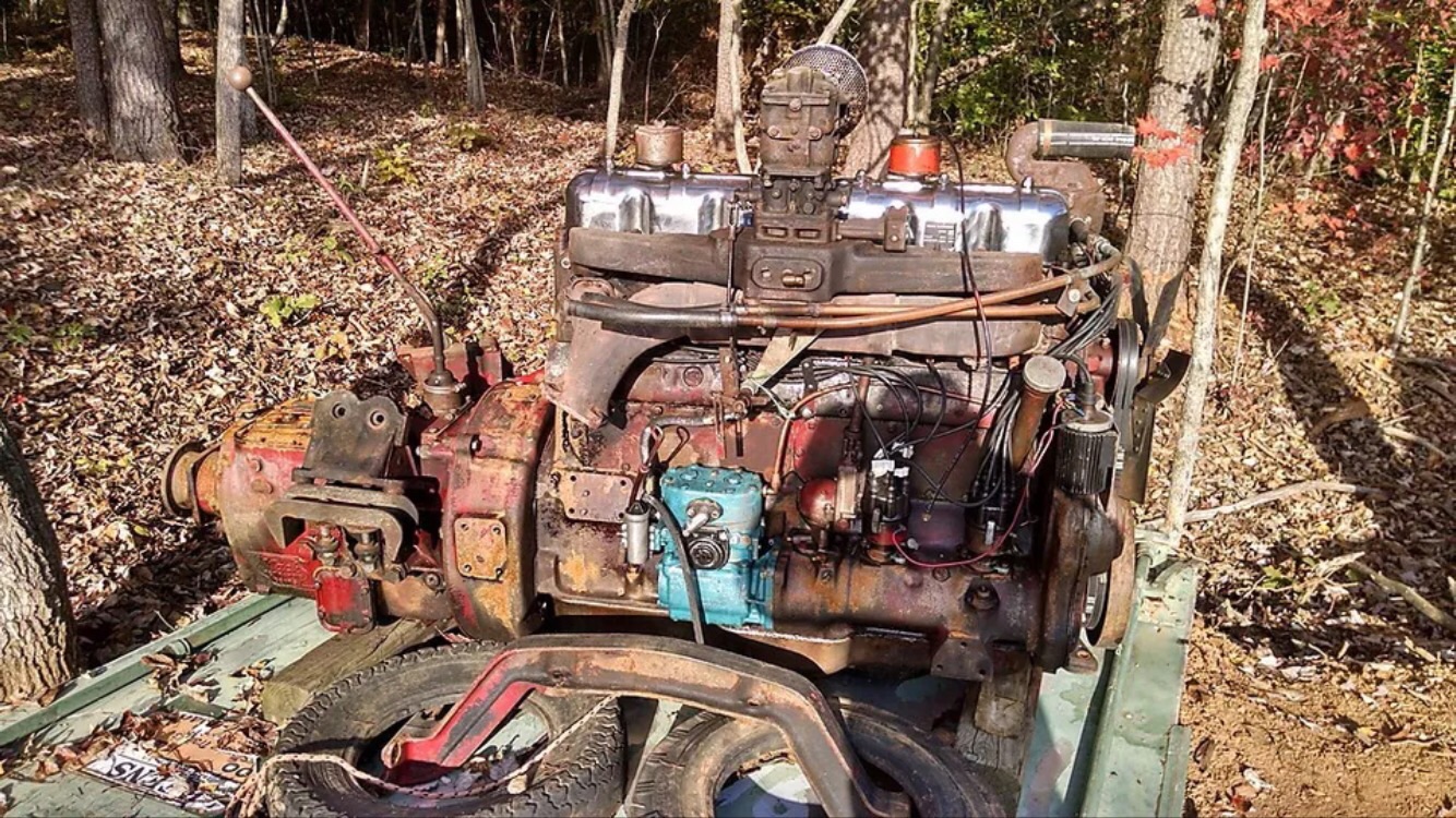

I ended up with a Mack B 4 door fire truck. Engine is bad. anyone know of a source for the 707's?
Is that the one out of the museum in CA?
yes, it is........didn't really want it but help was needed to keep the original trucks intact They will be continuing to thin the herd until a replacement home is found.
I don't know squat about fire trucks.
Here is a 707 on eBay. Pretty pricey though. I paid $1200 for one. I thought that was ok.
http://m.ebay.com/itm/Mack-Thermodyne-707-Six-Cylinder-Engine-Transmission-/161869635382
There was one in Texas on Craigslist a few months ago but I cannot find it now. I would have bought it if it were closer.
