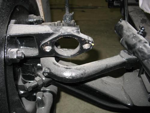

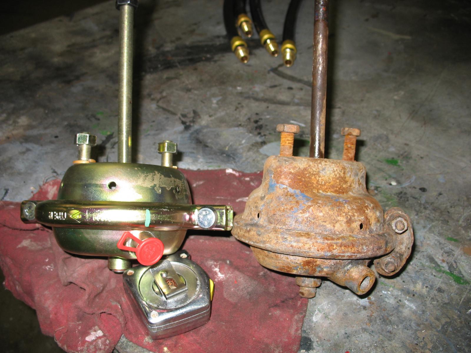

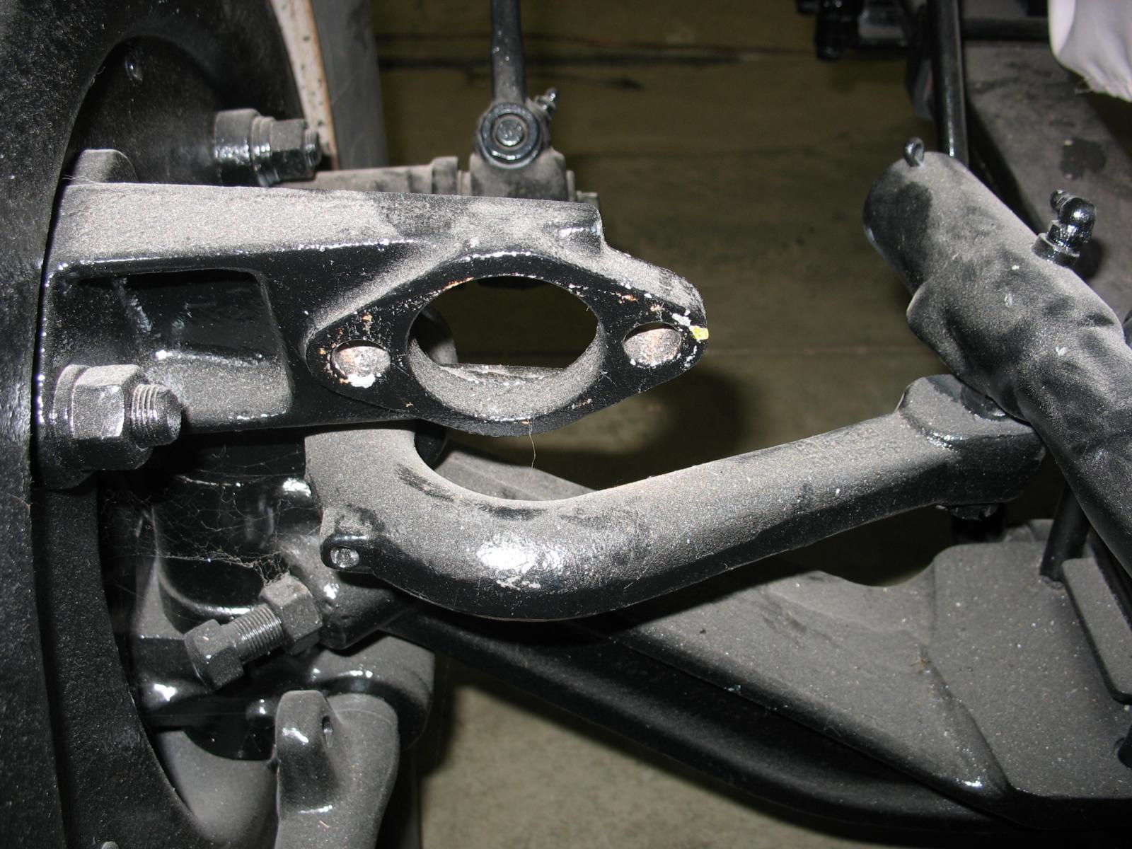

I put a 12000# axle under my B61 and the smaller chambers fit, but don't know the part#s I looked at mine and the holes are up-down yours are sideways. my new chambers look like the ones you took off. the only problem I had was on the auto slack adjuster was tight on the driver side.
If you cant find the smaller diameter ones do like what carlotpilot said, just clean it up replace the pancake for about $2 and you should be good.
Take the old one with they should be able to cross it if they know what they are doing
I found this looks like yours but I would have them measure it
SC09 by HALDEX
Service Chamber - Size T09

Thanks. I started with carlotpilot's idea. When I got the old ones apart the springs were broken. The new ones were too short. With the link from thomastractorvc I orded 2 Haldex SC 12 chambers. They will come from California and are temporary out of stock. If any one needs a type 12 as pictured let me know. Priced very reasonable.
