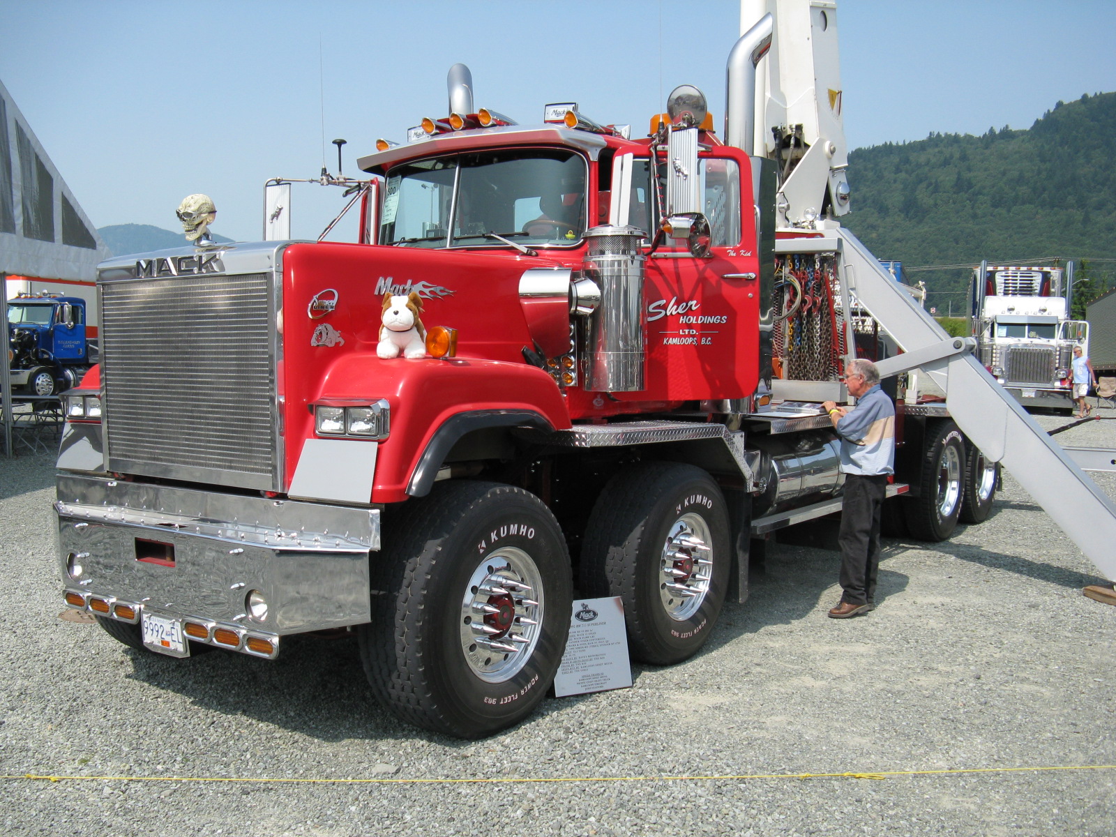

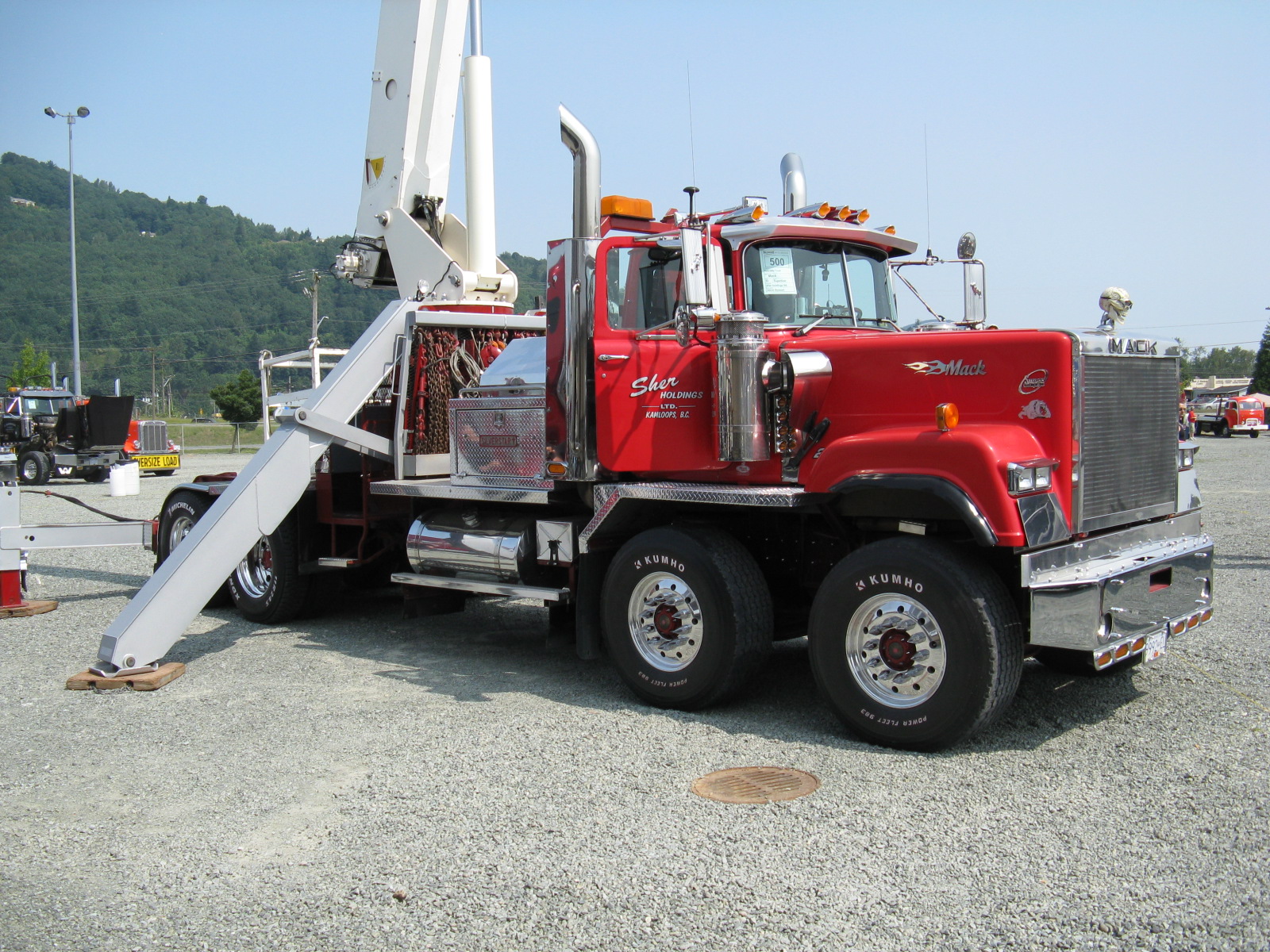

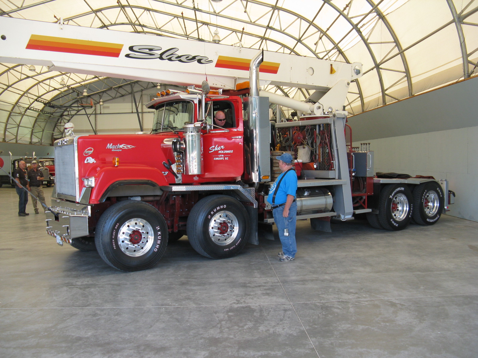

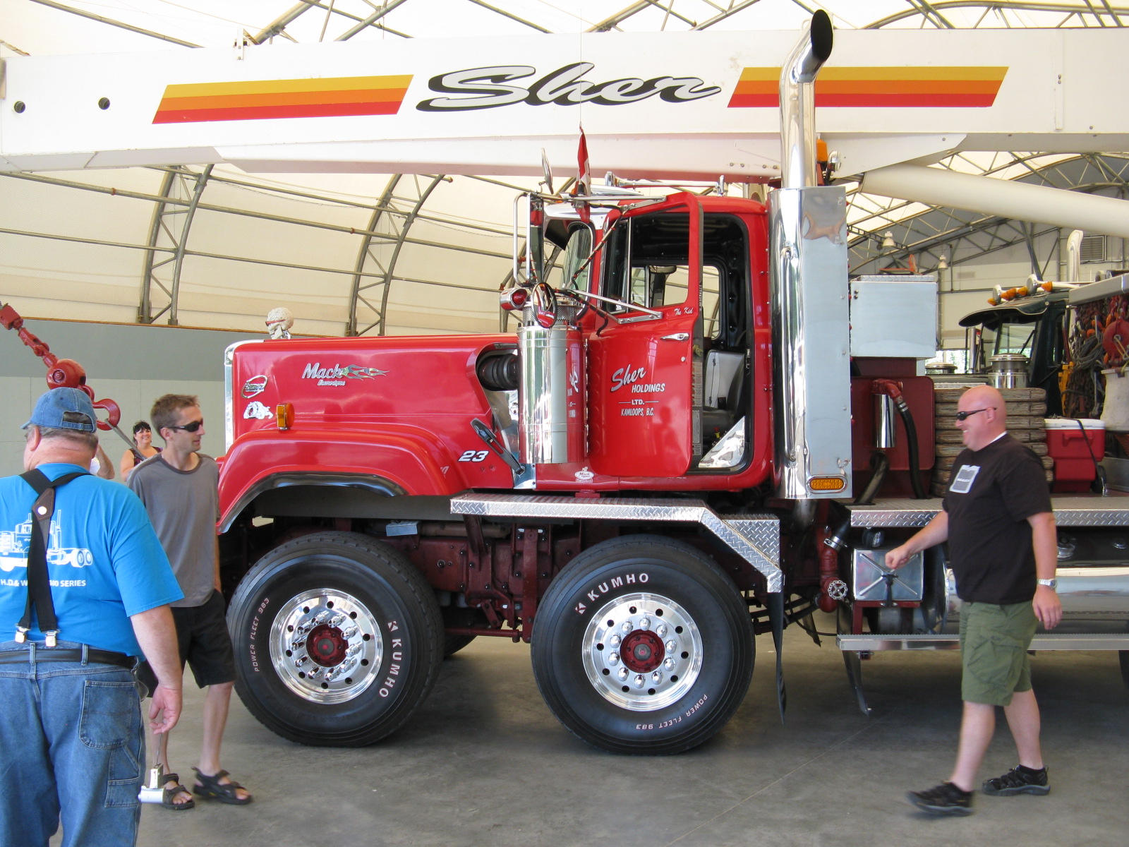

Dual front steering is fairly common in Canada. It's more common in Quebec where it's been required for heavy power unit gross weights since the 80's. Most of Eastern and far Western Canada doesn't allow for liftable axles so it's easier to go with a heavy second steer axle. Simard Axle from Que. Canada has a patent on the design Mack uses from factory and aftermarket in North America.
I've seen a few twin steer Superliners in Quebec. All were Dump trucks and the second steer was under the cab. Most are just behind the cab for maximum spread in Eastern Canada. Western needs them further ahead.
The purpose of going away from liftable axles is road wear. When cornering and a liftable axle is lifted it shifts the weight that axle was carrying to the remaining axles that are grounded. As a test, a fully loaded Mack CV granite was loaded with 22 tons of aggregate in a dump box. The truck had 44K rears and 20K fronts with a 20K rated lift axle. When the lift axle mounted behind the cab was lifted almost 27K pds was shifted to the front axle.
The ministries up here figure that spreading the weight on constantly grounded axles will keep the black top longer. Those trucks carrying max gross usually have more then 72"'s of spread on the twin steers and 72" of spread on the drives. Any axles in between must be self steer axles that only lift when empty (controls out of cab) or in reverse through the reverse switch.
