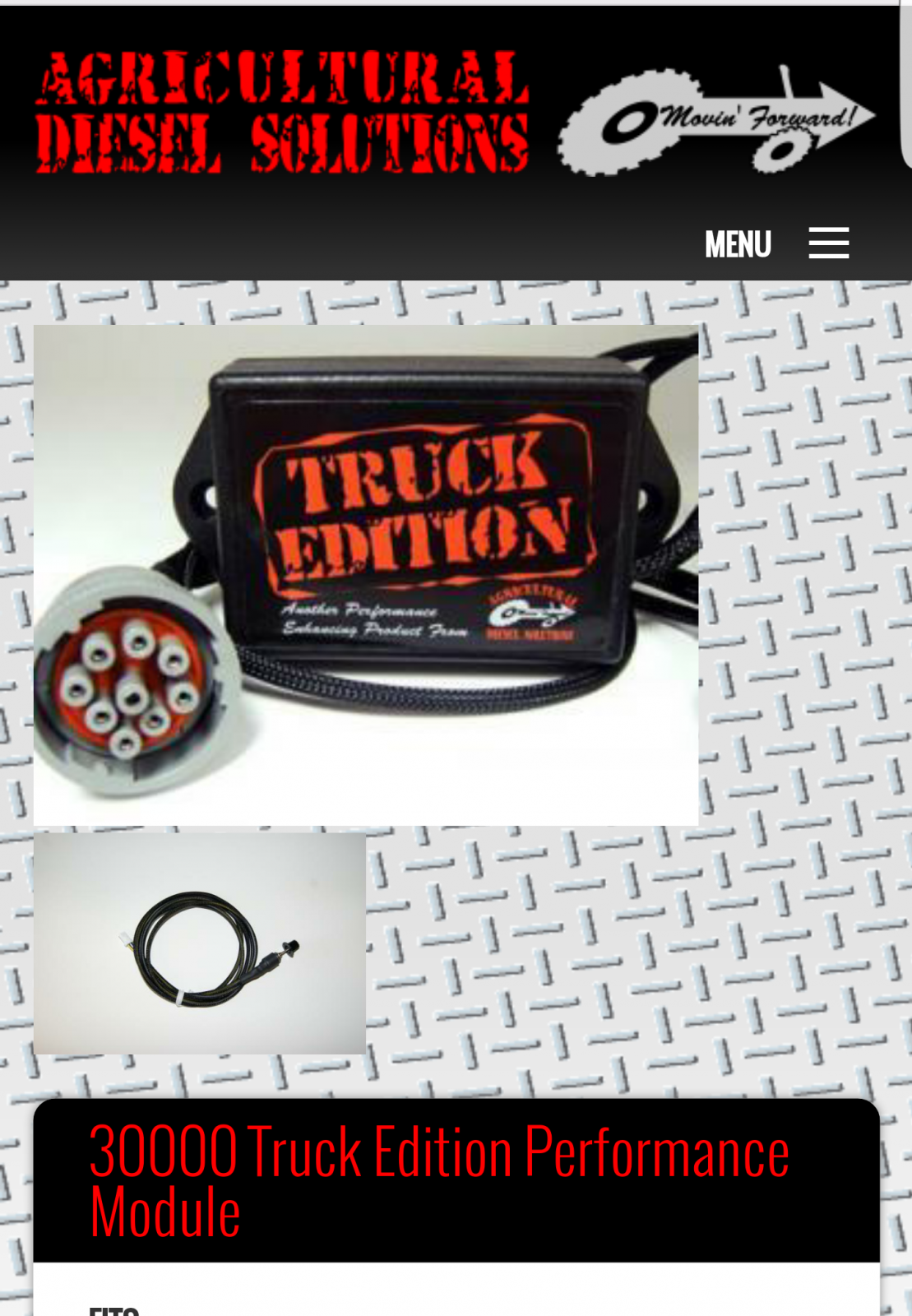

Hello brettj3876.im also trying to get more grunt out of the old dog.i came across this on the web.i reckon it must be similar to blixton module except it's a switch on the fly.im not sure how well it works ,maybe someone here can tell us how good or bad it is.

I don't know the price of what you posted but the blixxton is around 400. Rochester performance injectors 900 for the set and a s400 turbo off a 427 is around 800-1000 I believe. So I take it the 350 has the same cam as the 427 and 454 but the higher horse e7 has lower comp? It's a 93 ch that is very clean. It hauled million dollar race horses around all its life, never had any weight on it has 790k. It was cleaner than every newer mack we looked at. THe guy that's selling it has a 1990 ch condo with only 330k original miles with the 400 but hes not ready to sell that one yet
