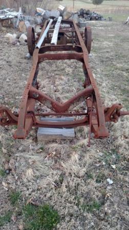

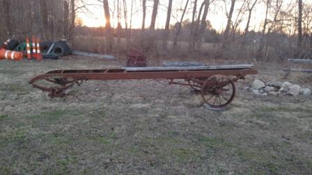

Need help on identifying this frame.  I was told that it is an early 1920's White Motor's Frame.
I received it when I bought my 1925 White Motor's truck - but there is no identification mark's or numbers anywhere.  Any help would be greatly appreciated.
Probably 1921 and up White as it has the distinctive front engine cross member.

The numbers on the frame are  first two numbers are the series, third number is year ... 871 would be series 87 and 1921 year of production.   Paul
