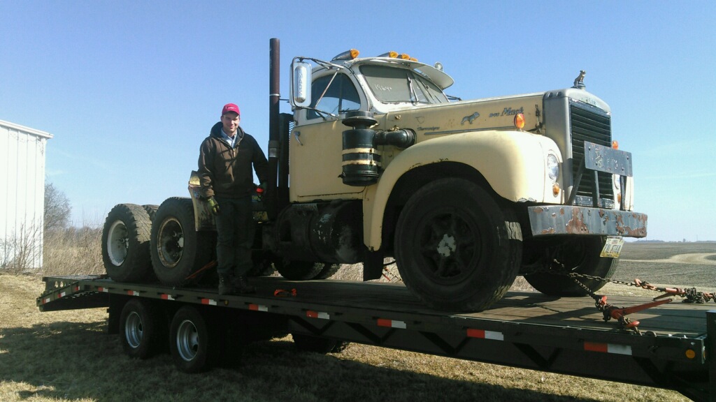

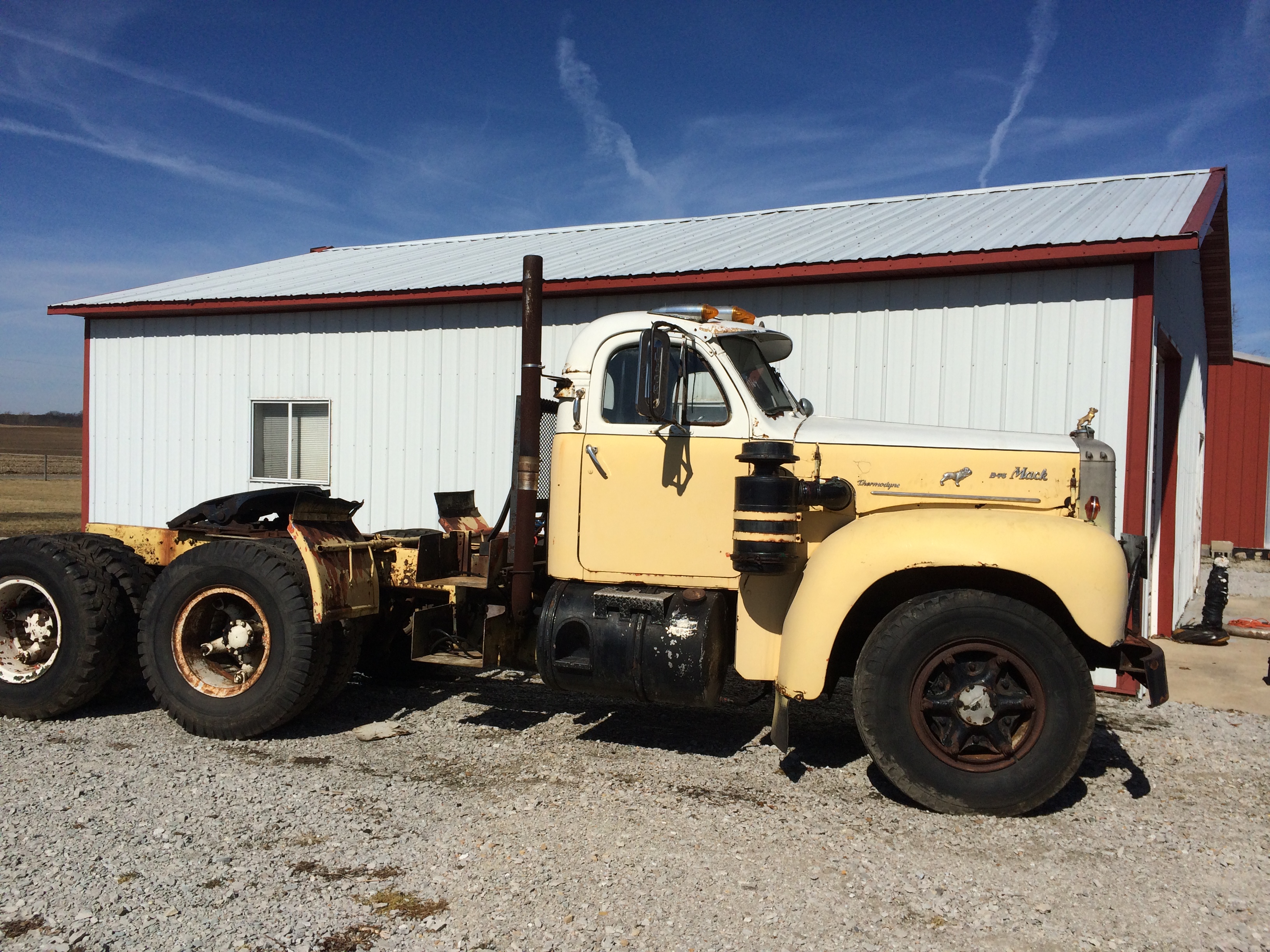

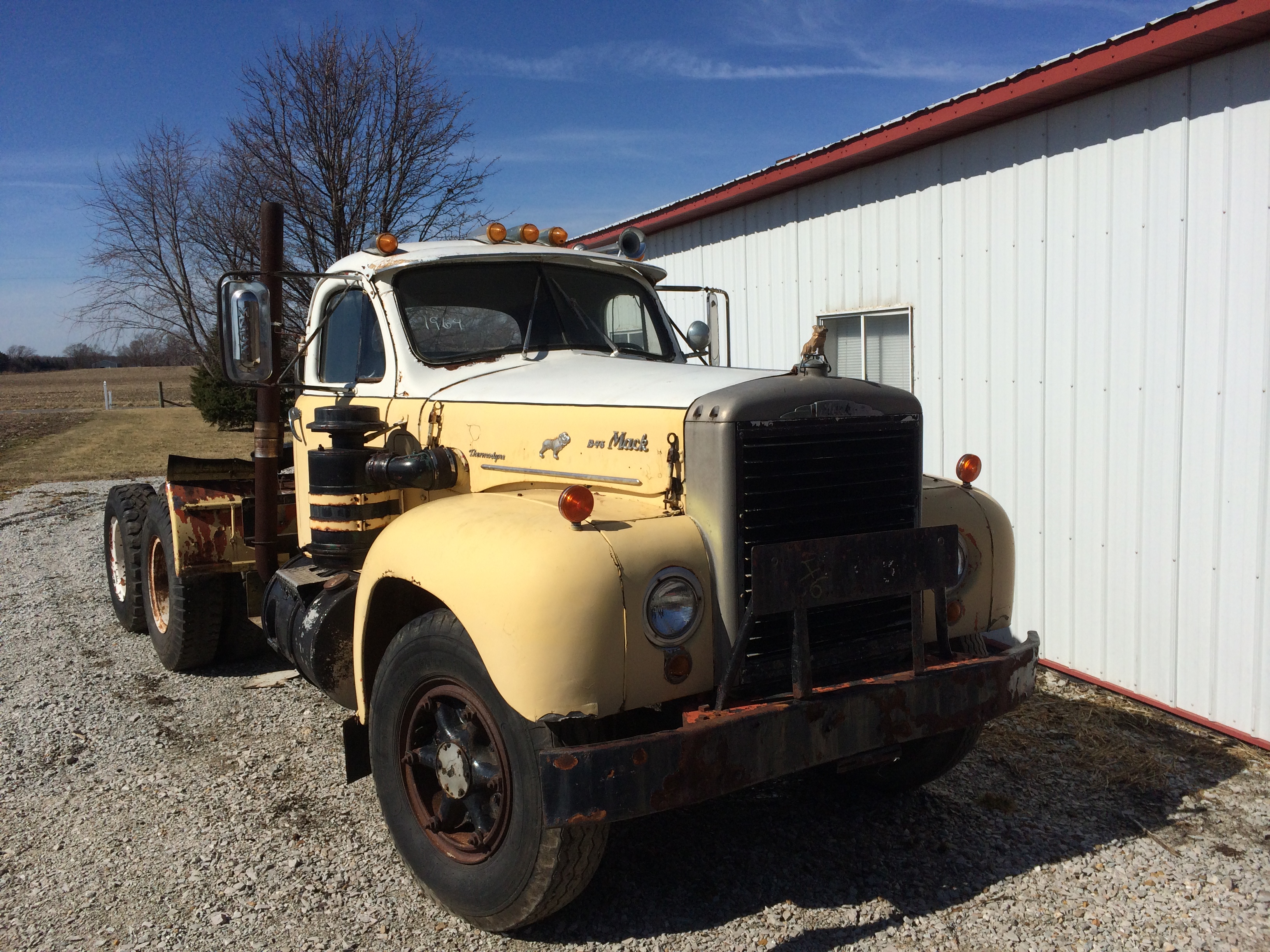

Hello everyone, I'm new to the forum and new to Mack trucks. A 1964 B-75 recently found home in my barn, and I'm in the process of getting it running. My plan is to fix the truck up and use it to haul around the miscellaneous equipment that I come across. Its not going to see everyday use by any means, but I would like to be able to get it out and use it like it was intended to.
The truck is equipped with a ENDL 711 with the added turbo and the transmission is a triplex. This engine has the heads with the large bolt (I think its 3/4) on the drivers side front and rear corner of the head.

Welcome, Jim. No dumb questions here, only dopey answers. For someone new to Macks, it seems you have done your homework on the truck you own. Sounds like a great setup, but we need pictures to make a fair assessment. We like pictures.

Nice find.  When you get it running, I would just run it and enjoy it.  Granted mine is a 673, but I lost two head bolts in 15 yrs or running it all summer pulling my race trailer around 3 states.  It always got me home, even it was "leaking" a bit.  They are pretty sturdy engines, even if they have a few weak points.   They likely will always get you back home.
