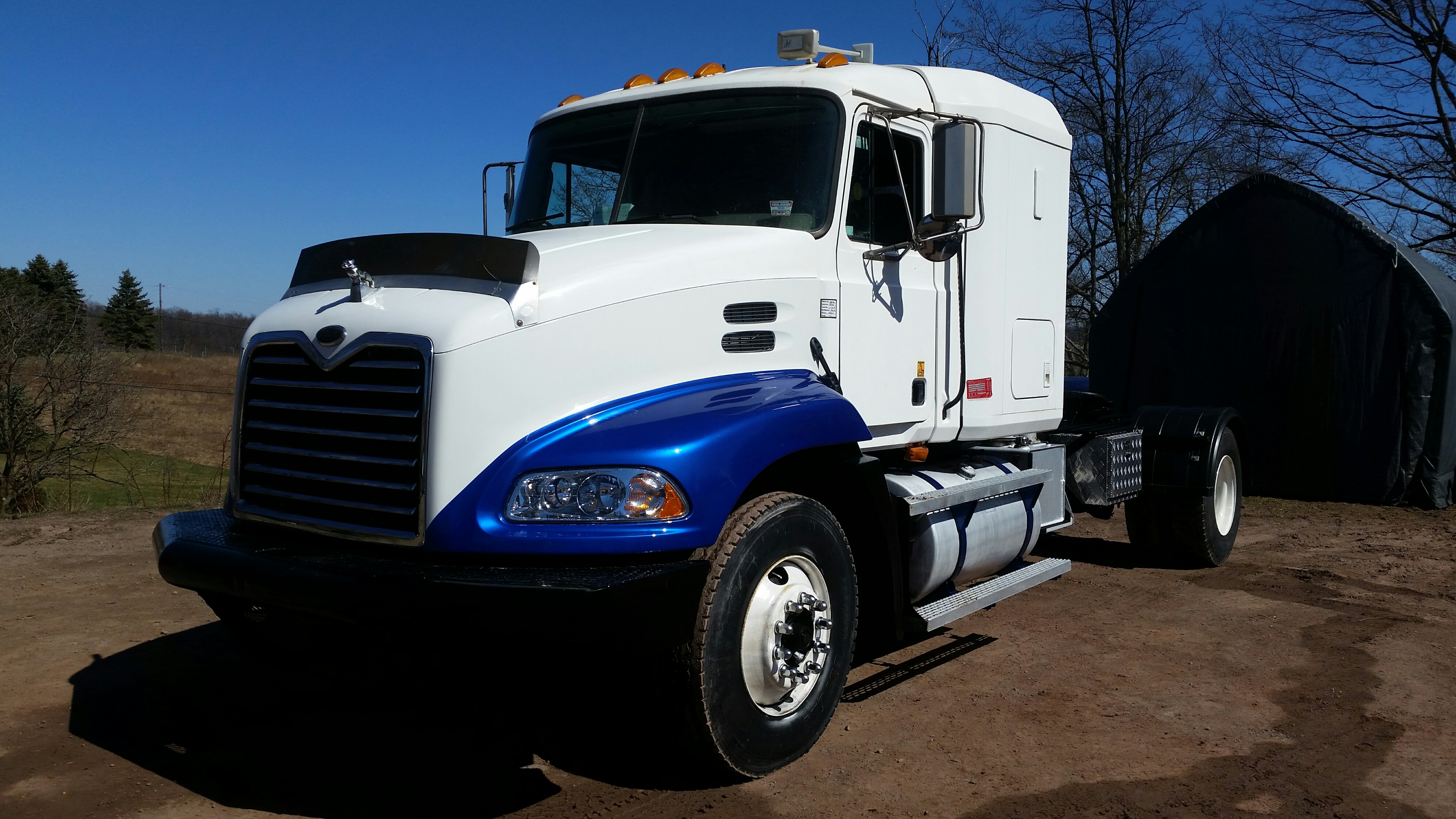

I apologize if this has already been addressed, I tried searching and did not find any answers.  I have a small fleet, 7 trucks total 3 with Cummins power, 2 with Cat, 1 Volvo, and 1 Mack.  The Mack is a 2000 CX613 with the E7-427 and the Volvo is a 2000 VMN with the D12.  I am looking for recommendations on software and devices to read and adjust engine and body controller parameters on the Mack.  I have Insite for the Cummins and and a friend has a Snap-On scanner that does the Cats.  All I can find that will allow both read/clear dtc as well as adjust parameters is the Mack/Volvo software from the dealer for about $1,000 with the interface cable.   The only good part about the dealer software it it claims to work on all Mack and Volvo products from 98-2010, so I may be able to justify it between the two trucks.
I like to do my own repair, hate waiting on a shop, my Volvo is typically in the shop for no less than 30 days every time it goes there, no exaggeration.  I can find generic scanners to read/clear some codes, but need to be able to adjust the speed limiter, tire rpm, idle shut down, enable high idle, fan cut in/out points, etc just like I do on my other trucks.  Any advice or suggestions?
