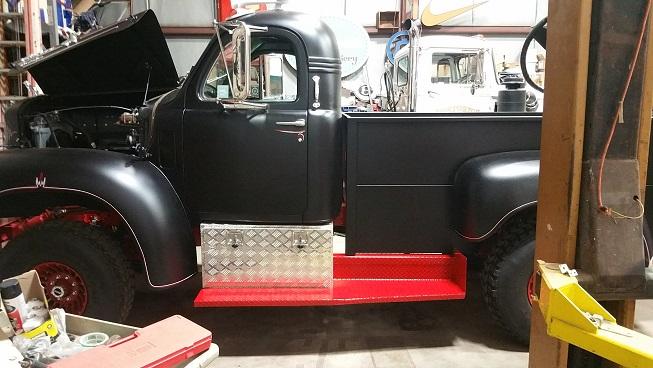

No Too sure if It's being asked before, But..
Is the Toolbox going to be painted/powder coated Red/Black ?? or left as is??

Thanks, leaving the boxes as is for now

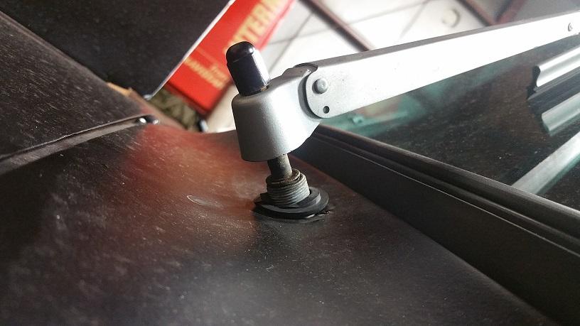

Anybody have a couple of the wedge shaped chrome collars and retaining nuts for the wiper shaft posts on a B model? Probably the last thing I need to find for this truck. I doubt there are any floating around but it's worth a shot. Punch list for this thing is getting whittled down, relays for the head lights, relay for the power windows so the little lights in the switches don't kill the battery, got the AC working right (I had it overcharged) found the only thing I didn't replace in the front end (draglink) was worn out so replaced that  and centered the steering wheel. Just got to get the wipers finished and I'll have to look for something else to do.

i would check with motorcycle accessarys outlets they generally carry all kinds of chrome nuts,,,,good luck beautiful work my friend  thanks for keeping us posted,,,also throw some of you ambition my way...lol.bob
if you got a bit of aluminium round bar and drilled the right size hole and then cut it in half on the correct angle wouldnt this then give you two collars
Buff them up with in a inch of their life and they would look like chrome to my untrained eye

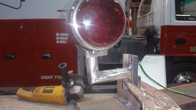

Thanks Paul, actually cut a couple of pieces of the tubing that I used for the taillight brackets but Im would be better off with aluminum tubing
