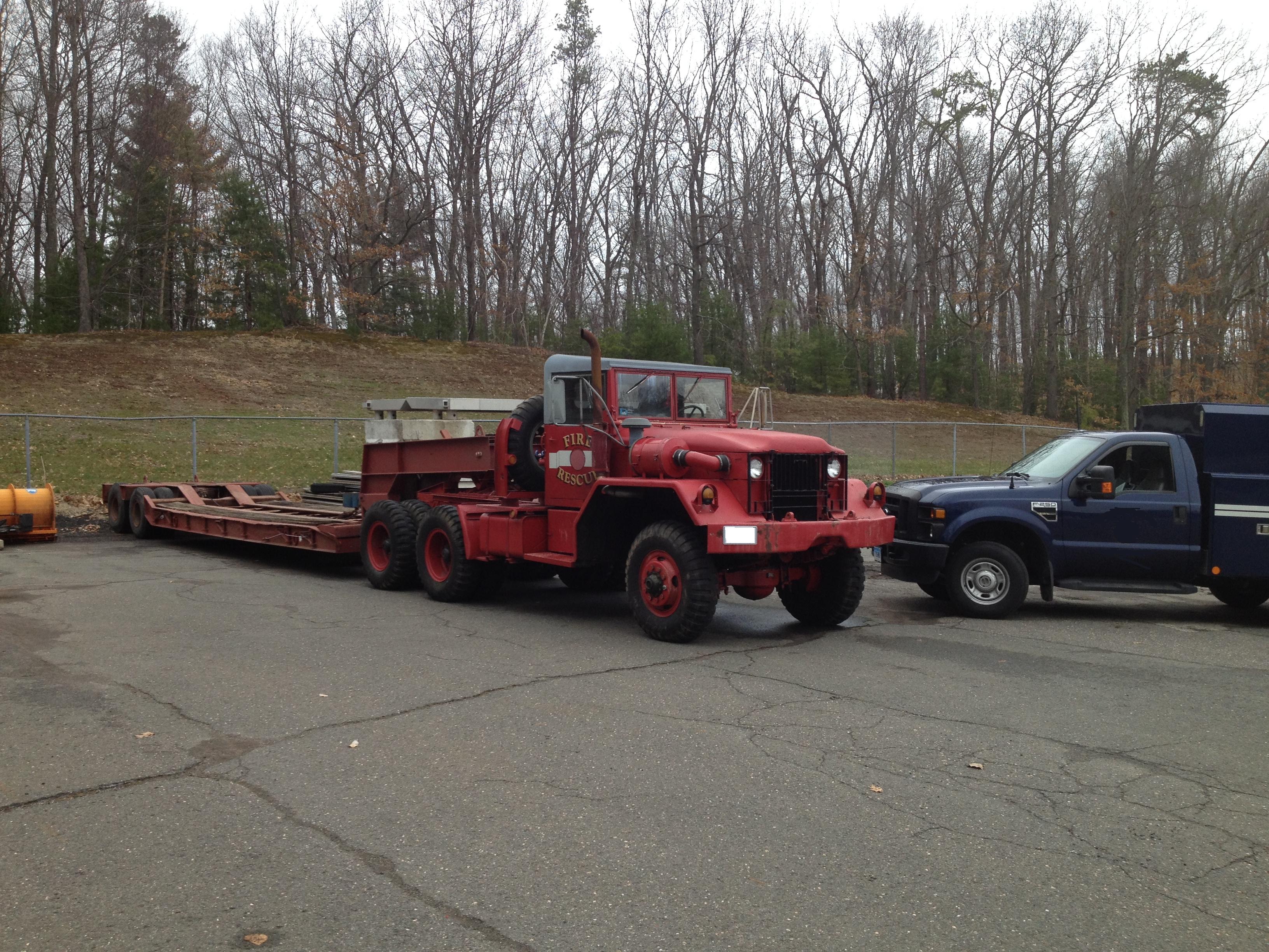

I have an M52a1 with this motor and I noticed the oil pressure was lower than usual today. it is very cold out but it is only running about 15-20 psi idle cold and maybe 35 if I race it up. I could swear it had more.
The truck overheated pretty good the other day but seems to be running fine now. No oil in the antifreeze and vice versa. No pressure in the cooling system/ Also this truck takes about 10 to 15 seconds to build oil pressure. I wasn't overly concerned as I know that is normal on the M52's Multifuel counter part because of the upside down canister filters. Should that be normal on this truck as well ?
That is what I was afraid of. I guess she's getting the torch. I don't have money for a motor and I have an M813 with Cummins that needs a cab.
I probably damaged it when it overheated...That stinks.
