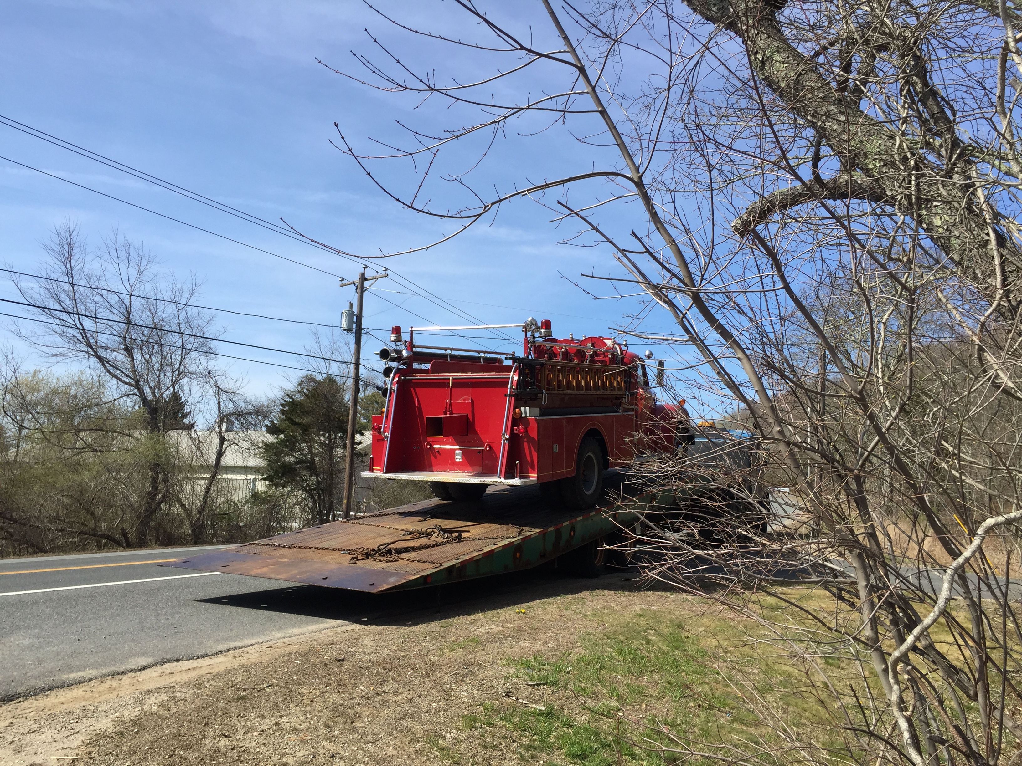

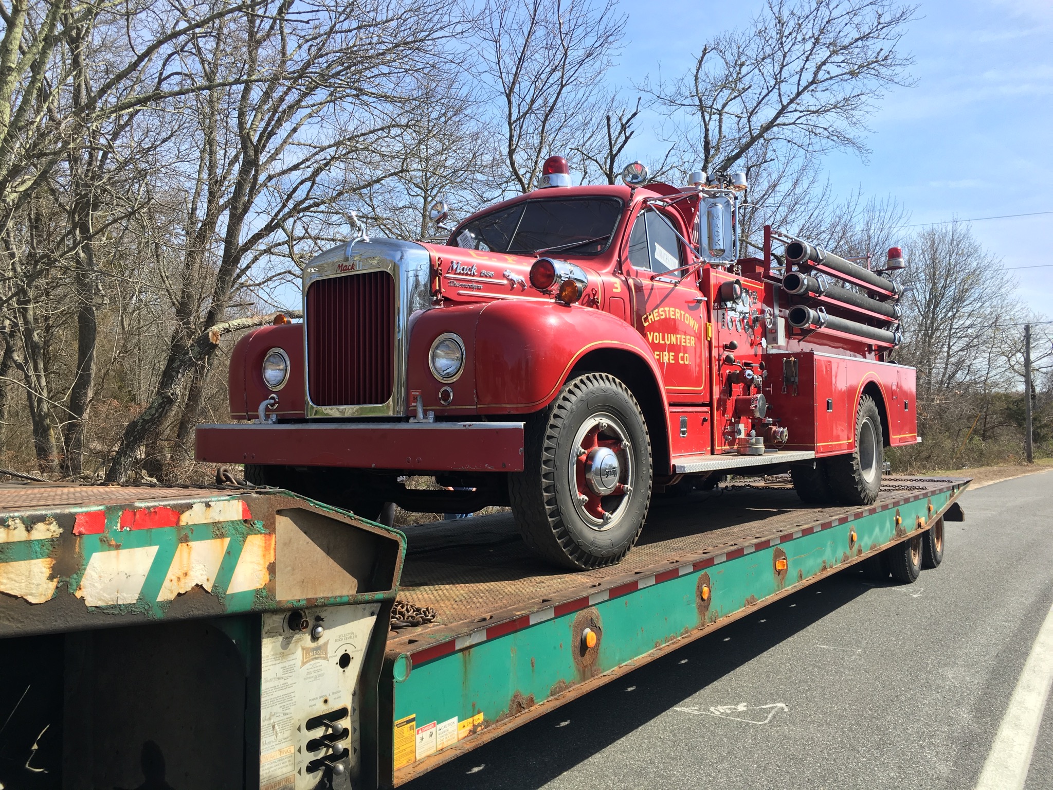

It's the 707 gas.  But it does have air brakes, and even a Maxi-brake.  I don't like old hydraulic brakes, so I'm happy about that.  I'm not sure I've ever seen a B85 with a Diesel.  Anyone know if any came from the factory with the Diesel?
I believe that this is from Chestertown NY.  But RI is going to be its new home....

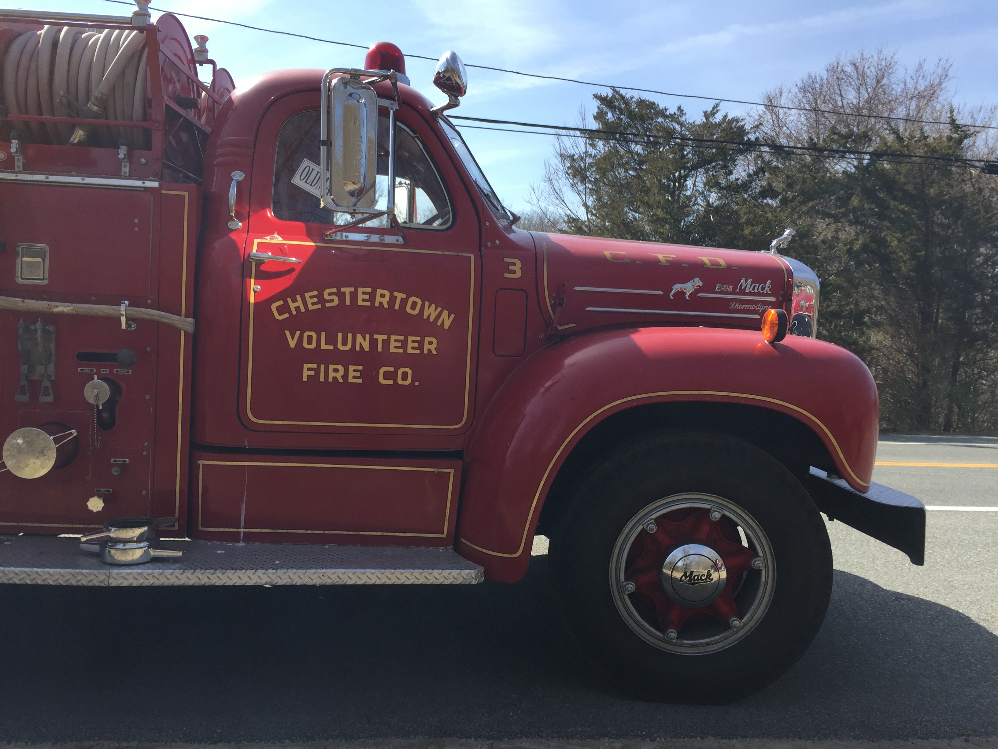

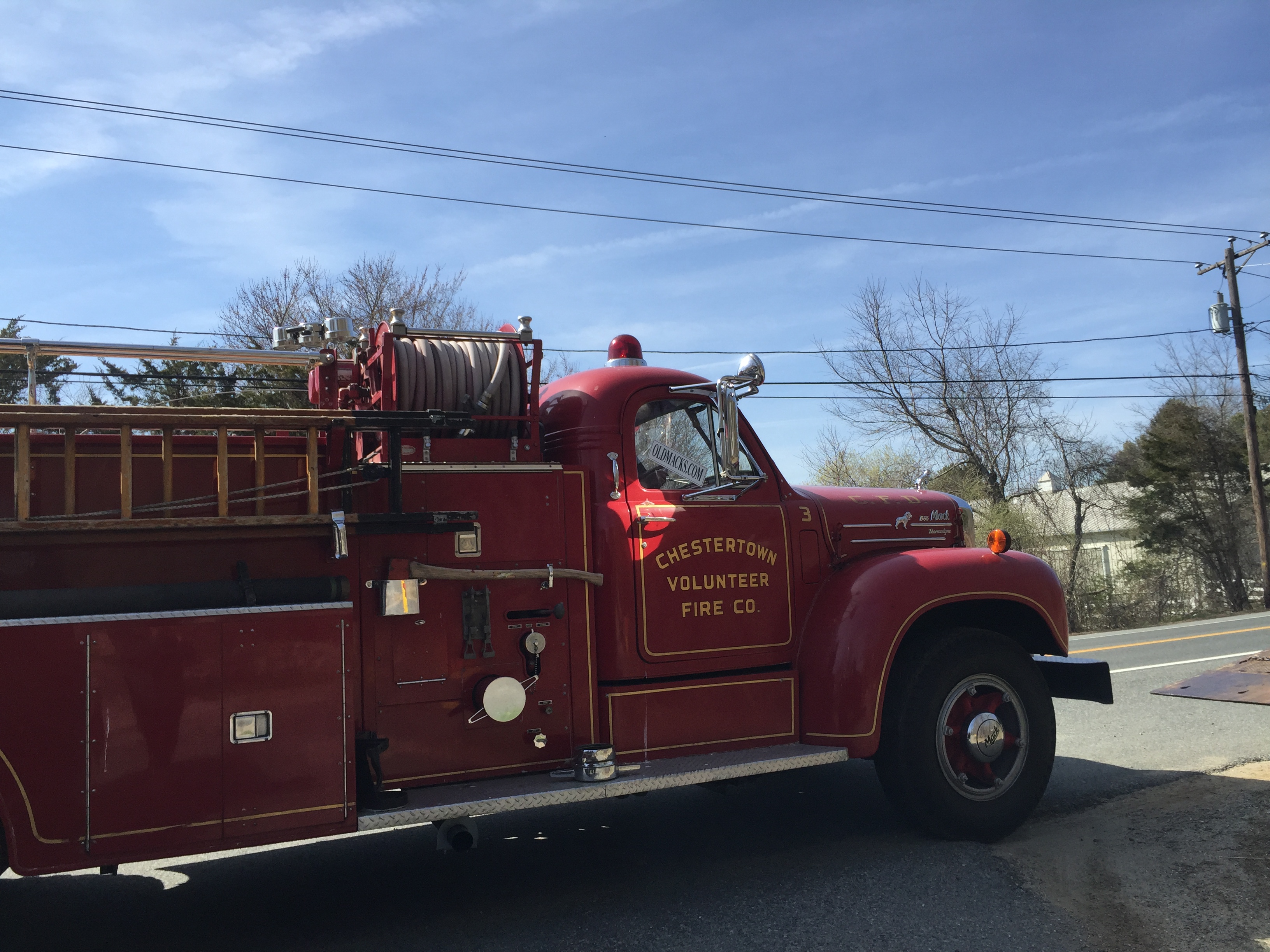

Nice looking truck; the "B" model is my favorite fire truck model. I had the good fortune to operate a couple of "B-85F" and "B-95F" pumpers back in the day, the cabs were a bit
cramped inside but they were great trucks. Your truck is from Chestertown NY, its website has a couple of historic photos of the "B" model being delivered and also a couple
of photos of a Mack "C" model pumper.

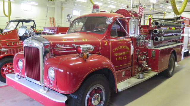

Look at www.chestertownfiredept.com, then "photo gallery". Scroll down to "misc older photos", the "B" and "C" photos are there. Also, a color picture of the "B" is
under "fire engines". The first three Mack fire engines with diesel engines were delivered to Hamilton, Bermuda in 1960. There were two "B125F" pumpers and one hose truck.

Thanks!  Now I just have to figure out what happened to it during the trip here.  I'm told it ran beautifully when it left, but since I got it, it's been running like crap.   Been checking all the ignition/battery wires, and that all looks good.  Now i'll have to check the fuel filter to see if it's being starved.  I think it ran out of gas by the time I got it unloaded and down to my neighbors barn, so I'm hoping that the problem is just some crud in the fuel filter....  We'll see.....
But otherwise, it's a great truck, and I'm happy with the overall physical condition of it.

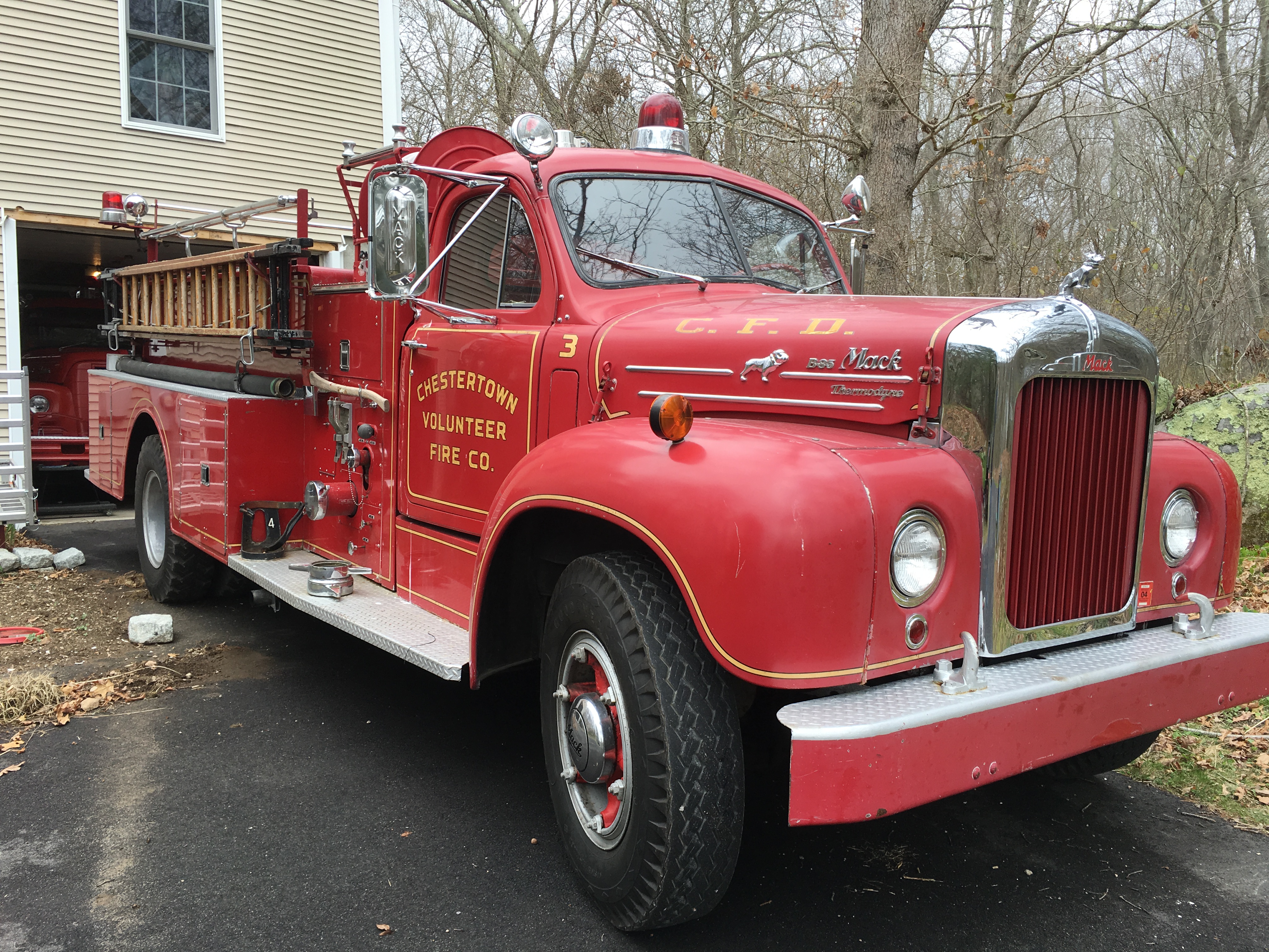

Ahhh.....  That's better......
Dennis at OldMacks.com stepped up to the plate and sent his mechanic out to see what was going on.  it was obvious that it was burning very rich, so after changing the plugs, cleaning up the carb, sanding a groove off the needle, and installing in in-line fuel filter it ran better, but still was flooding at low rpms.  We discovered that the fuel pump was rated for 5-9psi, but the Zenith carb is rated for 3psi.  So I'll get a new pump, and a new needle, and hopefully all will be well.  But as you can hear in the video, as long as the idle/rpms stay above 1100-ish, it runs great.
Very encouraging......
