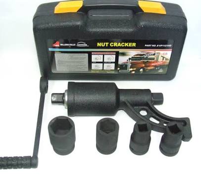

Been looking at these torque multiplier lug wrenches. I like to keep a tire changing kit handy when traveling with my antiques. Two I have don't have air on board, so I was looking at this as a travel option. Anyone like these? Is there a brand I should get or stay away from. They seem to start on the web at $60 and go from there.

I've been looking at the multipliers also. I've seen all the vids and by the looks of it, my 7 year old could spin them right off. As we all know though, the vids can be deceiving.
The by far worst to remove is stud pilot buds that have been on awhile. I've broken 1" drive ratchets trying to get them off on the side of the road and then you have the one or two inner nuts that want to come off with the outer.
That's exactly the kit I was talking about. All my trucks have stud pilot wheels on them. Can never ever break them without air. Do these kits work as well as stated. Just want to have a kit on board incase of a road side emergency.
