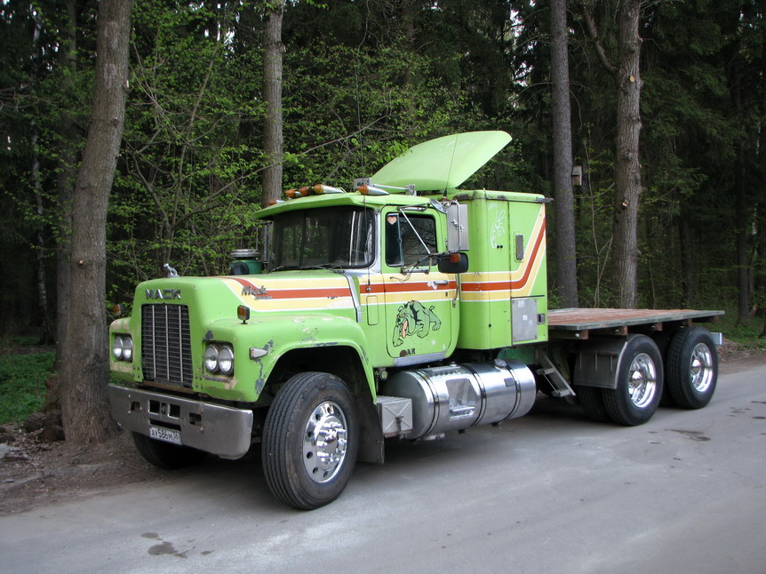

The question - what minimum pressure can I put in the tires to not loose them off the rims?
The wheels are 11R24.5 tubless Alcoas. The truck is tandem R-model tractor.
It's far from a showroom condition now but I like to drive it from time to time. Going a good road it rides smooth and I feel nice in it. It's long enough, has Neway airride on Canadian spread and air suspended cab with air seat. Although when catching some washboard parts of the road wich I meet plenty of it shackes as hell and flips its hood if I don't slow down fast enough. Once I had to pass about 20km of dirt road and it took me no less than an hour to. I know some load could help but I'd like to keep it as a tractor with only 5th wheel on it.
Being not a truck driver I absolutely have no idea on how deep I can deflate the tires. Currently I ride both fronts and rears with nearly 80 pci / 5.5 bar as the previous owner recommended. The fronts look deformed under the weight but the rears show contact trace in the middle of the tire threads only, just don't touch the pavement with thread shoulders.
So maybe loose the nippels? Or at least deflate the inside ones? Any suggestions from guru's?
