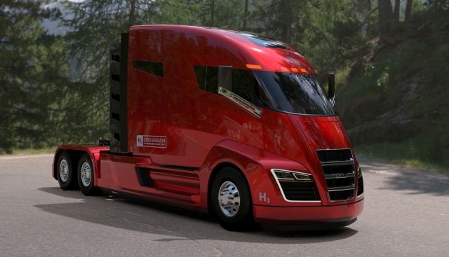

Nikola Motors natural gas-electric hybrid Class 8 truck
Autoblog  /  May 10, 2016
With Tesla Motors pretty much cornering the market on public perception of what an electric car should be, a new electric vehicle (EV) company called Nikola Motors is ready to launch a $375,000 natural gas-electric hybrid semi truck called the Nikola One.
The name Nikola comes from inventor Nikola Tesla (1856-1943), who is also posthumously lending his name to that one company Elon Musk is running. While the names are an obvious connecting thread, the Nikola Motor Company will not be competing with Tesla Motors unless Musk decides to enter the electric semi game.
The Nikola One is not all-electric. On top of a 320-kWh battery pack, the 2,000-horsepower Nikola One will have a 536 horsepower (400kW) fuel-agnostic turbine (the standard model will have a natural gas tank) that sends power to the battery.
Nikola says that its truck will be able to operate at half the cost per mile of today's diesel trucks.
With a full tank of 150 gallons of natural gas, the Nikola One will be able to go 1,200 miles between fill-ups.
And, for the first 5,000 customers, the company will provide 100,000 gallons of free natural gas at its planned network of CNG stations and company-owned natural gas wells.
The 100,000 gallons are enough, Nikola says, for a million work miles.
Nikola Motors is accepting refundable $1,500 deposits from today.

SPECS
MOTOR & DRIVETRAIN
Motor Type 800V AC Motors
Battery Capacity 320kWh Lithium Ion
Transmission Direct Drive With Low-Noise Gears
Drive System Type 6X6 All Wheel Drive
Transmission Two Speed Automated
Active Descent Control Comes Standard
Cooling Biodegradeable Non-Electrically Conductive Liquid Coolant
FRAMES, AXLES & SUSPENSIONS
Frame Steel & Aluminum
5th Wheels Alcoa Aluminum
Front Axles Nikola 12-14.6K lbs.
Front Suspension Independent
Rear Axles Nikola – Tandem – 40-46K lbs.
Rear Suspension Independent
Rear Hubs Alcoa Super Singles
BRAKES
Front Brakes WABCO Air Disc with Regenerative Electric Motor Braking
Rear Brakes WABCO Air Disc with Regenerative Electric Motor Braking
Parking Brake Air Parking Brake
HOOD, BUMPER, TIRES, WHEELS & FUEL TANKS
Hood Carbon Fiber
Bumper Aerodynamic Body Color Matched Aluminum
Front Tires 295 75 R22.5
Rear Tires 445 50 R 22.5
Wheels Cast Aluminum Alcoa
Fuel Tanks 150 DGE Natural Gas
CAB & SLEEPER
Cab Carbon Fiber
Seats GRA-Mag
DIMENSIONS
Bed Size Full Size Mattress
Ground Clearance TBD
Overall Vehicle Size (L x W x H) 384 Long x 98 Wide x 157 High
Payload Capacity 65,000 Lbs
Person Capacity Team Driver
OTHER
Air Dryers WABCO
Air Tanks Aluminum
Wheelbase TBD
Estimated Dry Weight (pounds/kg) 21,000 lbs / 9,526 kg
FEATURES
Display Monitors 15" Infotainment (2) 7" Instrument Clusters (1) 10" Heads up
Color / Graphics White, Red, Blue
Electronic Power Steering 800V electric driven hydraulic power steering
Lighting White LED, High/Low & Red LED Tail/Brake Lights
Instrumentation Digital Gauge, Speedometer, Odometer, Tripmeter, Tachometer, Coolant Temperature, Volt Meter, Hour Meter, Service Indicator, Clock, Distance to Empty, Fuel Gauge, Hi-Temp Light, Seatbelt Reminder Light, 2 DC Outlets

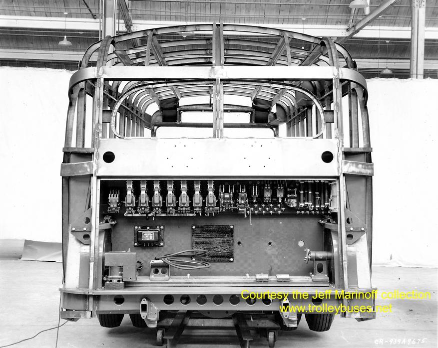

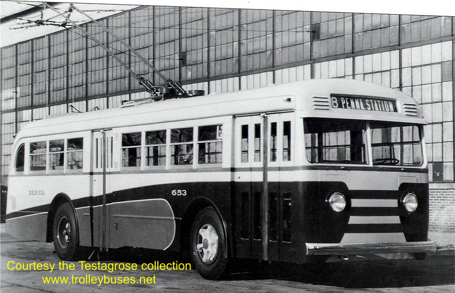

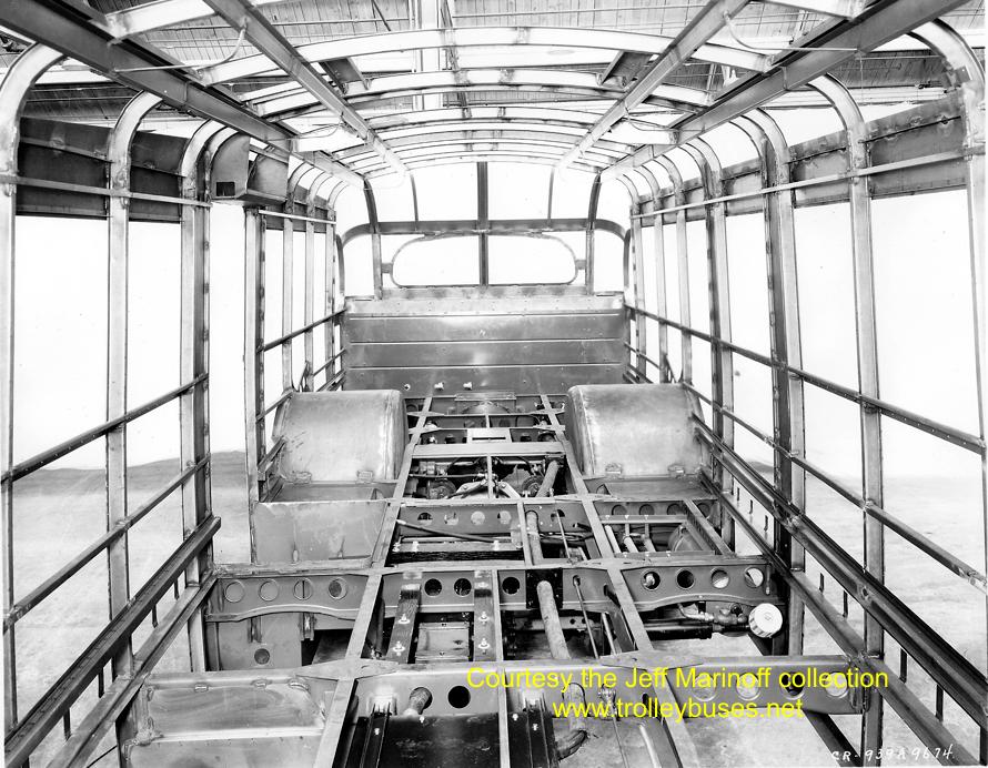

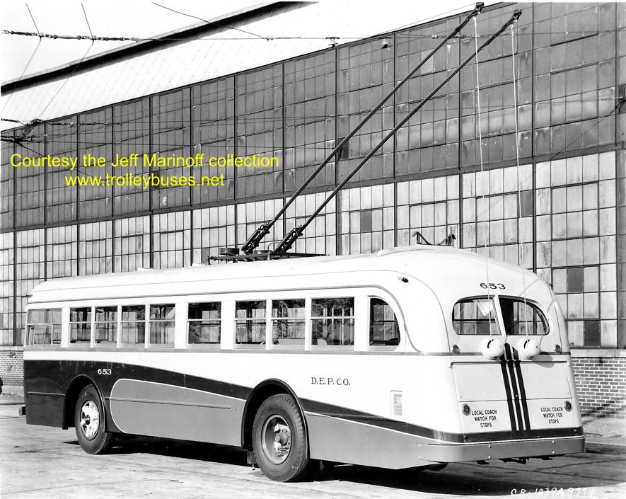

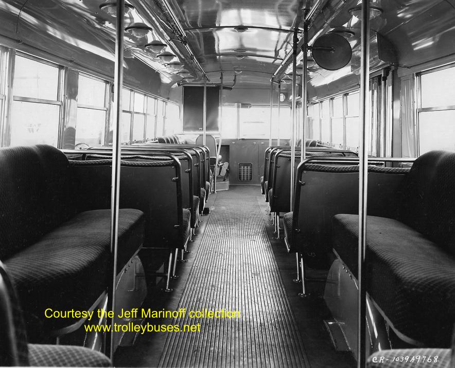

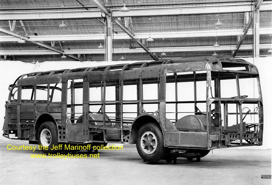

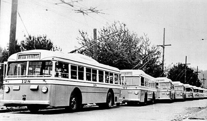

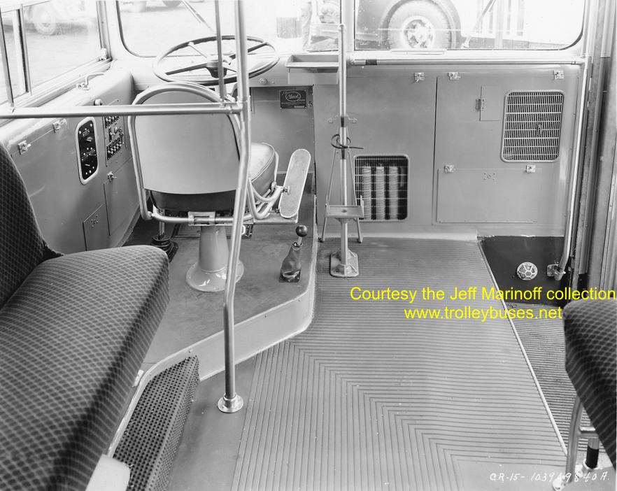

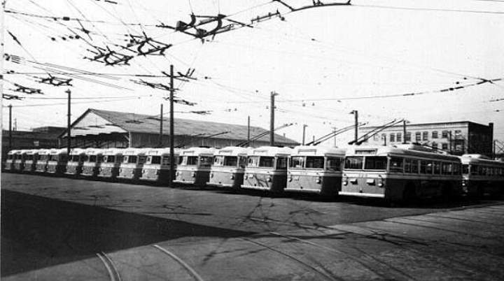

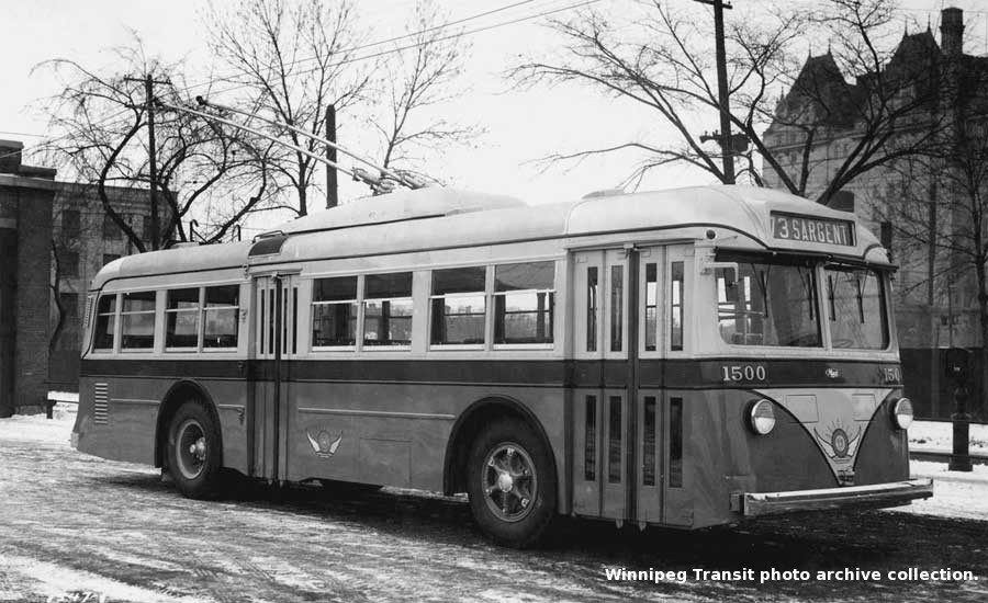

I agree. What we used to call a "trackless trolley' in the states, for example the Mack Trucks model "CR", actually is cheaper to operate.
Cities across the world, largely with the exception of the U.S.*, use modern trackless trolleys (overhead-powered electric buses) today.
* San Francisco is the only U.S. city I know with a trolley bus fleet.

Trevor Milton wants to revolutionize trucking, and he doesn’t care if you don’t believe him
Commercial Carrier Journal  /  September 9, 2016
Trevor Milton has been in the trucking industry for the better part of six years, but his big break came – like a meteorite through a skylight – earlier this year when he announced plans to build an electric Class 8 truck.
Milton founded Nikola Motor Company (NMC) two years ago, named in homage to engineer and inventor Nikola Tesla. With the looming December launch of its electric drivetrain truck NMC is poised to become the Tesla of trucking.
It’s fitting that Milton, who has fewer than 200 Twitter followers, only follows one account – Tesla Motor Company boss Elon Musk.
Prior to establishing Nikola, Milton was CEO of dHybrid Systems, a company that made natural gas storage technology for trucking that was acquired in October 2014 by Worthington Industries.
But Milton isn’t your typical trucking CEO.
A co-founder of five start ups, he considers himself a “serial entrepreneur” and is fluent in Portuguese, English and is semi-fluent in Spanish. He also brings his dog to work every day.
While at dHybrid Systems, he directed the engineering team and design processes that produced, among other things, “the fastest filling receptacles ever introduced into the natural gas market.”
Unlike his electric passenger car contemporary Musk, who is a graduate of the University of Pennsylvania and the Wharton School of Business, Milton didn’t attend college.
“I gained all my knowledge in the real world,” he says. “Working with all the different companies and it’s just how I learned. Everyone learns differently and my talents for learning are in-hand. I like to learn by touching things.”
Nikola burst onto the scene in May of this year with promises of a fully electric, 2,000 horsepower Class 8 truck that provided an asphalt crumbling 3,700 ft. lbs. of torque after. That’s Thirty. Seven. Hundred. An on-board CNG turbine was supposed to provide a range of 1,200 miles to the truck’s 320 kWh battery pack.
Next came the promises of zero emissions, an attractive buzzword as the EPA unfurled its Phase II emissions regulations in August. Then came a range extending hydrogen fuel cell, which just four months following its initial announcement supplanted a CNG turbine that will no longer be offered in the U.S. or Canada on the Nikola One tractor.
“Hydrogen is more efficient and there’s no emissions on it,” Milton says. “It’s 100 percent zero emissions. The end goal, and the desire of us, is to be 100 percent emission free.”
The conversion to a hydrogen fuel cell also came with horsepower and torque downgrades. Milton says the company was forced to reconfigure horsepower output from the 800V AC motors to 1,000 and dial down torque to 2,000 ft. lbs.
“The amount of torque and horsepower we had was destroying tires,” he says, adding the output comes from a change in the truck’s software. “It’s all software limited. The truck’s still able to output that power.”
Equipped with a hydrogen fuel cell, the truck kept its 1,200 mile top range claims. In addition to the fuel cell, the batteries are constantly receiving power through rotational energy via regenerative braking technology.
The decision to substitute the CNG range extender for hydrogen didn’t come without risk. Milton says more than 8,000 orders were already on the books for the CNG model. Less than a month after the switch was made, Milton says feedback has been mostly positive. Cancellations were practically non-existent and were more than offset by new orders coming in.
“There’s better hydrogen credits with hydrogen than there is with CNG,” he adds.
The trucking industry is nothing if not traditional, and NMC is further outside the box than any other company currently building trucks. Undaunted, Milton says Nikola One will find its niche with fleets and drivers tired of chasing EPA emission standards and looking to save some money along the way.
“It comes down to your bottom line – what does it cost to operate a diesel per month,” he says. “For a full-time driver it’s about $8,000 to $10,000 dollars a month …With our truck, you’re about $5,000 to $6,000 a month.”
About 70 percent of NMC’s customers are fleets, including large carriers who have ordered “thousands” of units, Milton says, adding his company’s sales pitch to-date has been not making a sales pitch at all. The majority of Nikola One orders, he says, have come from customer-initiated contact.
“We don’t approach anyone. They approach us,” he says. “The customers we’re dealing with right now are customers that have called in to us asking for a meeting for the big fleets, and the rest have just ordered online. We don’t need to go make a pitch. If they don’t see the value in saving billions [of dollars], I don’t want to work with them anyways.”
Milton says his company is currently developing the hydrogen infrastructure to support its million-mile “free fuel” guarantee, with 56 strategically positioned hydrogen stations planned across the U.S. and Canada.
There is currently a per gallon federal credit to the station owner, allowing Nikola to build those credits into the price of the tractor and give customers the pre-purchased fuel for the first million miles, Milton says.
Meanwhile, there’s all those trucks that still need to be built.
“Probably three-quarters of the truck [assembly] will be done robotically,” he says. “All the stamping, all the paint, the frame assembly … everything’s done by robotics, and then a human comes in and finishes it up.”
Milton struggles to pin down a number of people currently working on the project, but says counting employees of NMC and its partners, “it’s hundreds and hundreds and hundreds.”
And those hundreds and hundreds and hundreds of employees have helped push the company, Milton says, to the forefront of its segment.
“We’re probably five to 10 years ahead of our competition,” he adds, “and we’ll start full production about 36 months from right now. I’m happy. We’re booked out for many, many years and that’s what everybody’s dream is.”
Innovations in trucking are nothing new and with diesel prices fairly low compared to recent history, NMC has its share of doubters for long-term viability. But Milton says there are plenty of differences between his company and those who may have come – or gone – before it.
“We’re the only ones with actual orders,” he says. “We’ve got orders, deposits, partners – we’ve got the largest partners in the world. That’s the difference between us and everyone else. We have a product that makes sense and doesn’t need government subsidies.”
The development of Nikola One has largely been built and developed with Milton’s money and funding from partners. Milton says the 8,000-plus $1,500 deposits plopped down to secure a model pre-launch is sitting untouched in an escrow account.
“Tesla actually uses people’s money and deposit money,” he says. “We don’t. This has all been self-funded and funded by partners. We’re not out there trying to get money to operate.”
Milton is currently working to build the NMC sales and service network, the details of which he expects to announce in about 80 days when the sheet is fully pulled off Nikola One – an event he expects will be attended by more than 500 people, including a likely handful of naysayers.
“So many people out there called us vaporware,” he says. “They’re going to eat their words.”

Nikola to Officially Unveil Hybrid-Electric Truck on Dec. 1
Heavy Duty Trucking  /  November 3, 2016
Upstart commercial vehicle maker Nikola Motor Company is on track to unveil its flagship product, the Nikola One electric Class 8 truck, at a launch event on Dec. 1st.
In addition to the Nikola One, the company will also reveal its plans for its network of hydrogen fueling stations in the U.S. to support its hybrid-electric truck.
“Over 300 planned stations are going to be announced at the Dec. 1 event,” said Trevor Milton, Nikola’s CEO. “Nikola will have the largest hydrogen network in the world. We are proud to be on the forefront of this clean energy revolution.”
The Nikola One is a hydrogen-powered electric vehicle that is projected to have a range of 800 to 1,200 miles between fillups with an effective fuel economy of 15-20 mpg under full load.
The vehicle will also produce zero emissions, according to Nikola, surpassing the government’s standards including the EPA’s new Phase 2 greenhouse gas standards.
By using hydrogen to power its electric motor and batteries, the Nikola One can hoffer an extended range over a traditional plug-in electric vehicle while generating fewer emissions than a comparable diesel or alternative fueled hybrid, per the company.
“Nikola will begin selling hydrogen to non-Nikola customers for around $3.50 per kg, nearly half the current market price,” said Milton. “We believe that hydrogen power generation is a better deal per mile than plugging in for electricity.”
In a move that mirrors Tesla Motors, the company has been taking reservations for the unreleased Nikola One truck, which the company says has totaled nearly $3 billion in the first 30 days of availability.
