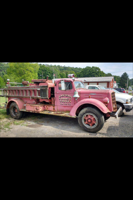

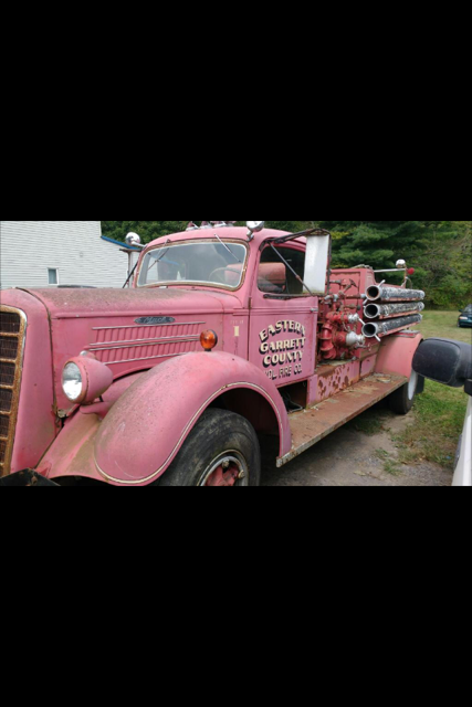

My department is attempting to restore our 1947 Mack FH Closed Cab Fire Truck.  We also are in need of a Hydrovac Brake booster.  I am attaching a few pic of our truck for reference.   We are a very small rural fire company in western Maryland we are attempting this restore for our 50th Anniversary in April 2017.  If you call hell us please email me at mgs012962@Gmail.com or call me 301 707 5295.  Thank you.
I used him for the 2 piston booster on my AC Mack. Give him a call. Have the booster part number or other I.D. info and  maker (Bendiz, Moraine, etc. )    Paul

On 11/12/2016 at 9:07 AM, j hancock said:
Good looking fire rig!
Deputy Chief 80:

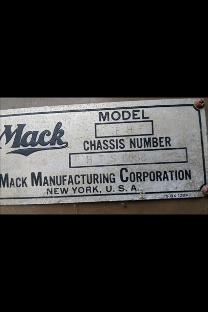

I agree with j hancock: I always liked the "E" model. This one appears to be a commercial chassis, "EH", with an aftermarket body and separate pump engine (not that there is anything wrong with that !!!!).
Good luck with your restoration, keep us updated on its progress.
