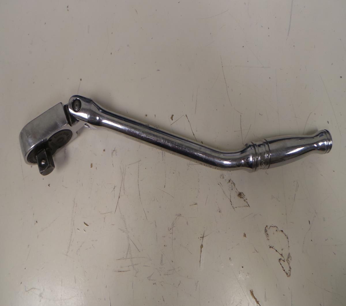

If you follow the electrical out of the vgt control on the turbo it with go to a plug. I unplug those to get the turbo out of the way completely. Ratchet wrenches with flex heads work pretty good for the back bolts. I always pull the outside bolts then the rear front bolt and spin the turbo to help loosen the bolts in the rear rear if that makes sense.
