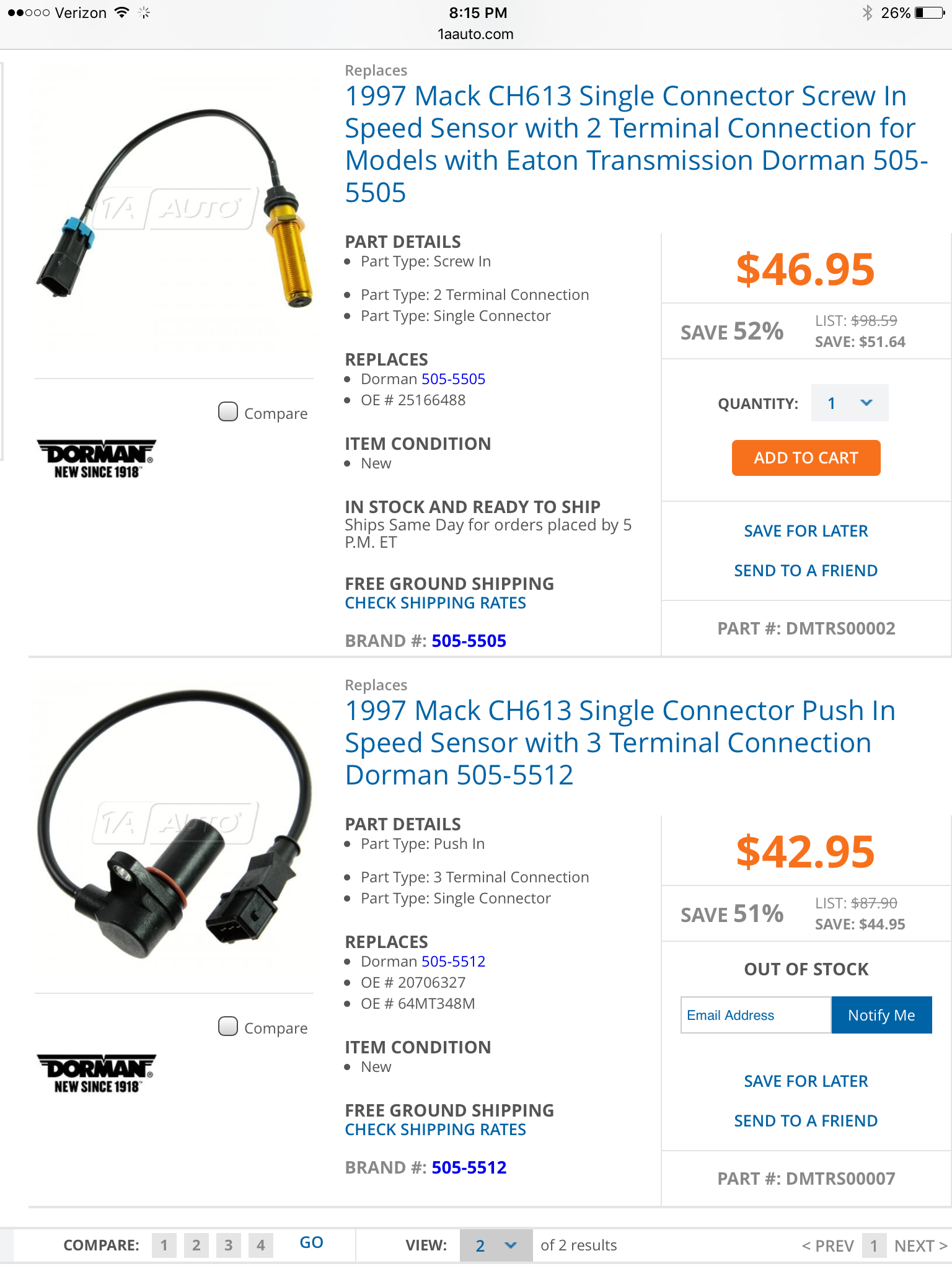

@turckster I checked the engine plate it says e-7 330-350 and my I do have an inline injection pump. So the next question is "where is the speed sensor on this truck on the flywheel or back of transmission?"  I also found this speed sensors online what's the difference? Thanks

The speedo sensor is located  at the rear of the transmission. Measure the resistance of the sensor. If it is gold in color(old style) it should be between 200-300 ohms, if it is black and looks like plastic(new style) it should be 140-180 ohms.  If that is ok, remove the sensor and check the tip for damage, also make sure the tone ring does not turn (use a screw driver through the sensor hole and try to turn). If all looks ok, try reinstalling the sensor and make sure it is adjusted properly. Screw the sensor until it contacts the tone ring, back off 1 turn and lock it down.
The gold colored sensor looks like the older style sensor Mack used to use, should be ok.
